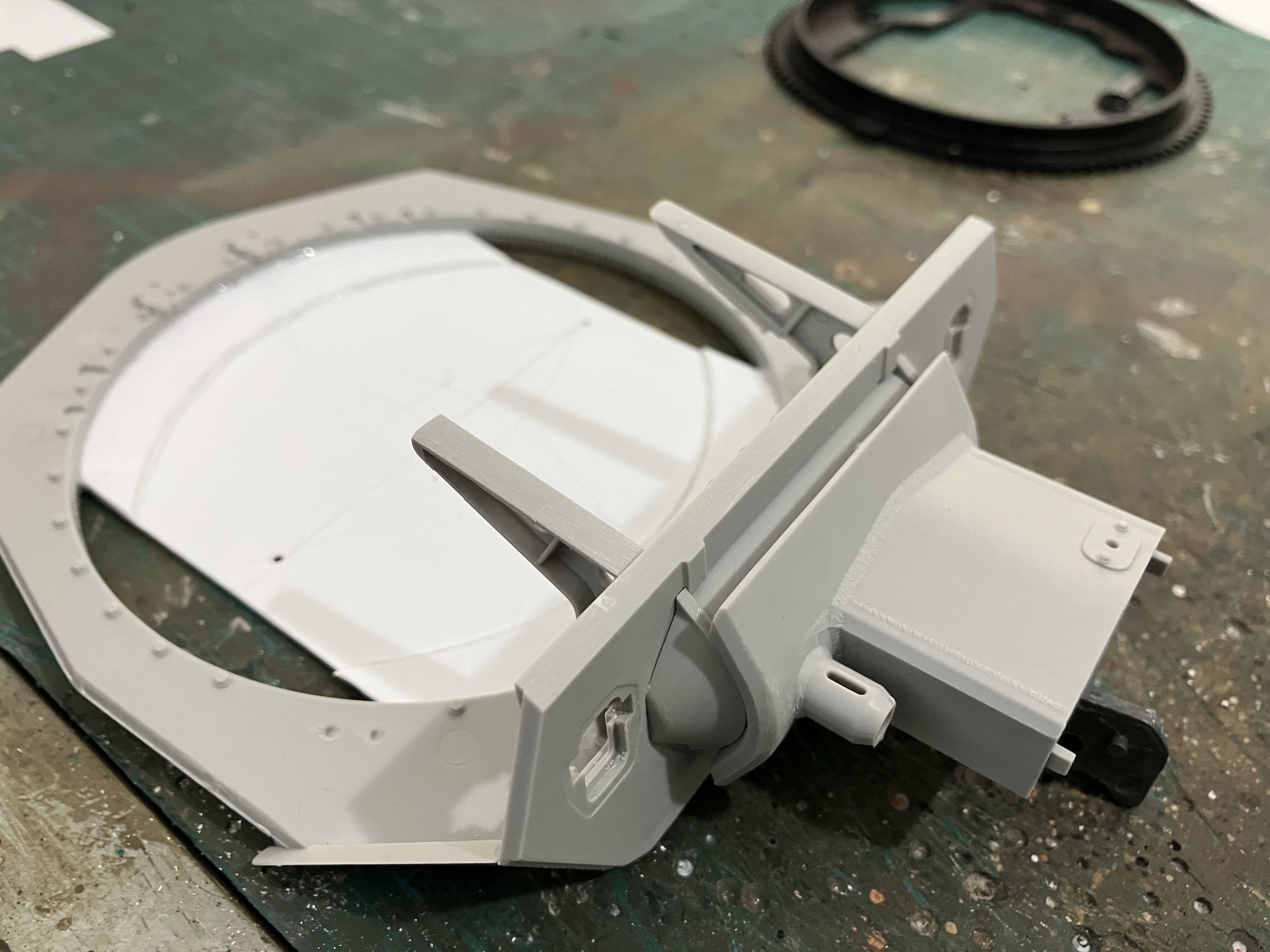

Now the fundamental parts of the hull are done, it’s onto the turret.
This damn thing is a royal, weapons-grade pain in the clacker
No locating points, no separation lines that are designed with maintenance and ease of entry in mind.
I’m going to have to make the lower and front plate fixed with the gun and its functional bits on it, and the upper turret just a covering cap.
I’ll get the bastard, but it’s testing my patience and will .
The rotation ring is also a bit of wing it & see.
An old HL gear that is secured by styrene sheet & screws to the Trumpeter turret ring which is glued to the lower turret plate.
It’ll work fine. Sanding a bit of the turret slew ring out to make it looser was a must.

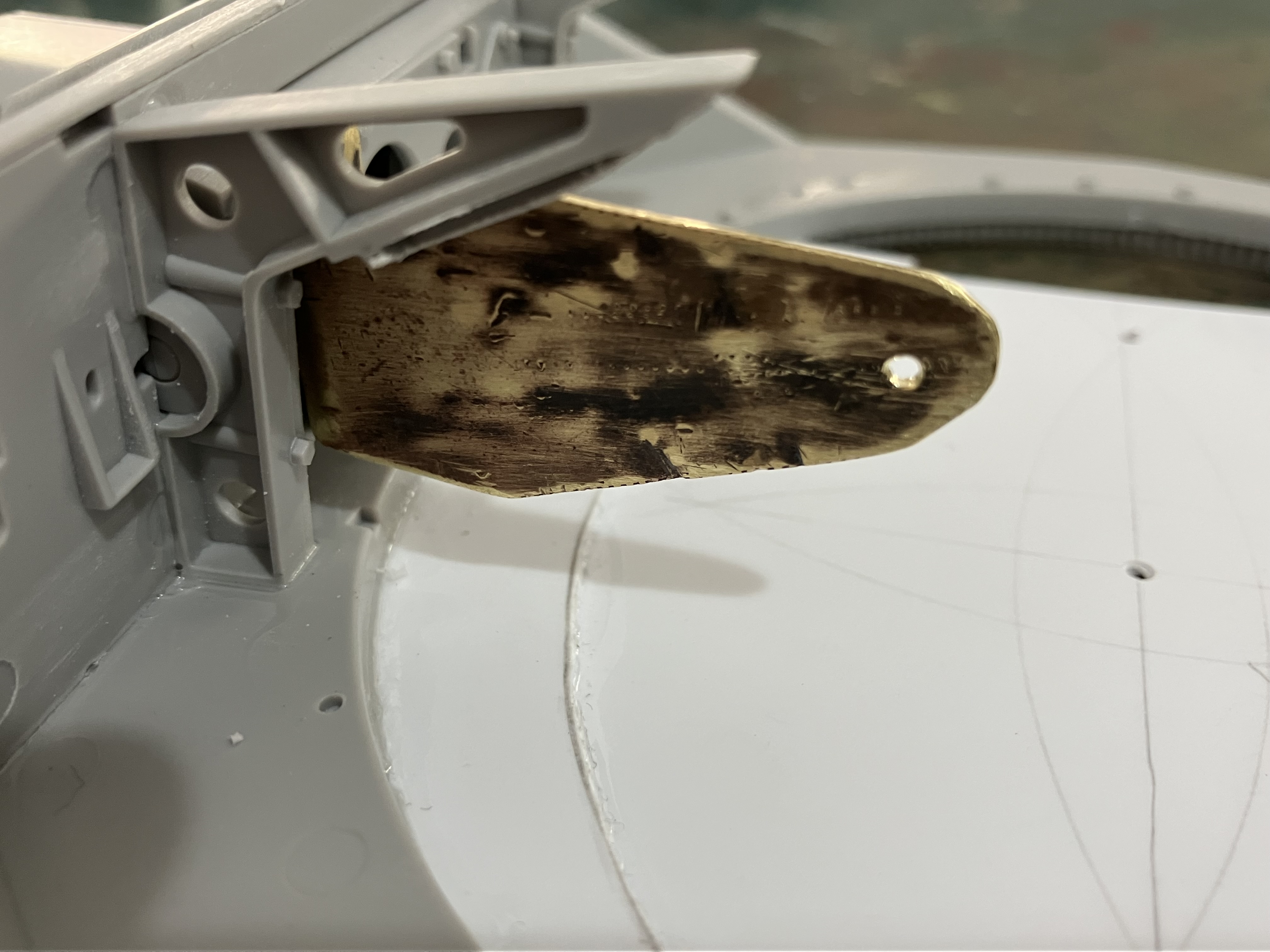

And now the turret.
Using the Trumpeter pivot points on the gun trunnions I did consider changing for a more robust solution, but also to consider is the low cycle life this thing is expected to see and that accuracy for the owner is crucial.
Risking getting the mantlet wrong would not be an acceptable outcome.
I used the Trumpeter gun cradle arms that would carry the elevation hand wheel & gears to support the trunnions and also assist in locating the turret roof .
Trimmed some details off the inside of the mantlet to enable a brass lever to be anchored in place to carry a link bar from the elevation servo.
There was a lot of testing , trimming, and readjusting to get the range of motion right I can give you the news!!
This thing is the remotely closest I have ever felt like how Mr Mcq11 does his work .
And it’s still far far away .
Using glued Lego bricks to carry the servo enabled me to do more fine adjustments before committing 100% to placement.
I will reinforce them more just to be safe.

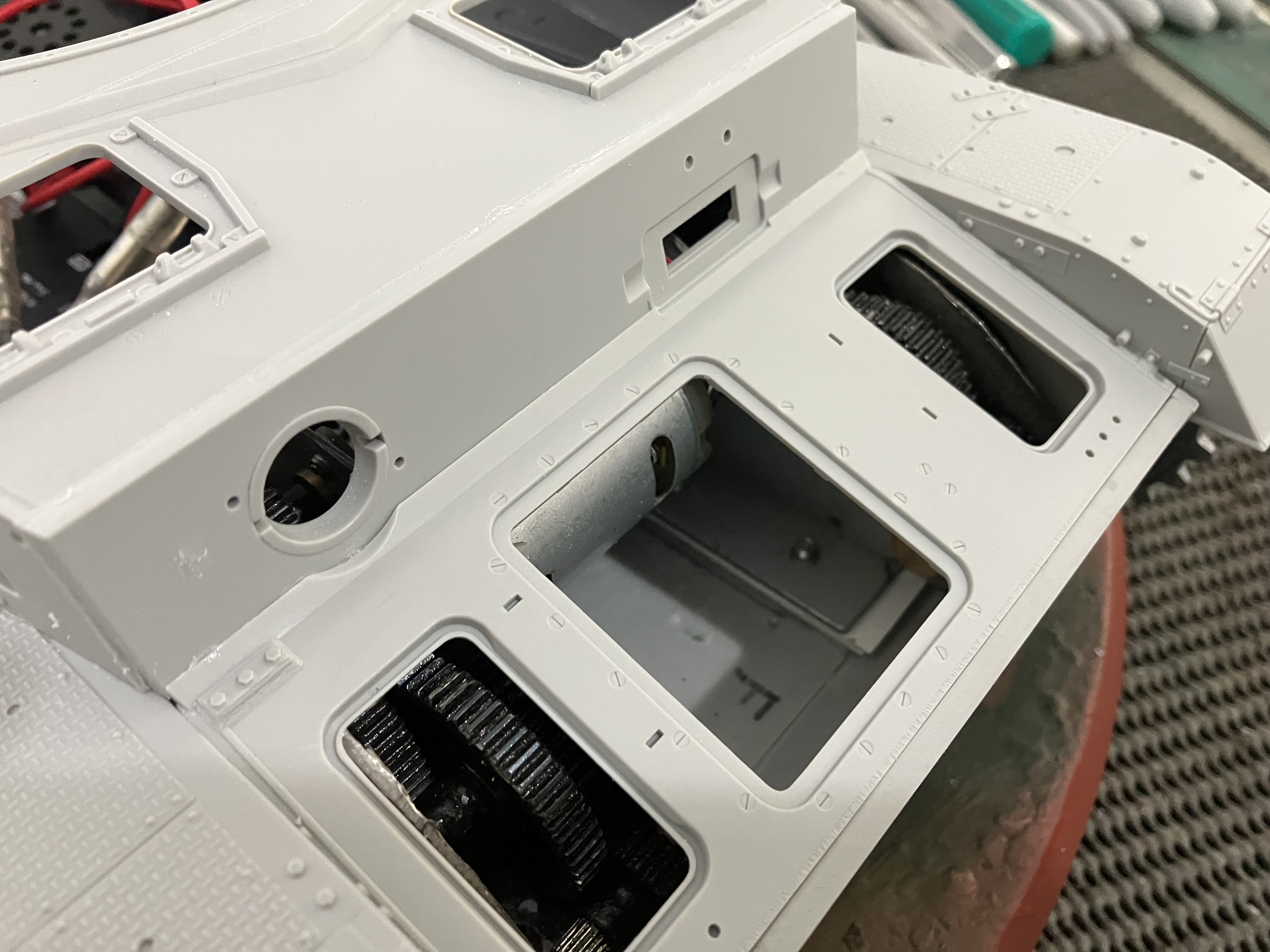

- Lieutenant-General
- Posts: 12027
Re: A LEAP OF FAITH
And best of all the owner chose the front plate version to be the early thinner one which helped a lot to get the hull and guards in place .
Still a lot to do and I won’t even finish it, that’s for the owner .
Happy with the progress so far and I’m privileged to be doing such a project in another’s behalf.
