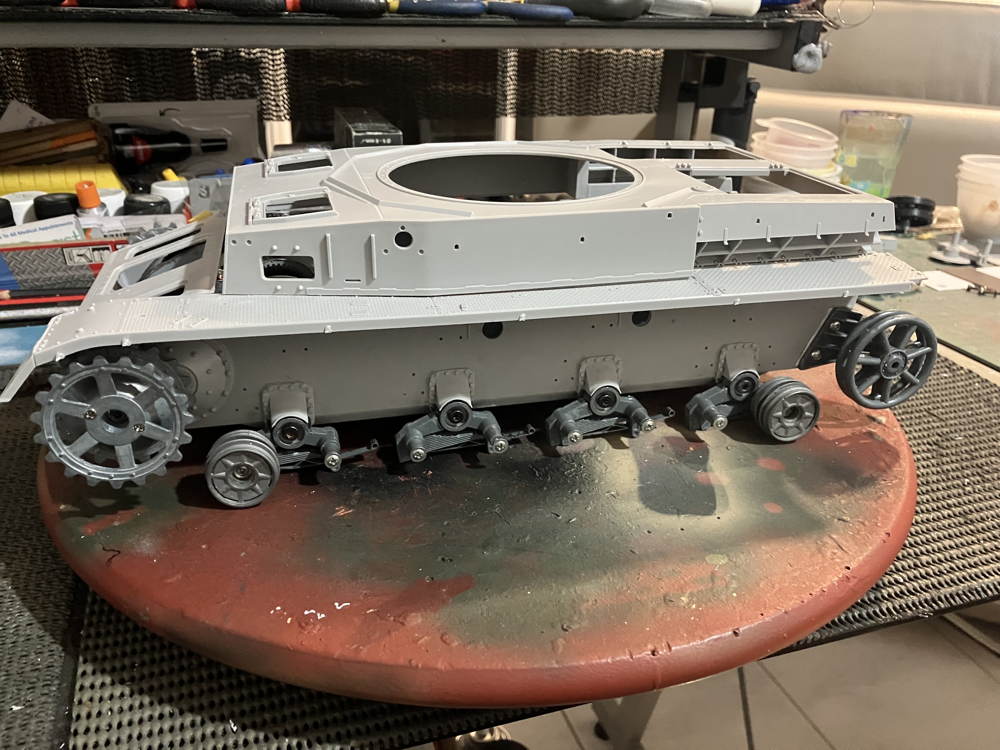

- Lieutenant-General
- Posts: 12019
Re: A LEAP OF FAITH
Even a loose fit of the upper hull parts shows the improved look over a HL version .
- IMG_1691.jpeg (2.91 MiB) Viewed 40 times
- IMG_1692.jpeg (2.92 MiB) Viewed 40 times
