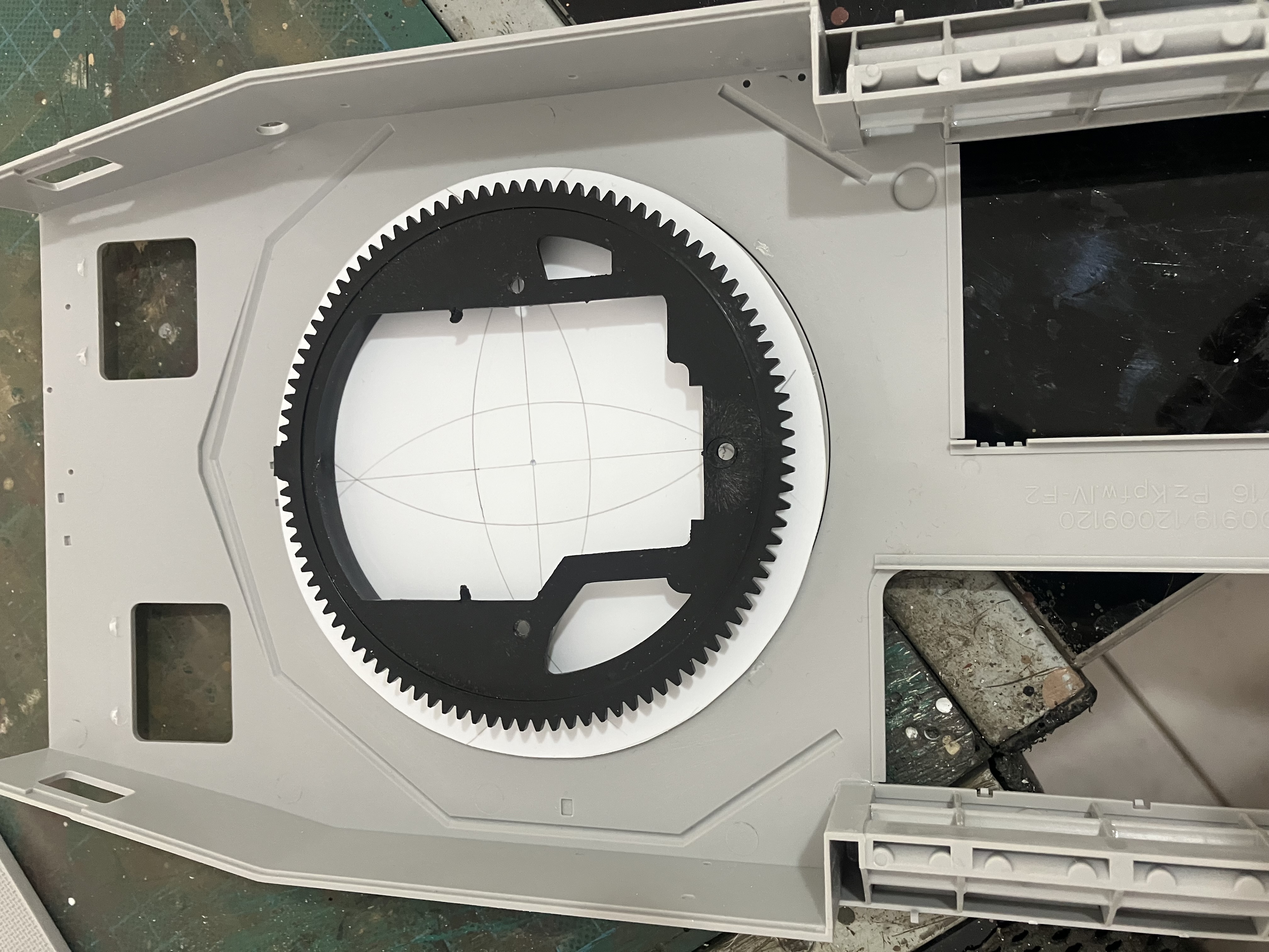

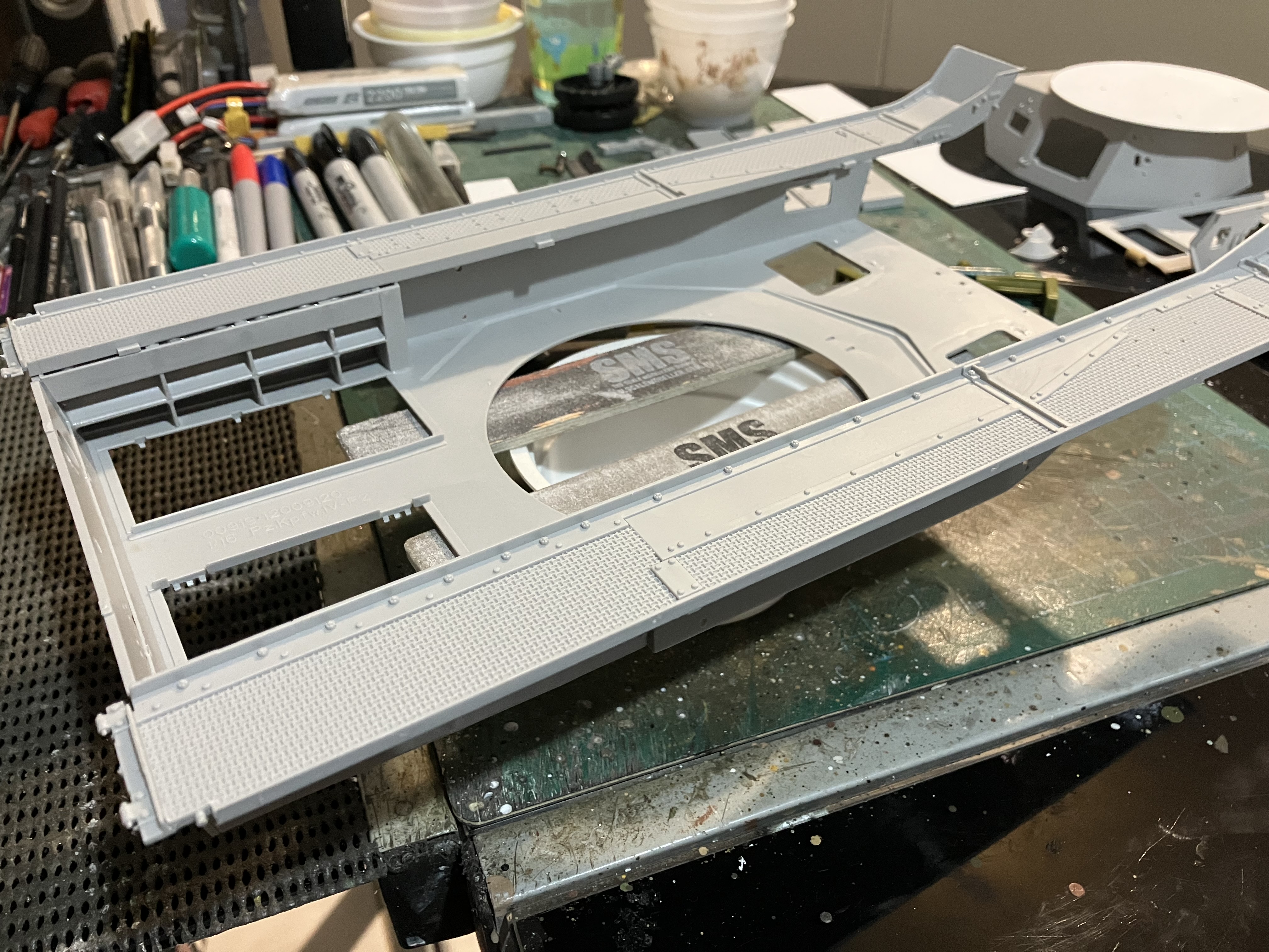

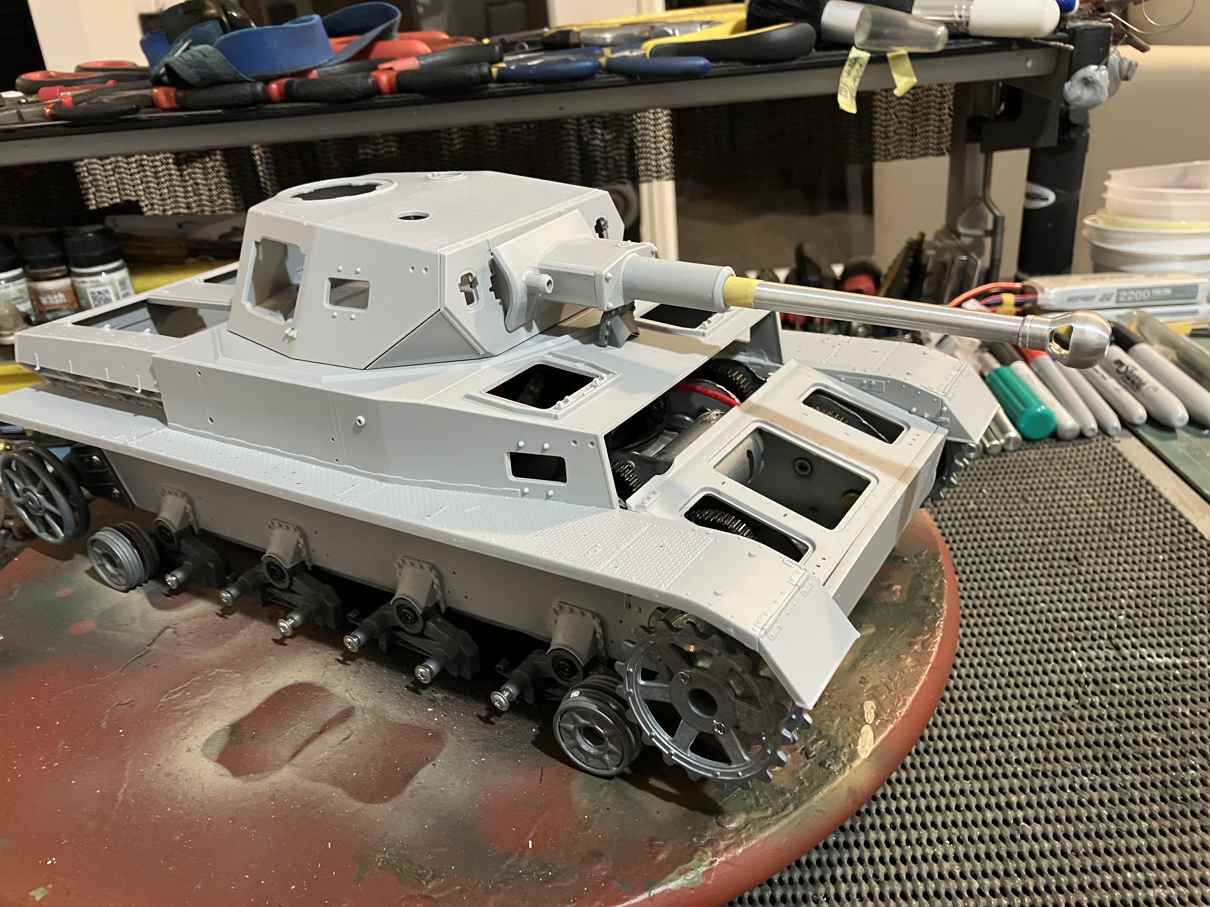

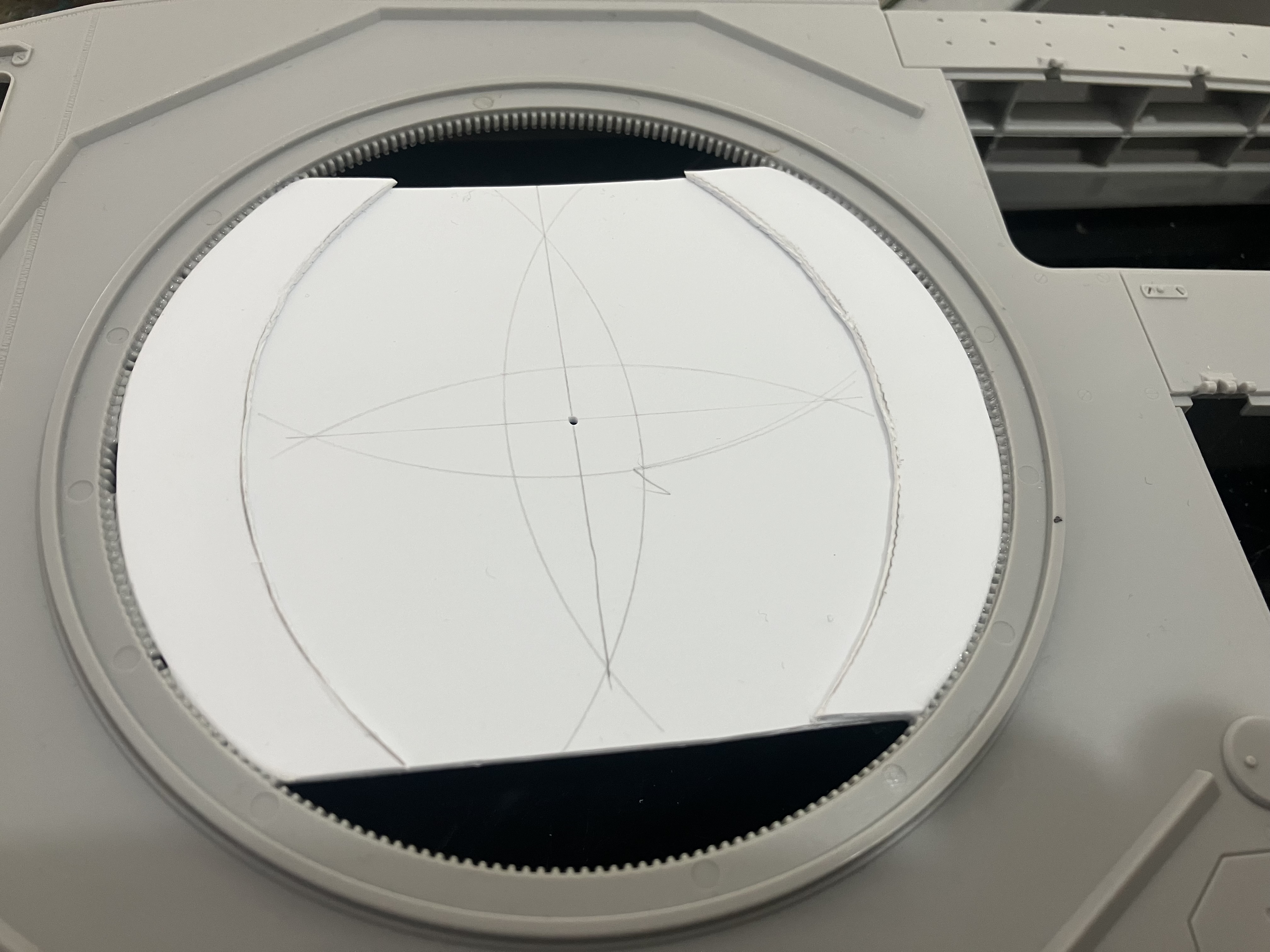

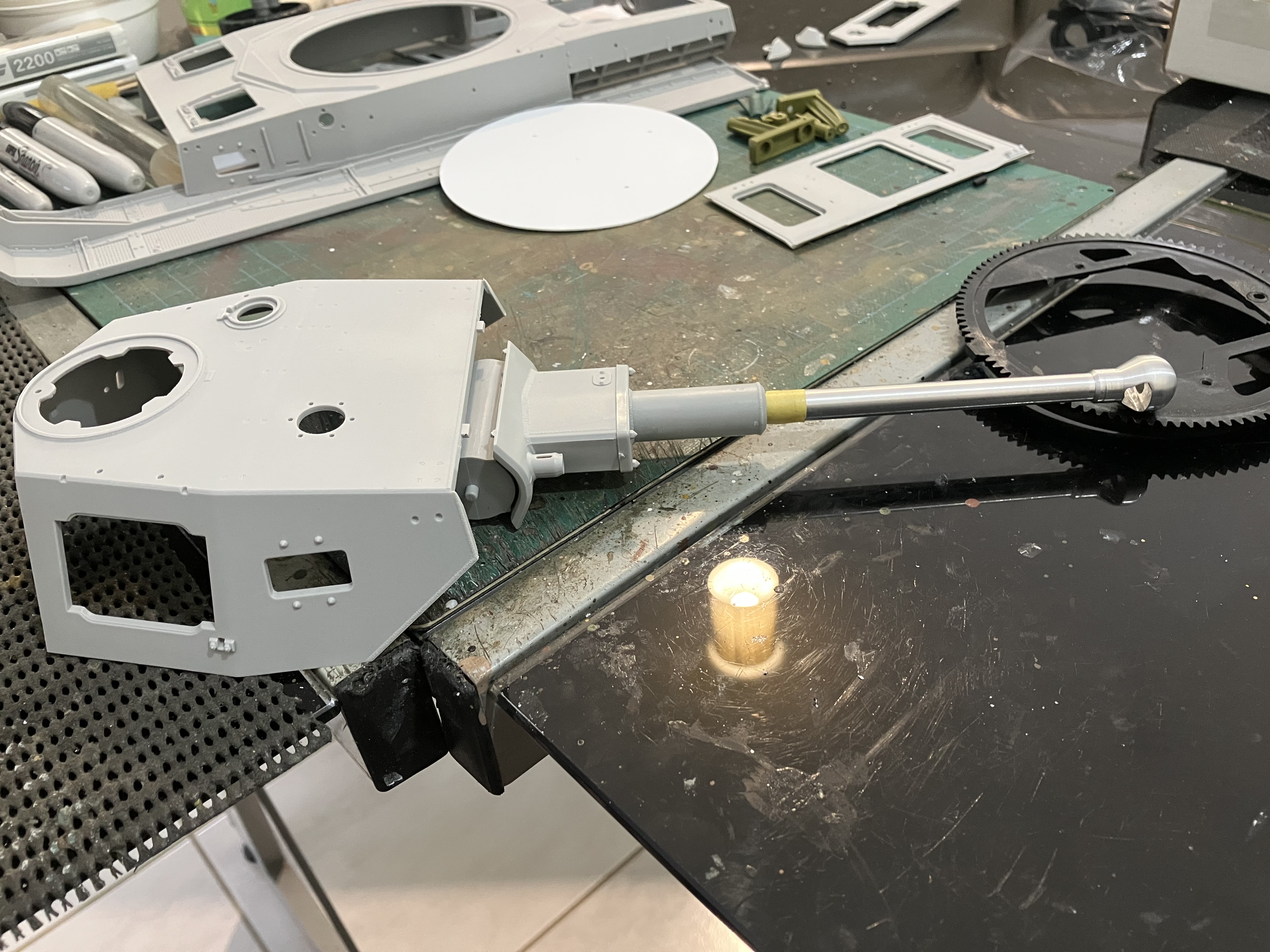

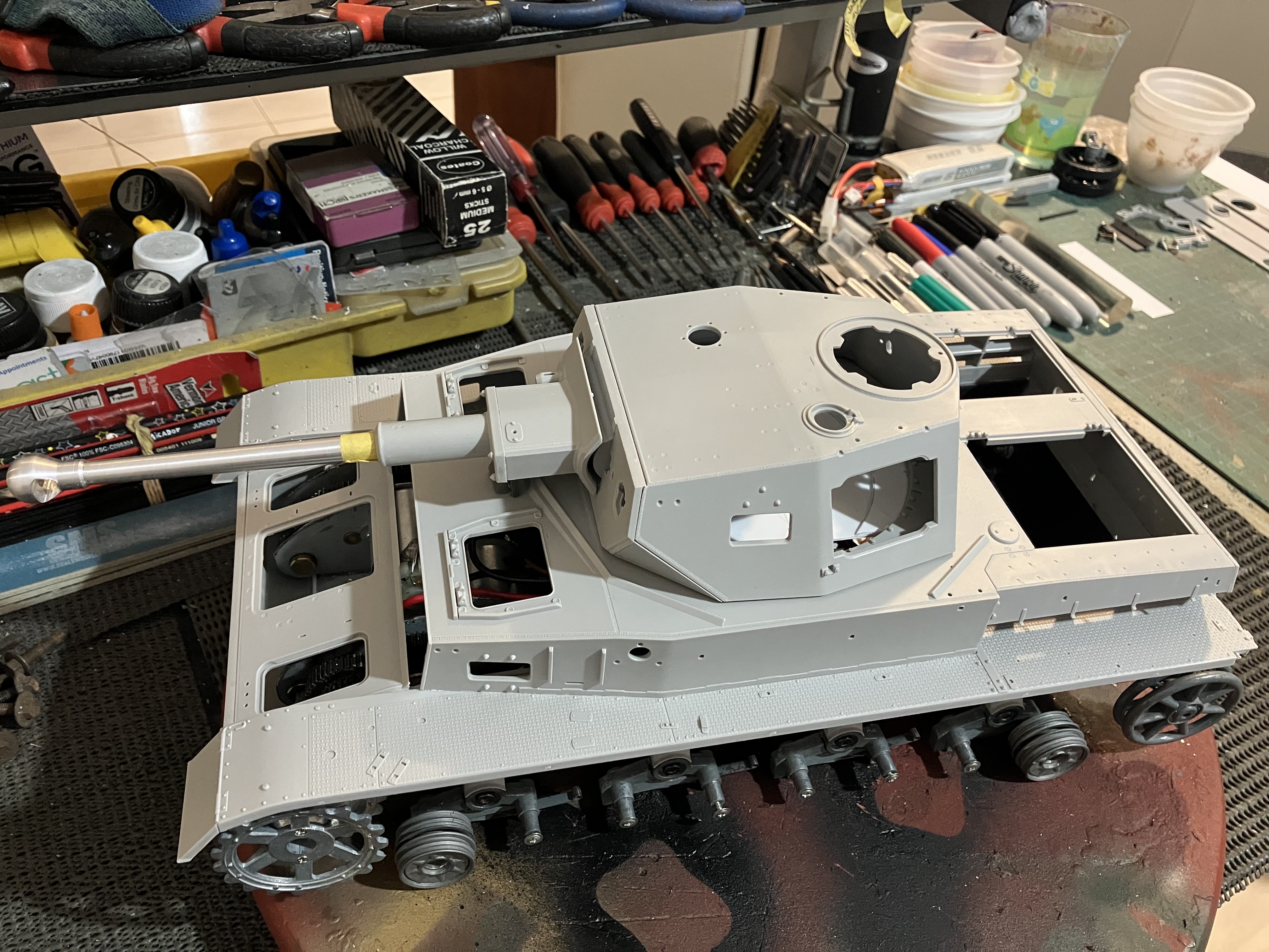

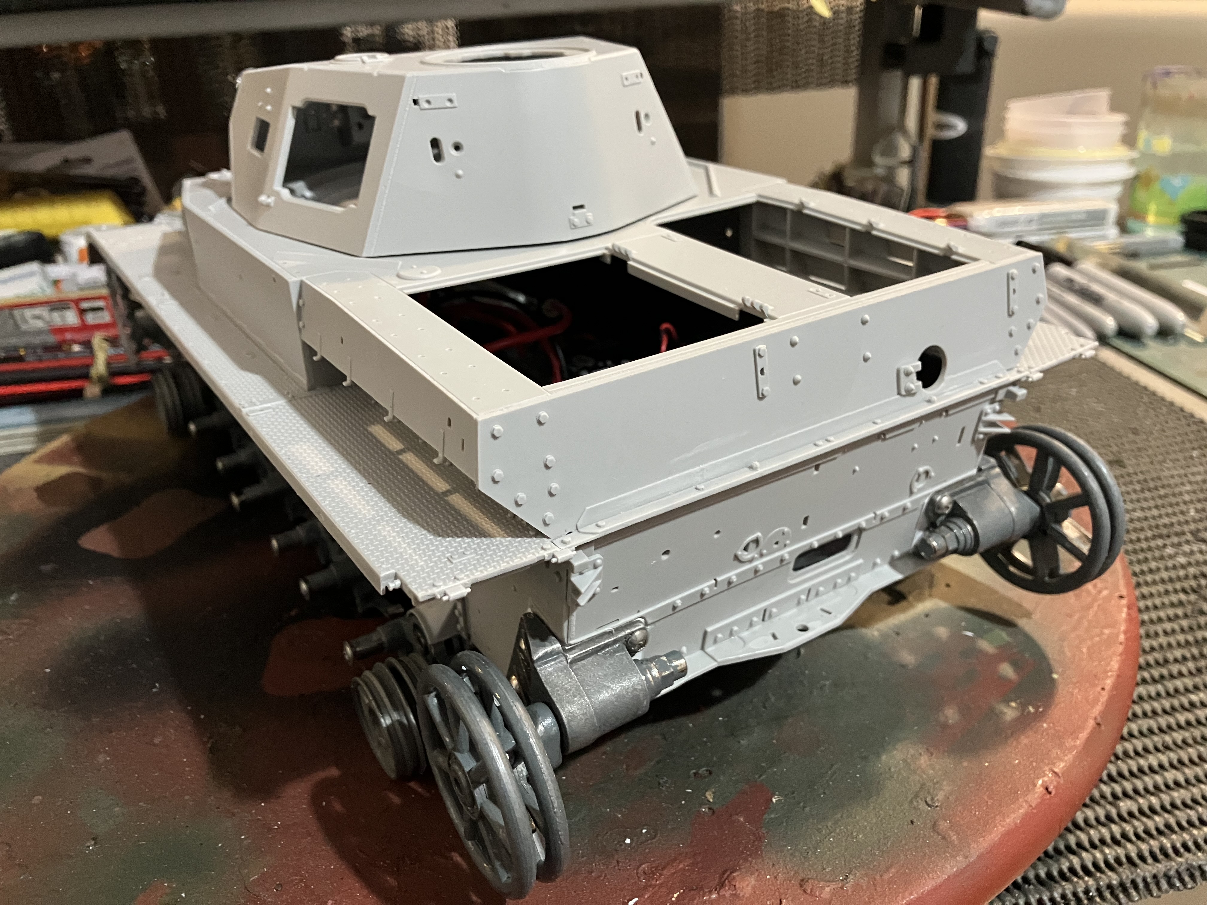

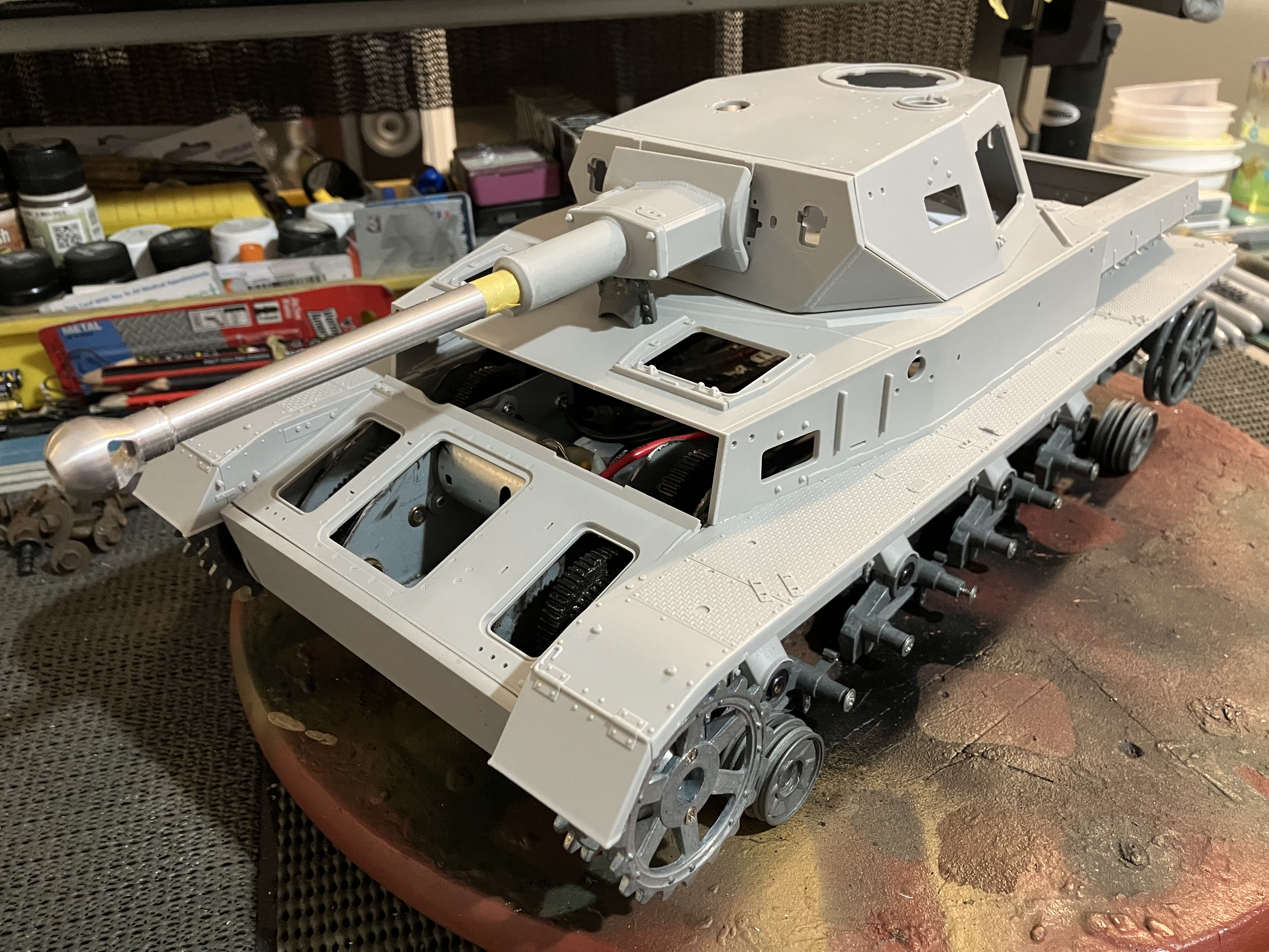

Now the fundamental parts of the hull are done, it’s onto the turret.
This damn thing is a royal, weapons-grade pain in the clacker
No locating points, no separation lines that are designed with maintenance and ease of entry in mind.
I’m going to have to make the lower and front plate fixed with the gun and its functional bits on it, and the upper turret just a covering cap.
I’ll get the bastard, but it’s testing my patience and will .
The rotation ring is also a bit of wing it & see.
An old HL gear that is secured by styrene sheet & screws to the Trumpeter turret ring which is glued to the lower turret plate.
It’ll work fine. Sanding a bit of the turret slew ring out to make it looser was a must.
