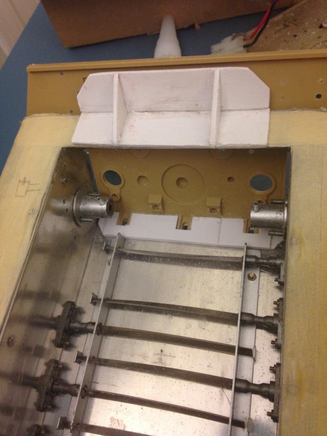

Thanks for the kind words about the tank. It looks OK, but not entirely happy with its reialiability, so I dont use it too much.. I installed the Henntec tensioner years ago, and I cannot remember if I had to drill something. If I am not mistaken I vaguely remember enlarging some holes I already had.

to answer your question about the "Hentec" system it is necessary to start by enlarging the existing holes in the chassis, then you must make 2 small holes, for each side, (fixing screws) personally that's what I I did, and no operating problems, just when enlarging the holes? be careful to stay centered in relation to each other
