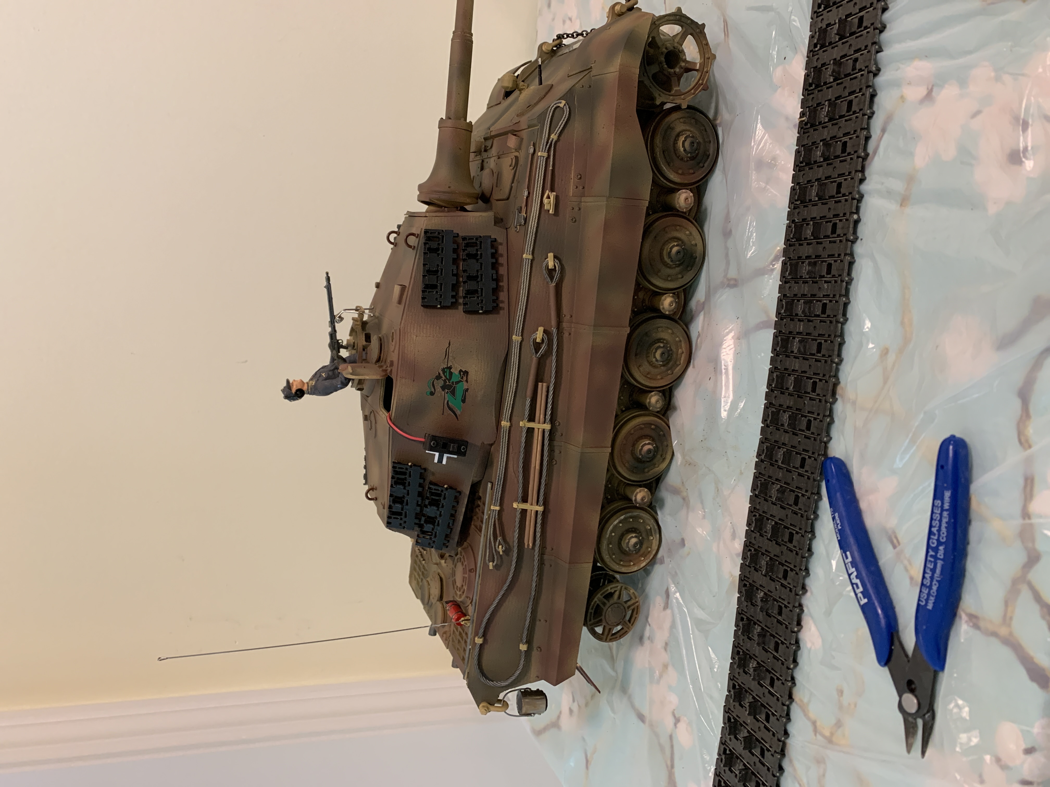

Michael151722
- Lance Corporal
- Posts: 122
- Joined: Sat Jun 22, 2024 3:30 am
Re: 1/16 Tamiya King Tiger Road Wheels won’t spin
Hello,
Thank you for the reply I did as told removed the tracks tightened up the grub screw but when it moves with the tracks my idler wheel still pushes forward I have tightened the idler tension I can still Kee on turning so I am not sure how tight I should go in this case?
- image.jpg (1.52 MiB) Viewed 1020 times
- Panzermechaniker
- Staff Sergeant
- Posts: 844
- Location: Toronto
The idler should not be moving position at all when you are driving. The tensioning system itself only moves it slightly back and forwards to adjust track tension. If the idler is loose there is something else going wrong in there. It's been almost 3 years since I assembled that Tamiya KT idler system before immediately replacing it with the Henntec on my first one. But I don't remember my idler just moving freely like yours is, it was more it was useless as a tensioning system. You might have to take it apart and re-assemble it. It's such a ridiculous system who knows what has happened
- Son of a gun-ner
- Lieutenant-Colonel
- Posts: 7653
- Location: Lancashire UK
If your idler is still sloppy/floppy/wobbly, tensioning the tracks won't help. We need to know why the idler isn't firmly fixed in place to stop it from being unnaturally pulled forward.
