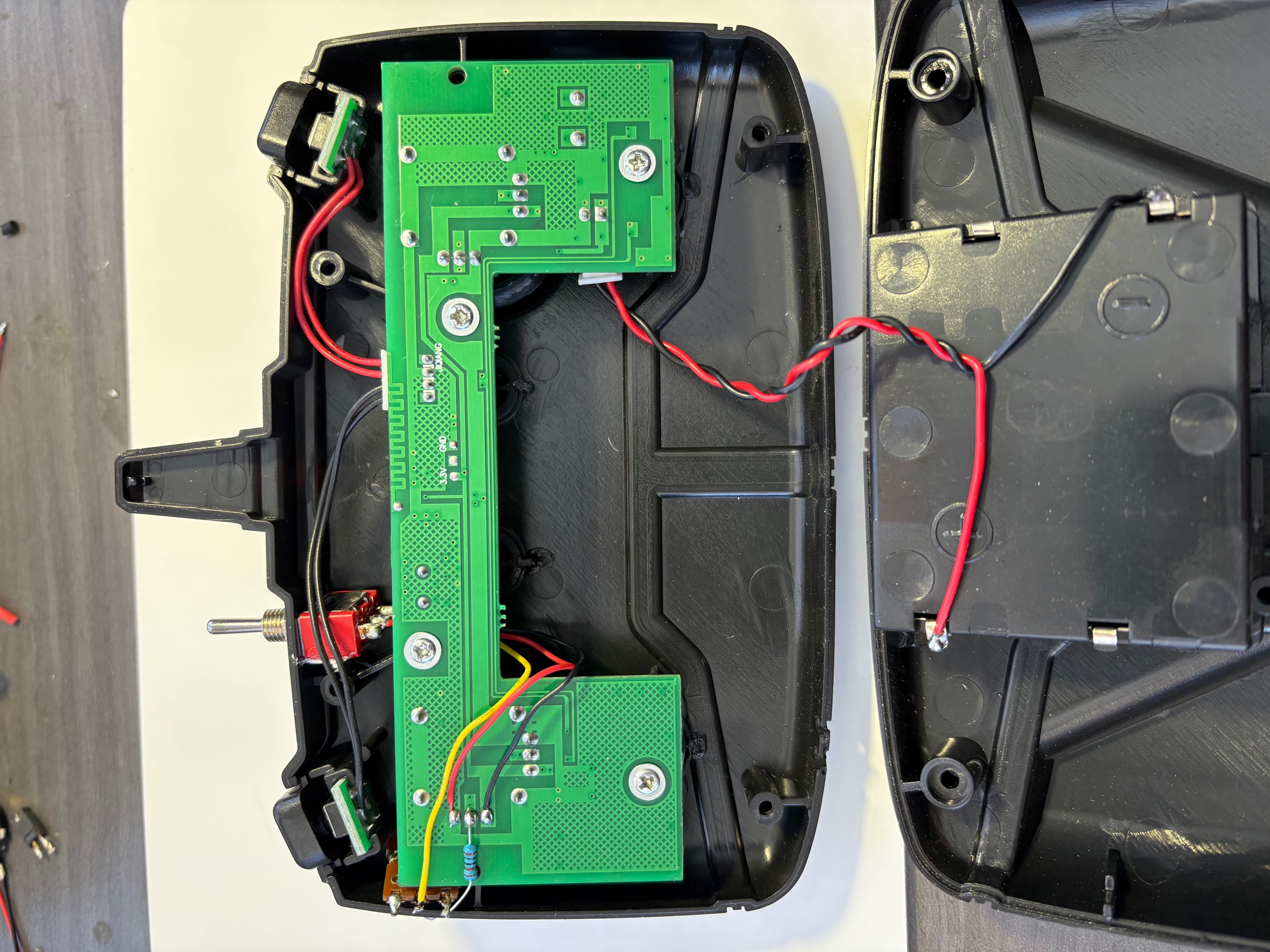

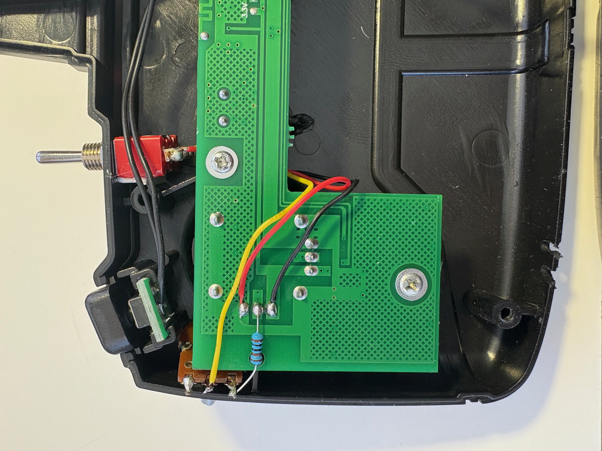

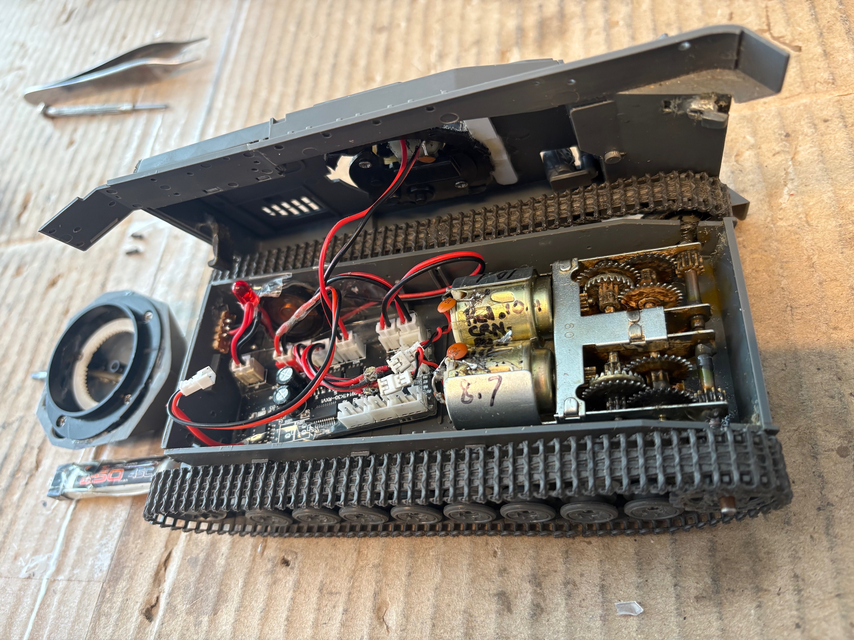

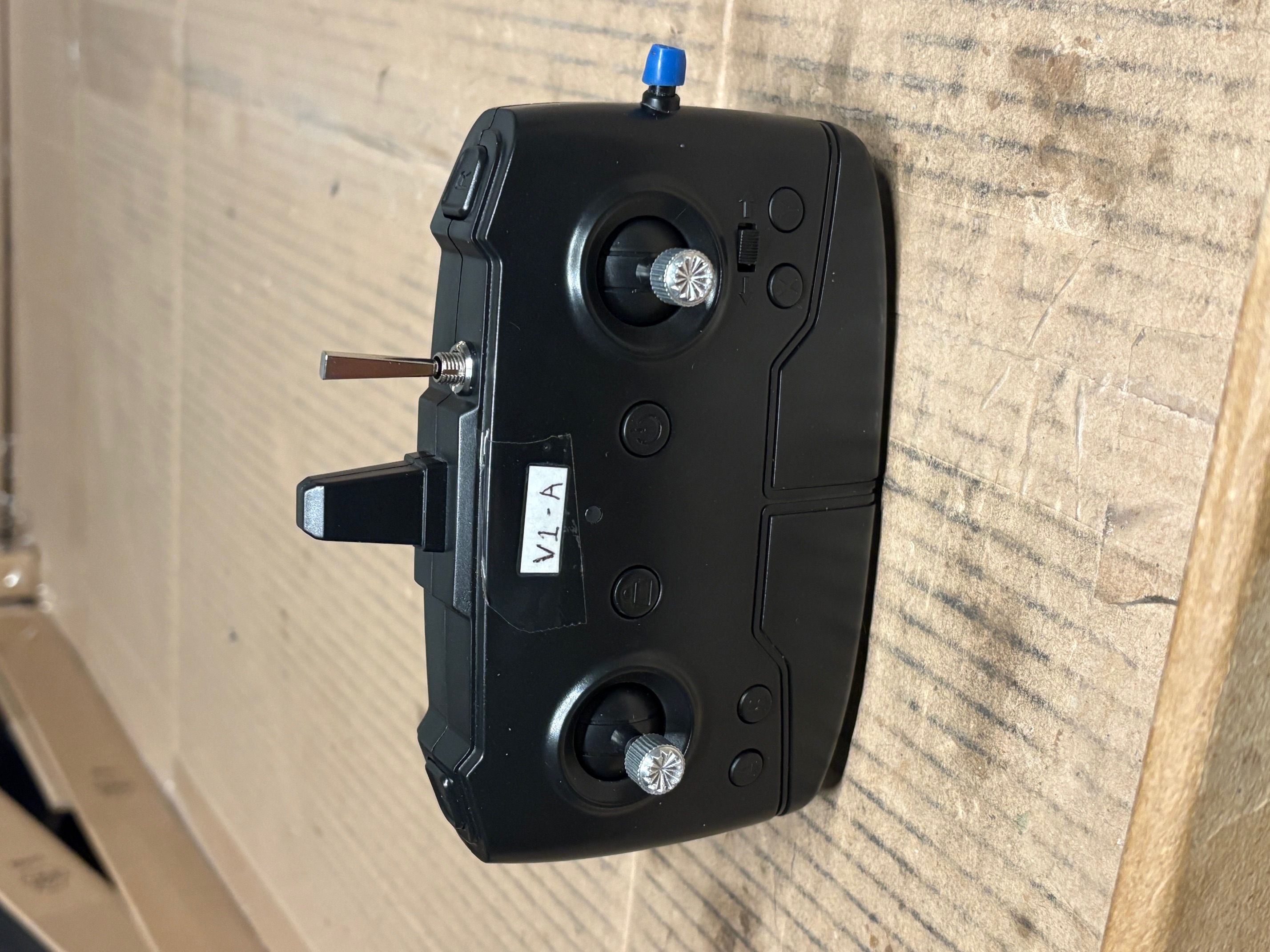

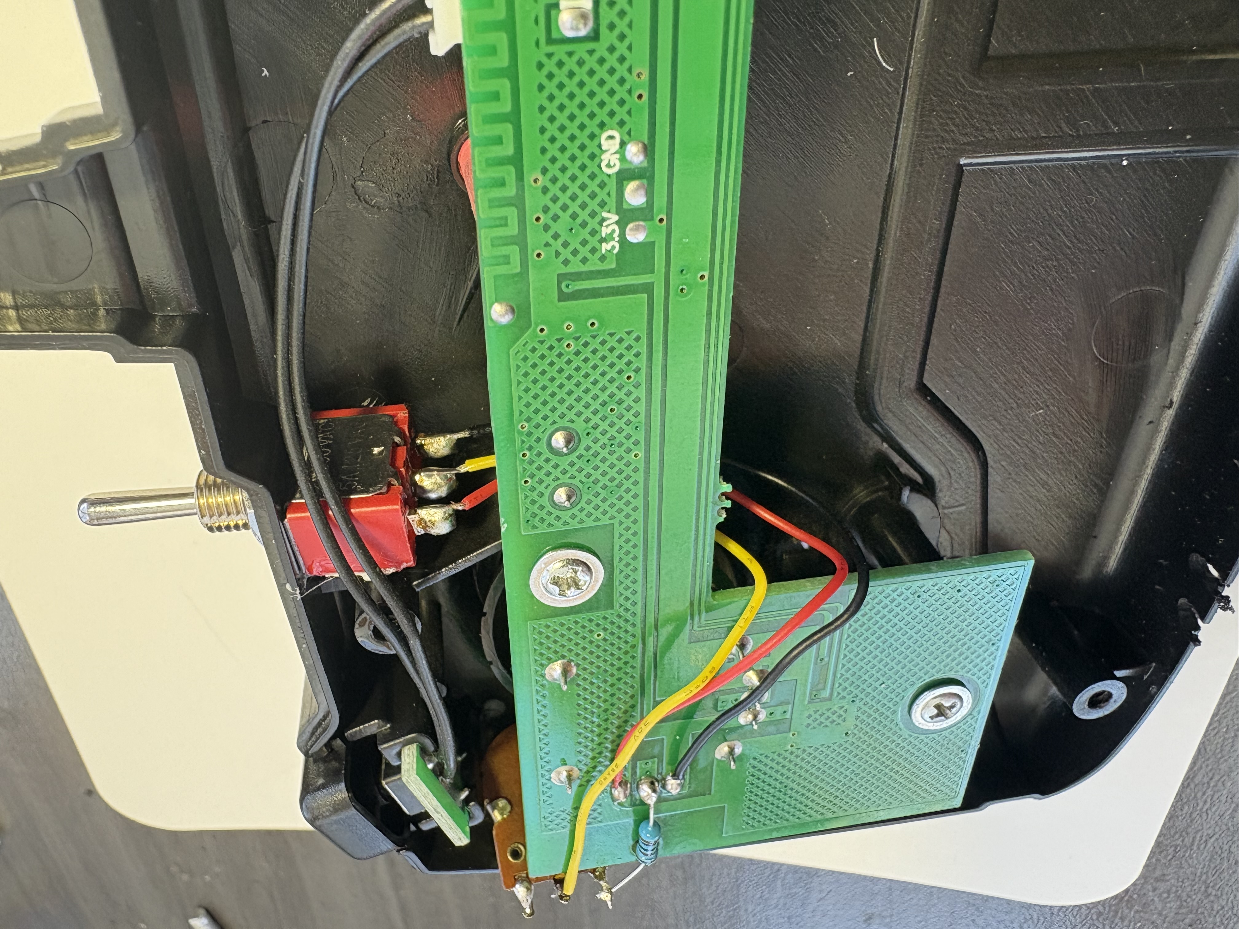

This Panzer IV moves at scale speed and that works well with the HL sound chip on the receiver board. I did a mod to the transmitter involving a spdt with center off and a 5k potentiometer. This allows me to dial down the speed and set a cruise in either F\R with the primary throttle still available to increase speed at any time, then when throttle is released, tank moves at the cruise setpoint until the switch is switched to the center off position.
I also added turret traverse on this model. You can see that in the video.
Here is a video of the tank in action on my indoor test track.
https://www.youtube.com/watch?v=7oN7HIzHTF8
on\off switch
on\off switch

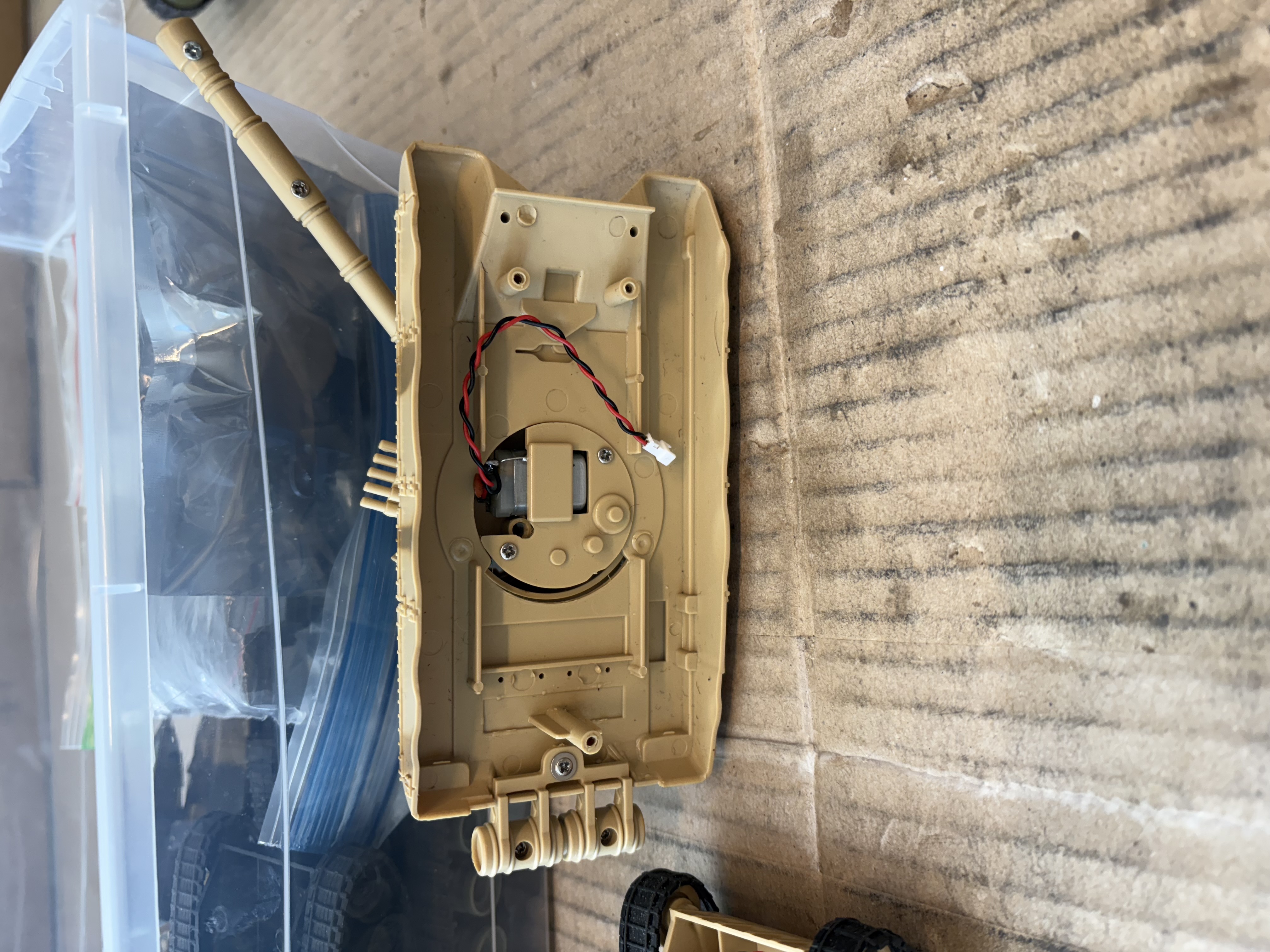

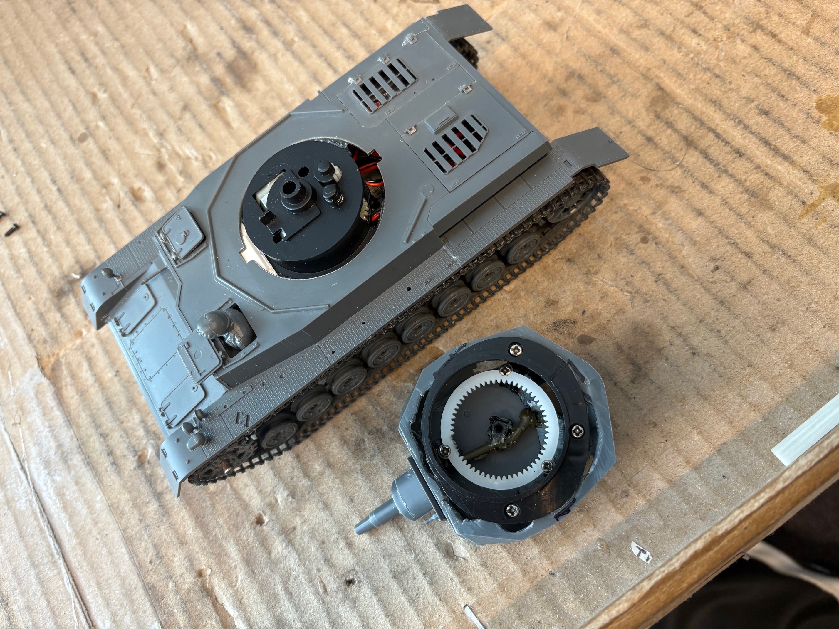

Turret traverse chassis attachment to upper hull.
This is a good model to motorize as it had the option from the factory.

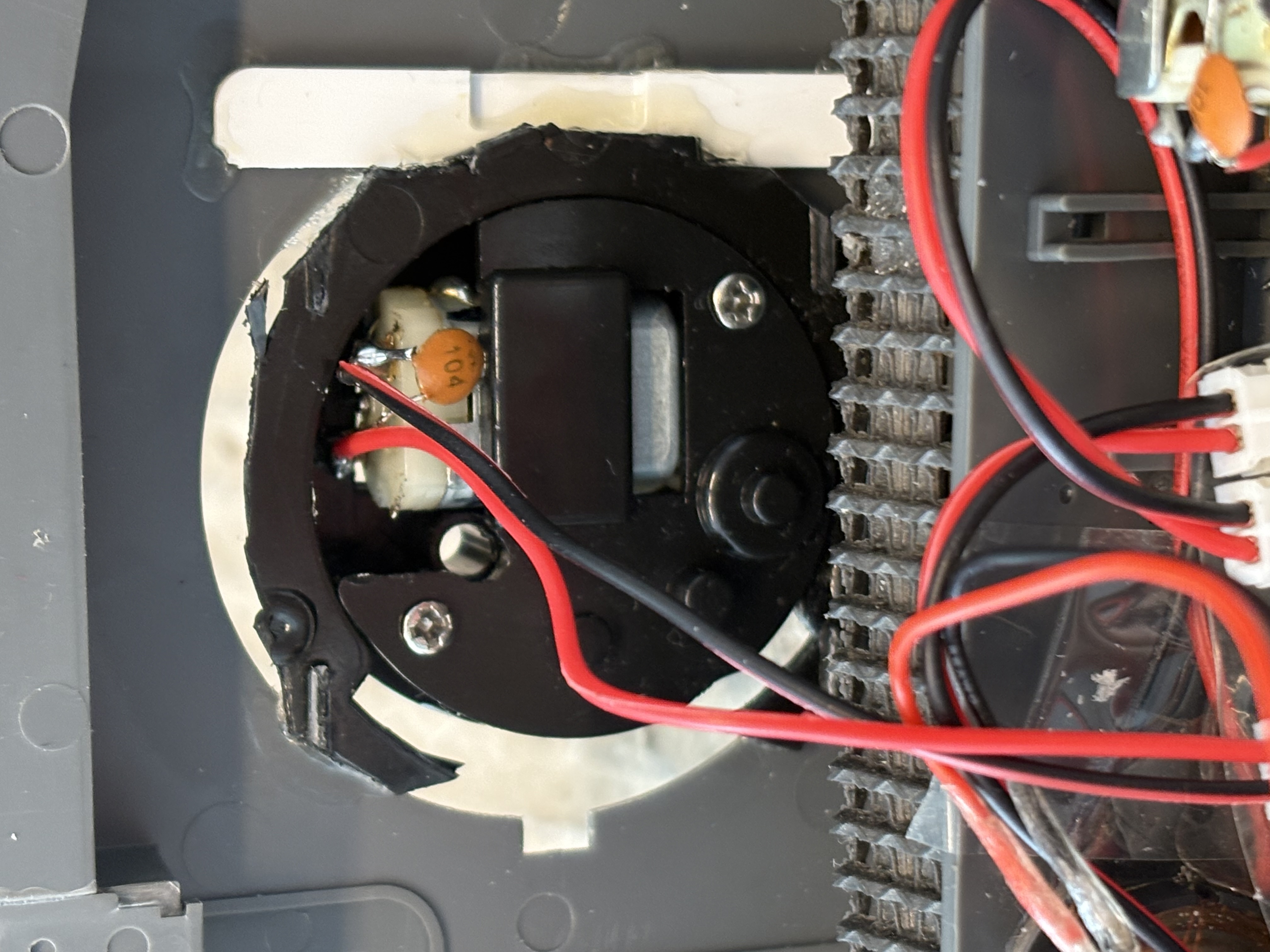

Added this turret traverse recently. I is proprotional speed and looks scale as well.

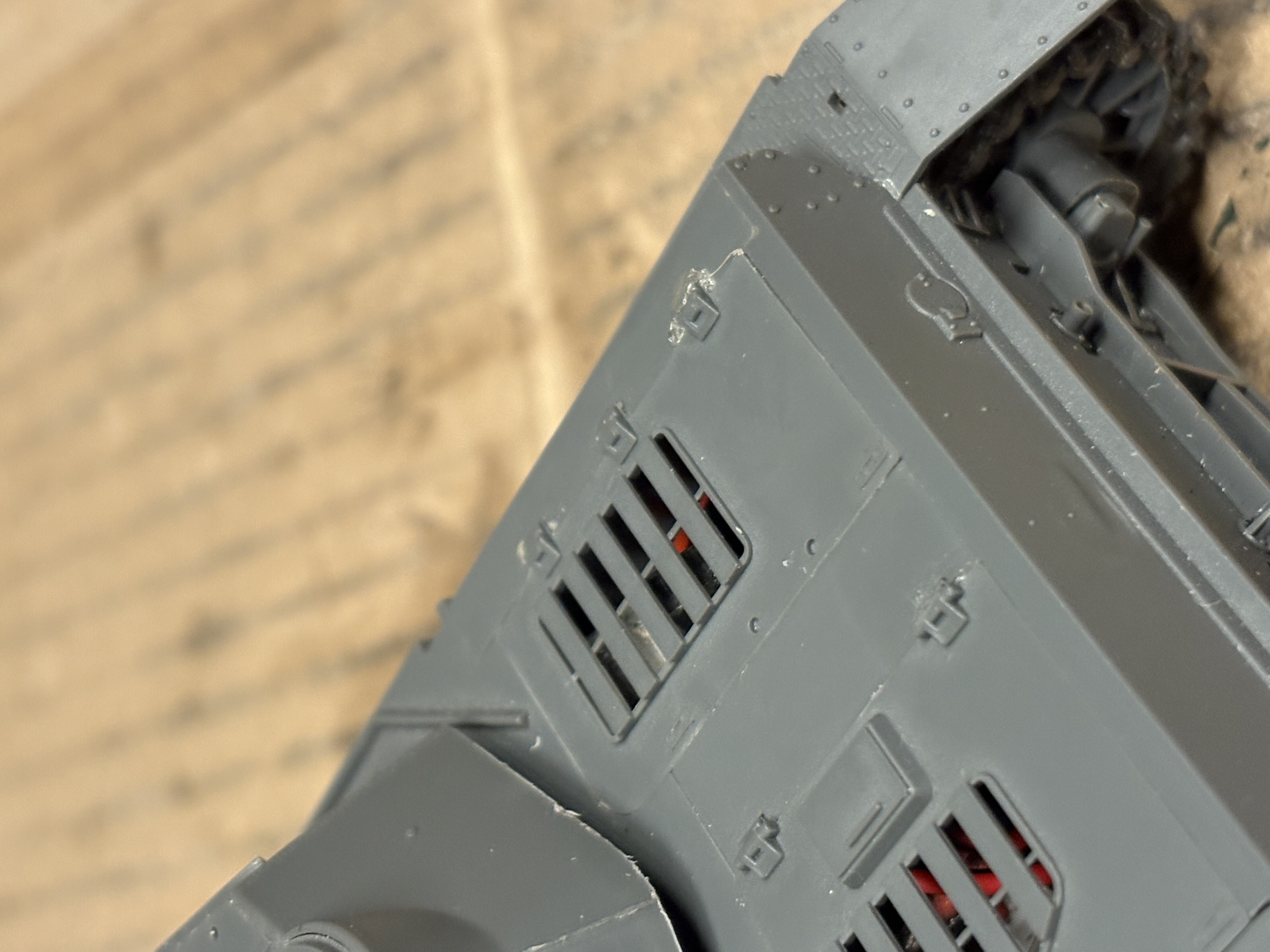

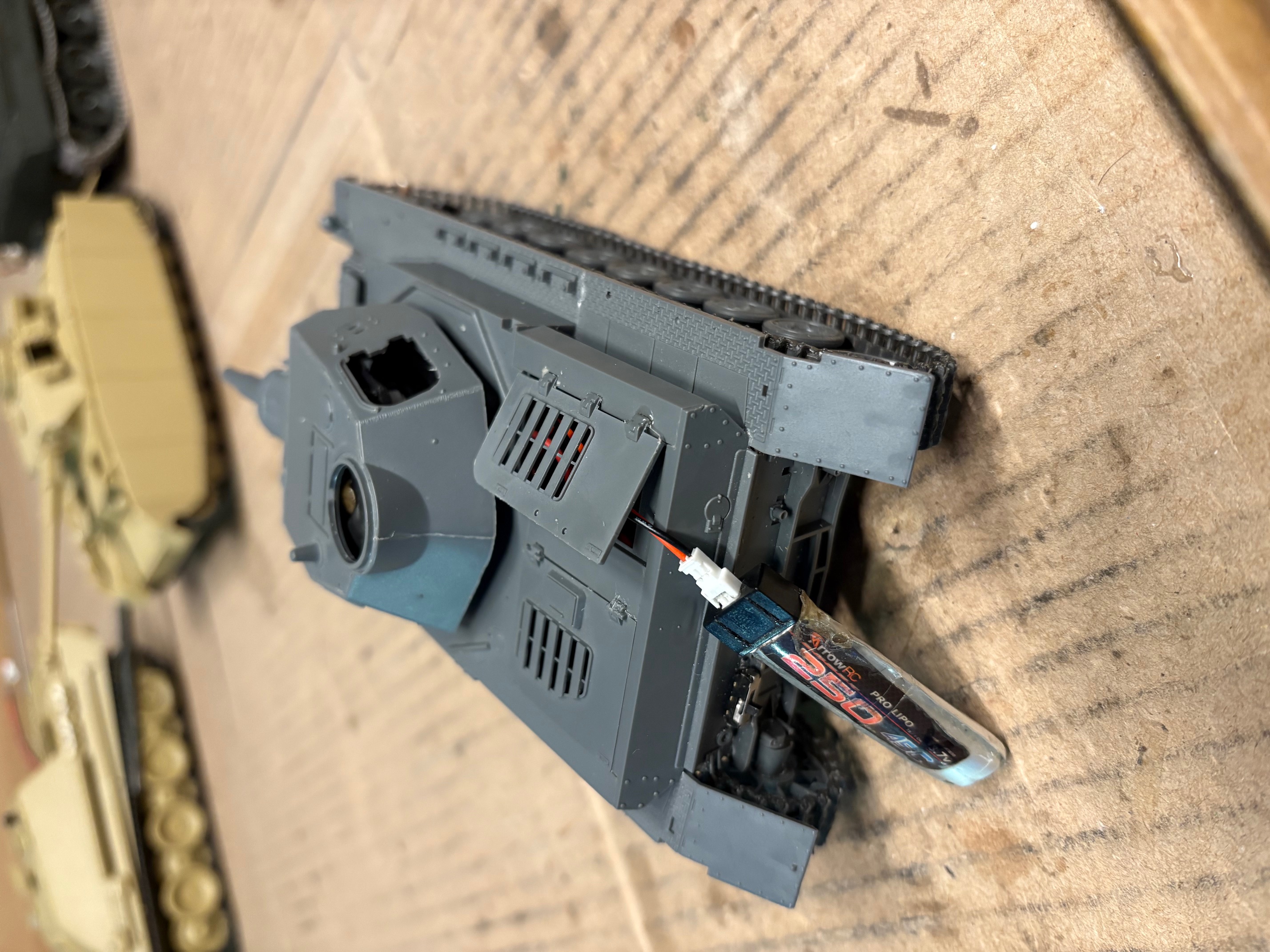

This Panzer IV has the same chassis as the motorized remote control version less the gearbox. These are the easiest ones to motorize.

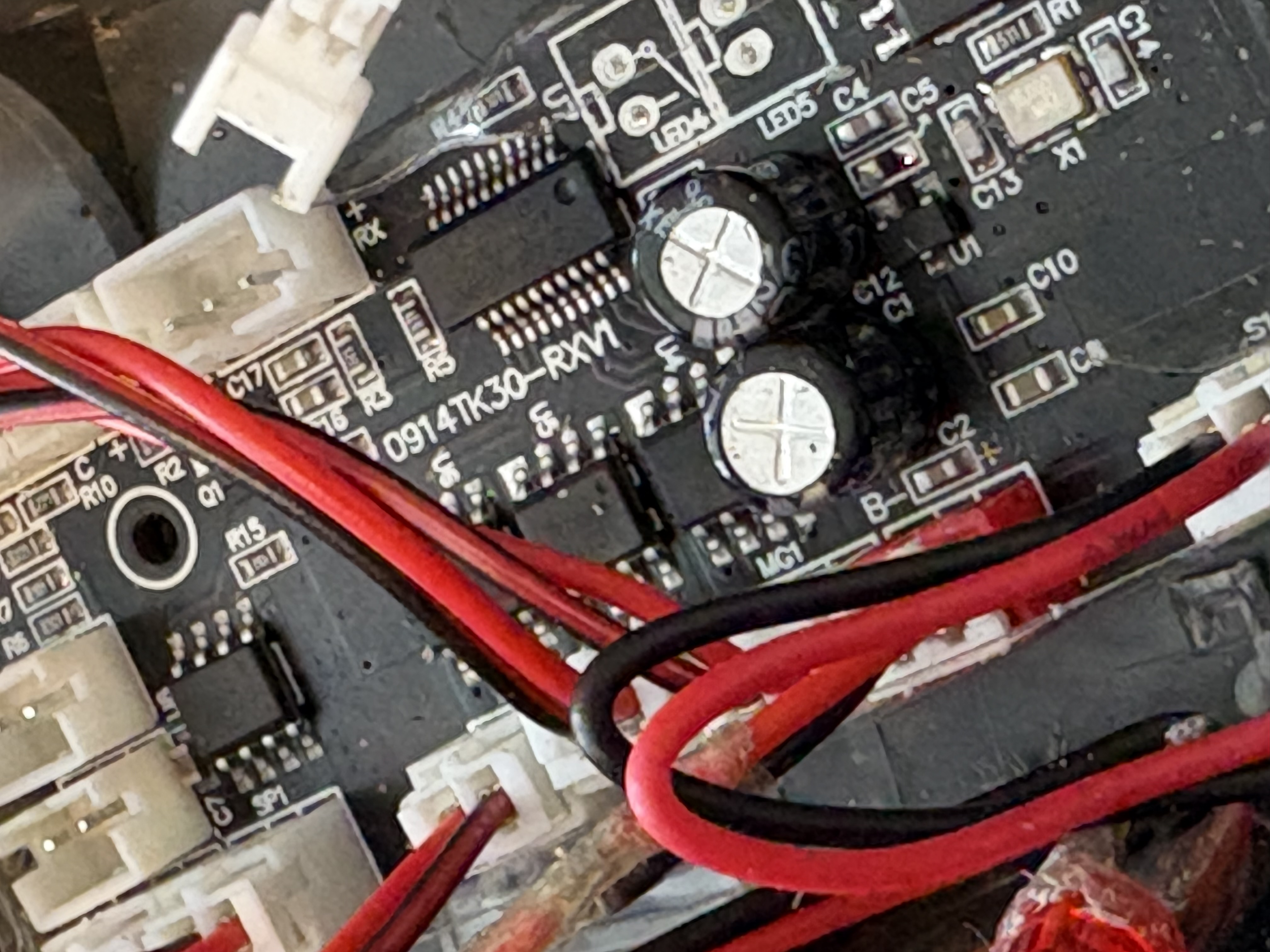

This Panzer IV will ultimately be a IR battle tank. Just need to add a IR emitter diode and 3 pin IR detector and maybe a 4 hit display with flashing defeat. (4 LED's). I use 1/30 Heng long RC models with TK-30-RXV1 circuit boards (Sherman, Pershing) as donor Tanks for these conversions.
There are four circuit HL boards available. I get mine from ebay or amazon.
1. TK-30-RXV1 = 1s lipo. use V1 Transmitter.
3. TK-24-RXV1 = 2s lipo. use V1 Transmitter.
2. TK-30-RXV2 = !s lipo. use V2 Transmitter.
4. TK-24-RXV2 = 2s lipo. use V2 Transmitter.

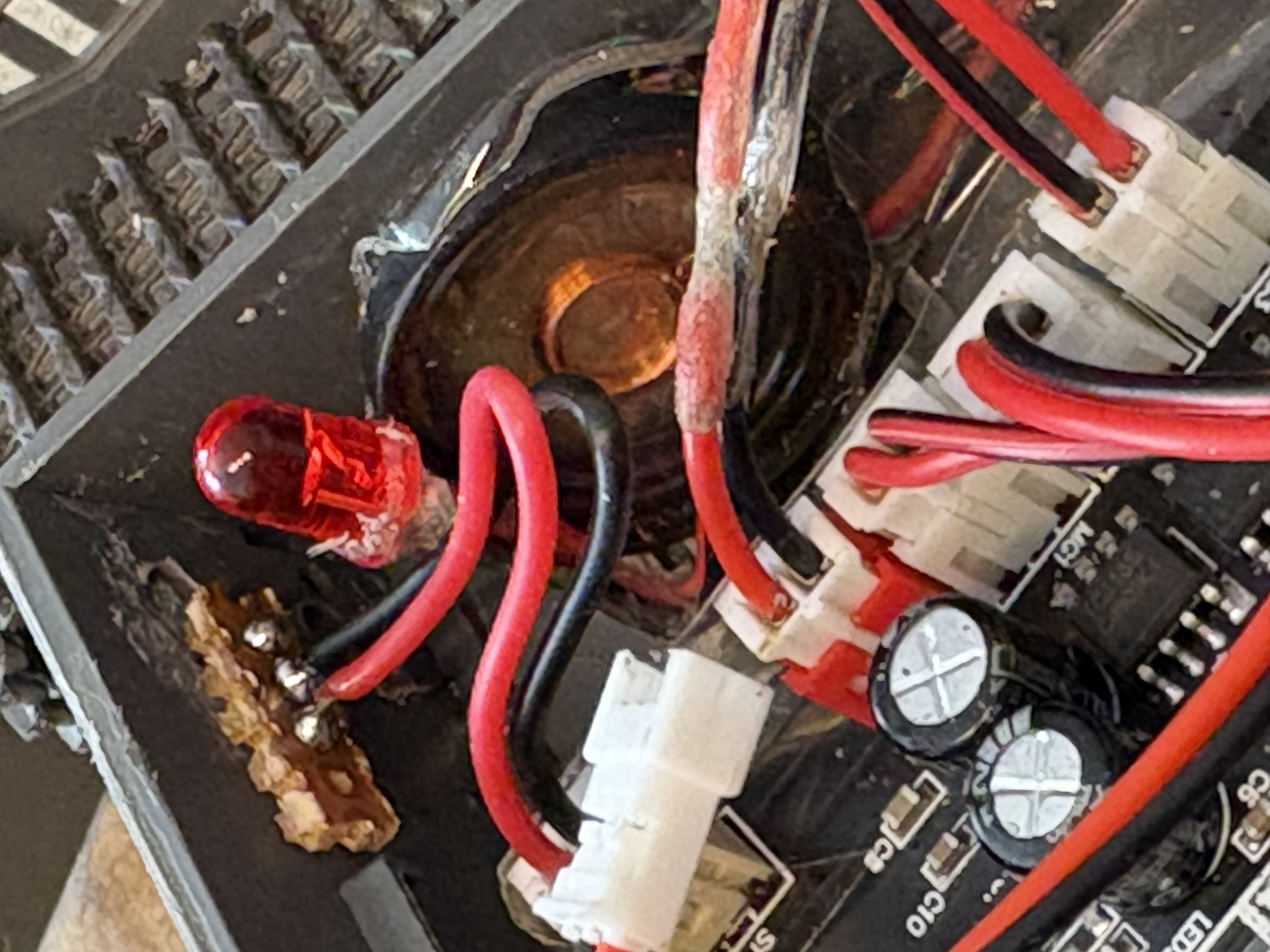

May replace this speaker soon as it is rattling and is worn out,

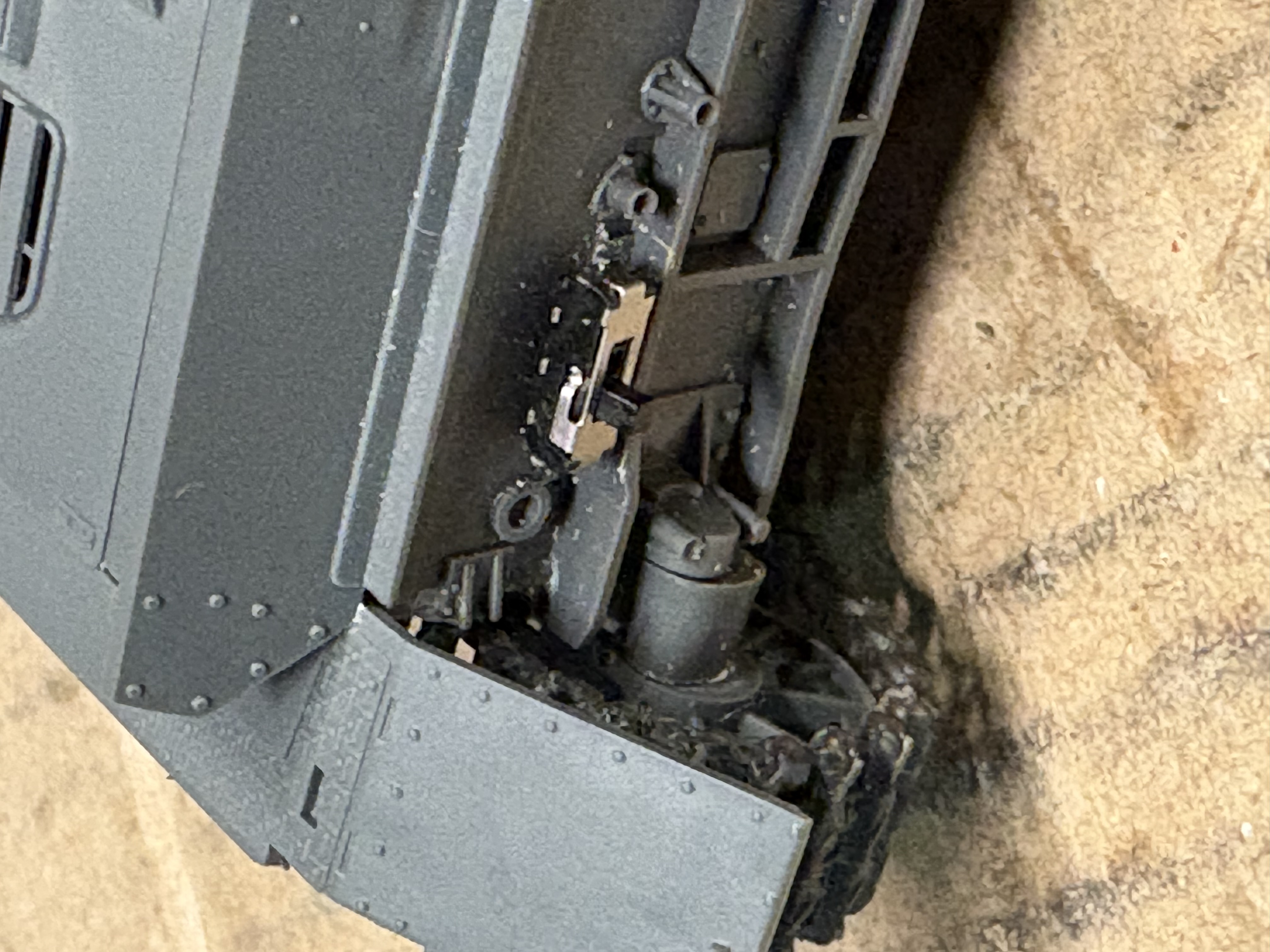

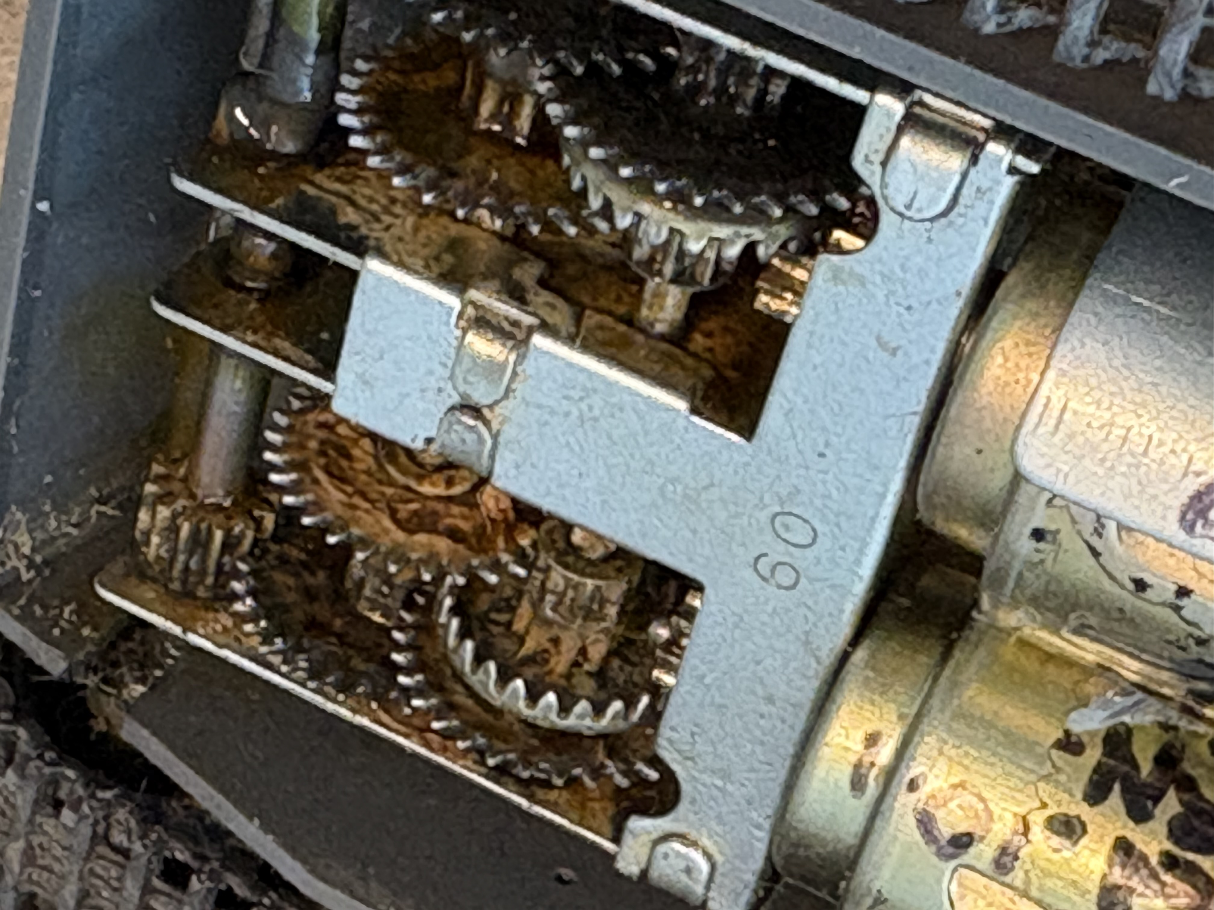

Gear box is from a Tamiya 1/35 M60 and is a good fit for this chassis. The axles are a bit longer and could be trimmed bit I have grown to like it as it is. I buy used M60 models to get this gear box as I like Panzer III and IV models.
This version (V1) has the best sound chip IMO.
Heng Long TK30- V1 circuit board used here.

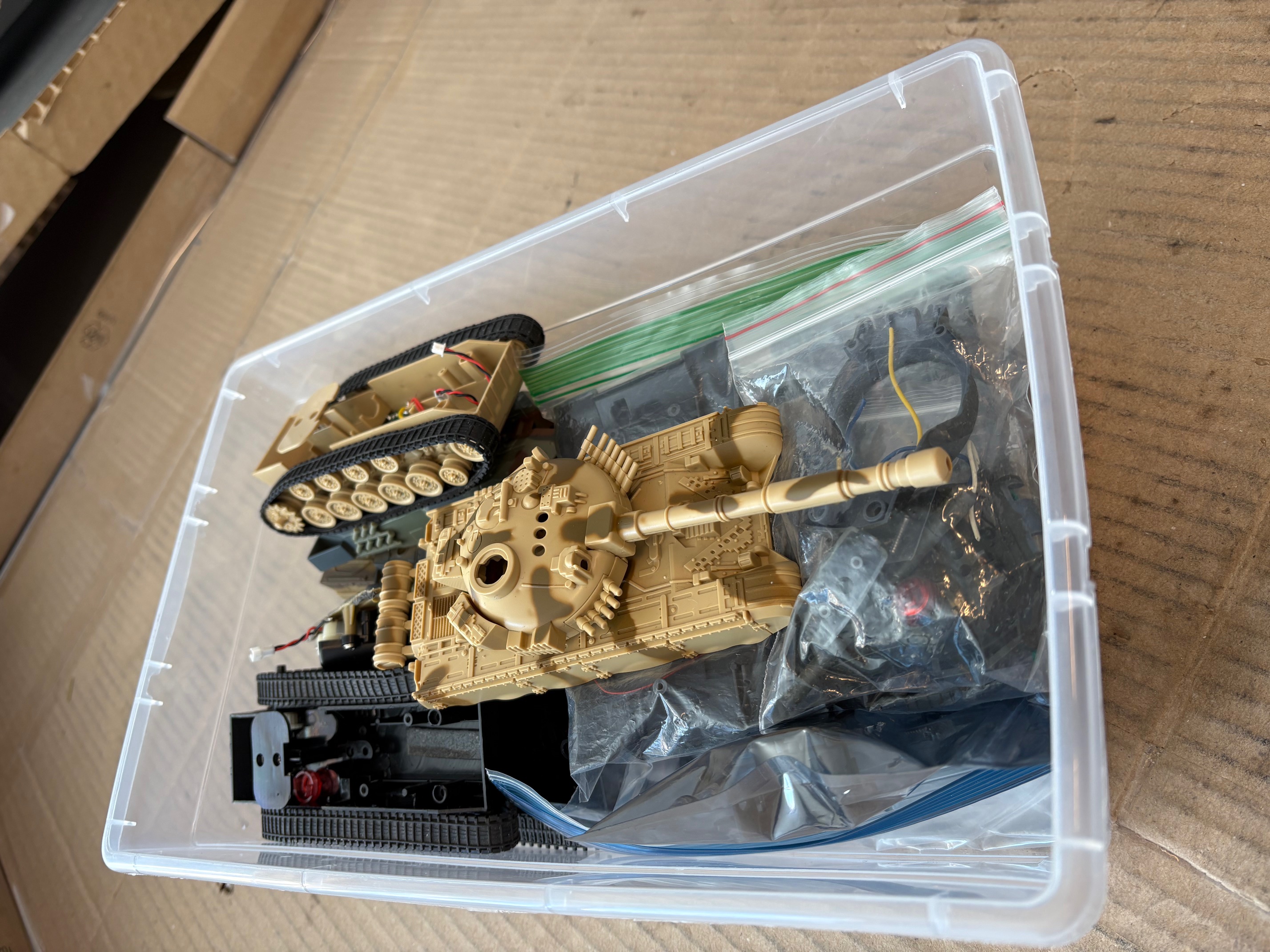

Ok I went all in on this turret upgrade. This is the 3rd 1/35 model that has been converted. I have a junkyard of older tanks that I use for parts.
Salvage yard of parts in a box.
bottom side of turret platform
not sure of the exact scale of these Lazer Force RC IR battle tanks. They do make good parts for 1/35 models.
