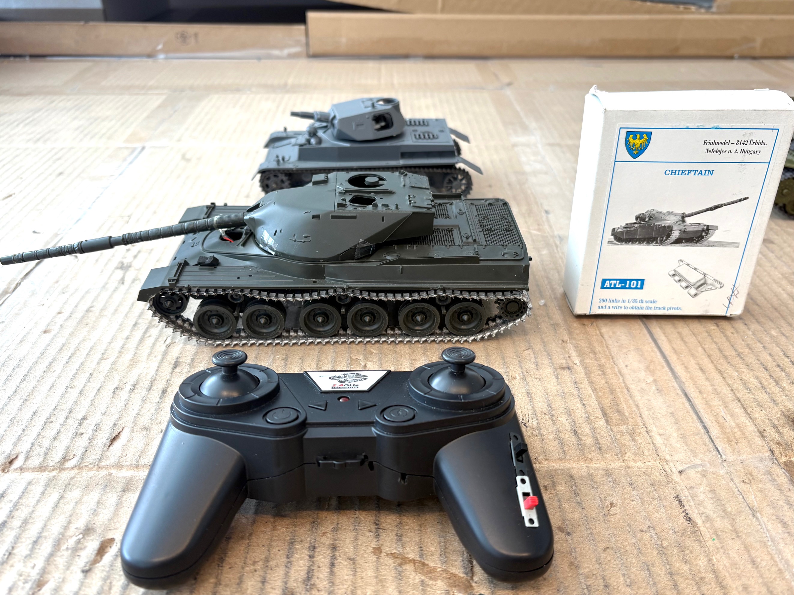

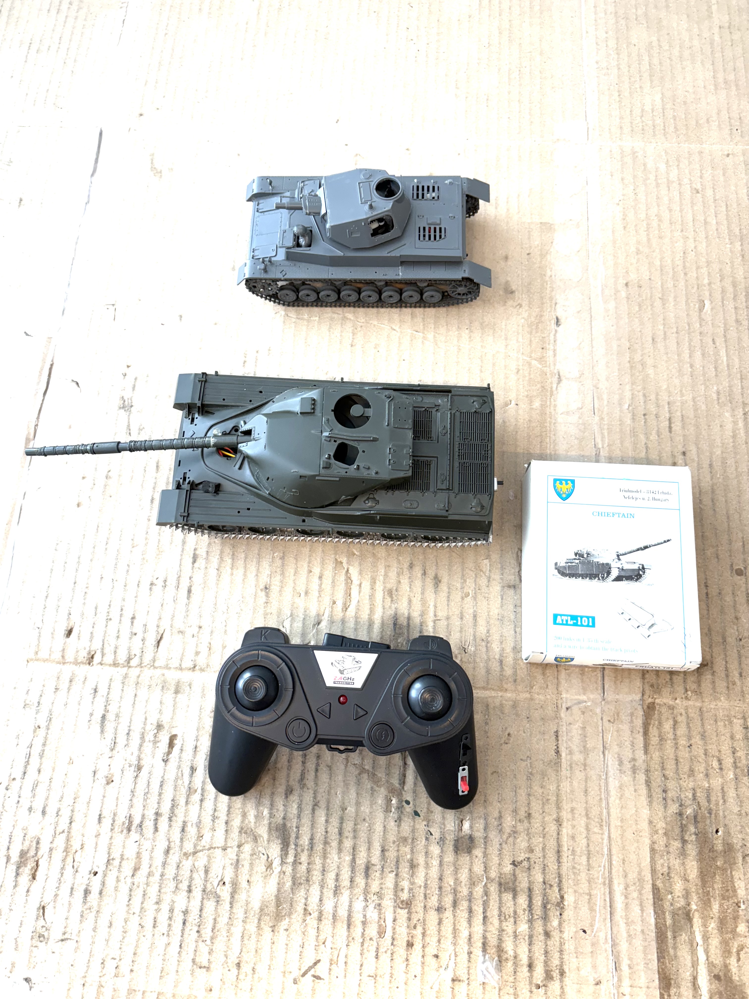

Yes, the model you mention has Fruialmodel metal tracks. It is a 1/35 Tamiya (1975) Chieftain Mk.5 motorized remote control version. It is also a scale runner with a modified Taigen Transmitter. I bought the Chieftain from a chap in Britain a few years ago via ebay. It was new in an unopened box. I will do a thread on that one soon.
Experiments in Transmitter modification of speed set control.
Here are a few of my GWS RC planes. I have actually used RC plane electronics in RC tanks because I have so much of it not being used anymore.
Taigen Transmitter modification for this model. I will soo be doing a simplified modification using a new Taigen Transmitter.
