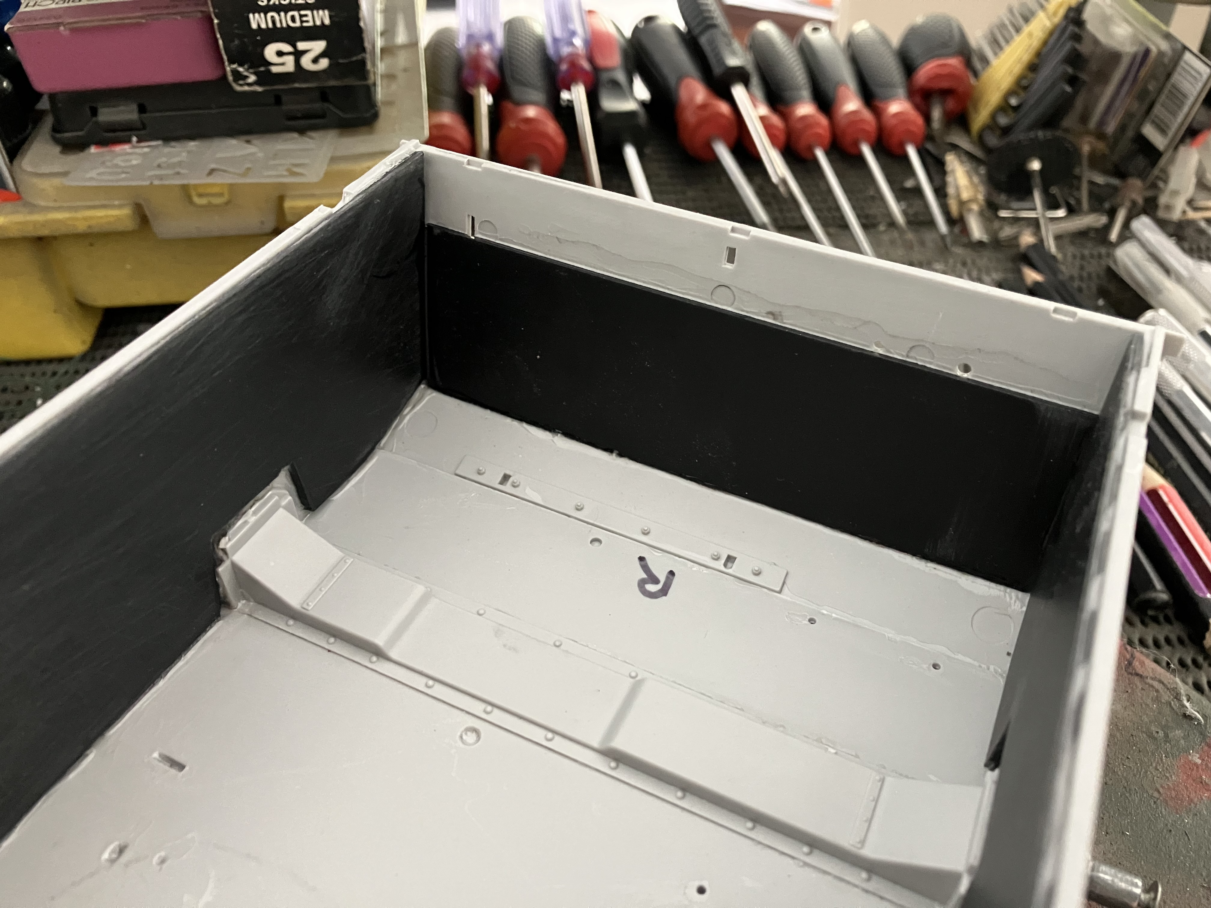

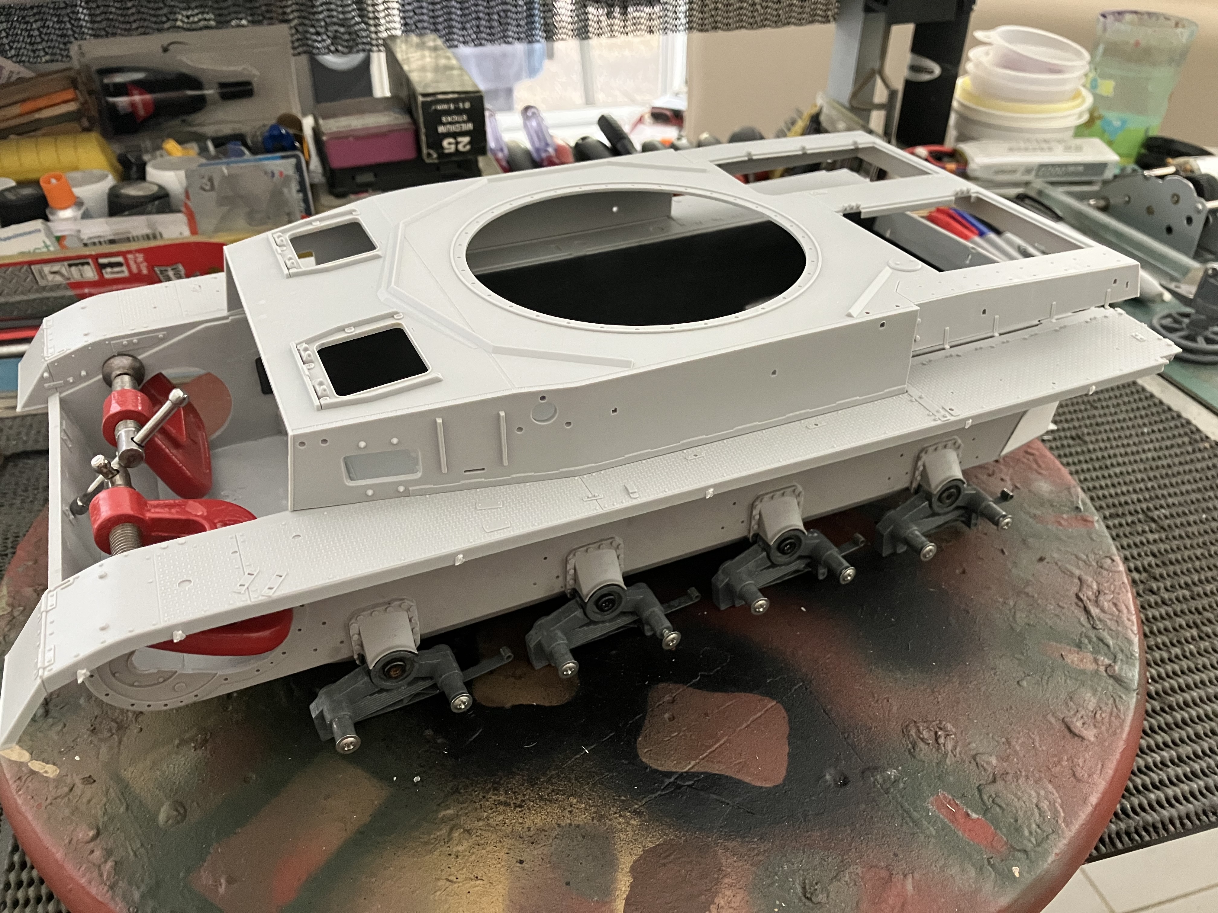

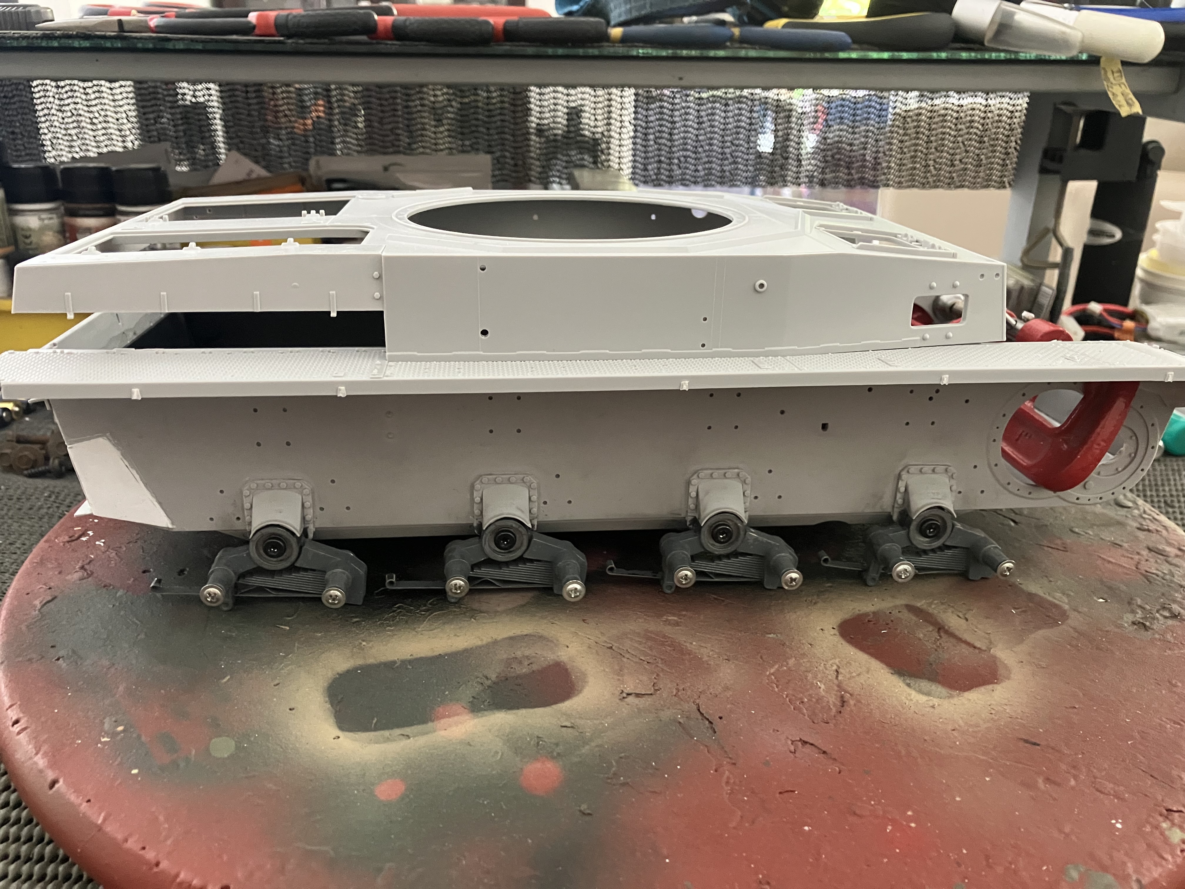

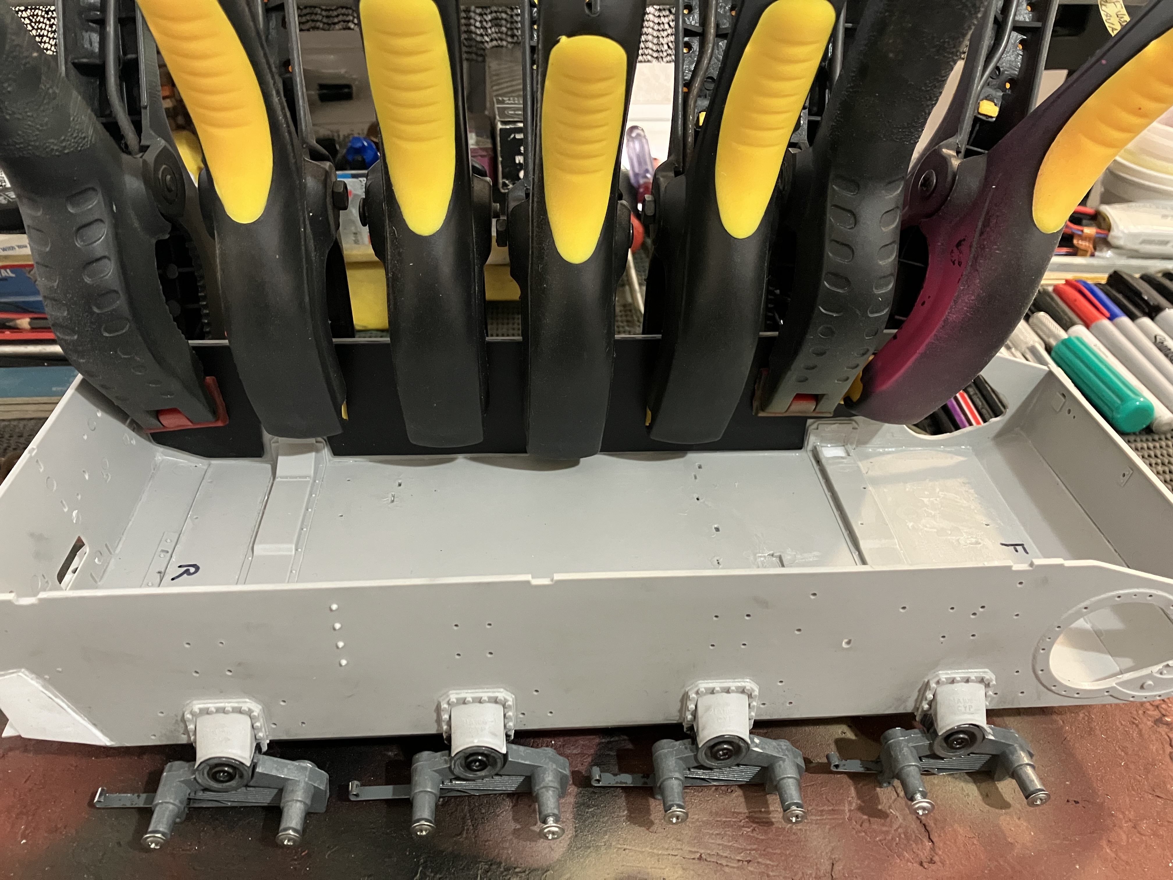

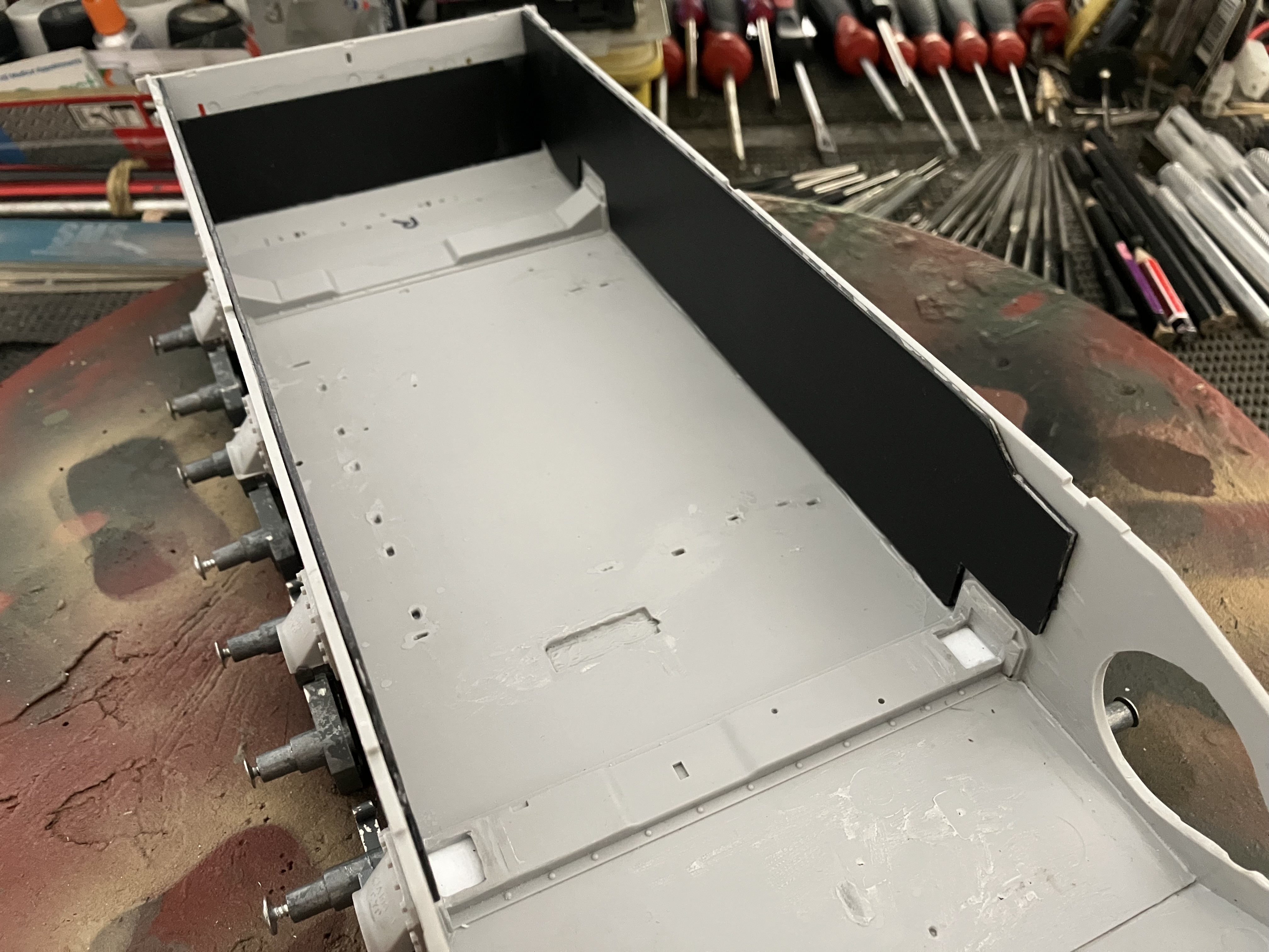

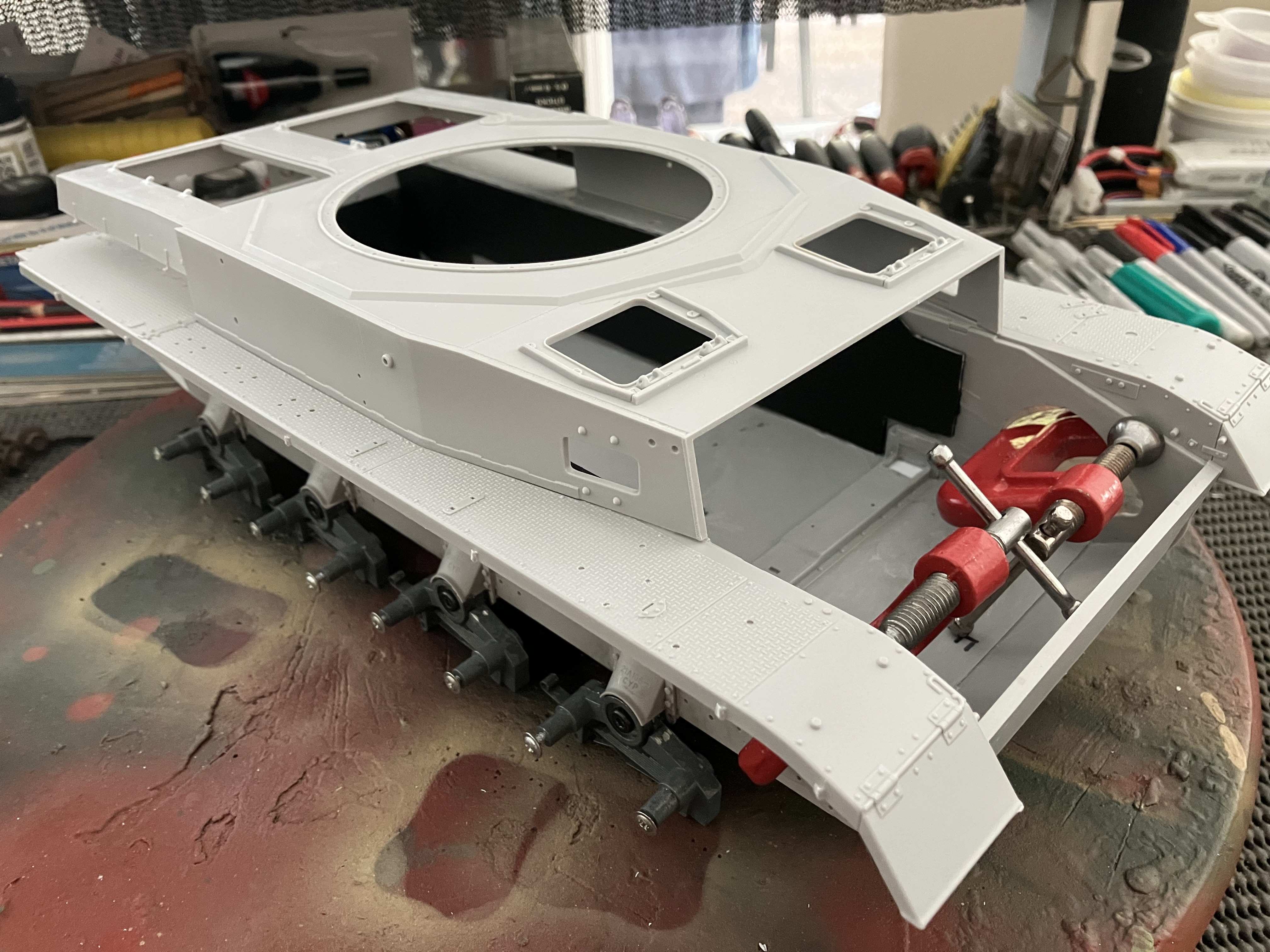

This is still happening folks, albeit a tad slow.
Got the metal suspension arms attached onto the trimmed Trumpeter stations & they are pretty solid & in-line!
Some dressing of the metal components was required, and a lot of pencil graphite to assist in their free oscillation ( got to be word of the day that-surely
Seems to be ok.
The Trumpeter floor was cemented in & that added a lot of rigidity to the lower hull.
I also bunged on the side reinforcement panels from 2mm Evergreen(thats actually black, not green, which its not easy being-but thats another story
Once I have added more Evergreen (see above description) to the rear panel, I can get the idlers fitted.
THHHHHEEEEEENNnnnnnnnnn...........I can get the gearboxes in place & shimmed to match the track run.
Mission............NOT Impossible
Seems to be ok.
