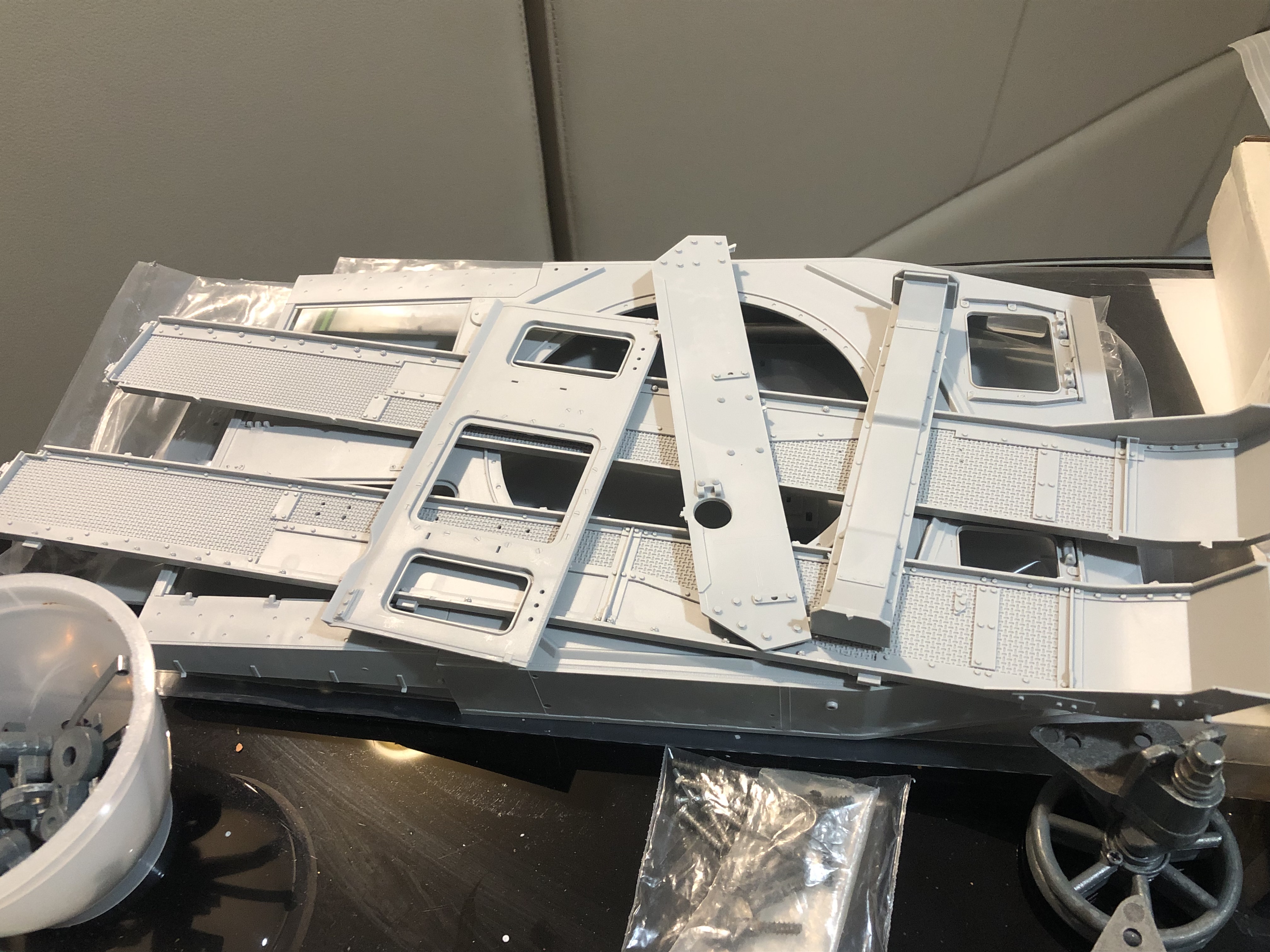

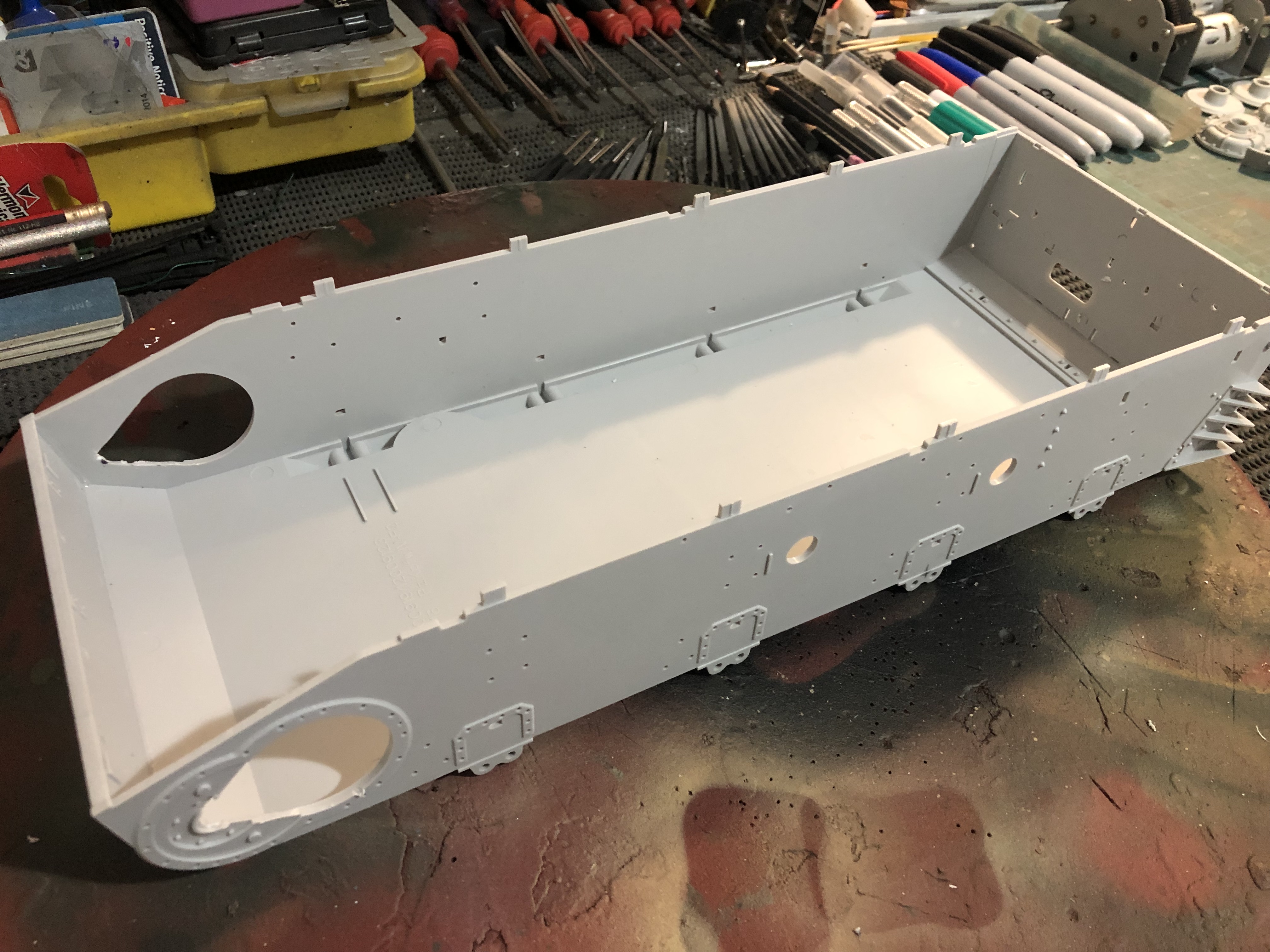

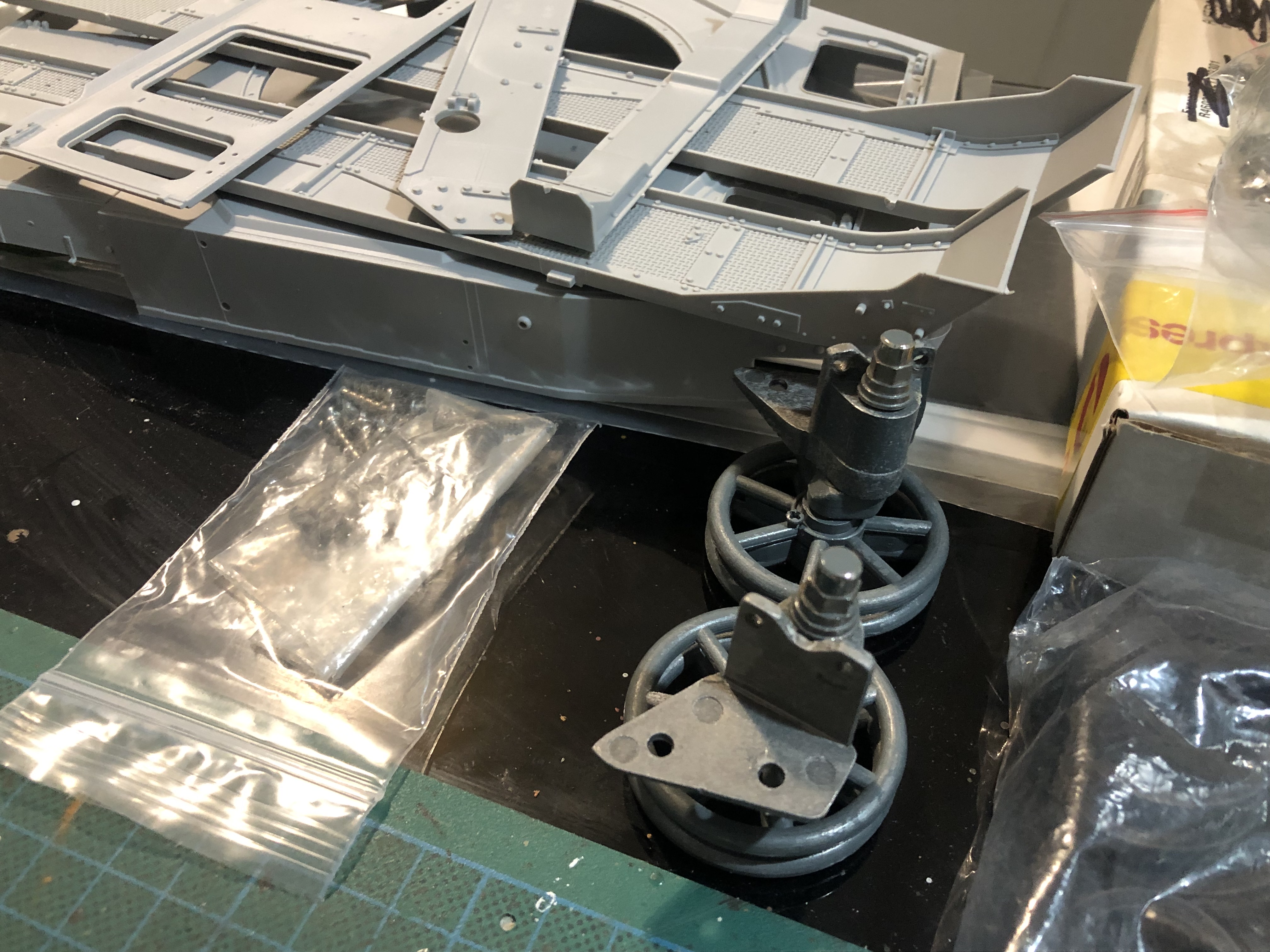

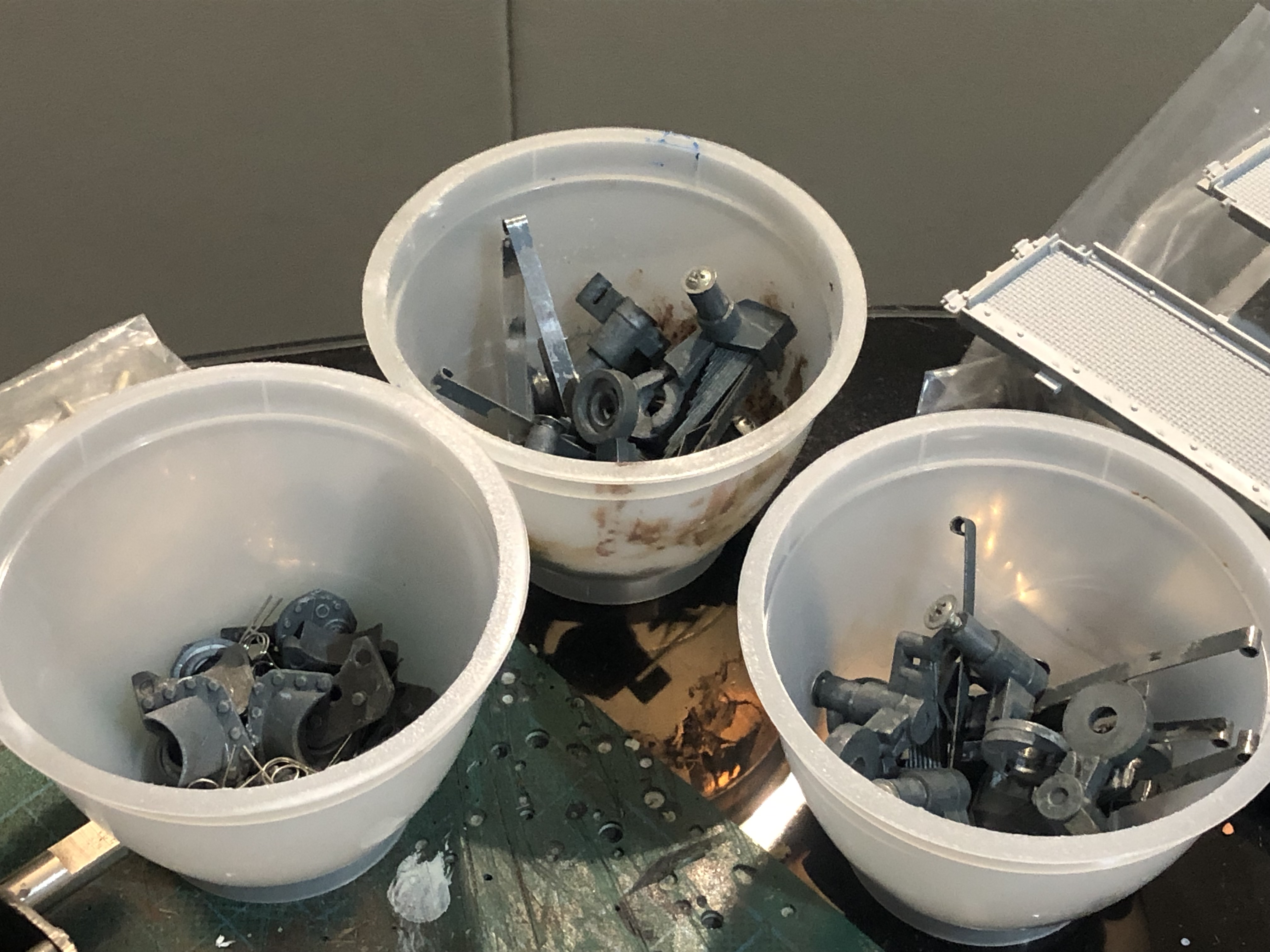

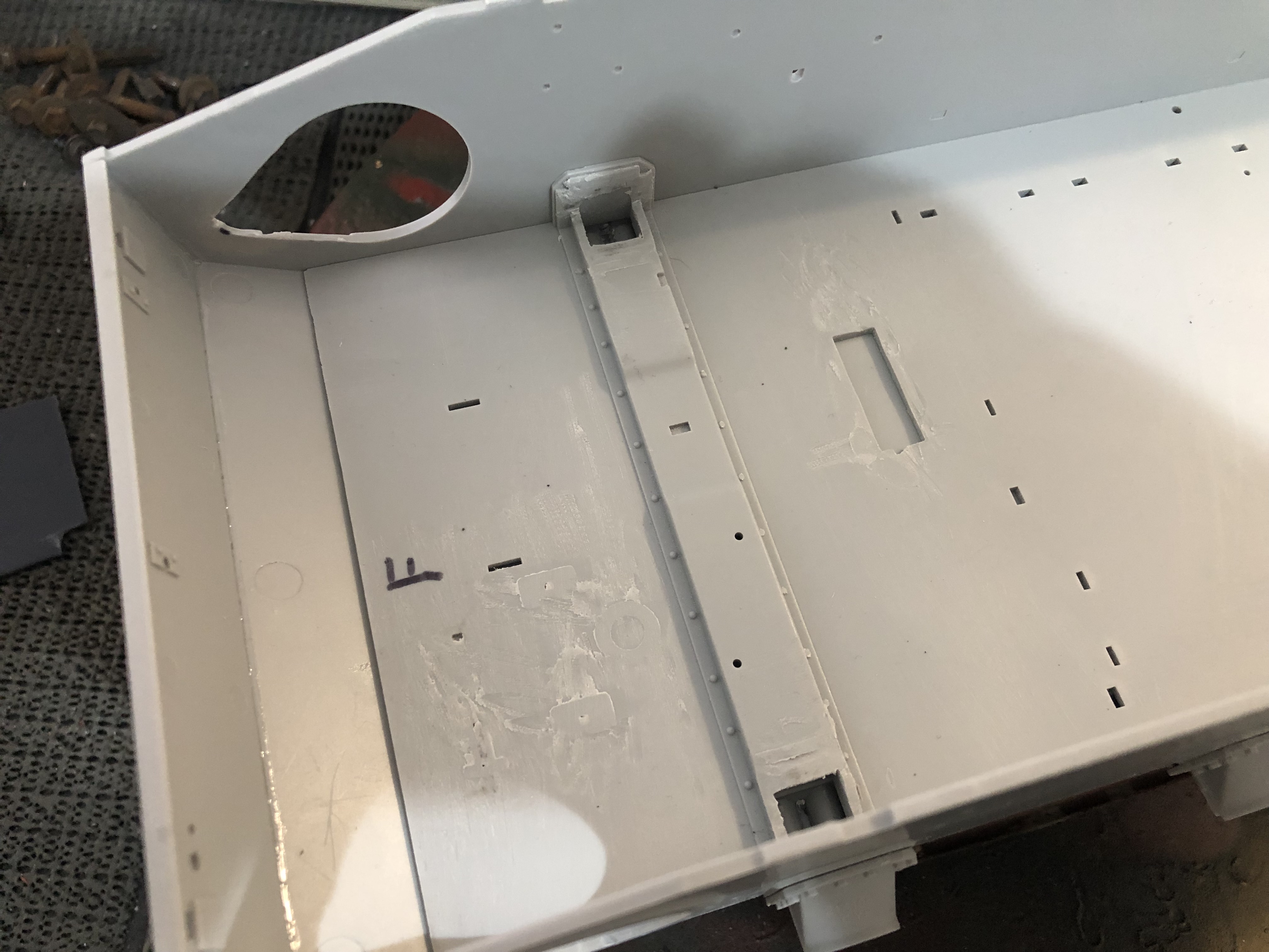

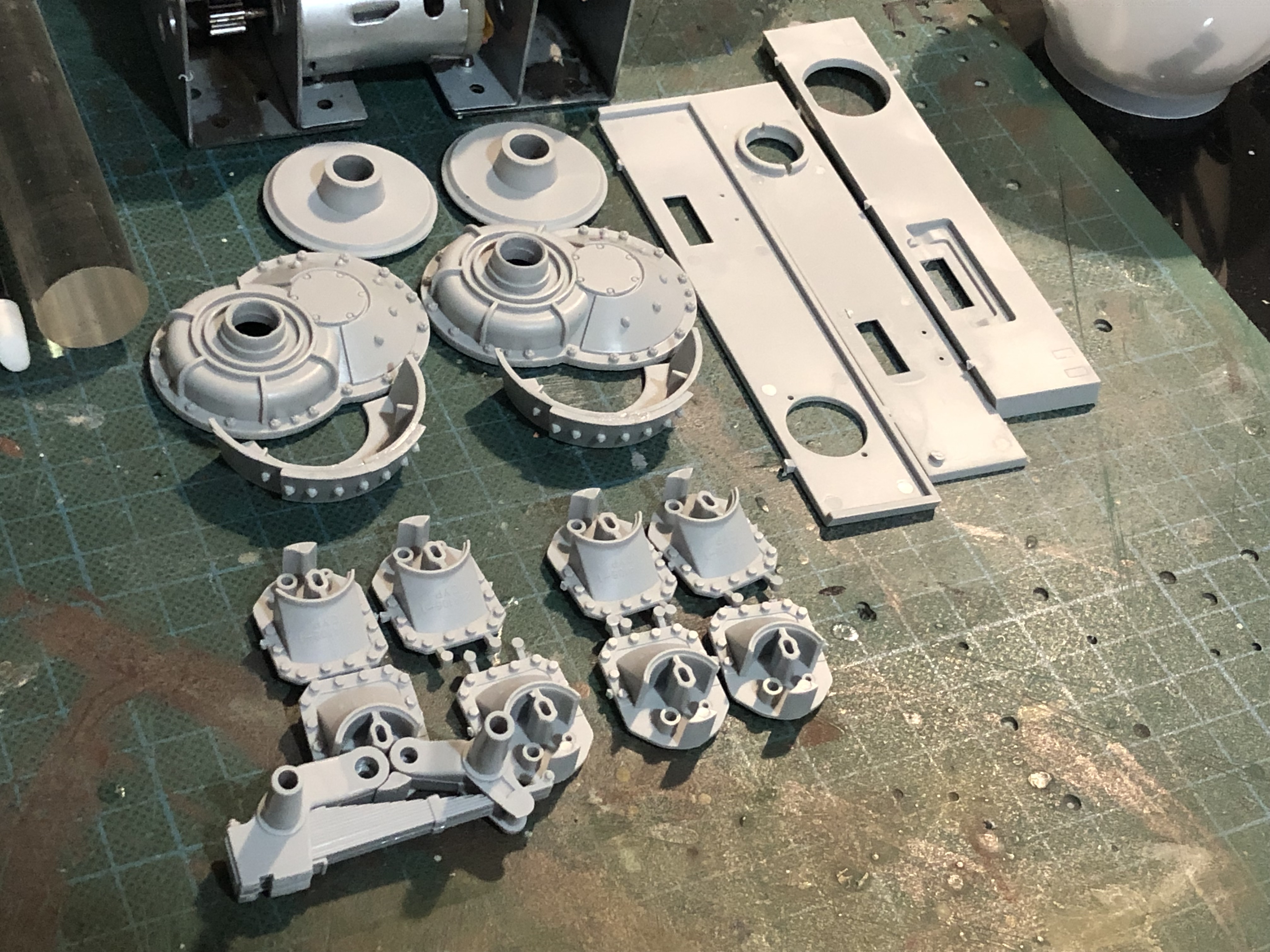

To get the thing actually moving there has been a lot of minor stuff done to enable the bigger stuff to progress.
- Rear plate idler gussets ground off.
- Rear plate idler placements had shim material added.
- Front drive hull penetrations opened up for the gearboxes.
- Suspension assembly made up for one station to check positioning & centerline for correct track & gearbox alignment.
- Trumpeter suspension pivot cover & fastening points modified & drilled for accepting the new pivot axle.
- Internal floor plate that Trumpeter provide to mount all the internal features cut & to be used to stiffen the hull and assist with gearbox mounting hardpoints.
- Side hull reinforcement plats made out of 2mm styrene which will be added to the Trumpeter walls for increased rigidity.
- Suspension pivot points to be filled with (something
) to assist the new axles to retain.
Long long way to go, but its taking shape.
