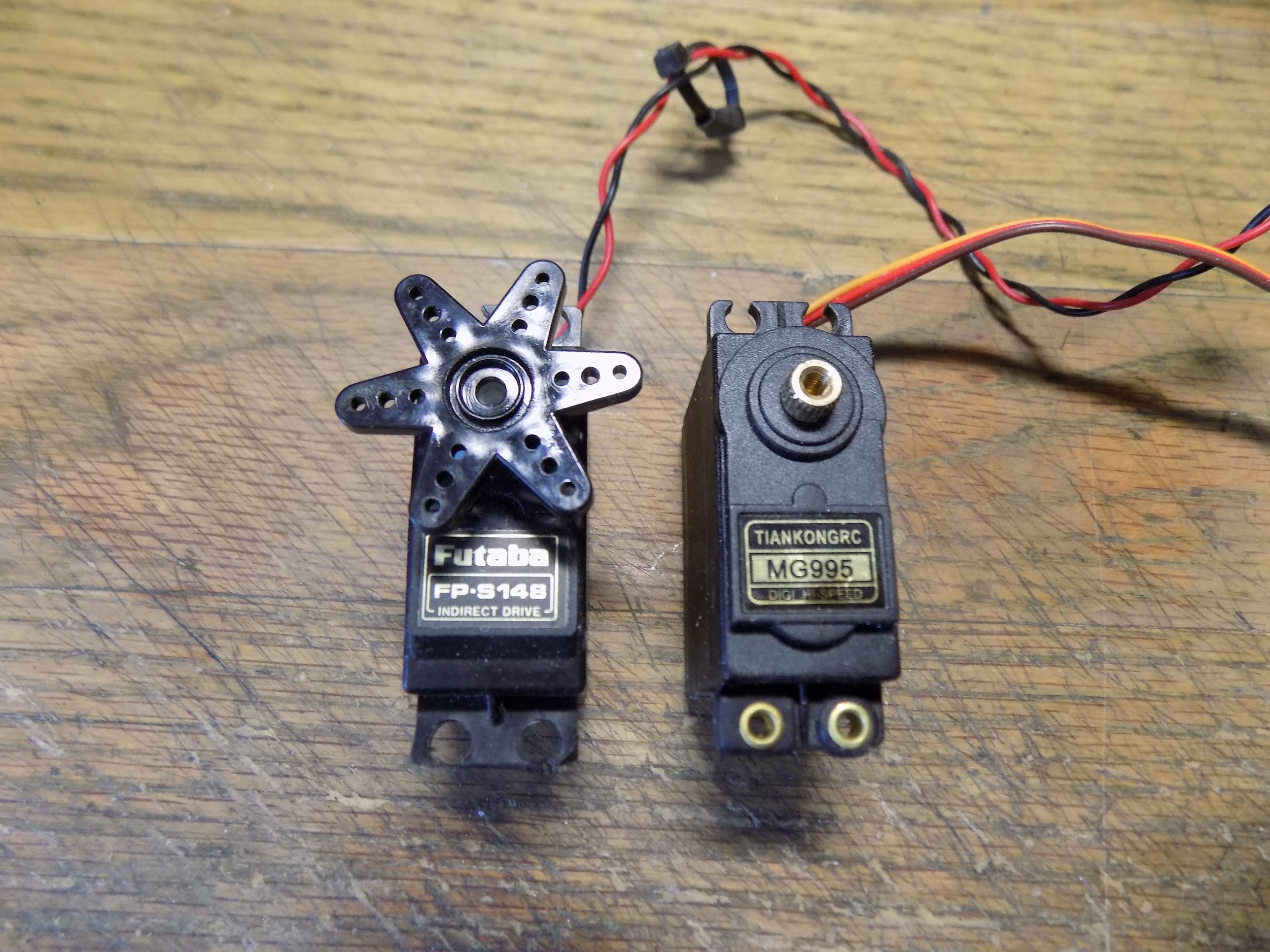

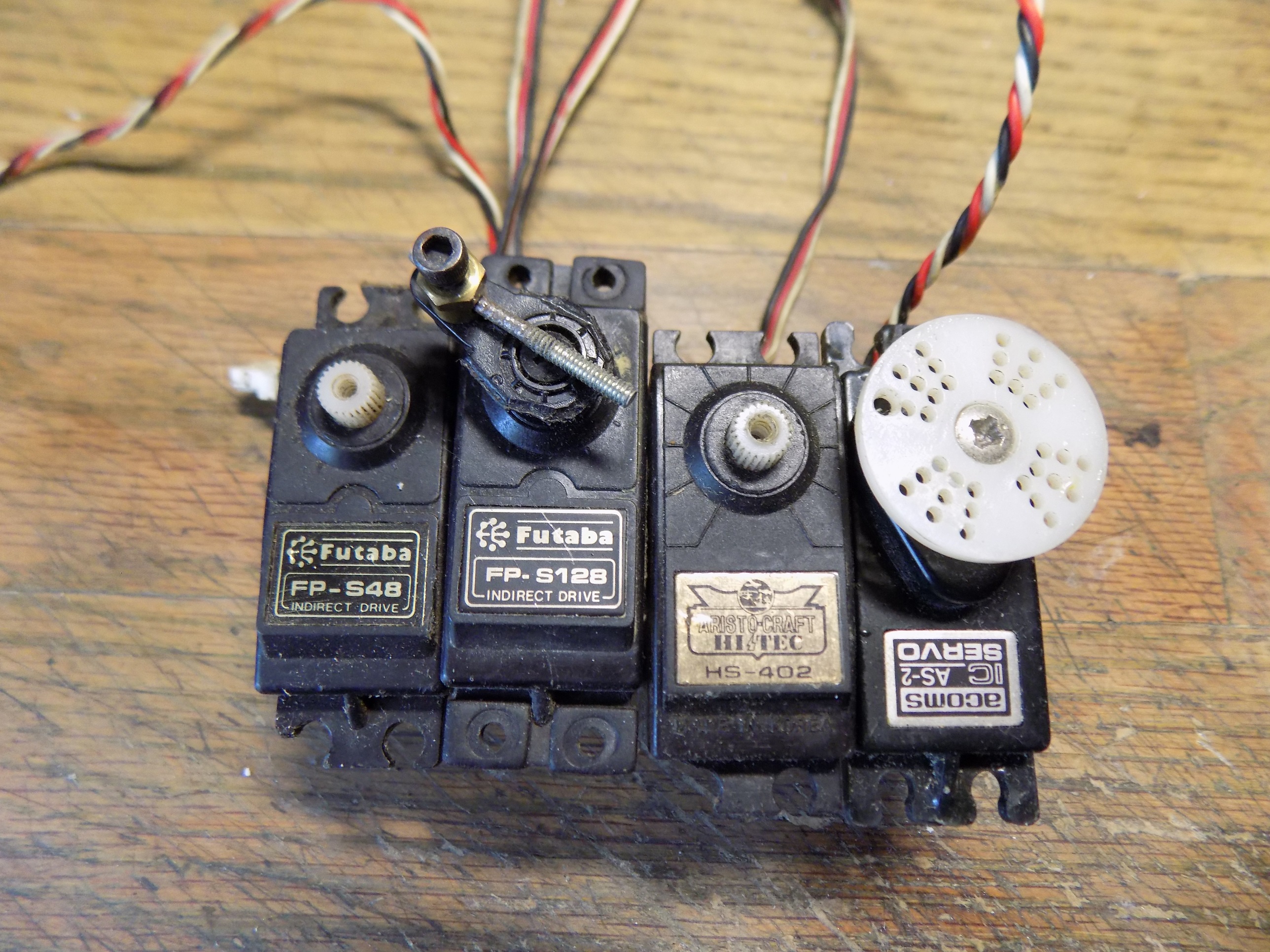

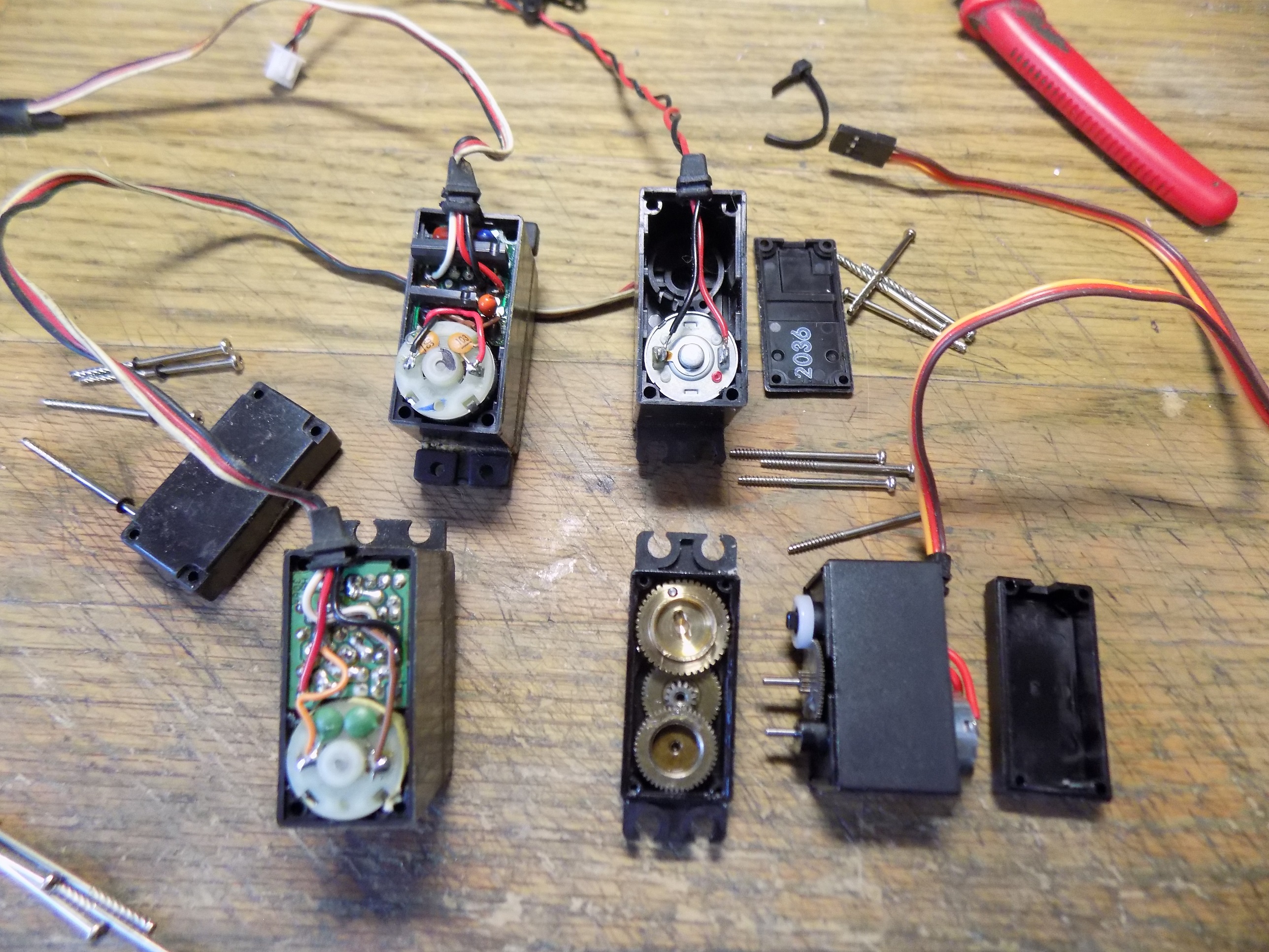

Old servos from the eighties and 90s.
One of the old ones along with a newer digital servo on the right (5 pack for $25 USD off Amazon).

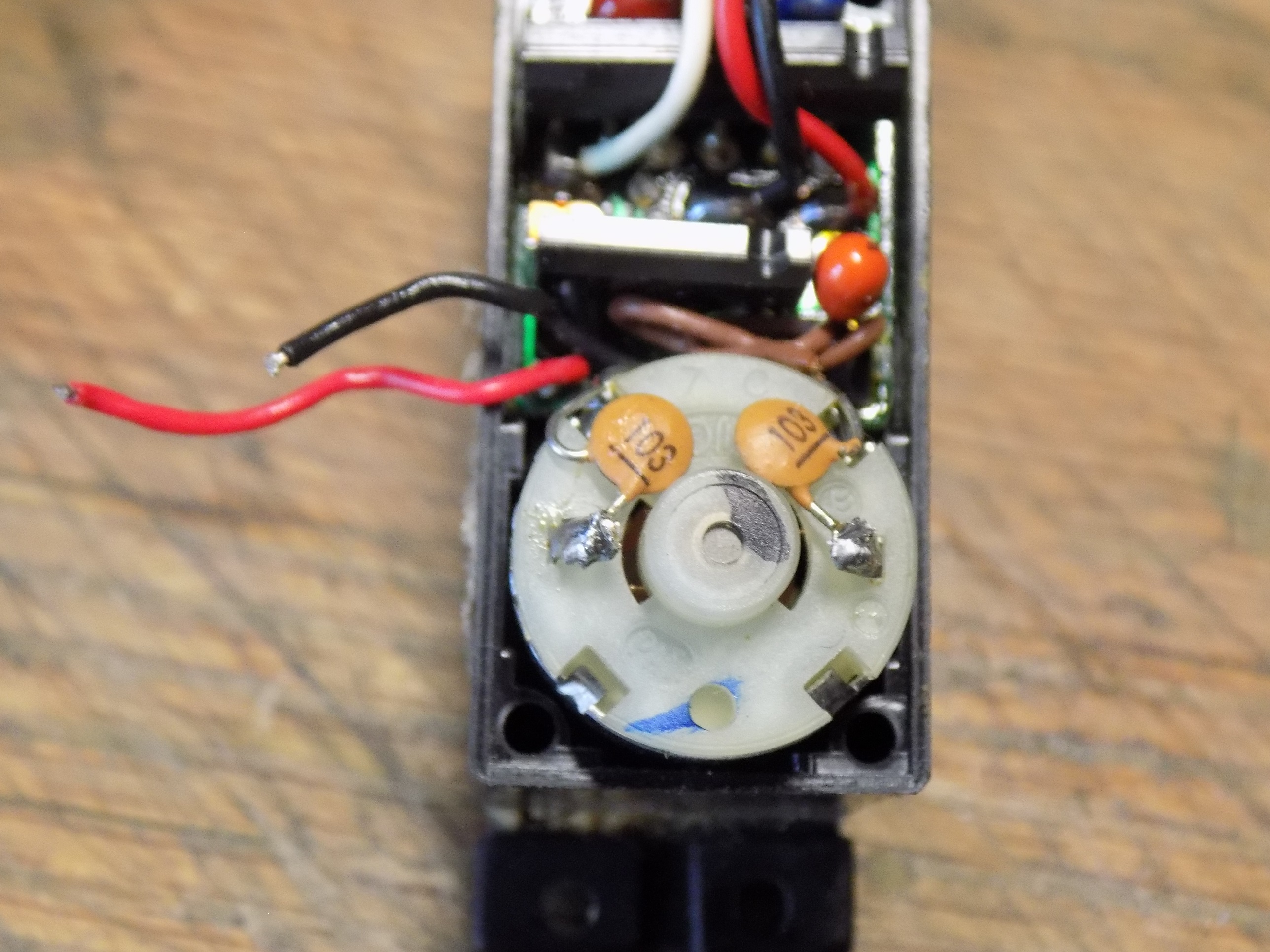

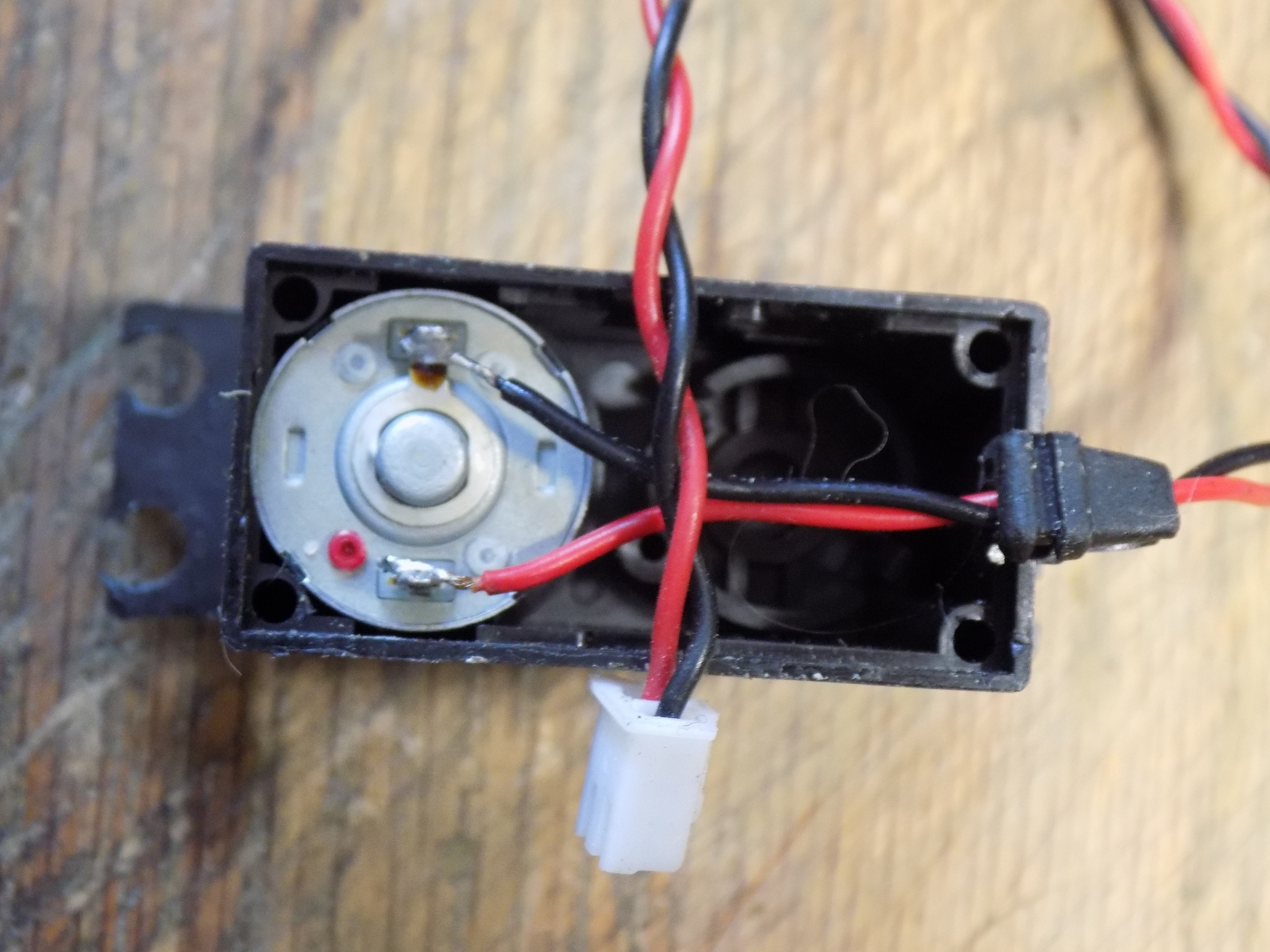

The Heng Long MFU ports for the airsoft, barrel lift and turret turn are all on off. The Tamiya lift and spin are proportional. Simply remove the circuit board from the servo along with it's power lead. Run a HL or Tamiya lead from the appropriate port on the MFU and solder leads directly to the servo's motor.

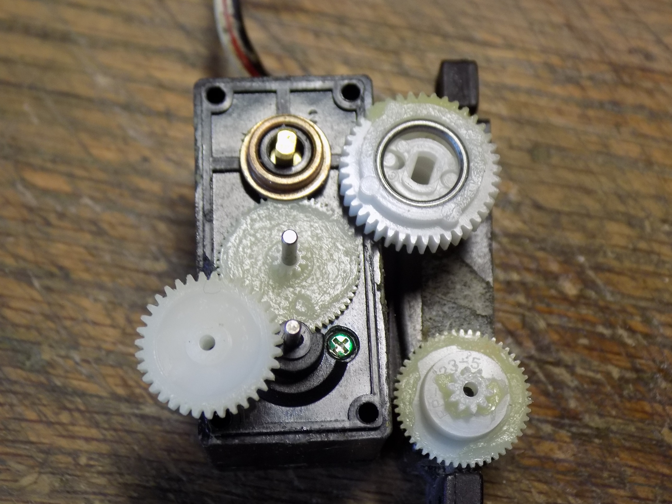

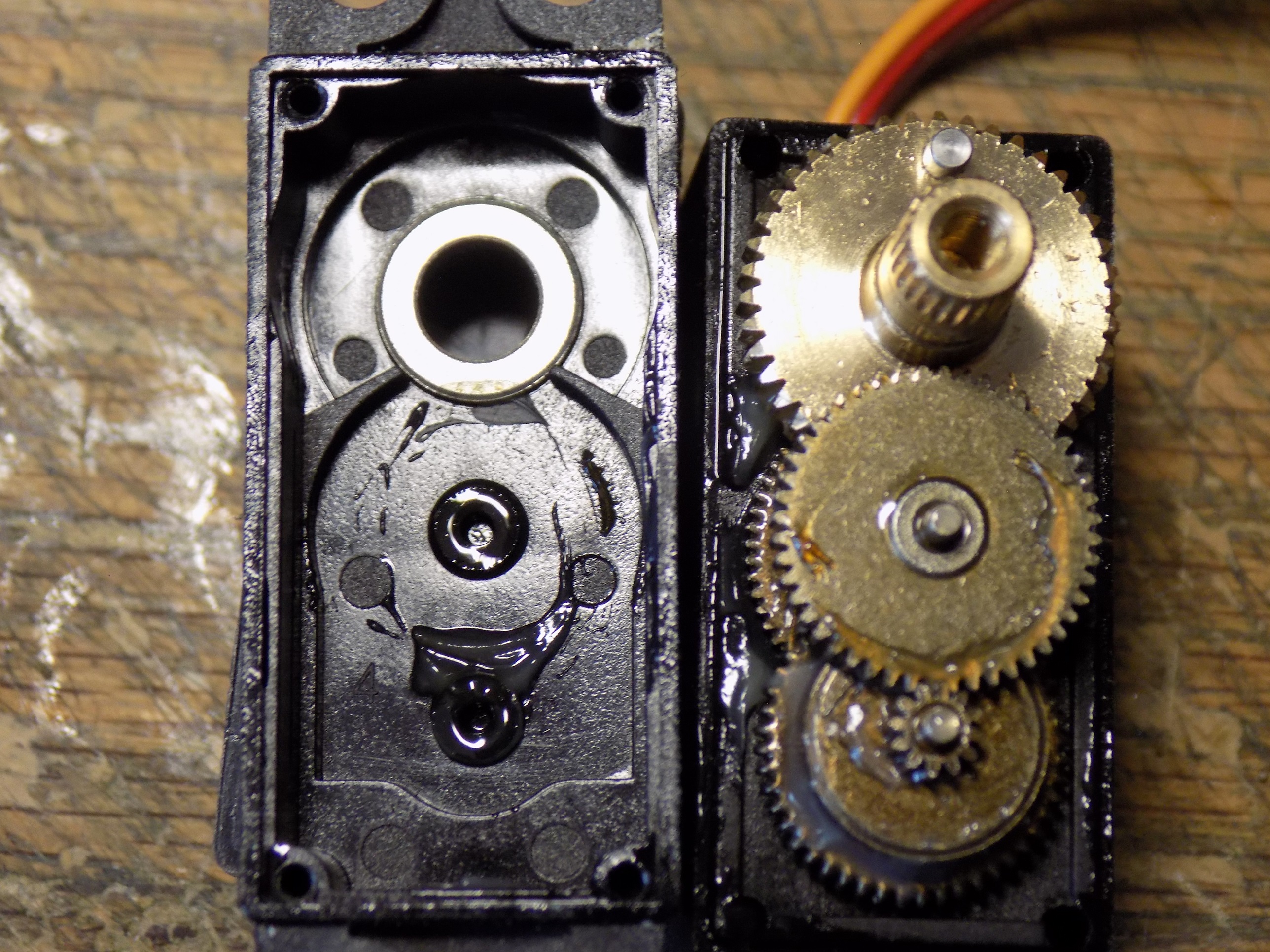

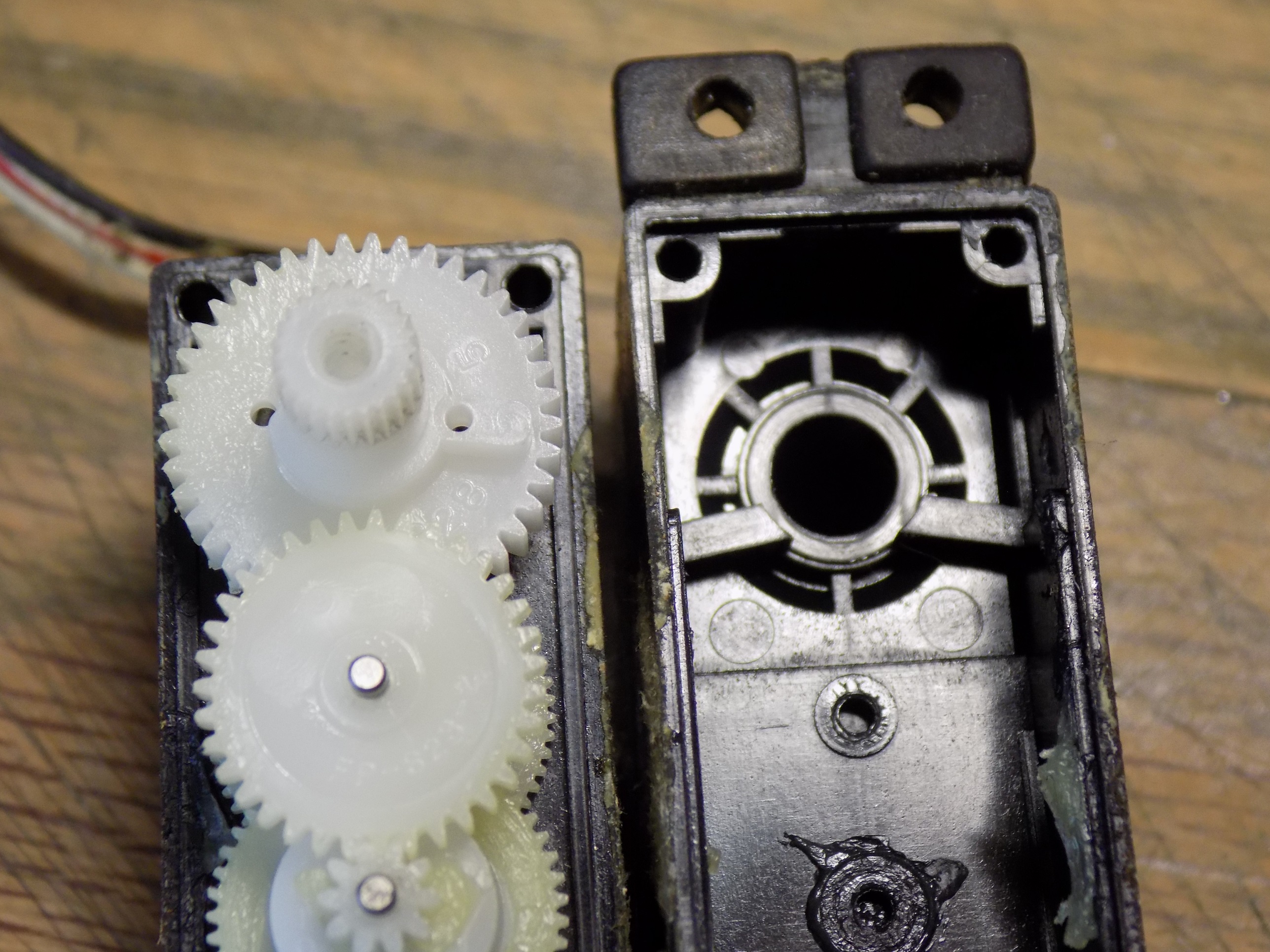

Most servos have 180 degrees of travel, 90 either way from center. Which means a servo would reach full travel in no time and could be damaged by straining on it's stop. So to get past this I remove the stops in the servo gear train.
The bar on the nylon gear (at 3:15) and silver pin on the brass gear. Now the servos are miniature geared motors for use in turret spin, rotary drive, winches and with some creative gearing could work a lever for barrel lift and push pull (recoil). Still working on that last one for my TDs but they've been moved to the back burner for now.

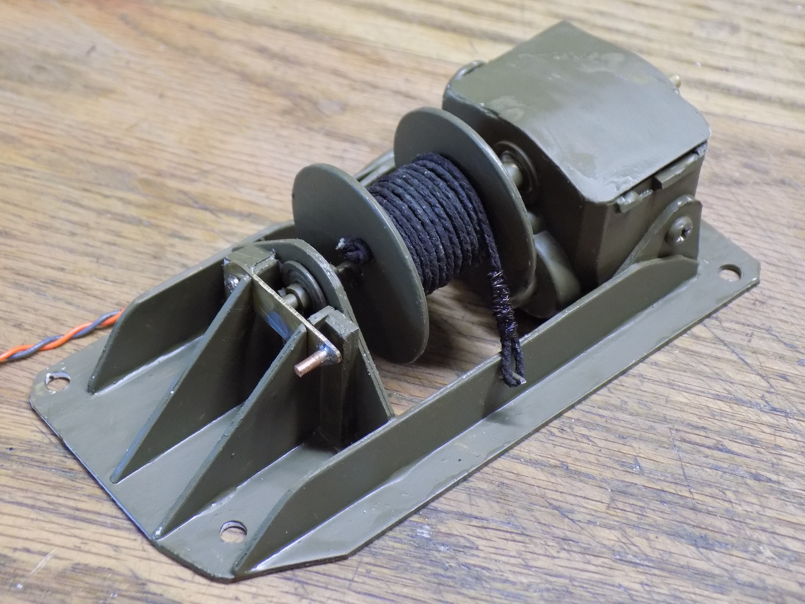

The airsoft, turret turn and barrel lift ports are all strong enough to run the airsoft motors as I've done in my Priest and M32 builds. The winch on my M32 can lift/pull around 4.5 lbs or 2 KG. A modified airsoft motor running the spool (tested with the HL system and then switched to the Tamiya)

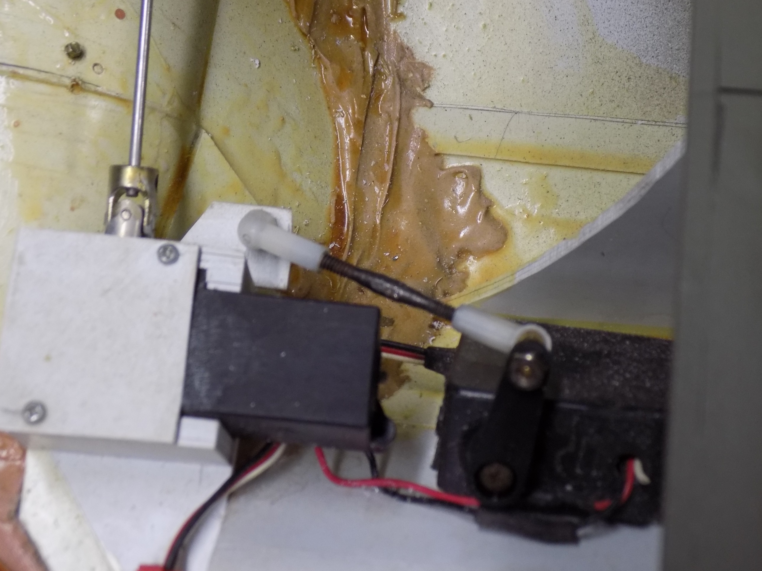

As a contrast, I wanted to run a HL smoker motor for the winch on my large DUKW running a six channel radio (Flysky FS-GT5). In this case I use the servo's electronics just not the servo motor. I steal the power leads for the servo motor and extend them to the HL motor. It gives a proportional control for motor speed.

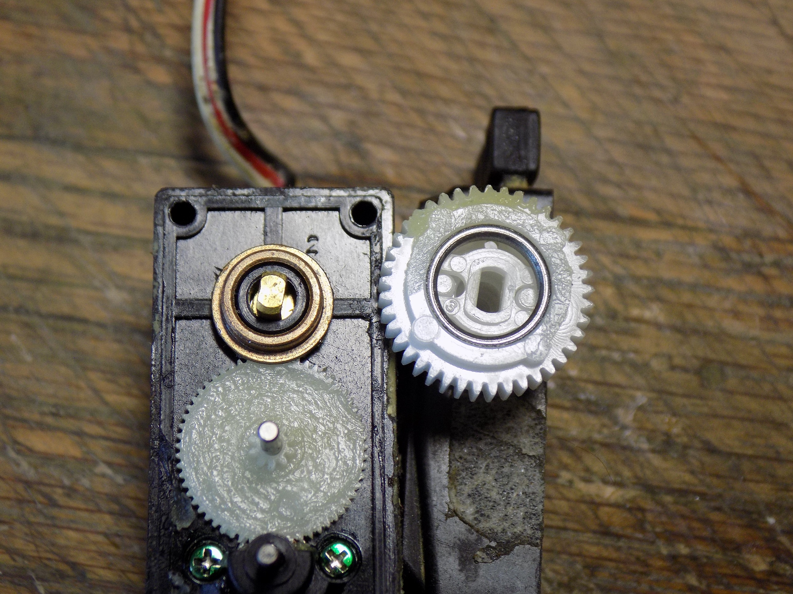

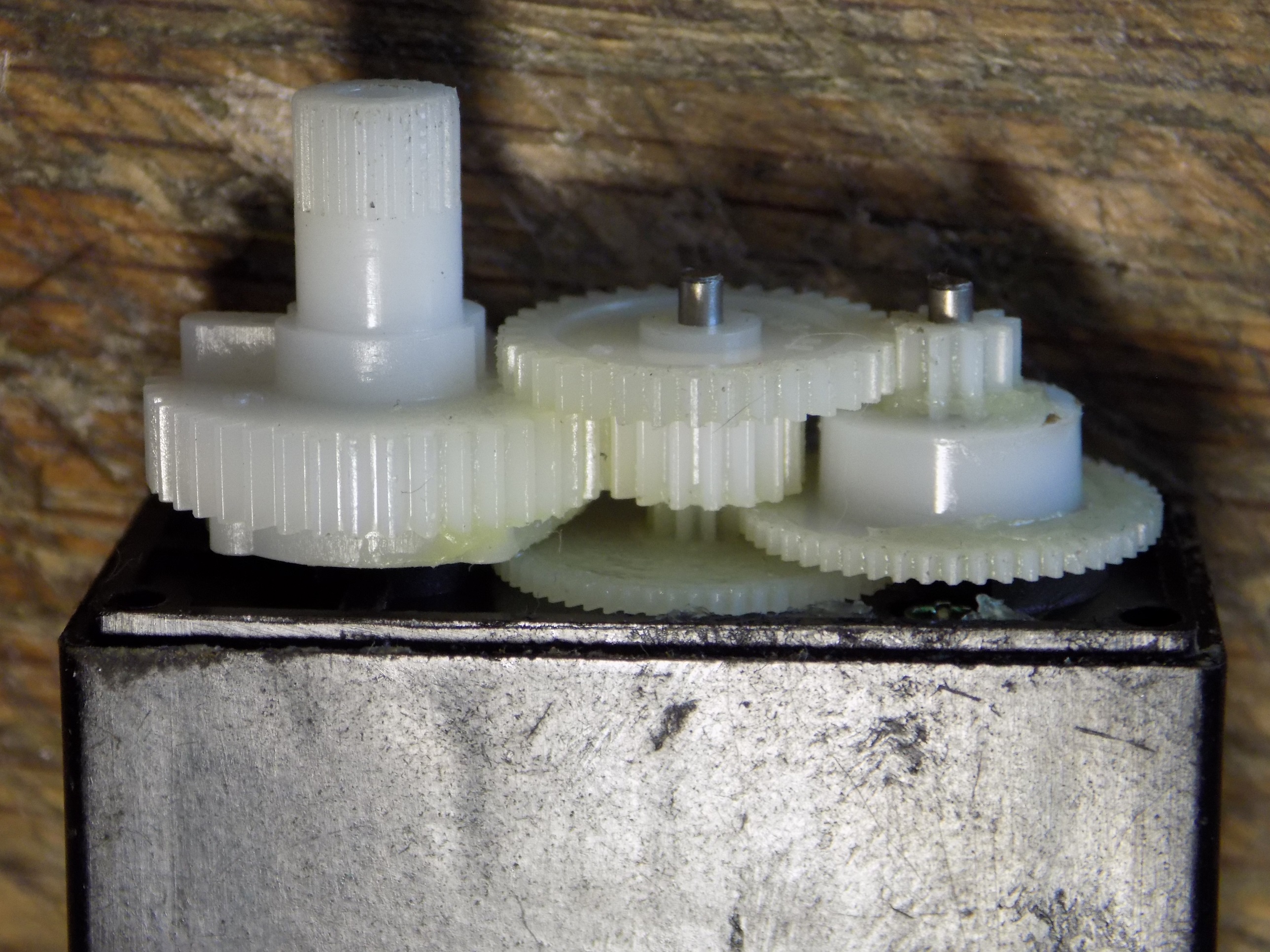

Slight alteration is needed to the servo gears as the dash pot (signal feed - red wire) has to be able to be adjusted. Here is a the typical gear set on the top of a servo.
The center and right gear are removed (center and lower in picture below).
Within the brass bushing is the dash pot that is the servo signal wire. Now the servo will act like a speed control for the external motor. The output gear will be used to center the servo. Like some speed controls forward may be 70% and reverse 30% moving the arm will find that center.
On the DUKW I found the center kept moving so I added a turn buckle for adjustment and holding center (no problem since). The Flysky unit I use is a pistol style with 4 channels for full servo control (1-2 & 5-6). 5 and 6 do not have a center detent so I elected to use a 3 position switch (ch.4 - but no trim adjustment) to control the winch for out/off/in. My propeller channel is 6 so I could have used 5 but finding center or worse bumping channel five could damage the winch while driving the DUKW.
