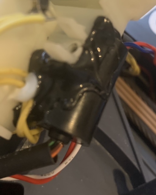

I’m trying to replace my stock barrel with the upgraded barrel / recoil servo unit. I need to remove this slip ring from the barrel housing, but it seems to be glued with some kind of melted plastic or glue...? Anyone know what this is or how to remove it without hurting the slip ring?

This looks like hot glue. Heat it up (preferably use a hot glue gun or finally a hair dryer) and it should be removable (at least partially). You can use also a wallpaper knife or scalpel and slowly snip off the glue fragments but you must be very careful.
The only thing that puzzles me is that you want to use the servo recoil... TK 7.0 doesn't support any servo. Contrary to TK 6.1 and the planned TK 7.1 (not yet available for sale).

Update….
I’ve got it figured out. For 7.0, simply plug the barrel / breach into channel 10. Since the servo is integrated, that’s all you need to do. I’ve got mine working like a champ now.
