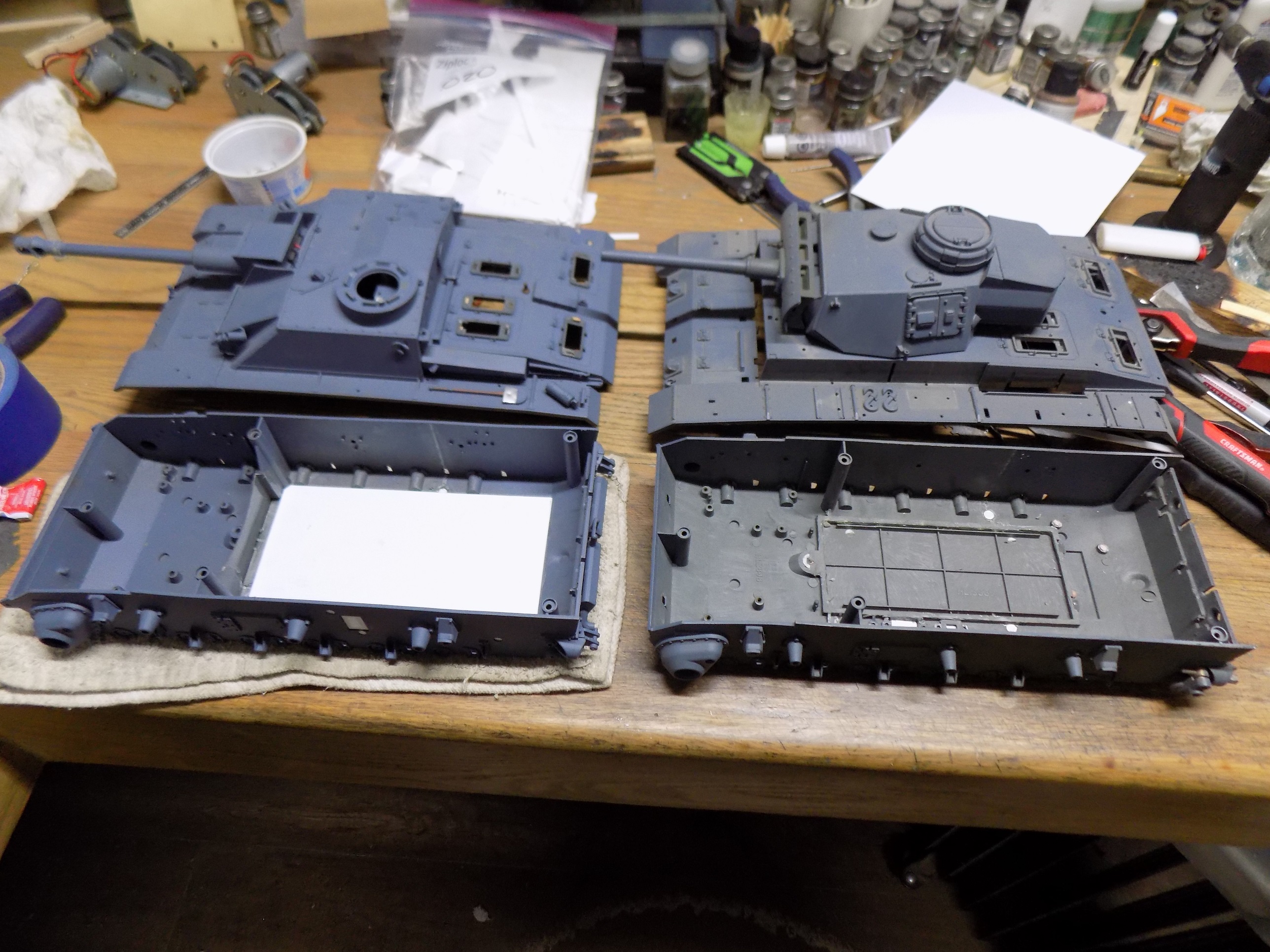

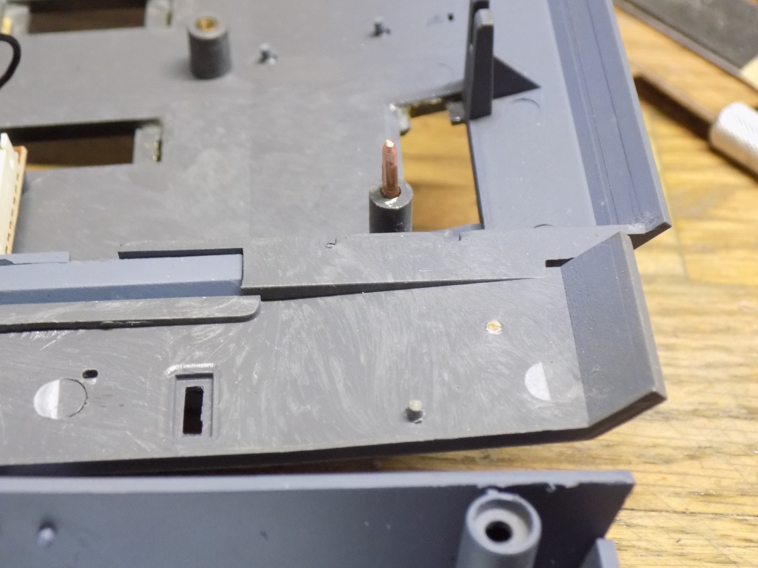

First step was to free up some room. The post aren't really in the way so I will use them as guides and magnets to secure. A piece of wire in the thread portions makes it easy to index and allows plugging the hole underneath. I find it funny that this is a fairly early HL kit, yet the underside has some impressive detail (muddied up by the holes and battery box).

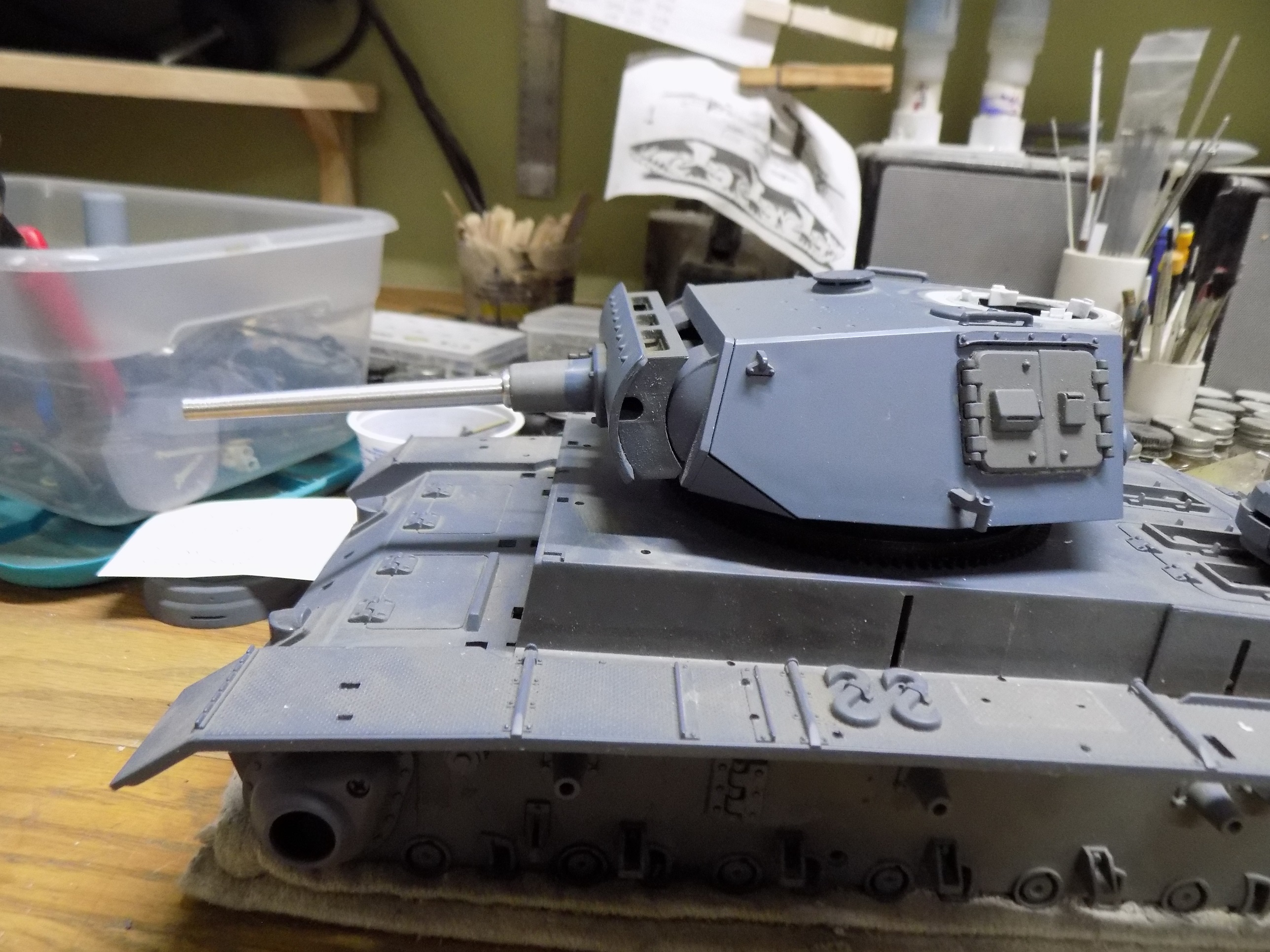

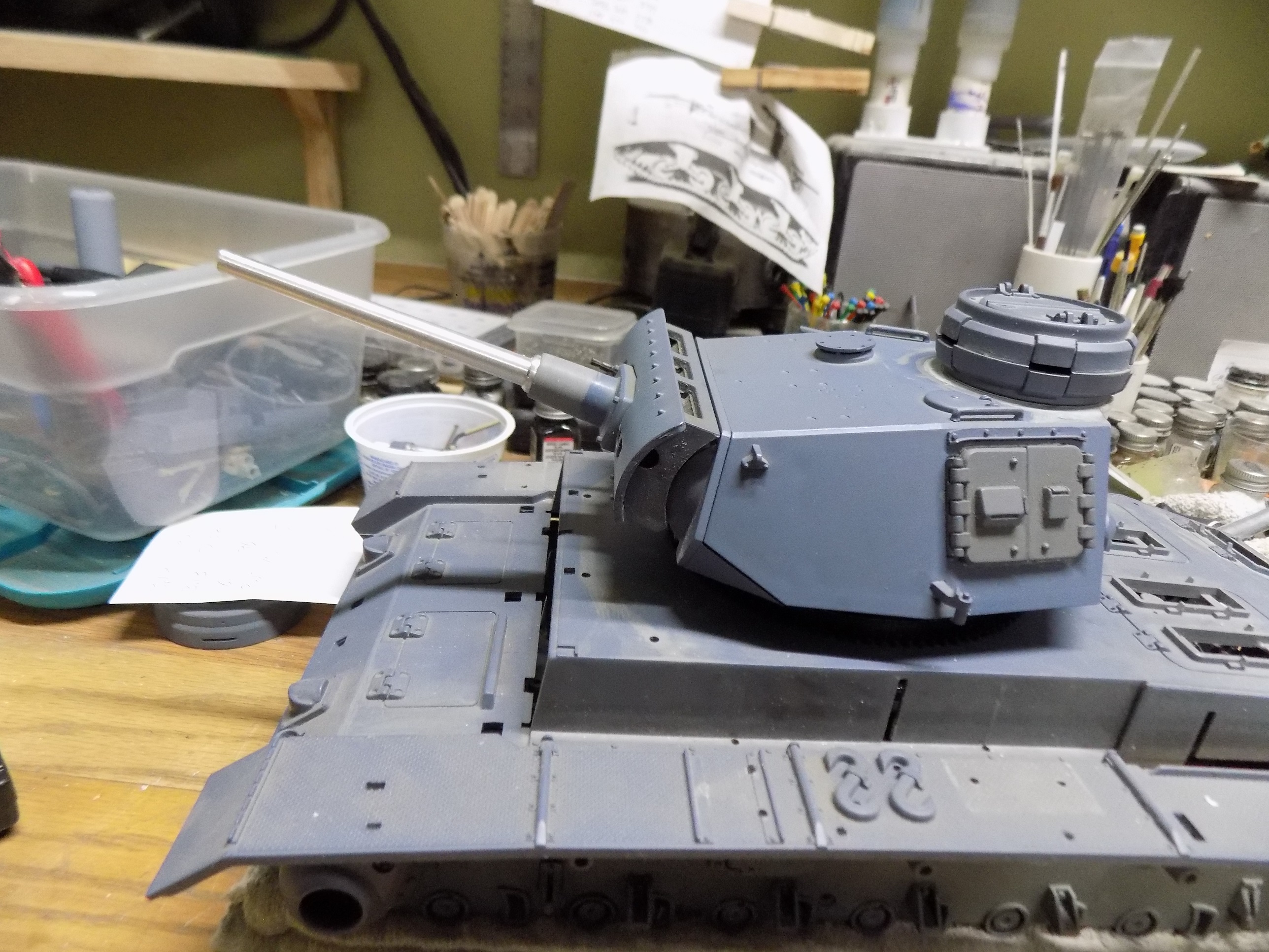

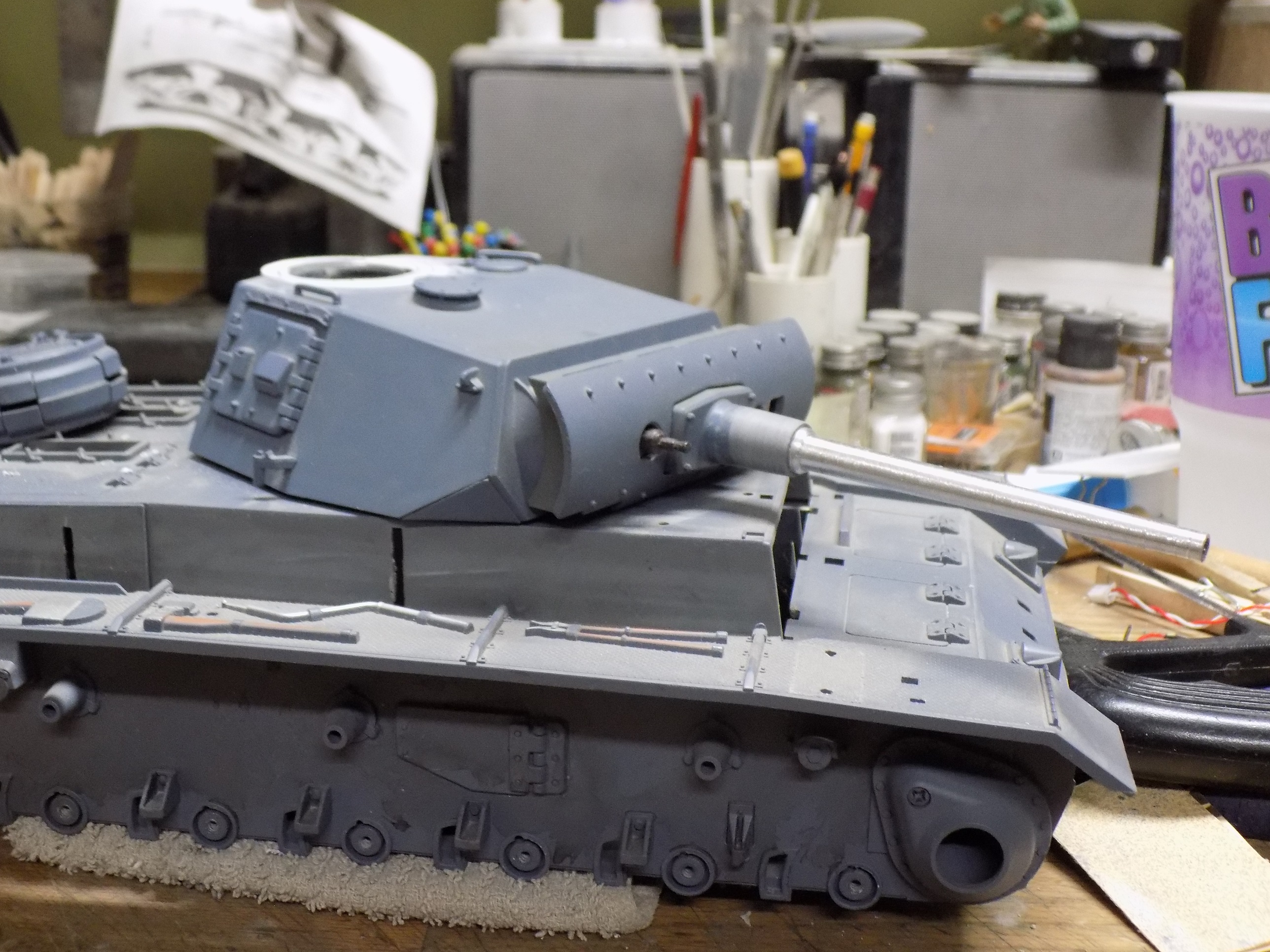

Turret work.

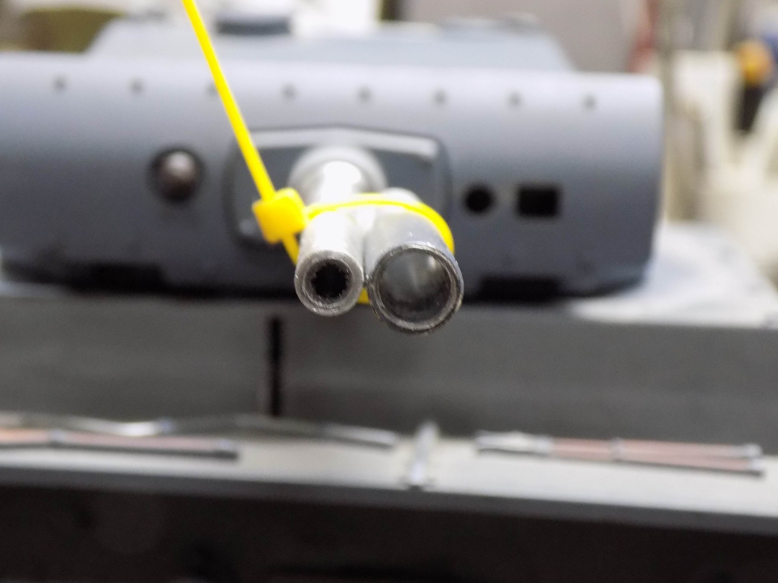

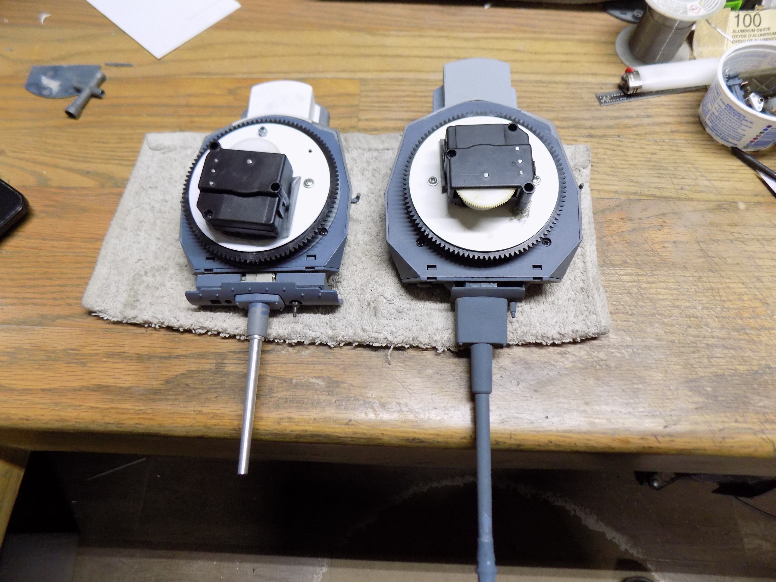

Need to make a new barrel and breech. Turret elevation will be just below.
Barrel. Drilled a 3.13 mm hole scaled to 16th works out to 50.08 mm. Sure beats the 6 mm x 16 = 96 mm.
Zip tied to the stocker:

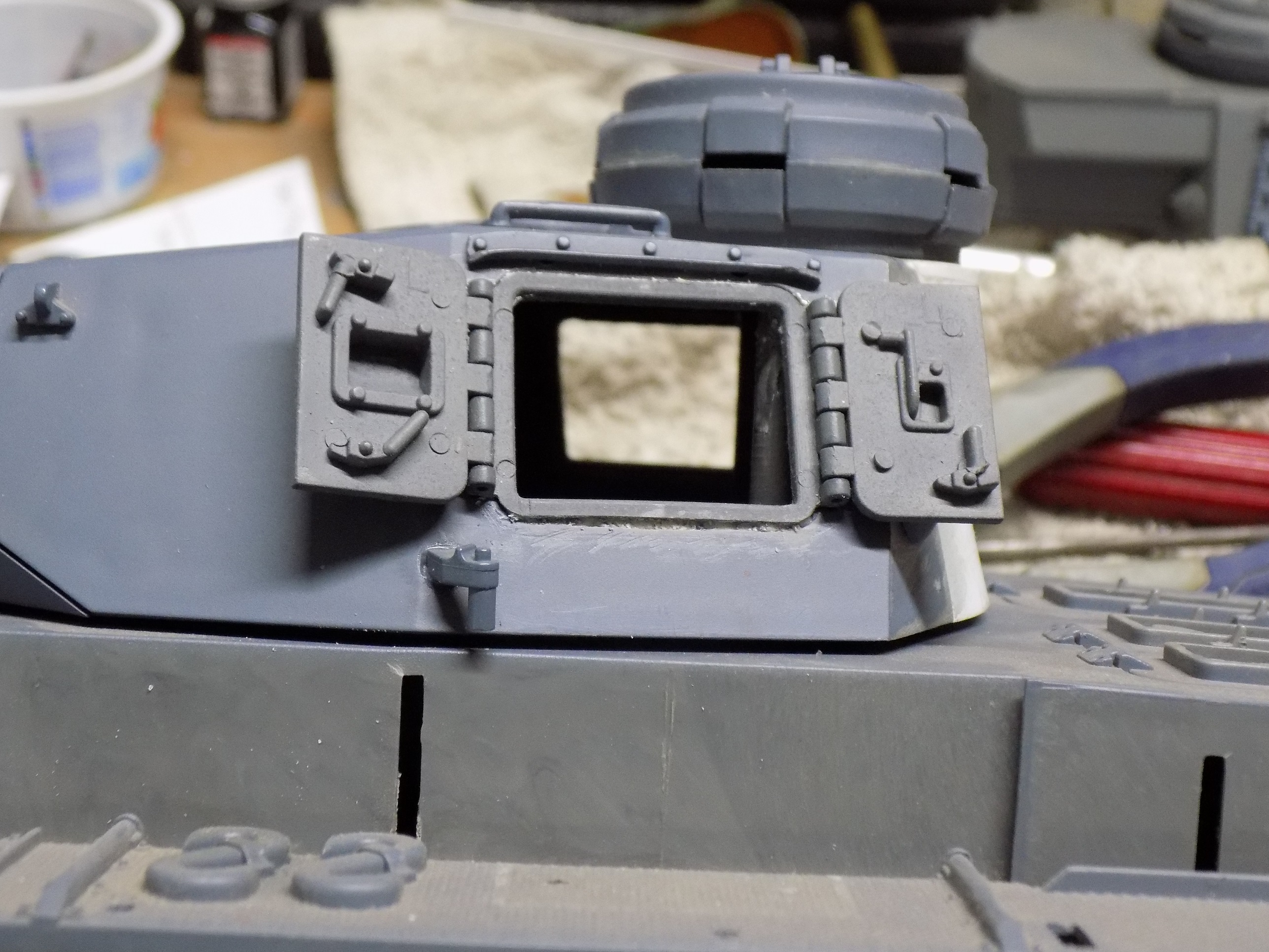

Hatch swap. The PzVI donated the turret hatches for the PzIII. Will order replacements soon for the 4.

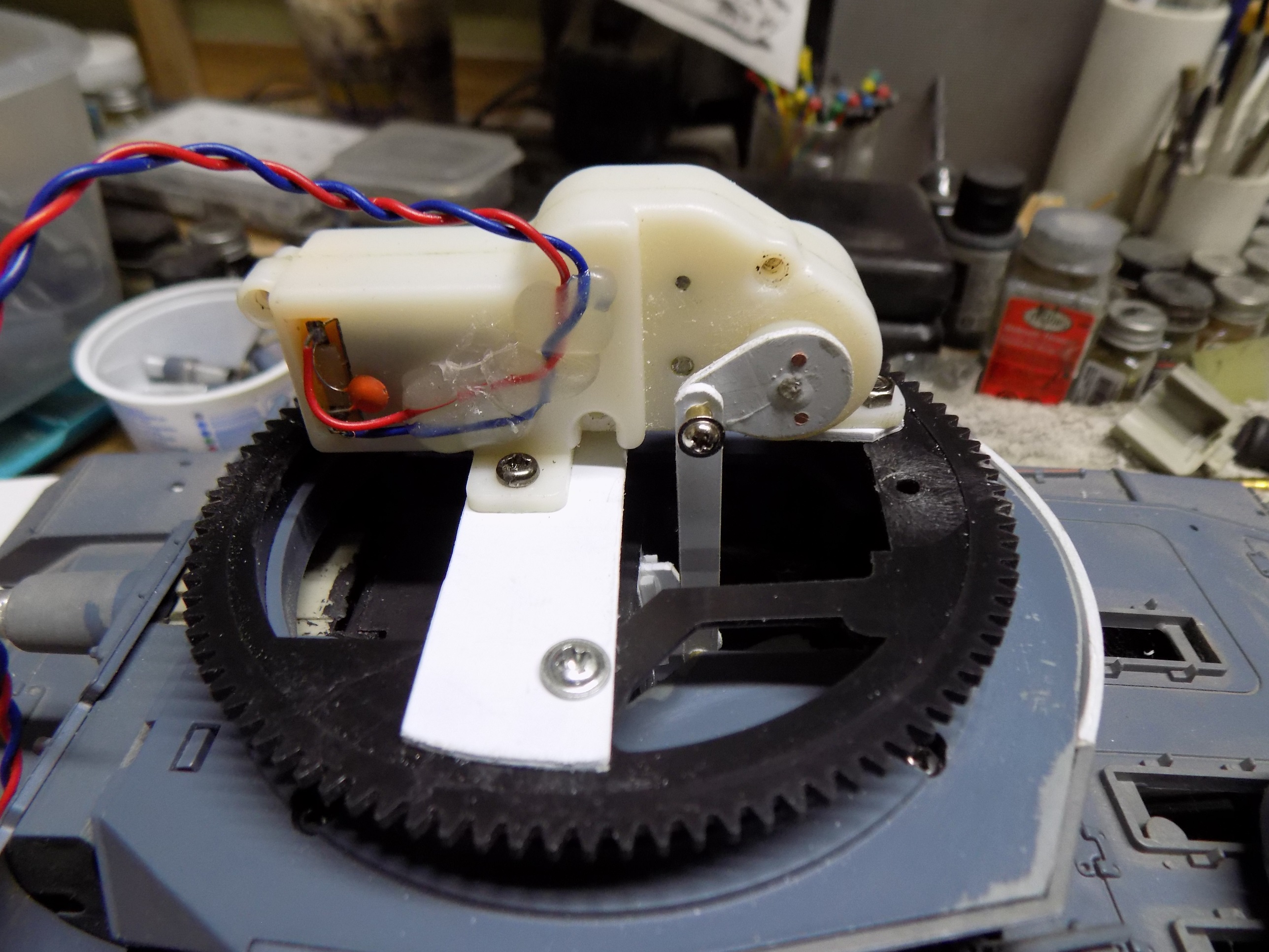

Lift mech:
Max elevation:
Depression:

Meter rat wrote: Sat Jan 20, 2024 1:01 pm Why does everyone else seem to make elevation units easy? I wished you had posted this yesterday when I was struggling with my Challenger. Even inspiration from red wine didn’t help.
It is a much cheaper route than changing out to 6.1 or 7.1 versions. I have three tanks in need of those. Projects like the Priest and M32 free up extra components.

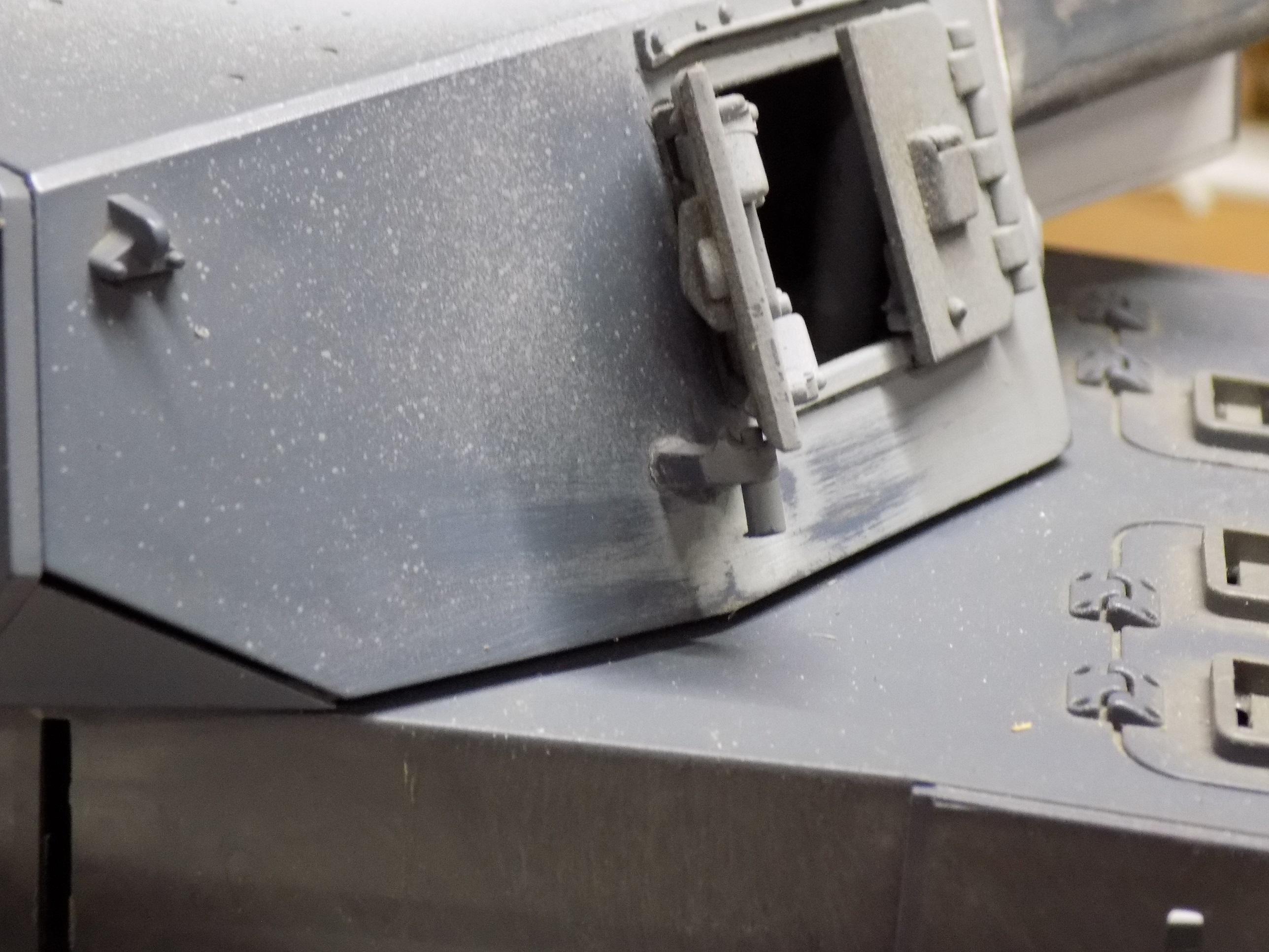

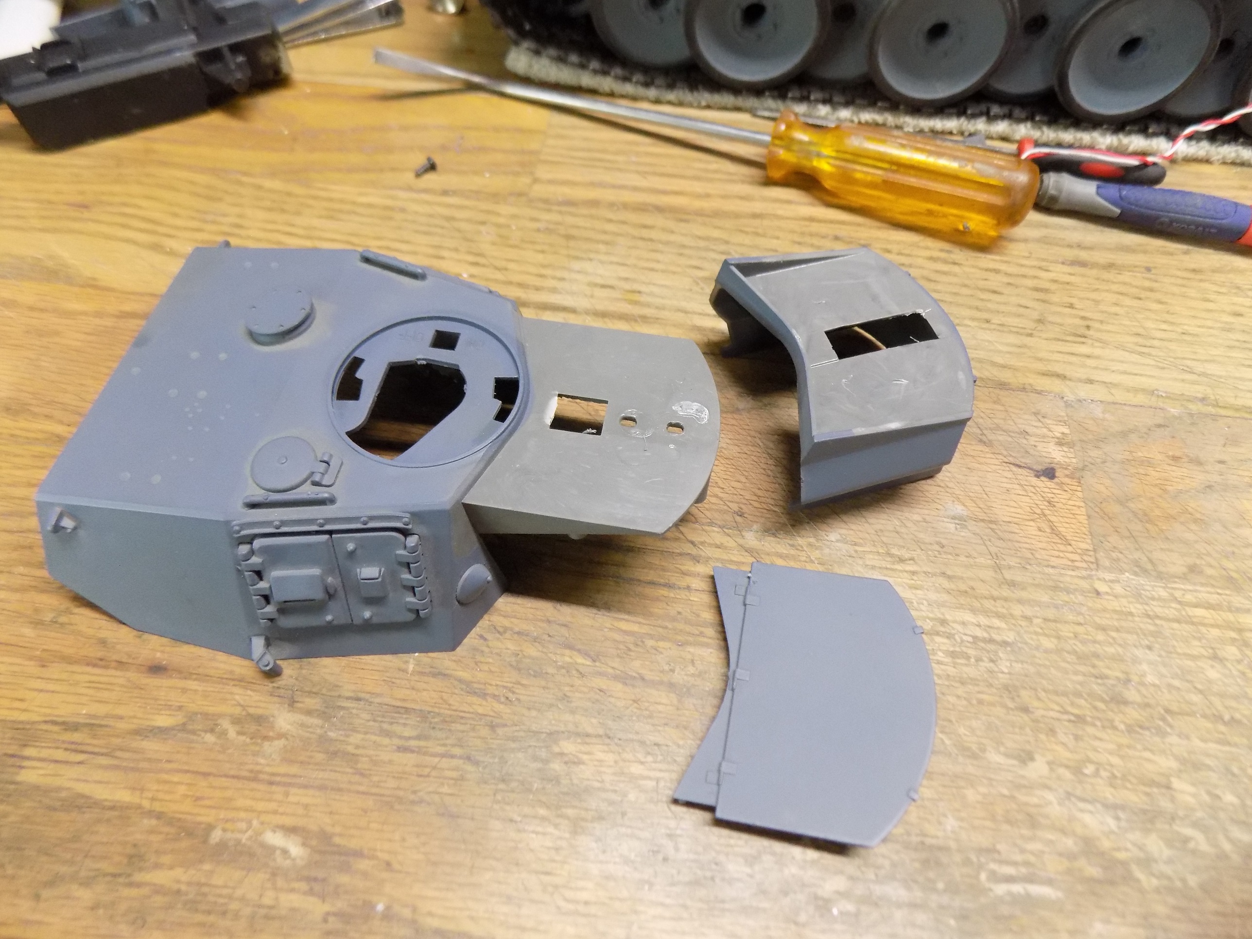

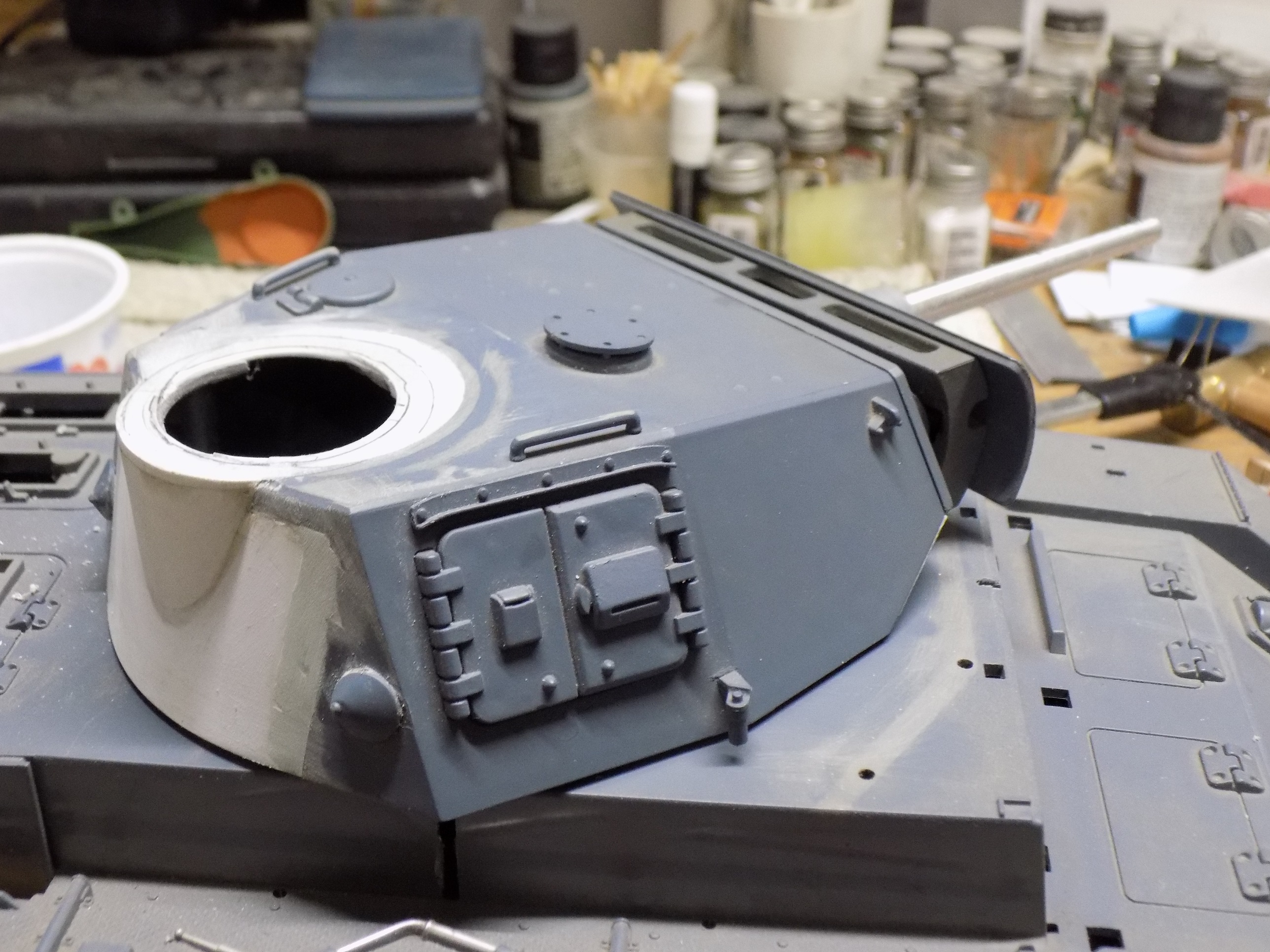

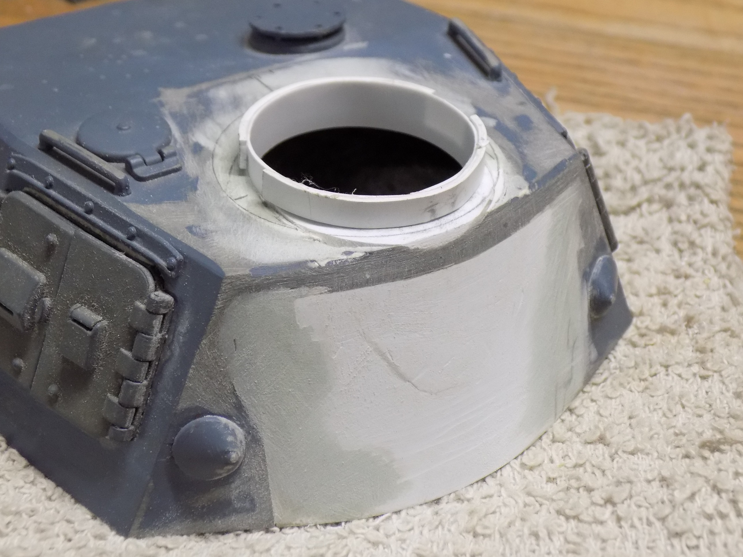

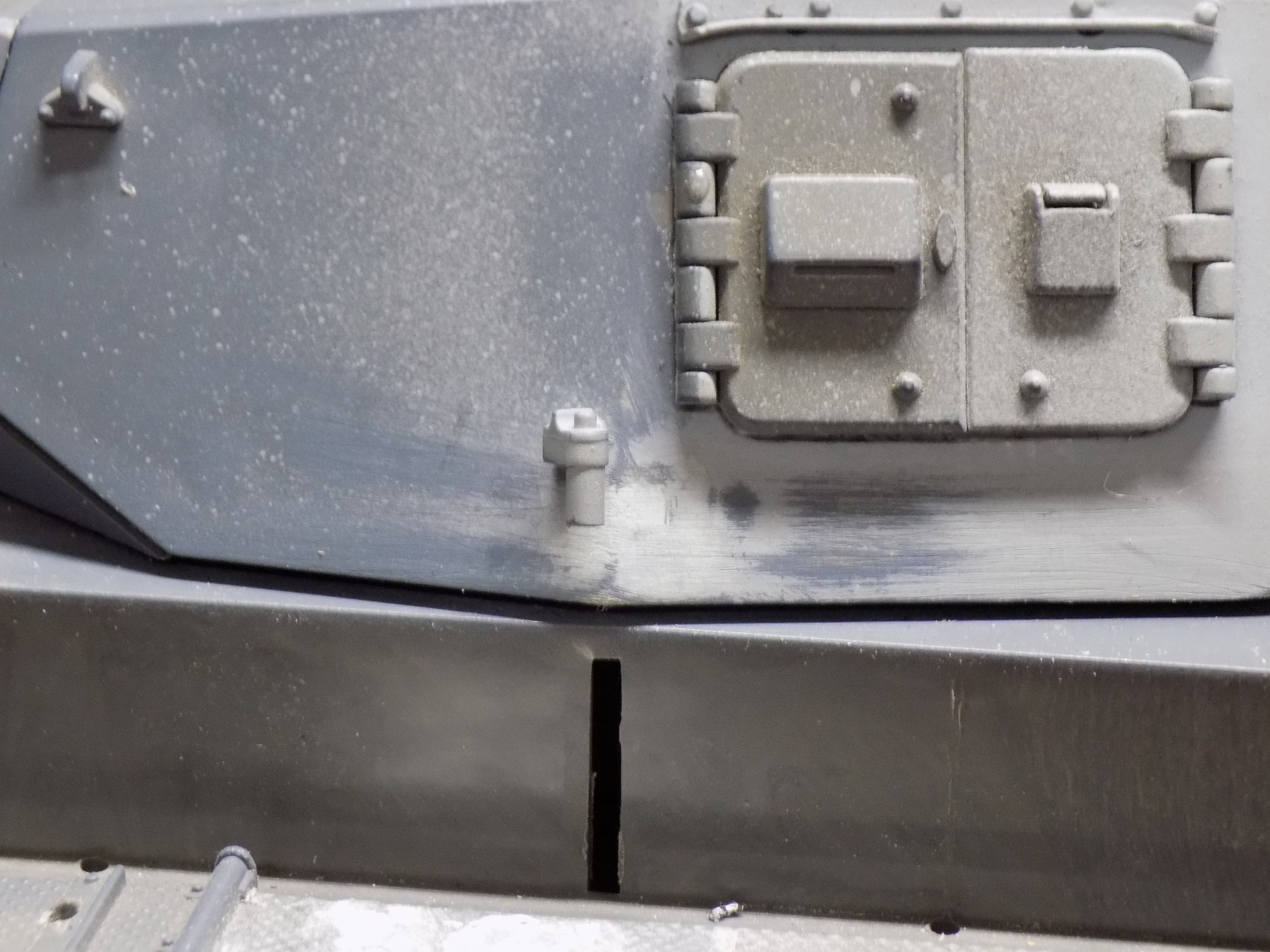

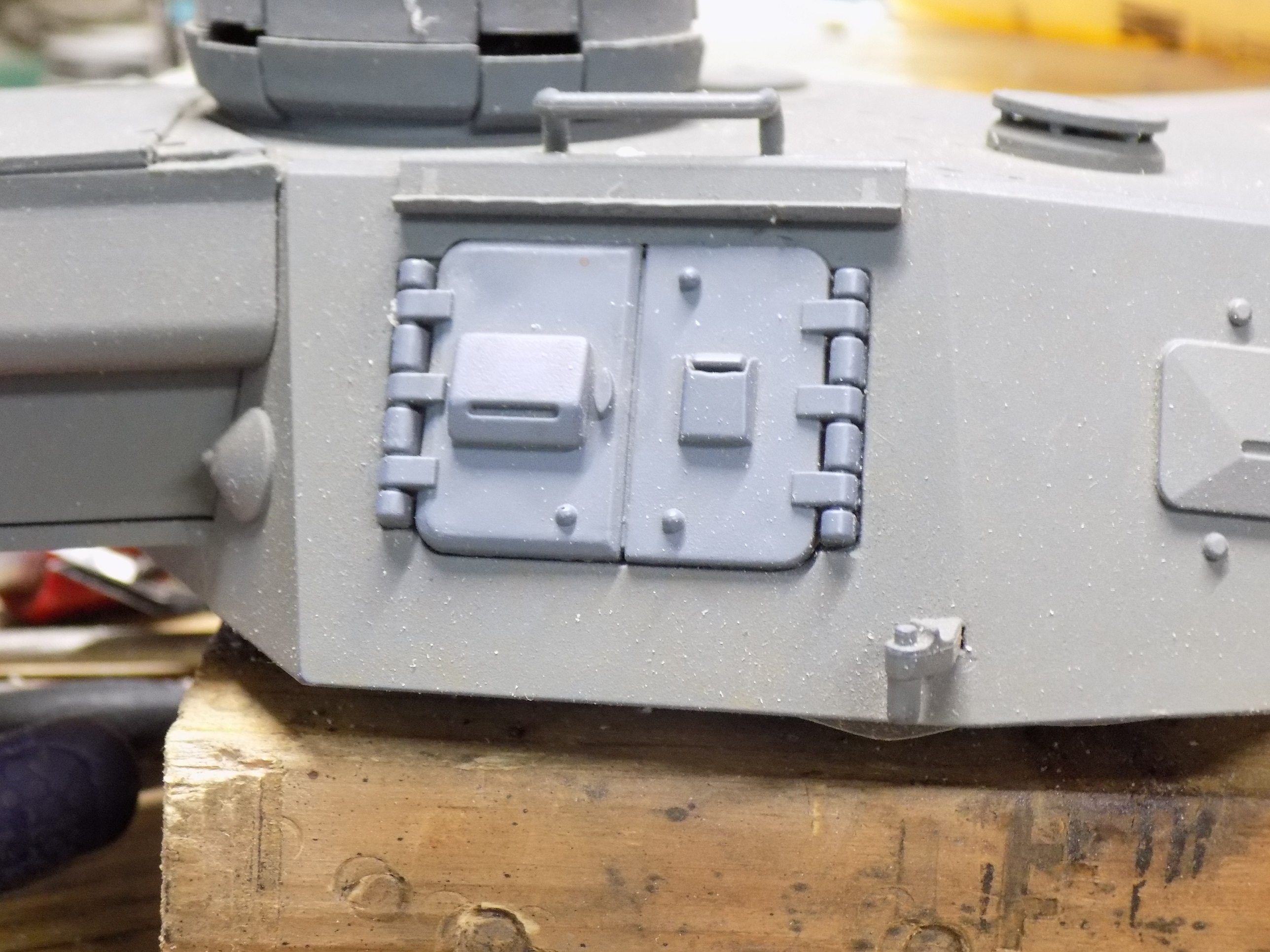

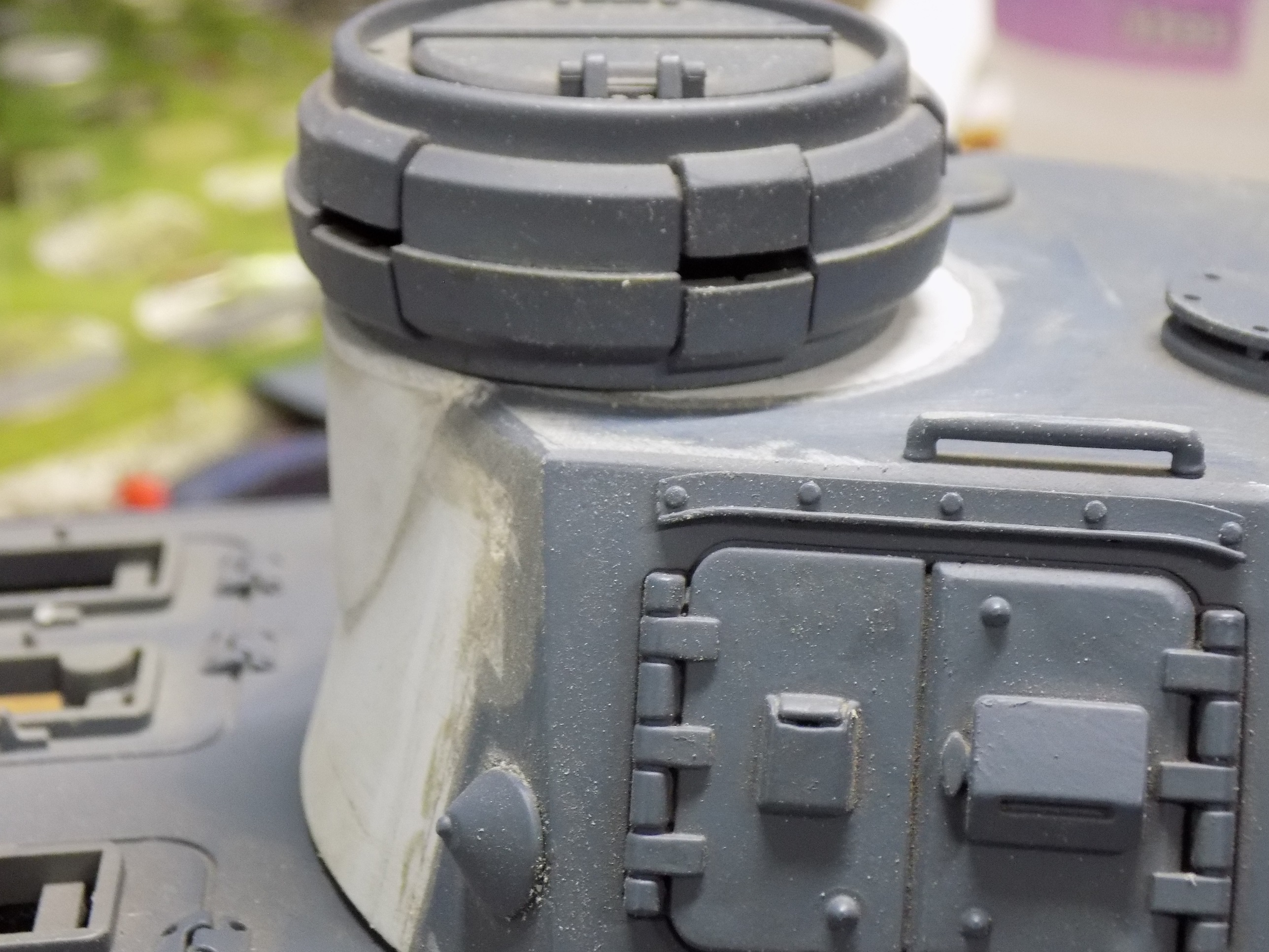

So I'm getting the feeling some of you out there might be snickering behind this rookie's back. While I feel this was a valiant attempt of a bin-less G turret...
It turns out that Germany used most of the alphabet to create the PZIIIs during the war. The books Mike sent to me showed that the turret is indeed the larger one used starting with the H model. The slope of the rear wall seam (just behind the side hatch) leaned forward on the G and earlier builds necessitating the blister I built. H and on that wall seam was leaned back slightly. Mine just needs the blister removed and the cupula moved back forward.
Quit laughing gents... or I may have to move back to the Shermans!

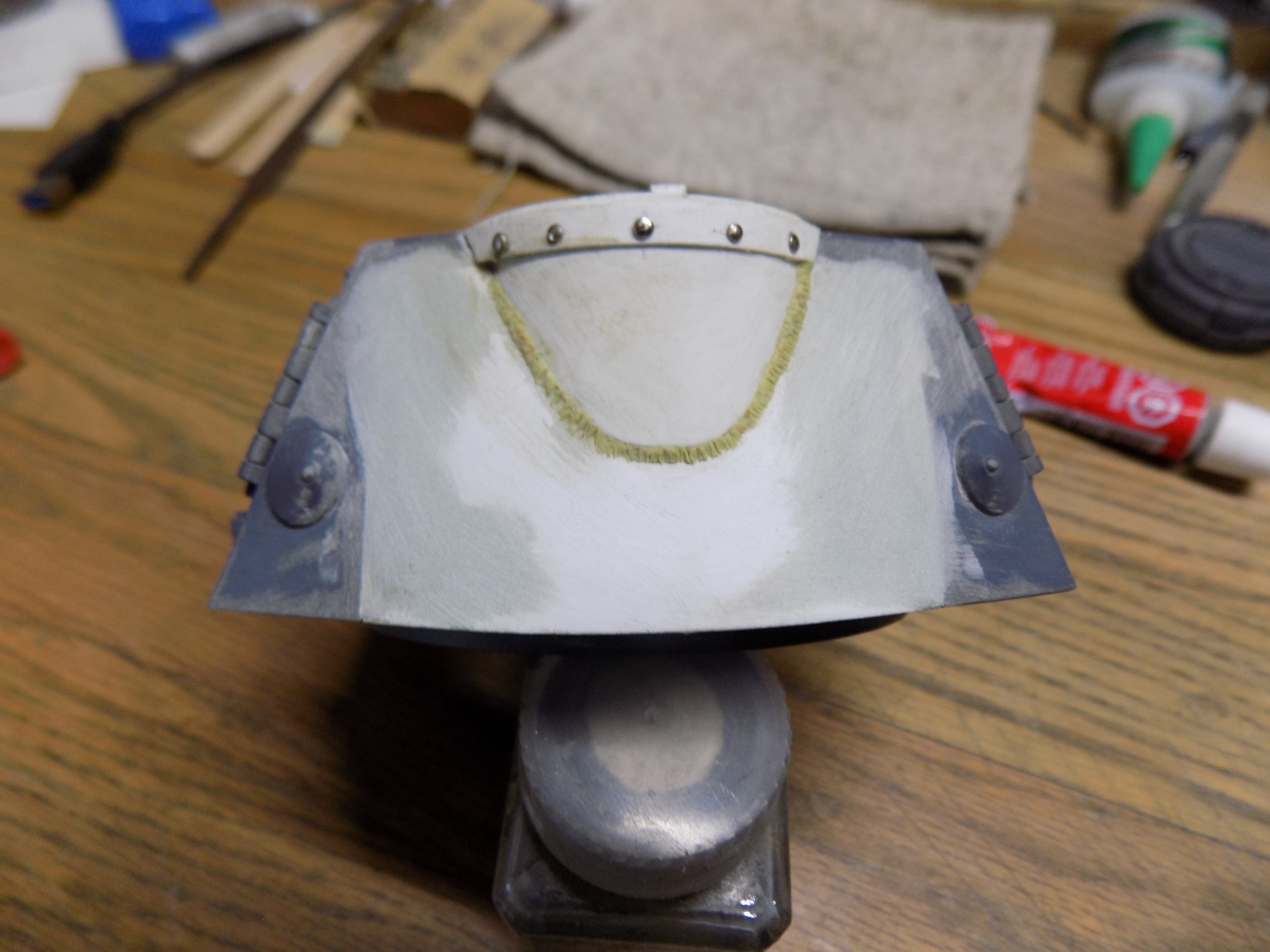

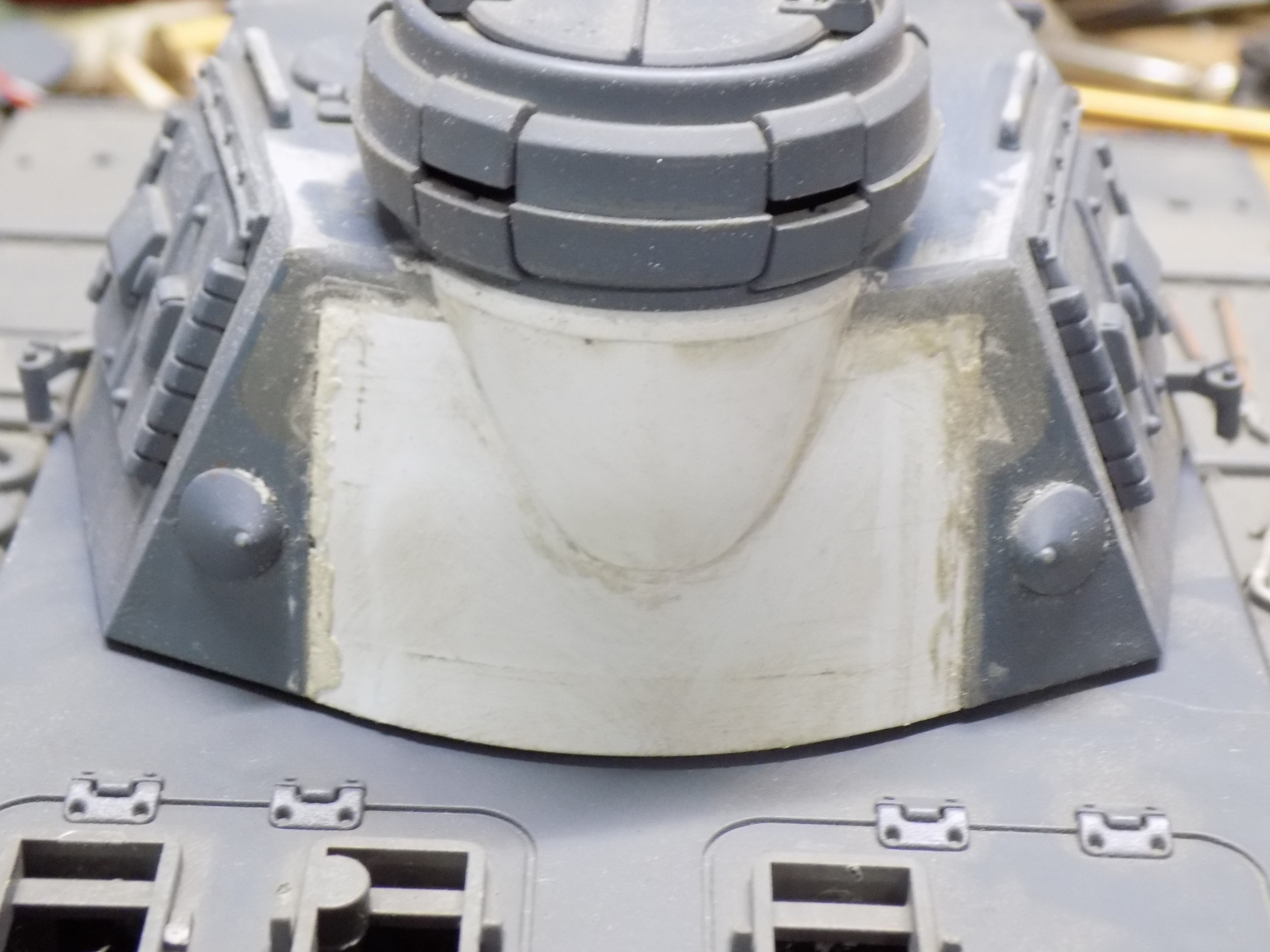

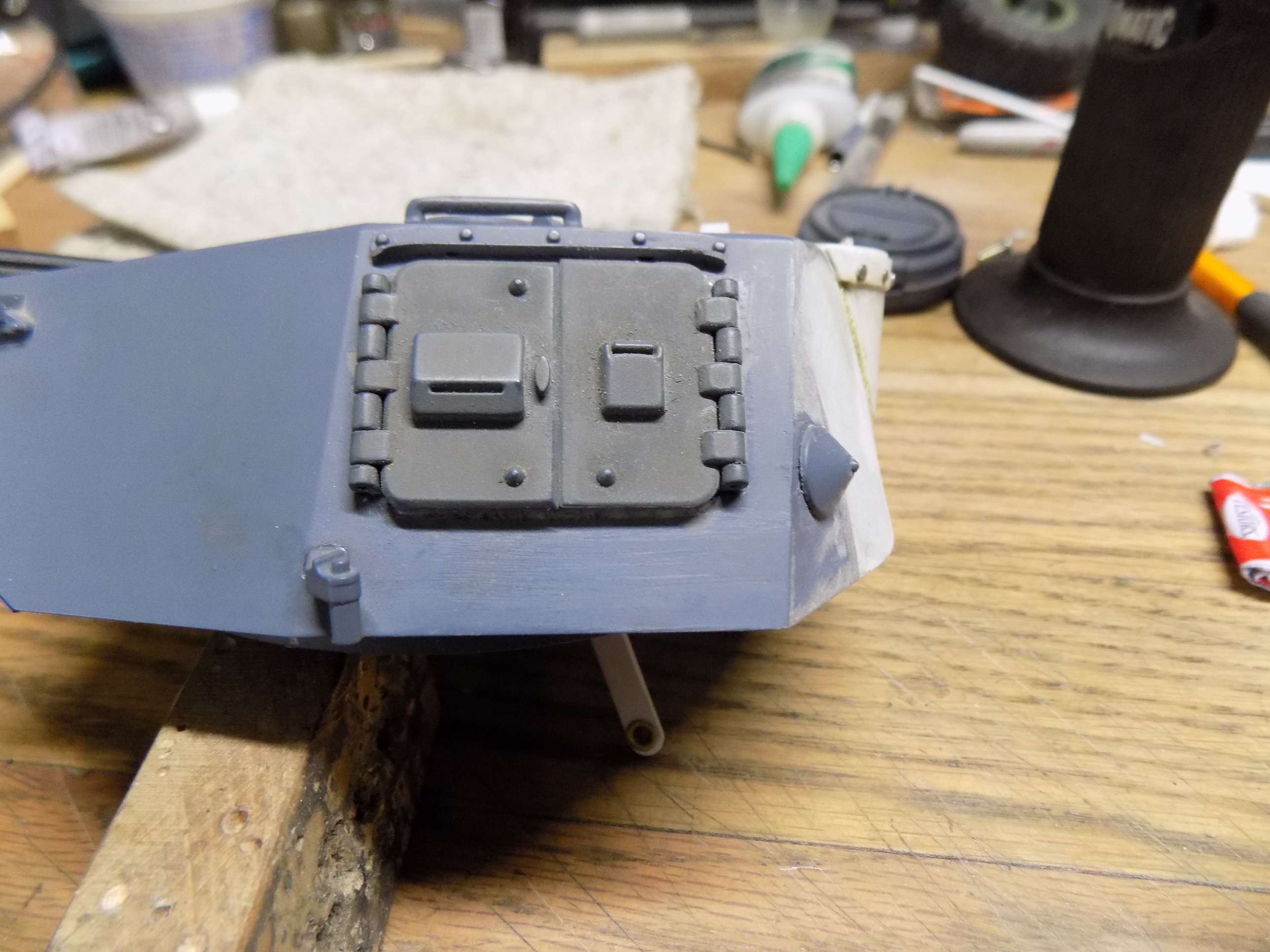

Blister removed, patched and newly drilled roof. That ring on top lifts out, and allows the cupula a snug centered fit.

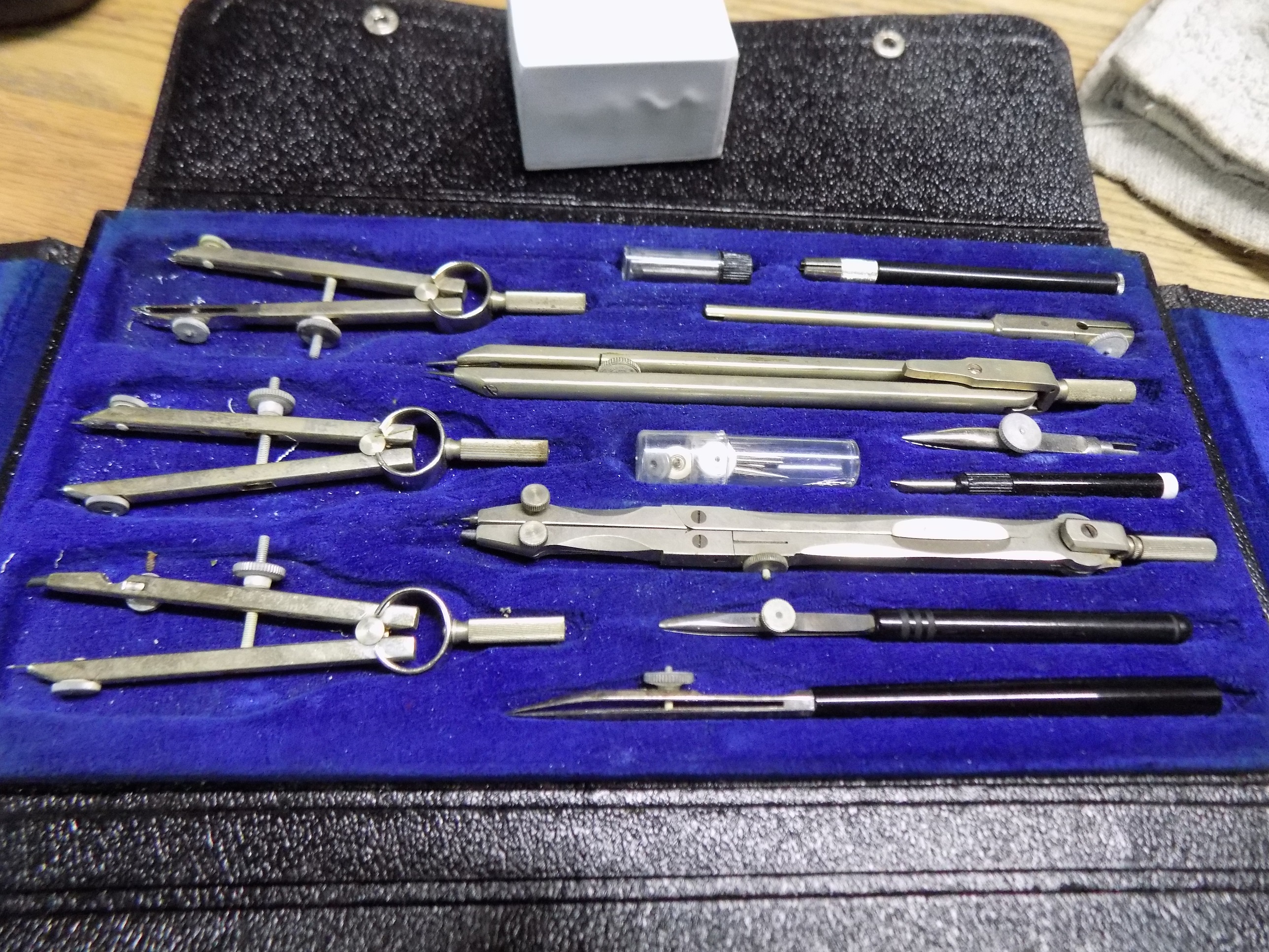

No idea of the origins but I have a few hand me down tools that come in handy at times on the tank builds.
Herr Dr. Professor wrote: Thu Jan 25, 2024 10:53 pm With CAD long established, such drafting tools have become heirlooms. I have my father's set--somewhat fewer tools--from right after WWII. I cherish it, and on some occasions use it. But an inexpensive electronic calipers has taken over many of the responsibilities.
Herr Dr. Professor wrote: Tue Jan 23, 2024 1:13 am "...I am not too knowledgeable about the screens over the PzKw III, but I find the second trick more convincing."

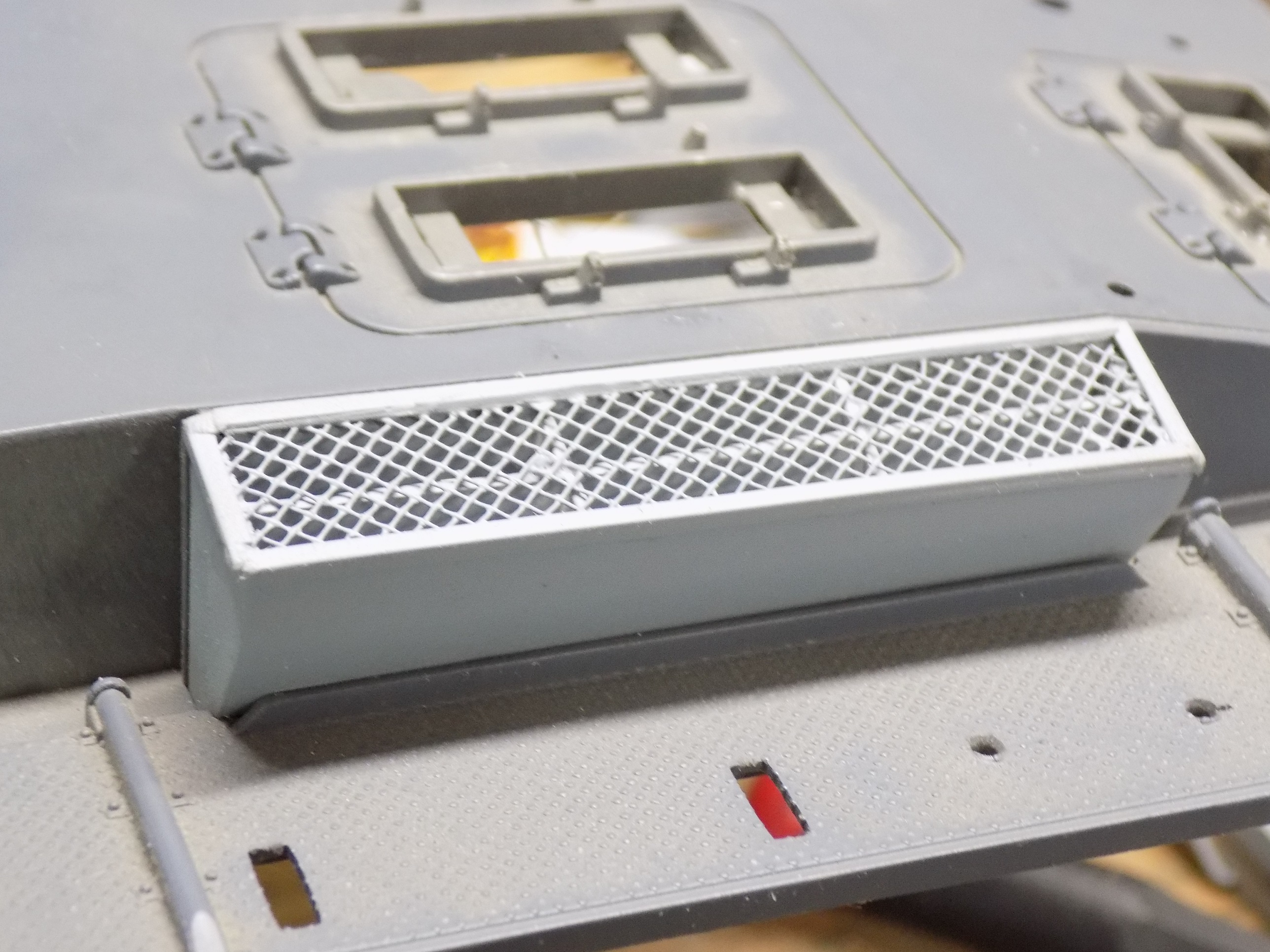

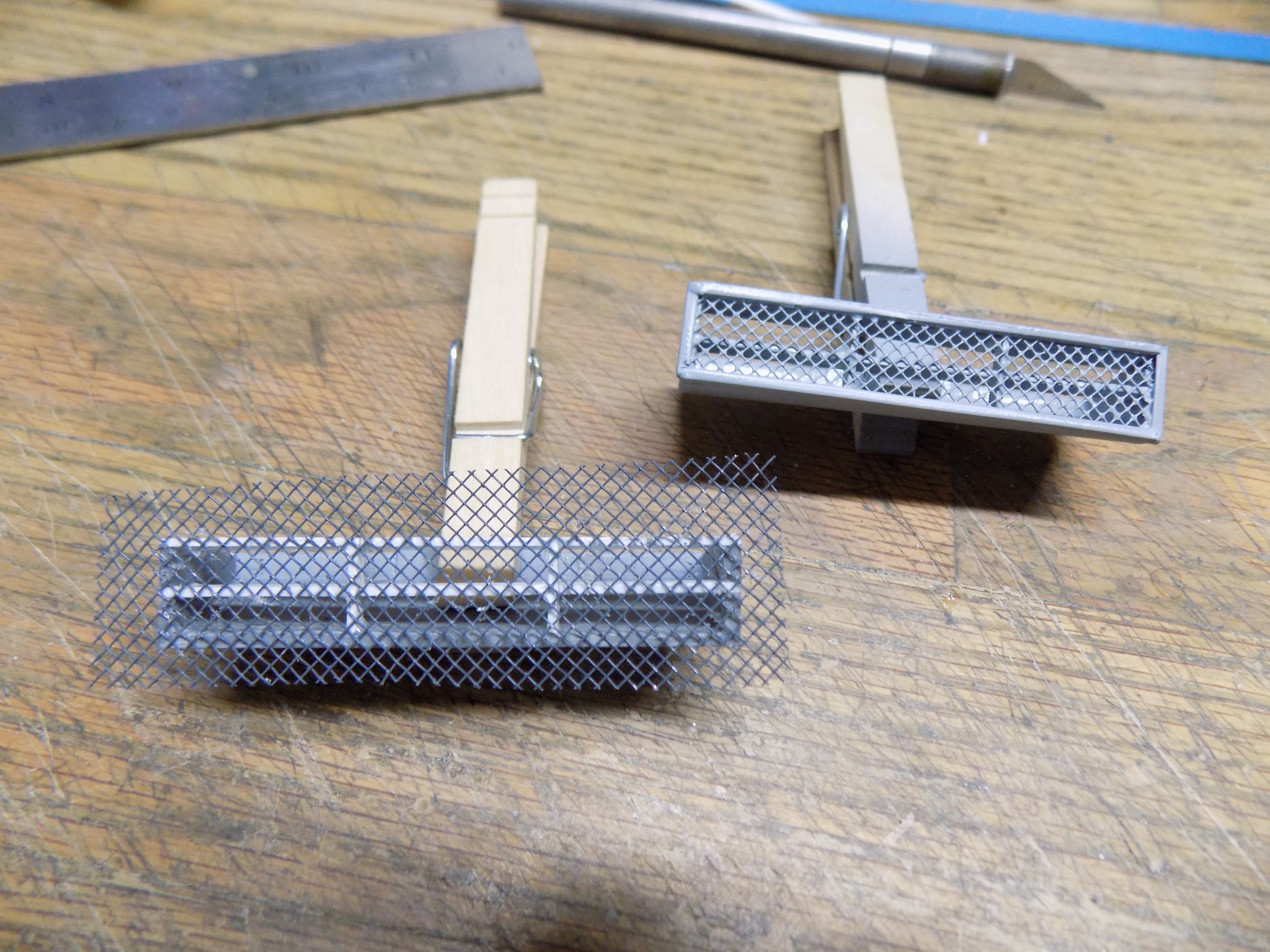

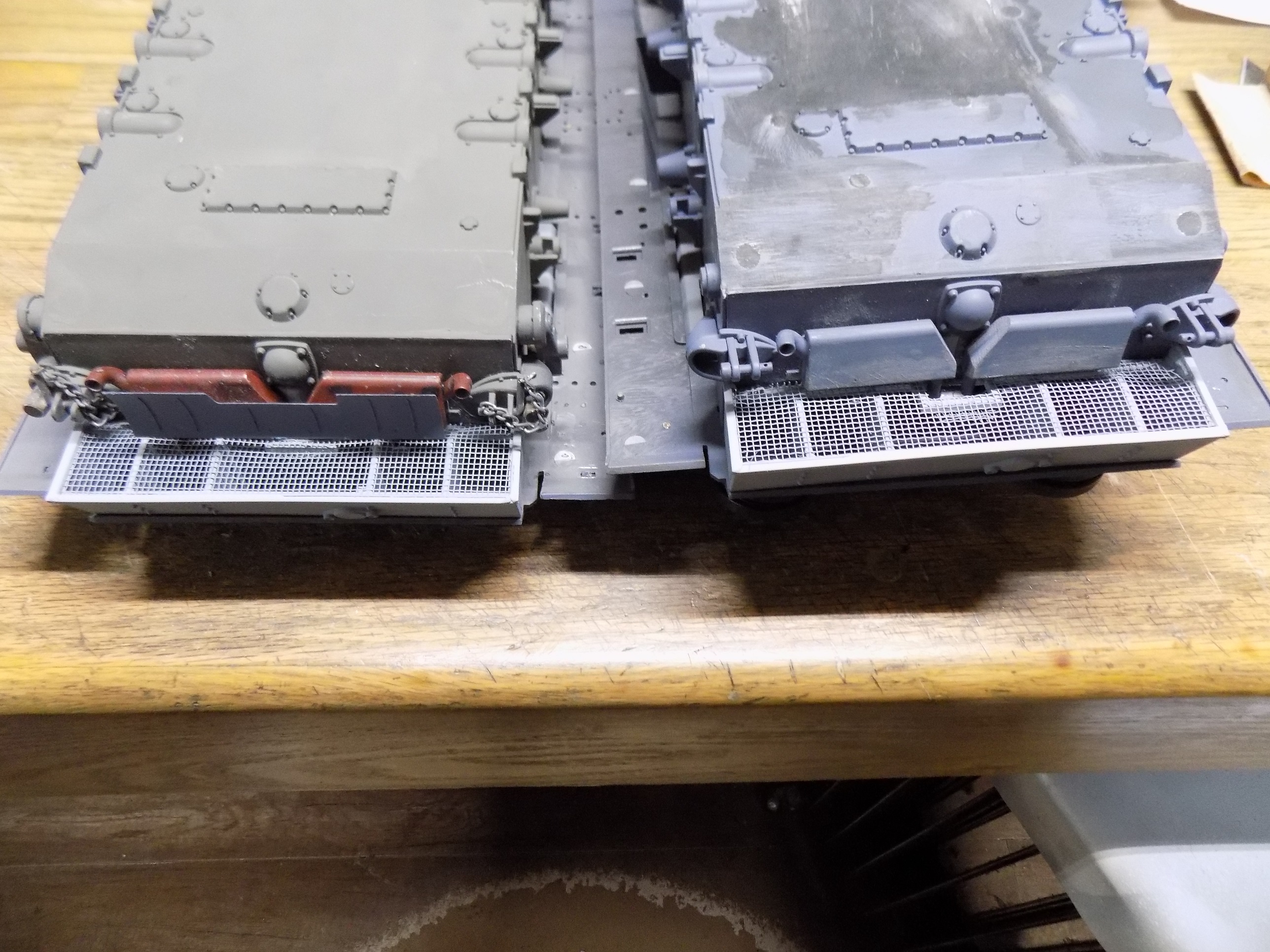

Since I can hear the complete disappointment in your post on my attempt at the speaker grille vent covers. I headed back to the drawing board for a grueling 14 hours (ok 30 minutes) and came up with this.
Eric
Ecam
Posts: 2407
Re: HL Panzer III
Post by Ecam »

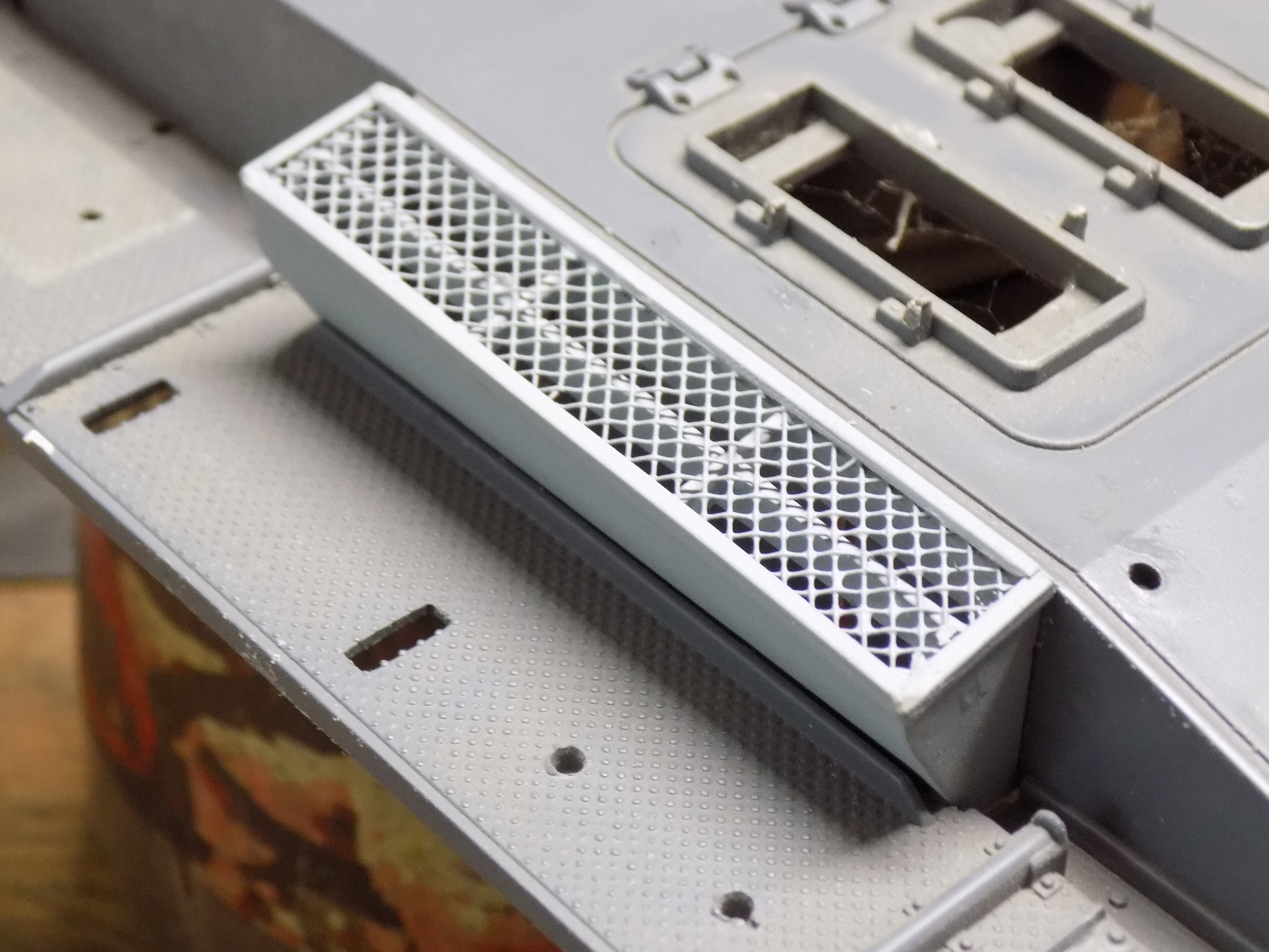

Herr Dr. Professor wrote: Fri Jan 26, 2024 2:19 pm Yes! That's the best version yet! And, indeed, I know about 30 minutes turning into 14 hours. Gee, it only takes me 30 minutes to get up and ready each morning.
Thanks Doc, glad to be out of the dog house!

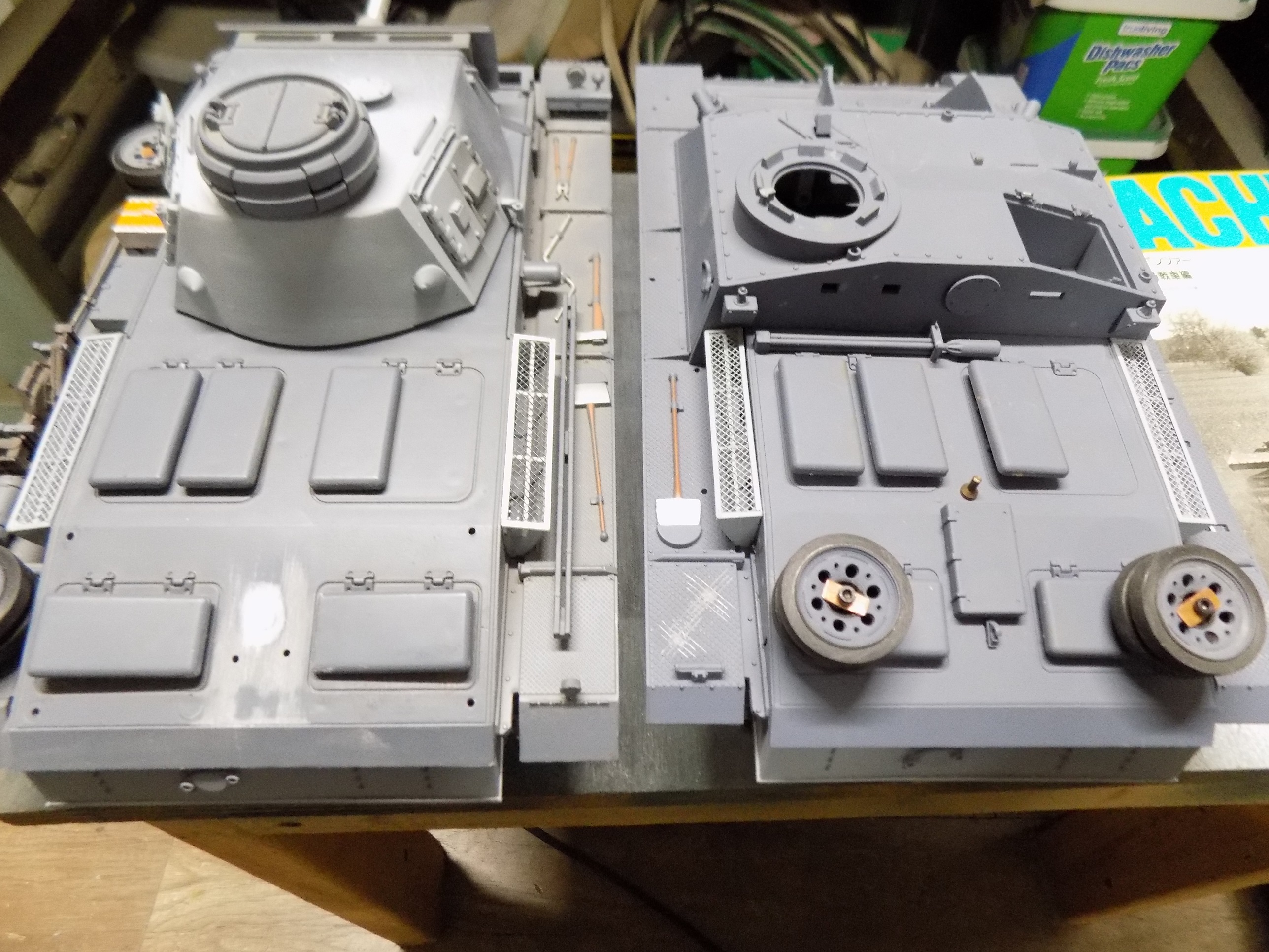

Used regular model cement to stick the screen to the box. After the glue dries a pair of scissors trimmed the screen. Then CA to mount the angle on top of the screen.
Best overhead view I could come up with

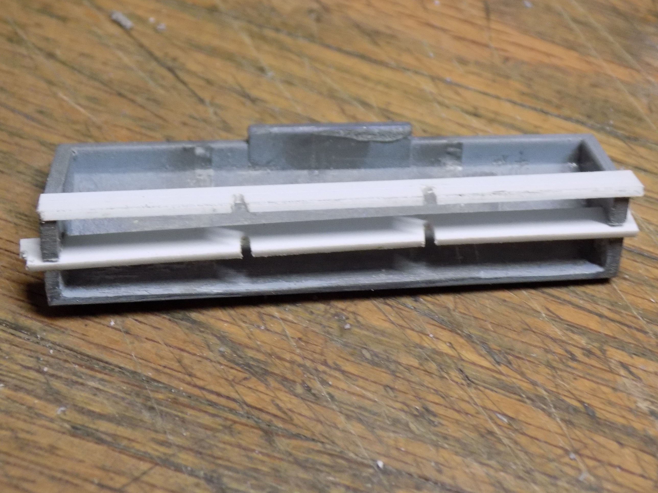

So while waiting for glue to dry on the other set of vents, I worked on the spare mounts for both threes.

Intake screens for both complete. And while I was in the mood...

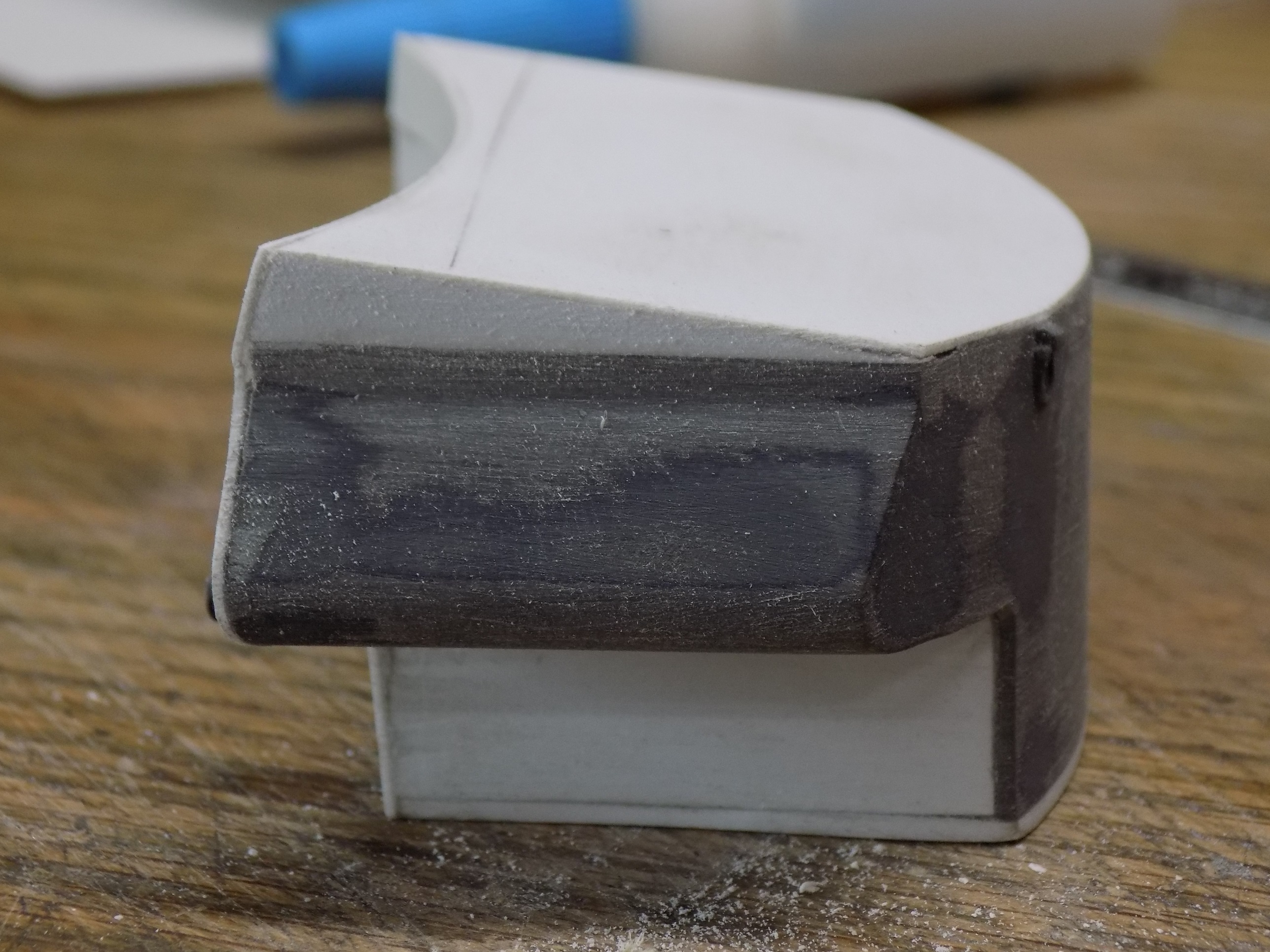

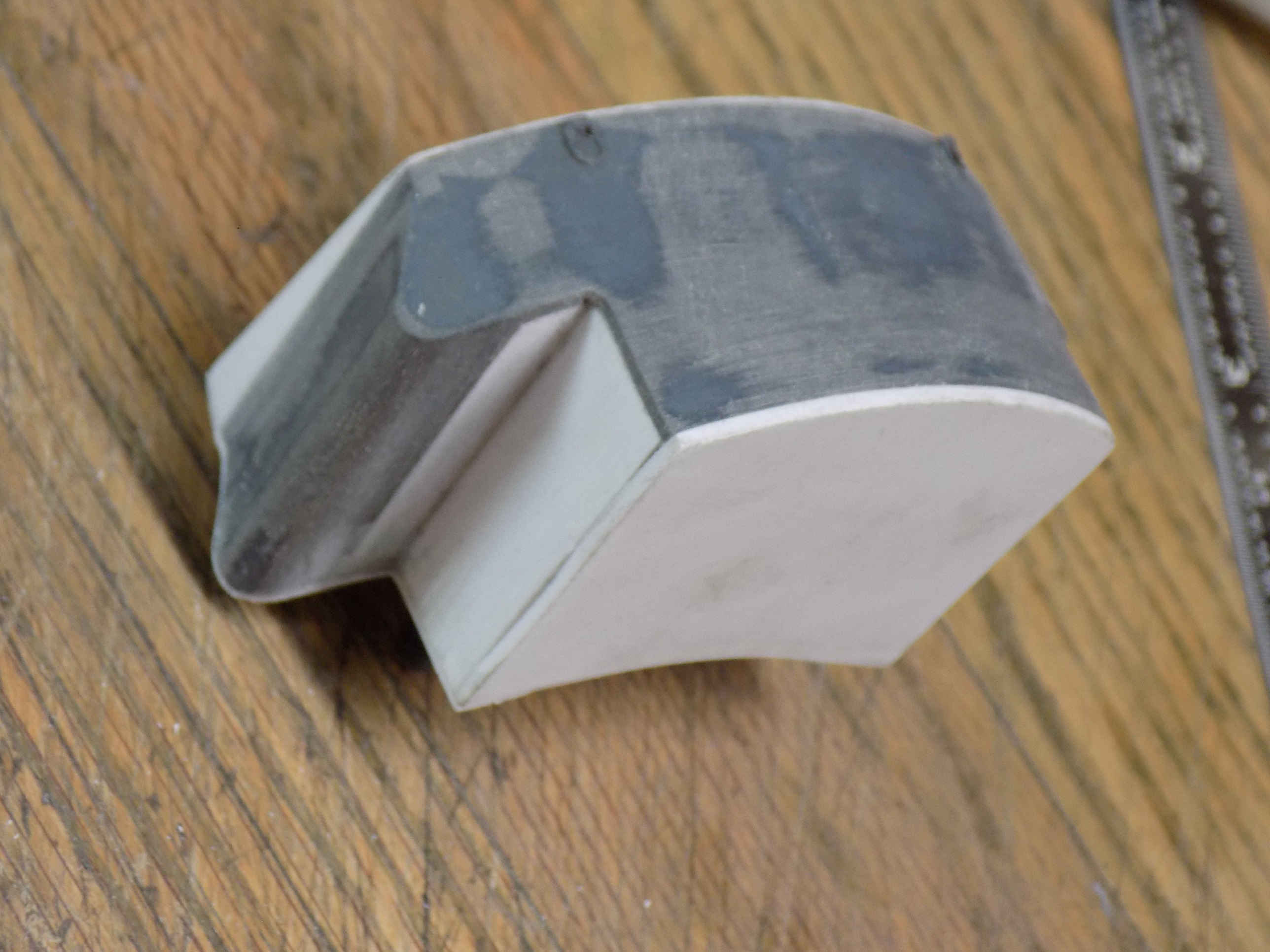

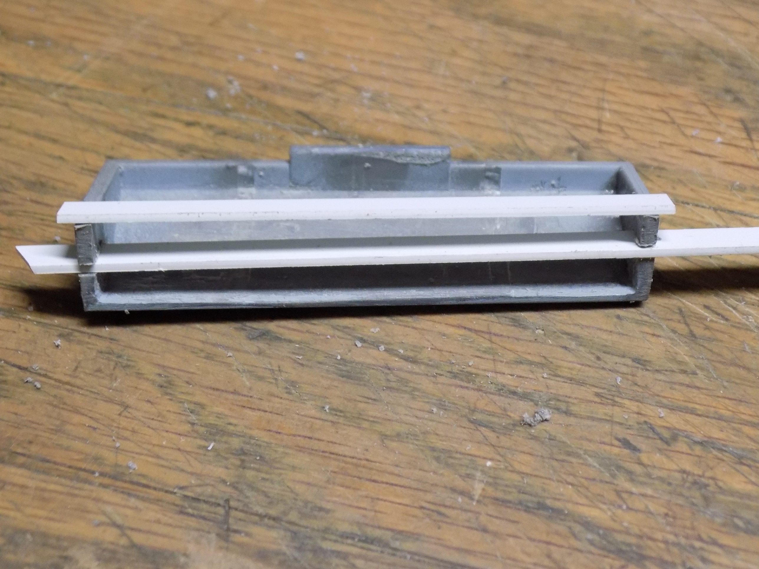

Since I will likely build the turret surround armor, and I've found zero pictures of the armor with a missing bin... I decided to rework the PZIII bin to look more like what I see in the pictures.
Trimmed the bottom a bit. Undercut the wings and added a wedge to the top. Also shortened the length a fair amount (sanding the bin to turret face). It also bolts on and will get some correct hangers soon (non weight bearing).
I liked how the lifter mech came out on the IV so I built another for the III. It is turned around to move the pushrod forward in the turret. With the open side hatches I tried to replicate a shorter breech to suit the 50mm gun. The pushrod in the IV's location would end up behind the breech.
And finally, relocated the hatch latch/catch.

Ecam wrote: Fri May 24, 2024 4:57 pm Blister removed, patched and newly drilled roof. That ring on top lifts out, and allows the cupula a snug centered fit.
Hey Eric, first how is this project coming along?
And
Second, how thick is the styrene sheet you used to cover the gap on the rear of the turret? 1mm, .75mm, .5mm?
