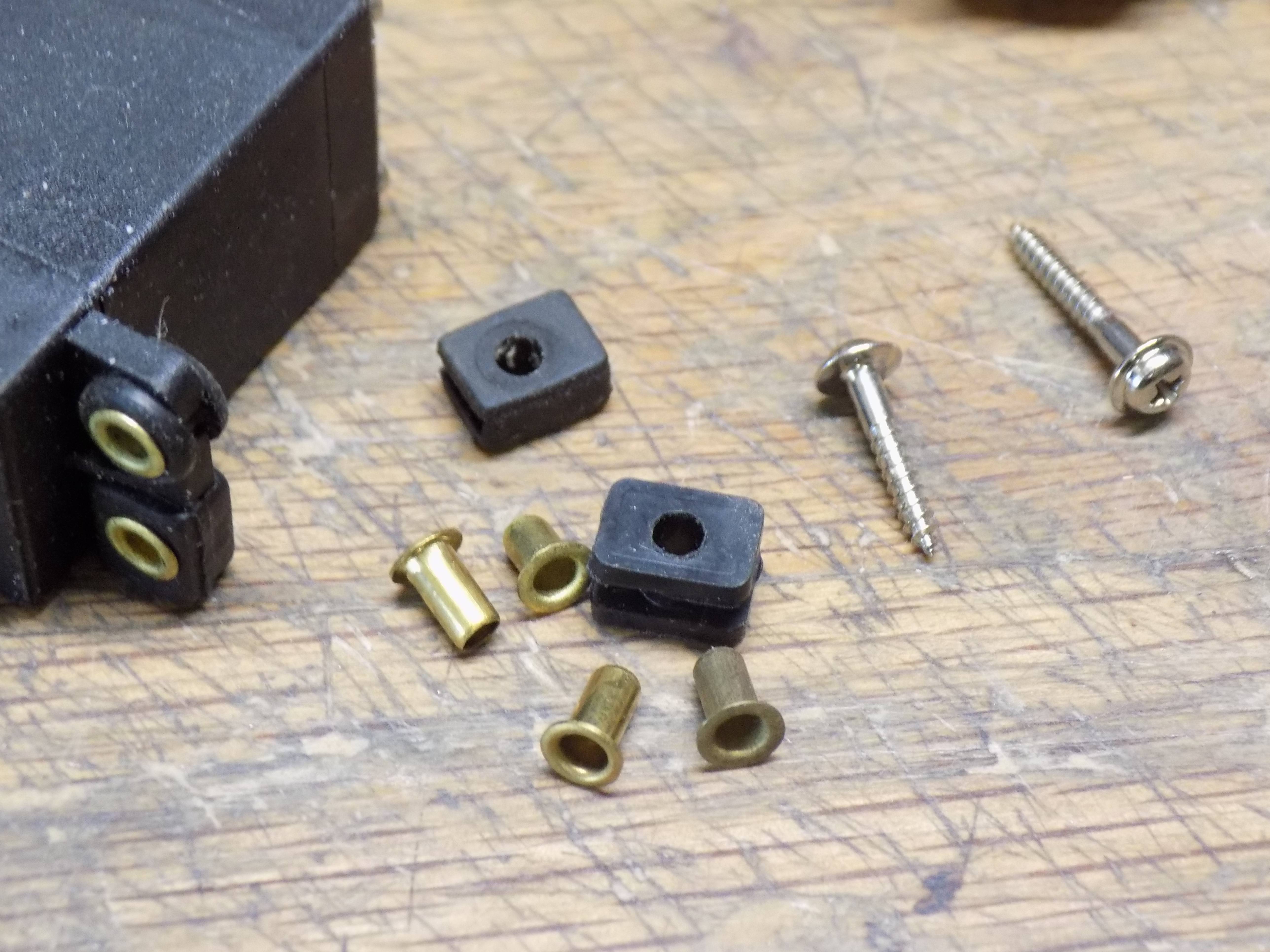

Small misunderstanding. I was looking at the linkage. Which looks like it would also work with a servo.
Re: Heng Long StuG III
Those are the servo sleeves and wood mounting screws. Simply drilled a hole in scrap plastic and pressed the sleeves in (and a dab of CA).

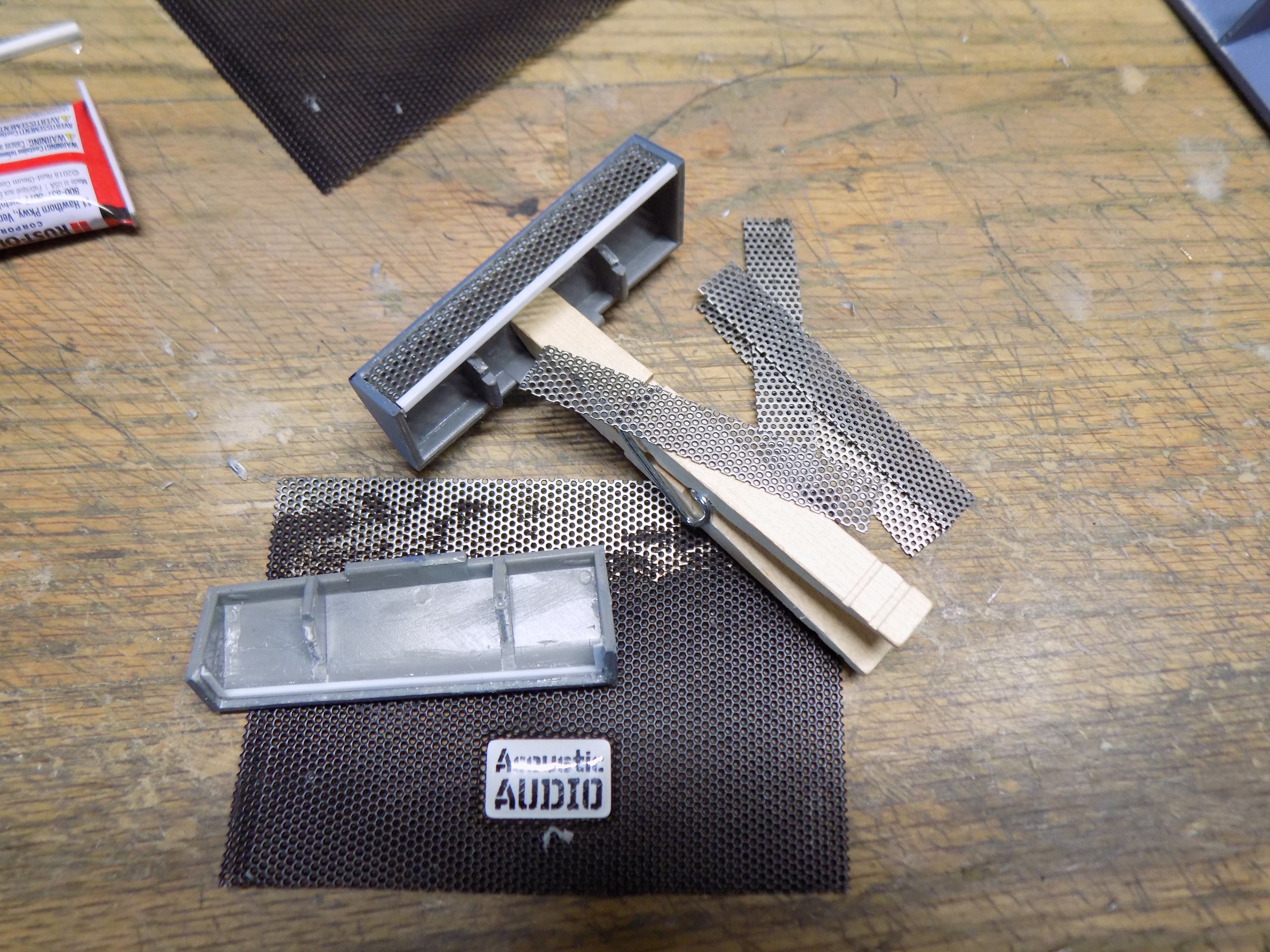

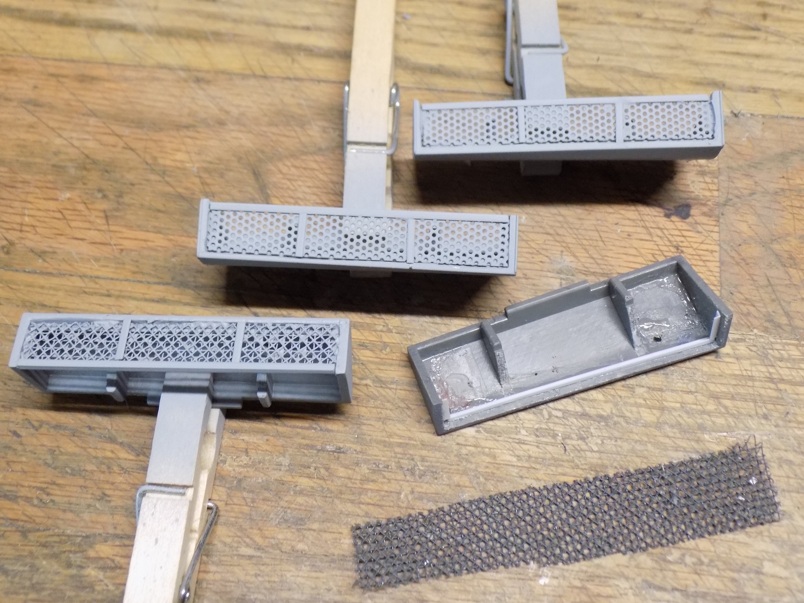

Working on a couple ways to make the vents better. One is a speaker cover with coating removed. The second is two layers of aluminum screen one layer turned 45 degrees from the other. This time I used staples to hold layers while polyurethane was drying. The urethane makes the wires slightly thicker and glues the layers together.
