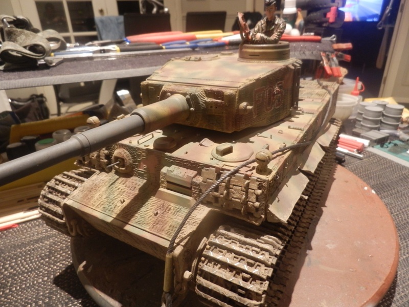

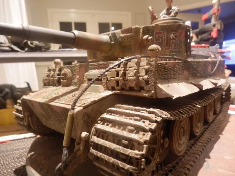

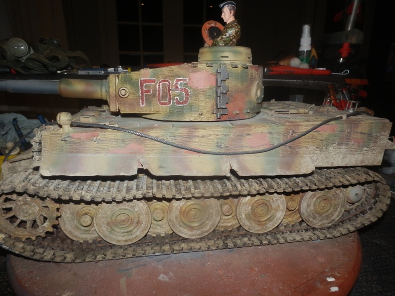

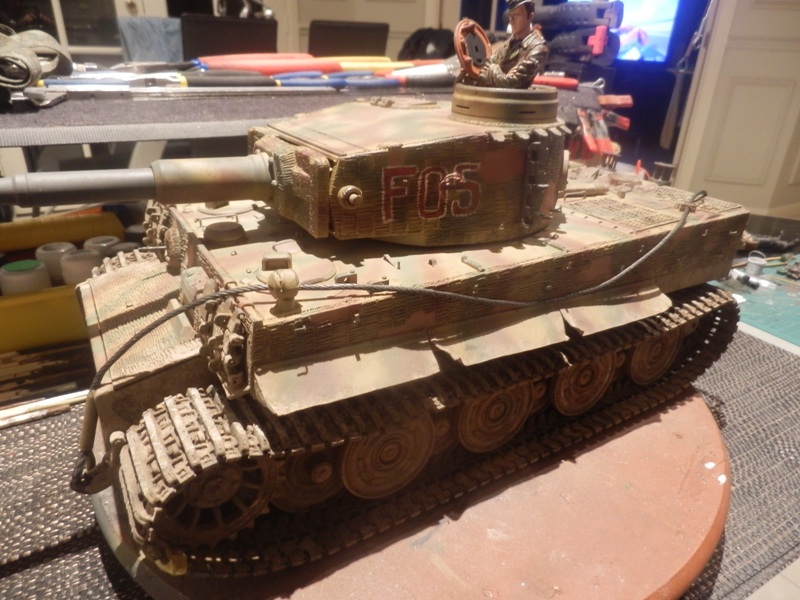

Almost done now.
Ran a full battery through it on a test run.
Have a bit of adjusting to do on the left track, but it ran without fault.
I've added a tow cable in the ready use position, just need to blend the pigment on as required to get the joints looking right.
Perhaps a steel helmet, but other than those, its done.
