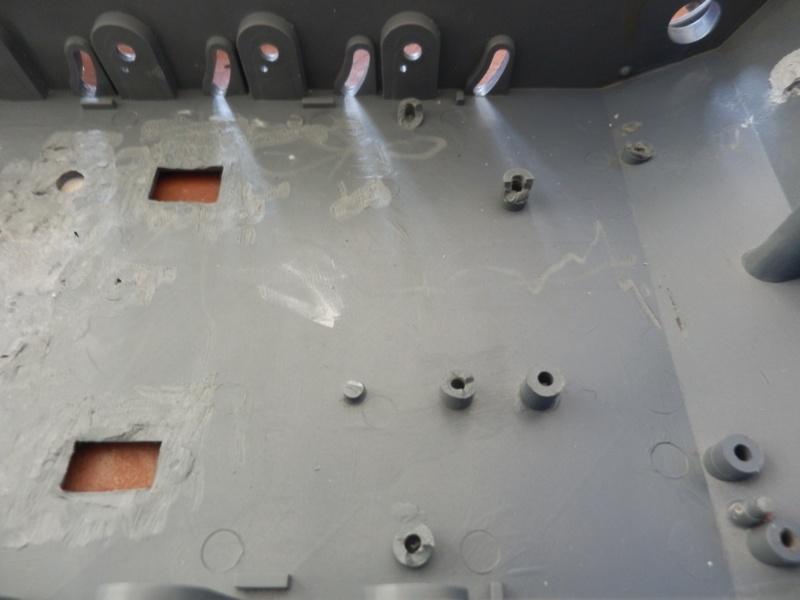

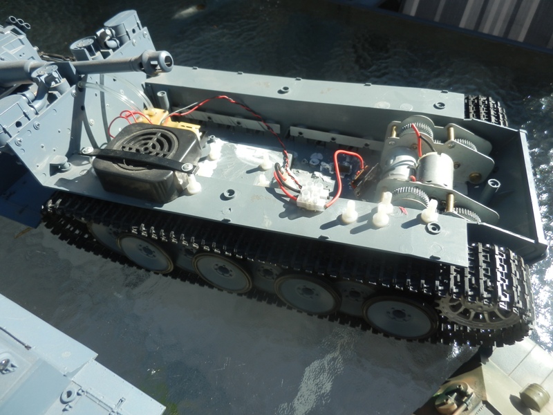

Gearbox mounts broken off is the biggest pain.
I will try and recover them, but at a pinch I will buy a new H/L lower for $14 and be done with it !

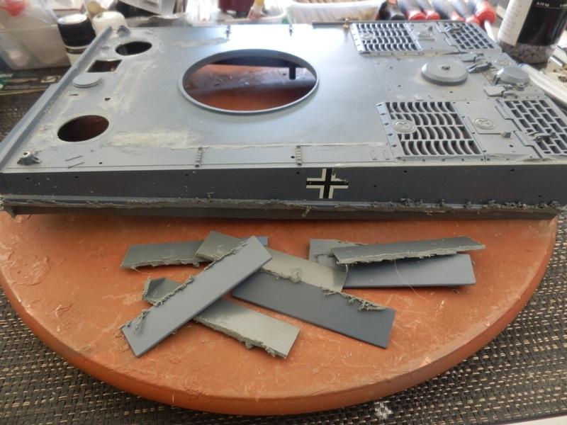

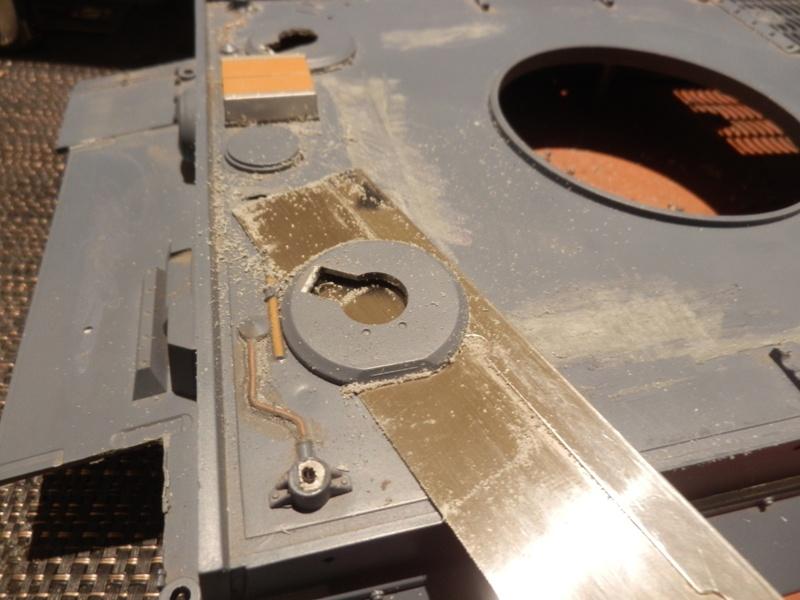

Get the thing apart, and slice the hatches off. - check
Hack the mud guards off - check
Grind the tools off - check
Fill in the holes as required - check
Rip the exhausts off the rear plate - check
Love the hack N slash part of a project................... :shifty:
Gearbox mounts smashed

My Ryobi loves H/L plastic !!
I agree on the metal hull concept, but its still simple cost/benefit.
How much you use it, how much you are prepared to work on a standard one to keep it running V's an all metal one............
I have all metal running gear on all my tanks, but retain the plastic hulls.
Outside of wishing I had installed good quality tensioners in them, all of them are intact without fault.

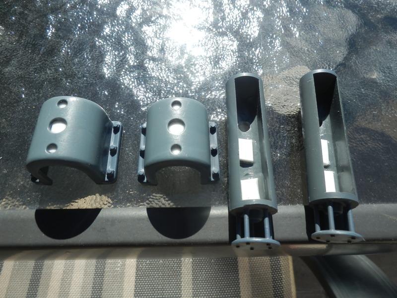

I got into the exhaust mods today. I want to have the tubes exposed with no guards fitted.
As the mounting of these by H/L is not conducive to a simple clean remodel, some alterations are required.
I filled in the screw holes on the armoured shrouds and the exhausts.
Once dry, I shaped a bit of brass tube (toobe for you left hand drivers!)and secured these into the exhausts poking into the proper outlet below the covers.
Carved out a bit of scrap to fill in the gap, filled the cavity with PVA and then super glued the strips into the voids.
I will alter the rear plate to allow correct positioning of these and texture the armoured shrouds.
