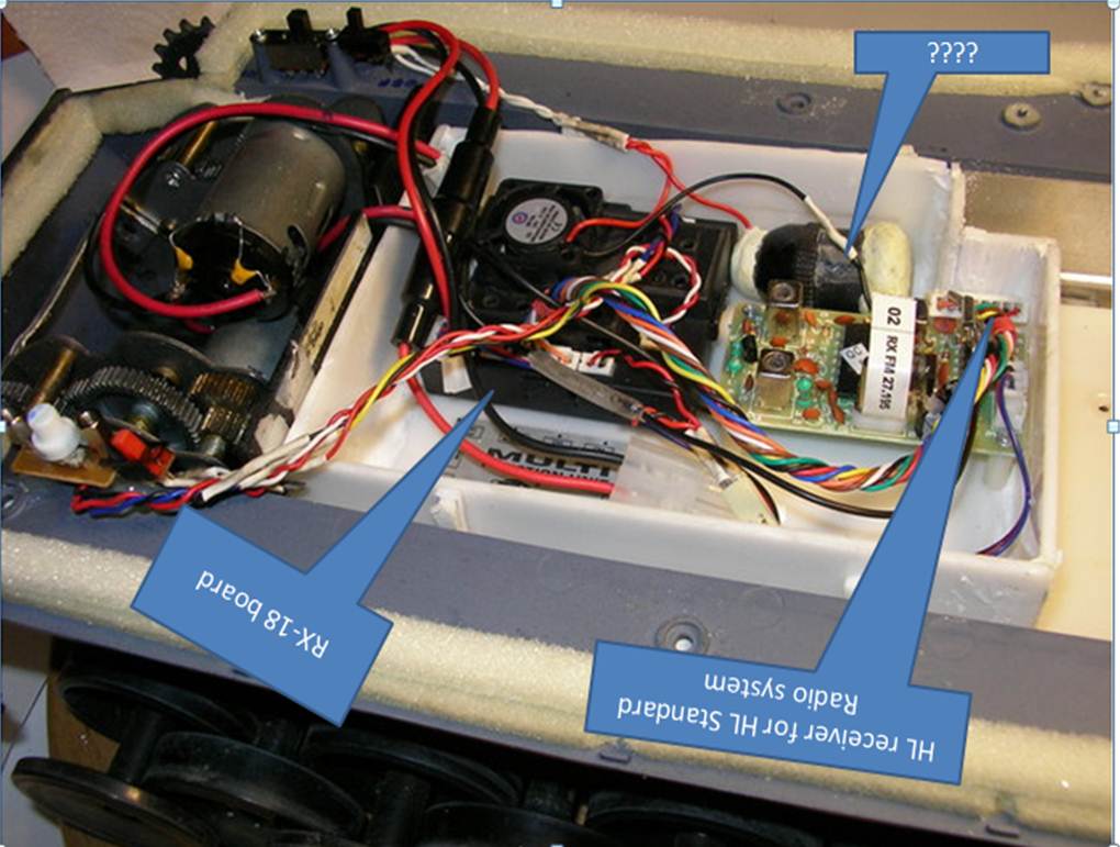

I am interested to know you Tanks Spec what electronic items you use in your Tank Currently ...at the moment this is the latest Pic i get from your link that you give me if you have the latest pic you are welcome to share with me :thumbup: .....
Can you tell me what the purpose at the pic which i mark as (???)

Hi Syrulizan, In your pic marked with the ?? looks like it could be a separate power supply for the cooling fan....?? Does the cooling fan start when you turn it on if there's no battery in the tank...?? I have never seen that sort of set up with the cooling before..

Reaper332 wrote:Hi Syrulizan, In your pic marked with the ?? looks like it could be a separate power supply for the cooling fan....?? Does the cooling fan start when you turn it on if there's no battery in the tank...?? I have never seen that sort of set up with the cooling before..
Ken
Hi ken
Actually please be inform the pic above is not belong to me it's belong to Jussek, Recently i confuse :crazy: with the (???) also.. I'm still waiting jussek to give some explanation regarding the pic. :think:

this pic is very old! Reaper332 is right, it WAS an isolated power suply made for the little 25x25mm fan i had on the RX18, because it was running on 12V
But this was not a viable solution, so i eradicated this and installed an 5V 40x40 fan, it is receiving tension from the RX18 itself.
