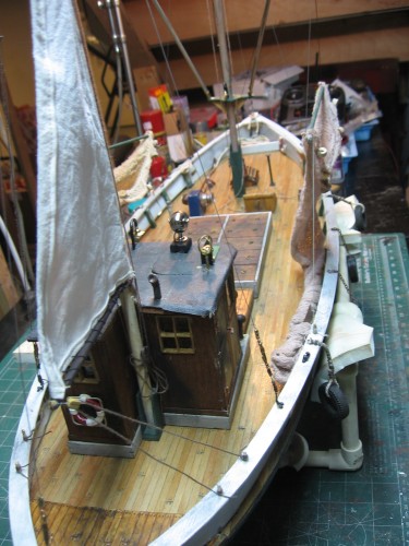

Picked up Artesania Latina Hellen Rc Ready Model # 20203 off ebay with two row boats for 179$. It was close so I picked her up and saved on shipping.
It was built about 10 yrs ago and need some major rebuild. The hull is a VERY thick GRP. I took everything apart and repainted the hull, re-planked the deck, rewired and added lights, redid the rudder servo and most of the internal structure as the decks were sagging.
Re-did the standing rigging, running rigging, extended rudder for RC, added lead, waterline and a bunch of other stuff. Came out pretty good. Had her out in a stiff breeze and she handled great......
enjoy..
enjoy..

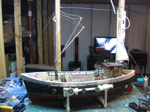

some more pics...
The original kit is 279$ plus shipping...wow..too much. All you get is a nice hull and a few bits of cheap hobby ply. Better off getting a hull from Microglass and building your own boat.

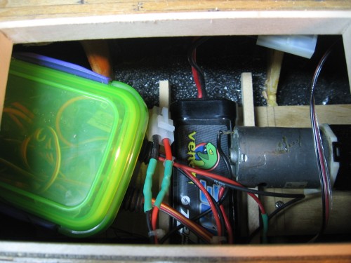

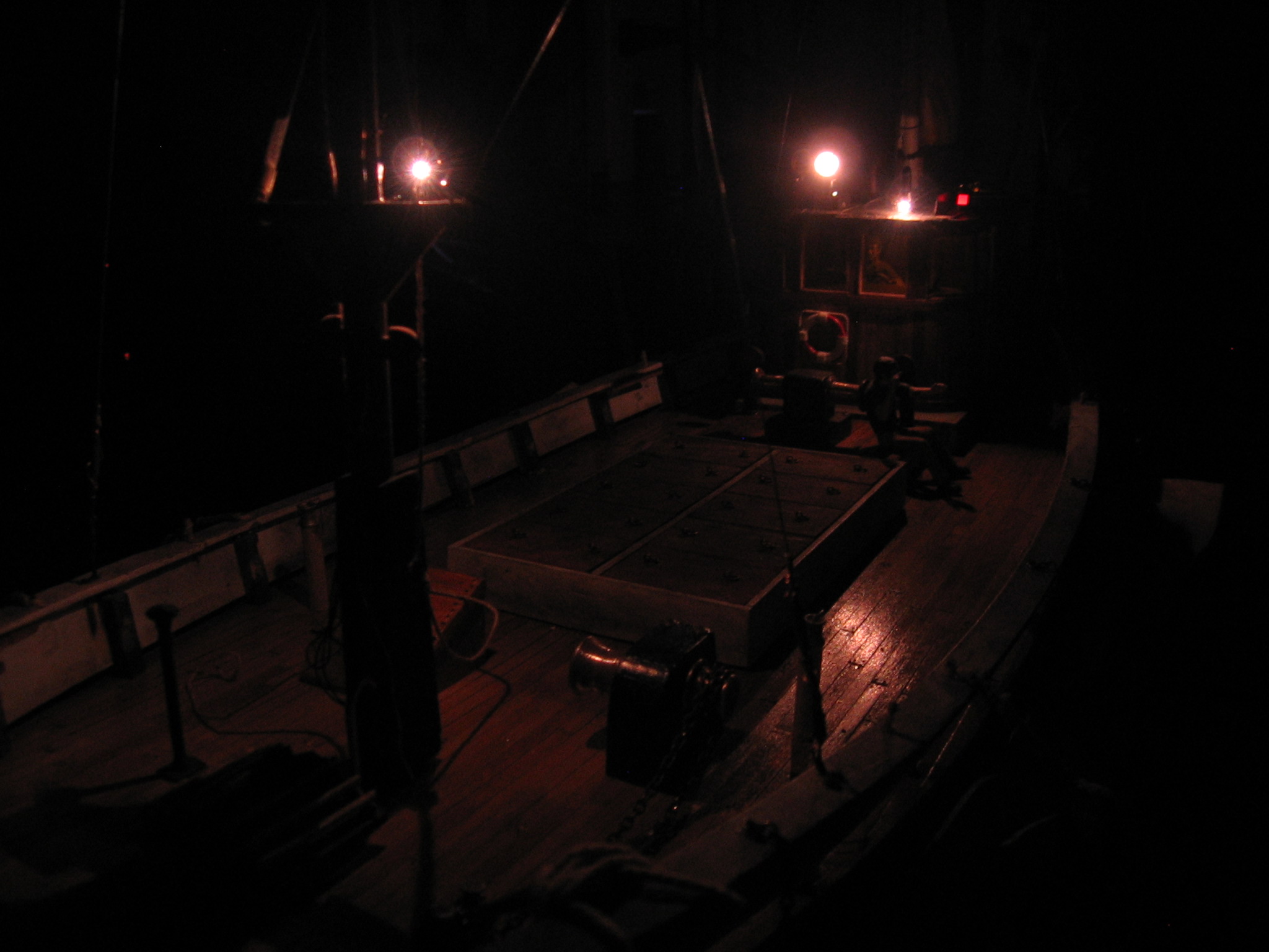

Motor is 550 can style with gear reduction drive. I use the landing gear option on my remote to run a micro relay so i can turn the lights on and off......
Basic rc speed control (cheapest i could find). The lights run of 3v system separate from 7v battery running the servo/receiver/motor
Great model about 38 inches long. Tires and light relay and lights from Harbor models. FAst shipper!

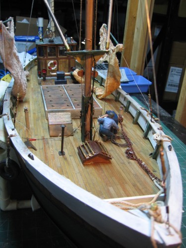

I really like that - the tyres are a great addition and the planking looks superb.

thanks Steelhammer. Had to make a tool to do the nail holes..Each board is cut for size...two days of basswood planking and a good hour to tap them all in. Accentuated with very thin enamel flat black (wipe on, wipe off)..then two coats gloss poly with sand between each coat...then a light spray of testors dull...
I left a few areas of original planking in deference to the original builder (his were balsa)

The deck wench is a nice touch with the crewman working on that piece of equipment. Never built a trawler but this is a nice change,and I very much agree with your sentiment.Ships, Boats, aircraft, it's best to have a wider experience,and try new things.
