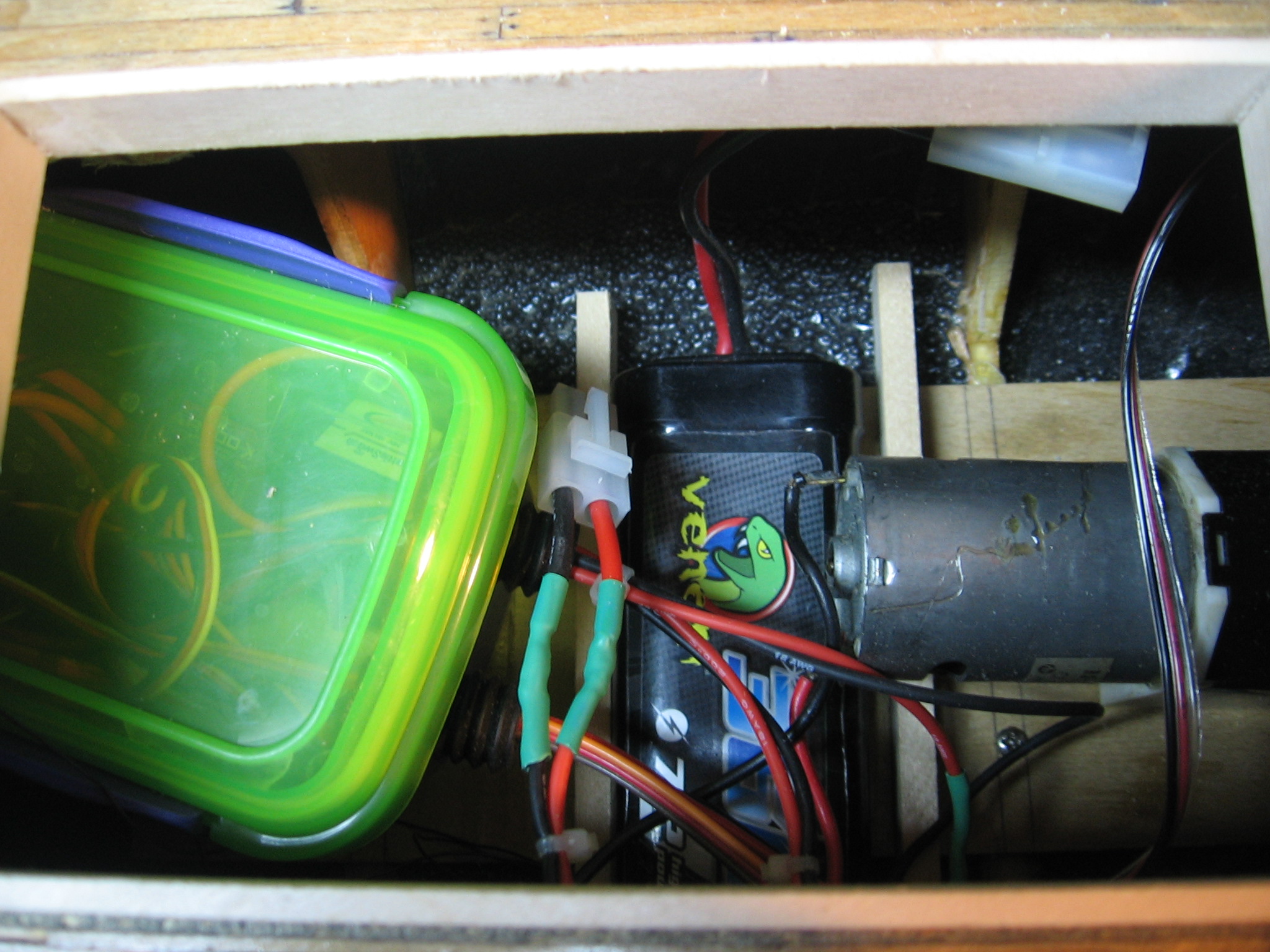

Motor is 550 can style with gear reduction drive. I use the landing gear option on my remote to run a micro relay so i can turn the lights on and off......
Basic rc speed control (cheapest i could find). The lights run of 3v system separate from 7v battery running the servo/receiver/motor
