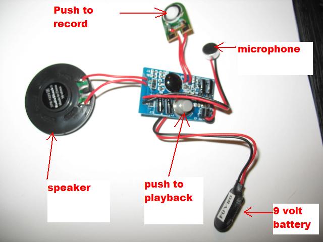

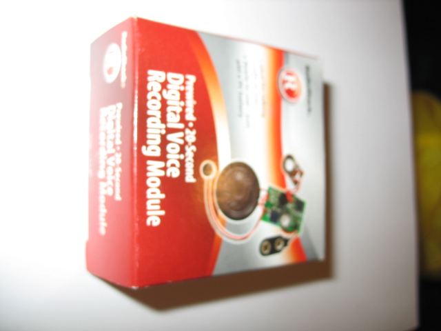

I am just thinking out loud here as I am not familiar with this style of airsoft gun.....
But how about removing the 'Airsoft' firing cylinder the part that acts like a plunger in the hypodermic syringe then you could remove the large spring at the same time..to cut down on the noise,this will mean that the motor will run much more quietly as it is not straining to compress the spring.....as far as a delay for reloading, I am not quite sure what you mean, so I will put this in as a guess.................how about using a gear wheel high up in the drive train that will be moving slower and either modify it or extend it through the casing to fit a cam wheel...this could then activate a switch on one of the cheap little digital recording modules and this could play the sound of a large calibre gun being reloaded I got mine from Radioshack dealer in the uk, this is a link to the item in the USA
http://www.radioshack.com/product/index ... Id=2102855" onclick="window.open(this.href);return false;
Is this of any use to you ??
