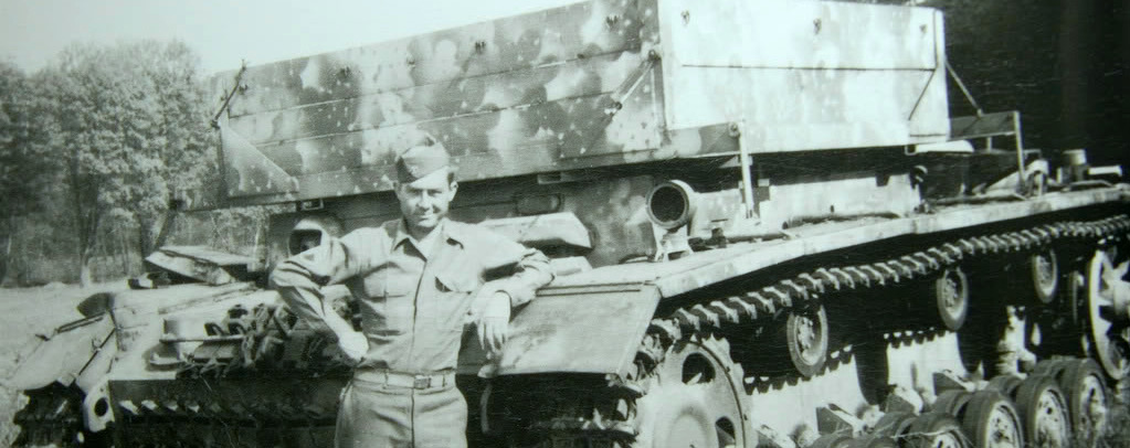

I have just found this style of Camo-paint that I have never seen AT ALL before and I thought that some brave soul might like to use it on their tank..it is a very interesting effect, AND you can use a Stencil !
The principle seems to be to spray the vehicle in the usual fuzzy edged colours of green and brown over a yellow base coat, and then apply the stencil and over-spray AGAIN with the yellow base coat. I think that it produces a really interseting and different finish to the Panzer.....it is certainly out of the ordinary !! :~
Alb.

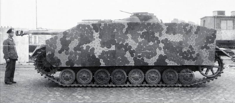

THIS IS THE CLEAREST PHOTO THAT I HAVE SEEN AND SHOWS THE PATTERN VERY WELL...ALTHOUGH PERHAPS A BIT 'FRESH' AND NEEDS WEATHERING DOWN...ALSO NOTE THE LARGE NUMBER OF DOTS PLACED INTO THE NONE STENCILED AREAS OF COLOUR !!
CAMO PAINT ON AN AMMUNITION CARRIER

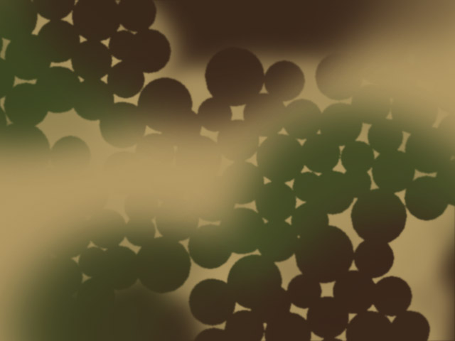

STENCIL AS SUGGESTED TO BE USED...ALTHOUGH TO ME IT IS TOO DENSE WITH CIRCLES COMPARED TO THE TOP PHOTO..!!

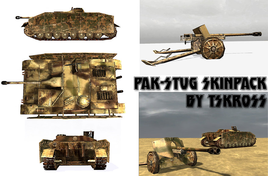

SKIN DESIGNED BY AN UNKNOW ARTIST FOR A 'FIRST PERSON SHOOT'EM UP GAME' USING THE NAME OF TSKROSS

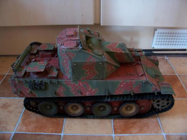

hi there
nice find
will this count ?

Hi mcevoyi , :~
Its a beautiful conversion, but I am sorry to ask you is the tank really that red ? It seems a bit 'distinctive' to have that colour on a battlefield.....are the crew expecting to live long,or since they are an Anti-Aircraft vehicle is it a double bluff to sucker in dive bombers ??
mcevoyi
Posts: 2297
Re: New to me Version of German Camo Paint Style
Post by mcevoyi »
hi there dietrich
lol.. it looks red on my crap pic ....
but it realy is red brown and no so in your face ...
the folks that saw it at the mvt show love the paint job ...
i so wish i was better at doing photos ..
iain
