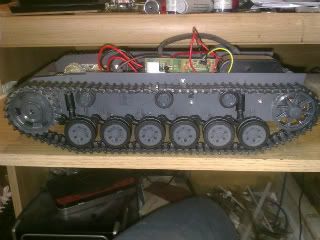

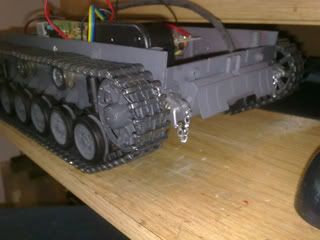

I have finally gotten around to putting the big pile of bits on my shelf together.  I have stripped my Panzer III's chassis down and replaced the suspension and tracks/sprockets with metal parts.  I decided to fit track tenshioners as I thought they might come in handy, and they were found to be essential!  Brass 3 to 1 gearboxes finished the job and I fitted the new S&S kit I bought for it last year.  Its working beautifully however the noise from the right hand gearbox is a bit grating!
   Its all been painted a more authentic colour too.
Next job is to rework the top half, got a lot of detailing I want to do on it!
