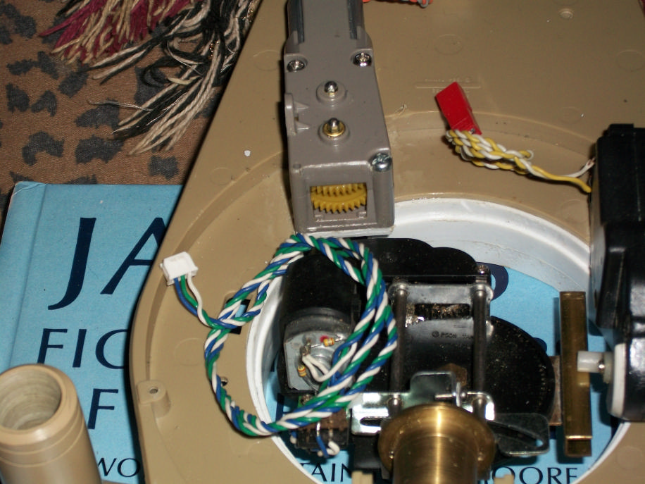

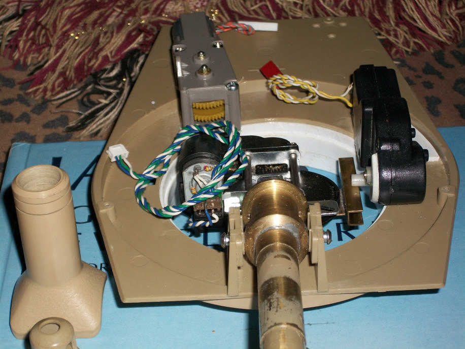

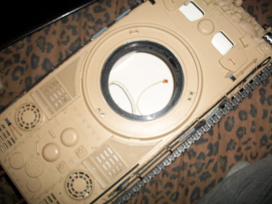

This is my Porsche turret layout,it was designed by another member named Bubbajoe. It is cramped but works,the ring gear is mounted in the lower hull,the small gearboxes are from Tamiya's learning mechanical line of products,they can be built in 5 ratio's and work very well for rotation but the best part is the turret will lift off in any position,
Thought maybe this would give you some idea's concerning your Panther II Build. If you keep the standard rotation the recoil mounting saves space as does the elevation gearbox. The pivot can be made from Brass tubing and the King Tiger inner turret pivot assembly.then the recoil can mount forward leaving you turret room behind it,recoil at best is less than 30mm so this arrangement does save space and works very well.
