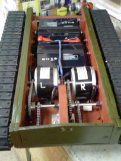

It is only a scratch build, stand off scale (about 100 metres). Not accurate. Roughly modelled on my Heng Long Pershing. I have only done the lower hull so far. I have had it running. I get about an hour from a 12V 22 AH battery that also runs my homemade smoker.
Phil

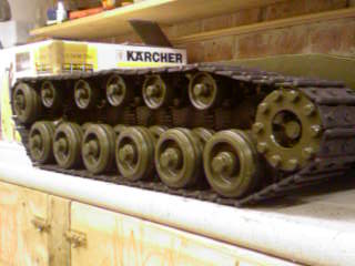

Tracks made from door hinges. Homemade TRIPact speed controller allows me to control it from just oine stick on the transmitter.

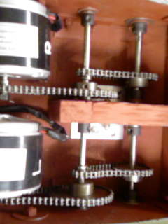

This picture shows the gearing system. It gives about an 11:1 reduction which provides enough torque to allow it to climb 40-50 degree mud slopes easily.
