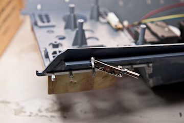

Keith spent sometime before your email looking at photos and parts and finally figured it out. After attaching the right side, I measured the left side starting from the back and attaching one holder at a time to make sure the skirts line up. Taping the whole set and marking positions, leaves a little to much to chance with tape moving and the hole not lining up. Keith thanks for responding, looked at your skirts, your skill is out of my level. Amazing work Keith. Thanks Greg

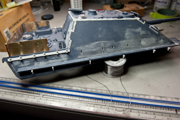

Heres atop view of it

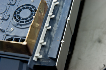

this one shows the skirt gap

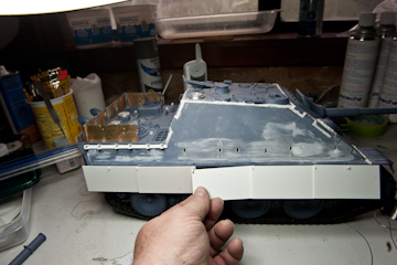

here is a problem if glue the skirts in place I can't work on the wheels if I need to. If I don't as you can see they fall off very easy. Any suggestions for attaching them, but still get them off?

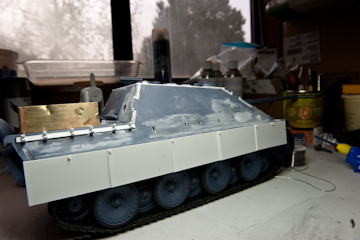

here an image with tank on hull with skirts on

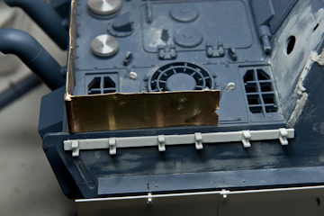

holders in place
holders in place
I used clips to hold in place and glue them in place

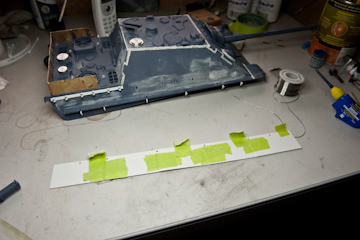

taped  the skirts, then placed on the side and marked the skirt holder positions.
