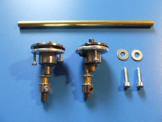

i fitted the tensioner that saxon metioned but found this had problems to
have a look at this
tensioner
tensioner

If everything aligns (wheels, tracks, and arms etc..)under compression and rebound position, it is probably that your tracks loosen enough when the suspension compresses. A combination of tensioner upgrade and front and rear swing arm spring enhancement will probably do it.
