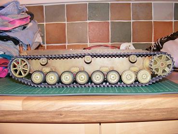

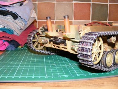

Hi Andy are you going to fix the incorrect return roller ( to high ) next to the rear idler and reduce them to 3 rollers per side as well as raise the drive wheel a couple of mm to look correct ?. On my "paper Panzer" I undertook these "simple"
modifications and even added a flanged 8mm bearing to support the drive axle. I would also recomend the rear idler adjuster Steve sells as it's fantastic with metal or plastic tracks to get that magic sag over the return rollers. Also made late style exhausts as I think these look so much better than the drum type exhaust IMO. Then I just went nuts with the upper deck
. Plenty of pictures so I can pinch errrr get some ideas for a possible later build
. If this build turns out half as good as the Stug it will be a cracker. All the best for now

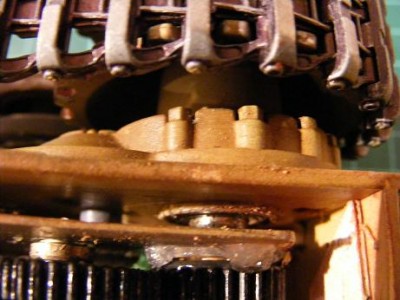

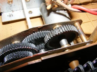

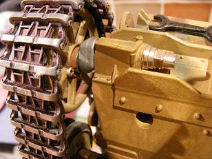

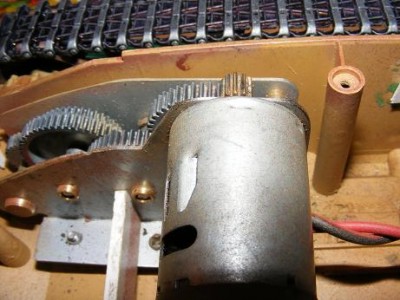

Re: Asiatam Pz.IV
Not that big I will post some pictures later. I wanted to put bearings in to support the drive shafts so all I did was raise the gearboxes by a few mm with plastic shims then mark where the shaft,s new position was. I then lined up my bearings on where the shaft had moved to and marked round them. Got the dremmel out and made a rough hole inside the mark then hand filed the rest away untill the bearing dropped into the new hole put the gearboxes back in then a spot of superglue on the bearing flange to keep it in place. As I said I also had to adjust the front mud guards up a little to avoid track fouling. Hope that helps
Alan
PS you have to trim the gearbox casings down to allow the top to fit. That's why HL dropped the sprocket by 3mm
Alan
- Front sprocket raised 3mm
- panzer Iv chassis 002.JPG (40.3 KiB) Viewed 996 times
- Rear idler adjusters from WDM very good
- panzer Iv chassis 001.JPG (36.31 KiB) Viewed 996 times
