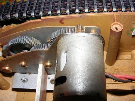

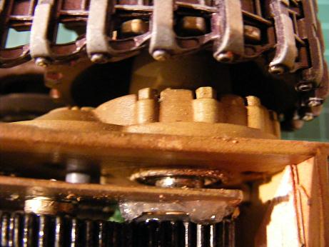

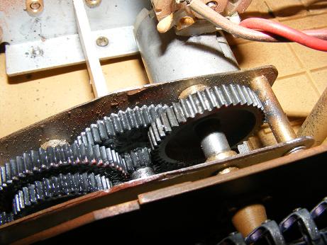

Not that big I will post some pictures later. I wanted to put bearings in to support the drive shafts so all I did was raise the gearboxes by a few mm with plastic shims then mark where the shaft,s new position was. I then lined up my bearings on where the shaft had moved to and marked round them. Got the dremmel out and made a rough hole inside the mark then hand filed the rest away untill the bearing dropped into the new hole put the gearboxes back in then a spot of superglue on the bearing flange to keep it in place. As I said I also had to adjust the front mud guards up a little to avoid track fouling. Hope that helps
Alan
PS you have to trim the gearbox casings down to allow the top to fit. That's why HL dropped the sprocket by 3mm
Other gearbox trimmed to fit
Gearbox casings cut down to allow top to fit
Bearing in place
Bearing in place

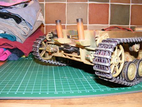

Late rear exhausts (scratch built from a pen )
