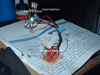

The prototype Animated Tank Commander Control Circuit works. This is a picture of the very rough prototype.
The lower board has the relay, resistor, transistor and 4 diodes. The other round board houses the reed switches and provides a motor mount fo the 58:1 6VDC Gearhead Motor. It also provides a mount for the figure.
During the I also found a way to pop the commander out and place another figure in. I am making some PCBs this week and hope to have the final version done by the weekend.

Friends,
At Long last the Final design for the Working Tanker PBC is Done!
The board will measure 1 3/4" X 1 3/4" That is just about as small as I can get it.
Is there a common tank (ie) H/L, Matto, Tamiya that will have trouble finding room for the board?
From the board you will have four leads runing to the turret. These will be attached to the the two reed switches that tell the guy to start moving and when to get back to his starting point. The board will need a momentary pulse from either the RX-18, or the ElMod. RX-13 and 14 guys may have to tap off the MG. The gearhead motor is powered from 7.2 volts. This is a 12VDC motor but works just great with the 7.2. That along with 58:1 Gear ratio makes for a realistic rate of motion.
I wonder if that motor can be adapted for turret rotation? Hummmmmmmmmm.
In addition and quite by accident. The mounting design for the figure, makes him kinda loose. I was worried about that until I accidently moved the tank forward. He moved backward like a real person would if the tank just started out. So I left it as is. It looks really great! As soon as my son the Chef is done with the ole digital camera I will get some video of him operating with the prototype board in Tiger 1334.
Once this little project is done and I heal up. The next will bethe driver that lefts the hatch, raises up, lowers his arm then looks around. Then when ordered, lifts his arm, and shuts the hatch as he lowers into the hull.
Then I hope to have a break dancing loader.
