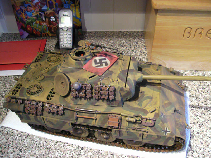

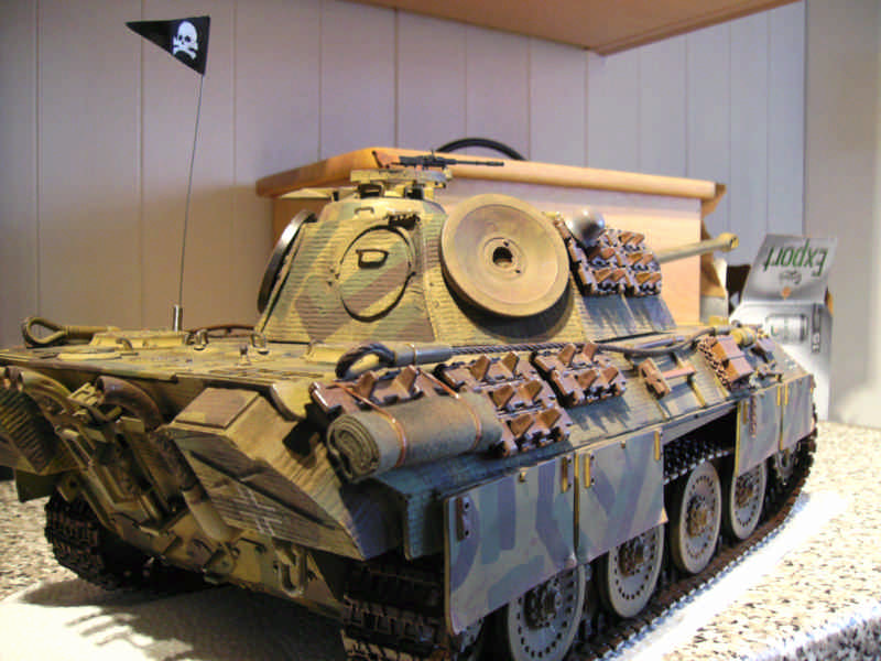

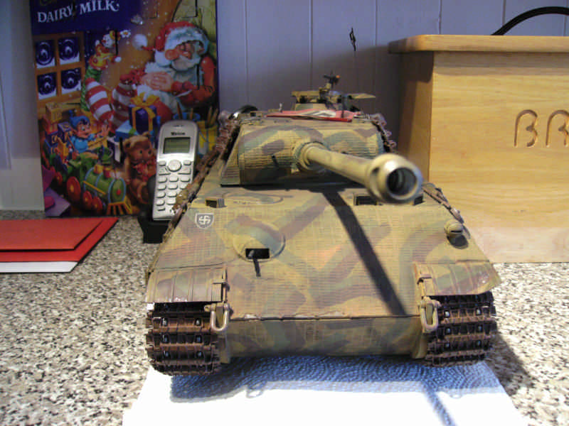

HI, just a few photos of my pantiger project started build the build in feb 09,problem after problem i know it is not correct but it looks better than when i started the build.

Hi Now that dose do look great compared to the orginal Pantiger,well done . :thumbup: :thumbup: :thumbup:

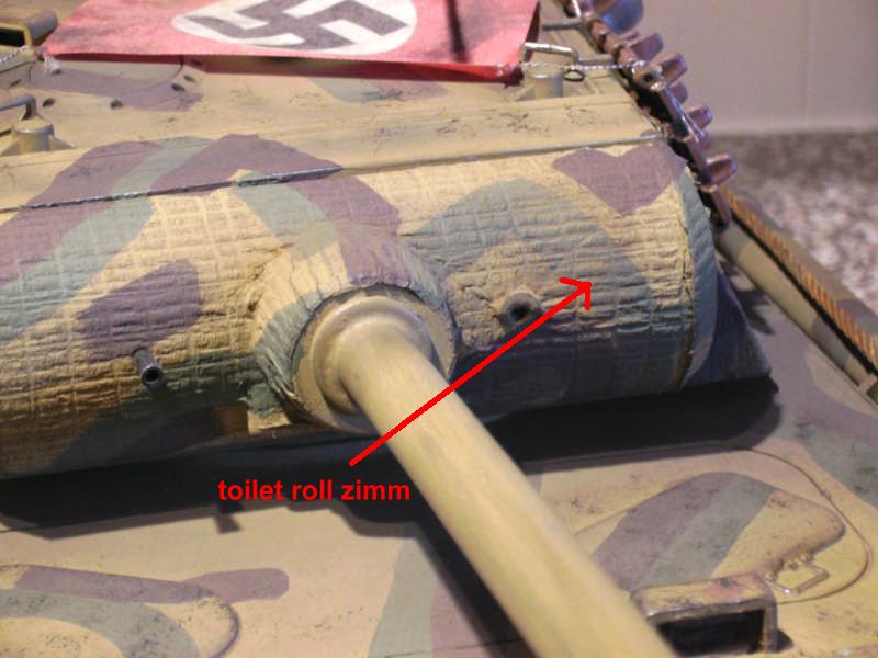

Looks great MT, the bog roll zimmeritt works a treat, love the paint job too, and as Pete has pointed out, it looks a damn sight better now than it did when you bought it originally :D :thumbup:

Hello MT1,Looks pretty good to me.If you think about what you started with and what you have built I say damn fine work.The wheels seem to be Panther dished,and the correct wheel pattern.How about some more photos if you get a chance,mainly interested in your rear panel mods,look good from what I can see.You might be interested in a site I posted in the reference section,all models of the Panther on this site.EXCELLENT WORK,MT1 cheers Blake

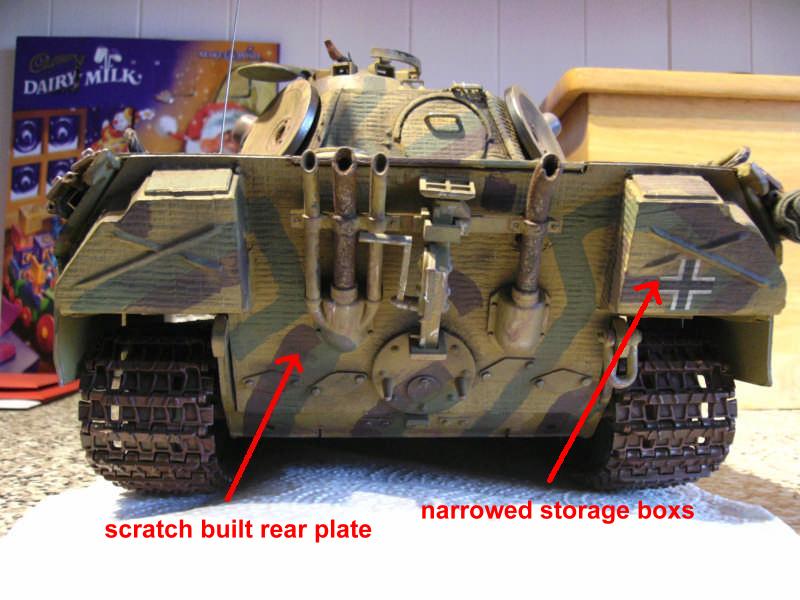

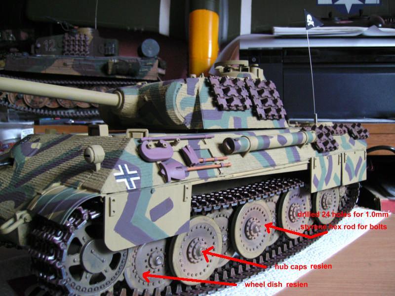

a few more photos of my modifications to pantiger. :think:[]

Mt1 Nice work on making your pantiger look a lot more like a real panther

That is a fine job MT1,thanks for posting the pictures of the all the details.Rear panel is perfect,very well done.The wheels had to be a lot of work and look great,just excellent.

Very nice build mate as a fellow Pantiger guy . Your work is very good mate . As Im sure you found out theres loads of errors by HL on this . I bought my Pantiger years ago . Its the S&S version . But Ive compleatly re done mine to . I did alter the original HL turret but wasnt happy with it so I cheeted and bought one of Daves Panther G tops and used that turret. I had to remove the late war fittings and the chin . But it looks ok . I narrowed my tank but going on the new improved HL Panther G it needs another 5mm of the width but not messing any more with it . Ive altered my one to a late Ausf.A model. I chopped the Pantiger tub to so that I could zimmerit above the wheels plus by making the sides have the A wedge on rather than the G sloped edge it showed the incorrect tub . As for the wheels I to used resin plates and added the bolts one by one to , what a night mare . I did have to get my dad to alter the inner wheels so the dishes fitted . And recently I bought a set of Tamiya wheels , oh well there going on another project . did you fit narrower tracks ? Im using Daves ones for the Panther G . But you have done an excelent job on yours :thumbup: . Ive just got to spray mine now . Ps I like your spray job to . Well done.
