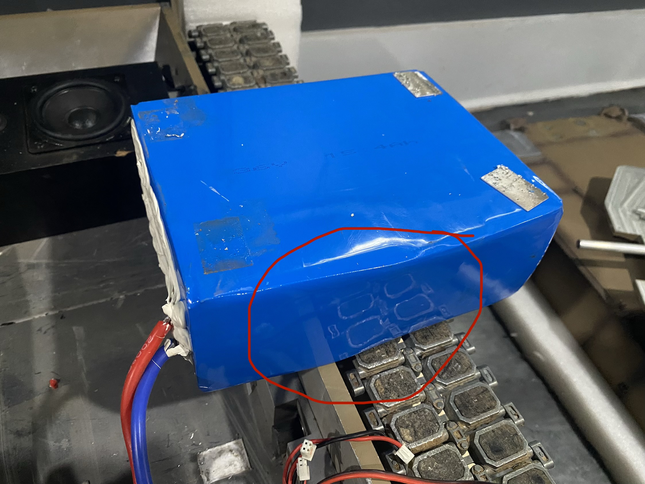

I’ve got a 1/8 scale metal tank, 130+ pounds. In this tank I’ve got a 36v (charges up to 40v give or take) 15.4 Ah Li-Ion (I think) battery that came with the model originally. It appears to have a BMS in it because it has a little lump off to the side of the battery near where the cables come out.
From here the power travels through a 40A fuse (I installed this) and then into a 40A DC breaker (left over from the original electronics that came with the model) that acts as the on/off switch to the dual motor ESC and the turret rotation/elevation ESC.

Once it dropped into this range, I found that if I pushed the model kind of hard, the power would cut off all of a sudden. When I examined the tank the power/breaker switch was still in the on position. I found that if I turned the switch off and the back on again, I would get power back as normal. But, then if I pushed the model again by driving fast, the power would cut off again. The more I did this, the less fast I was able to drive the tank before it would die again. I eventually figured out if I kept the speed low, I could drive it back to my house without it dying again.

Do you all think the breaker is “tripping” even though the switch is still in the on position and not in between on and off like a traditional house breaker when it trips (at least in America), or do you think the BMS is saying “Danger Will Robinson!” when the amps begin to rise and the BMS cuts the power?

More than likely it's the BMS. The BMS will limit current draw and cut power off when it starts to drop the cells into a dangerous level. I say dangerous as in if lithium based cells get below a certain voltage per cell, the cells become unusable. If they are drained beyond that level, sometimes a fire hazard can occur with some battery packs. Sealed Lead Acid batteries also experience problems if they are drained too far, but they typically don't have a BMS which limits the current draw. An SLA battery can also have internal battery damage when drained to low. In your case, this may be a case of a battery that might not have enough capacity for the amount of runtime you want.

Man I wish I knew. I tried to bug their customer service about it, but basically all they could tell me was what was printed on the outside of the battery. They said they got it from some supplier and that it was a lead acid 36v 15.4 Ah battery. It doesn’t look like pictures of other LA batteries I have seen pictures of online, so I was skeptical of this.
I’m only guessing that there is a BMS because there is a little lump on the side of the battery that looks like there would be one, customer service was no help in figuring this out for me. But whatever it is, it is underneath the plastic, there is nothing for me to see or interact with.
If there is a good way to figure any of this out please let me know.

- Circled in red is the lump I’m talking about
