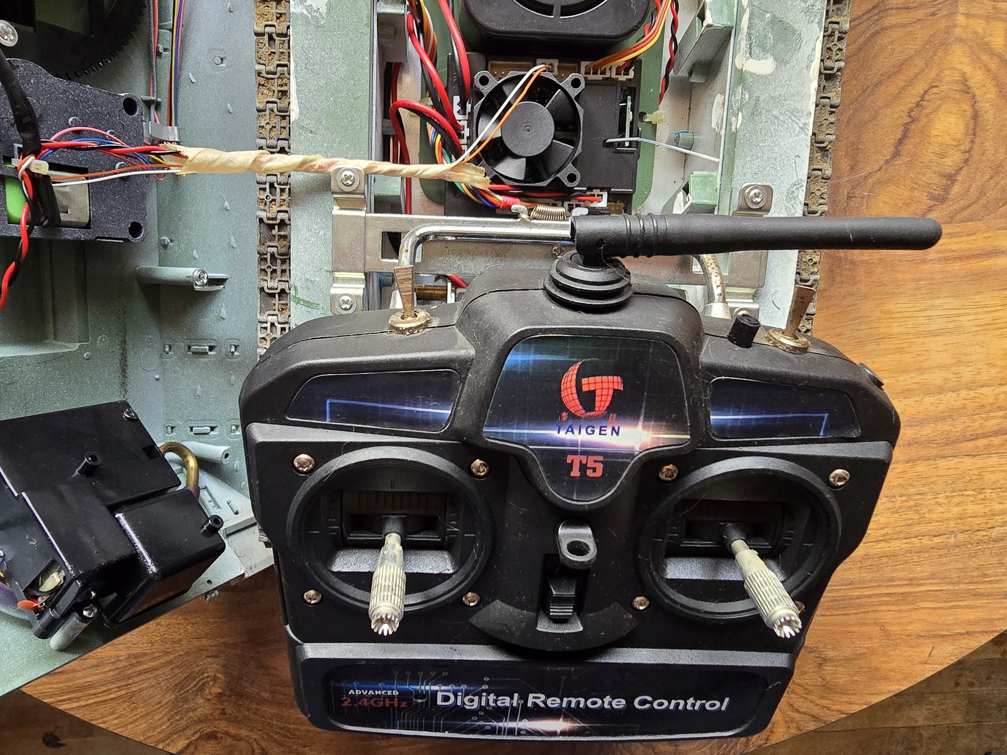

Stormbringer
Posts: 665
Re: Suspension adjust on T-34 Heng Long
Post by Stormbringer »
Heres a picture of tx and mfu
It is the metal plastic version and is how came out box
