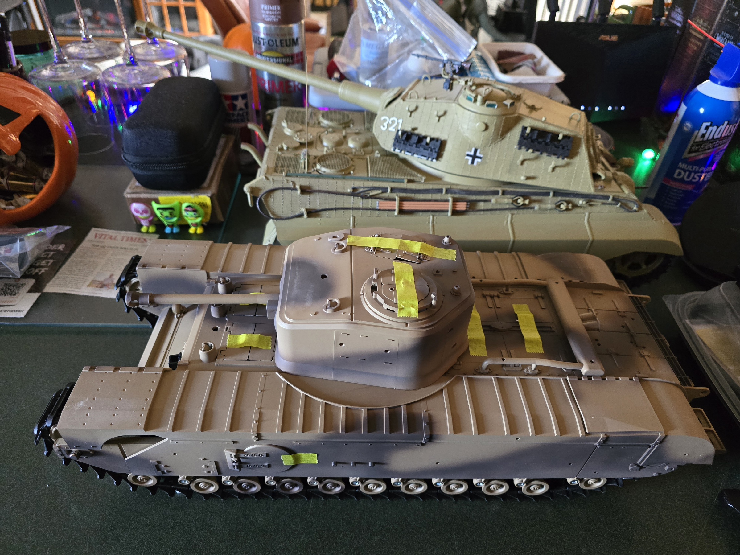

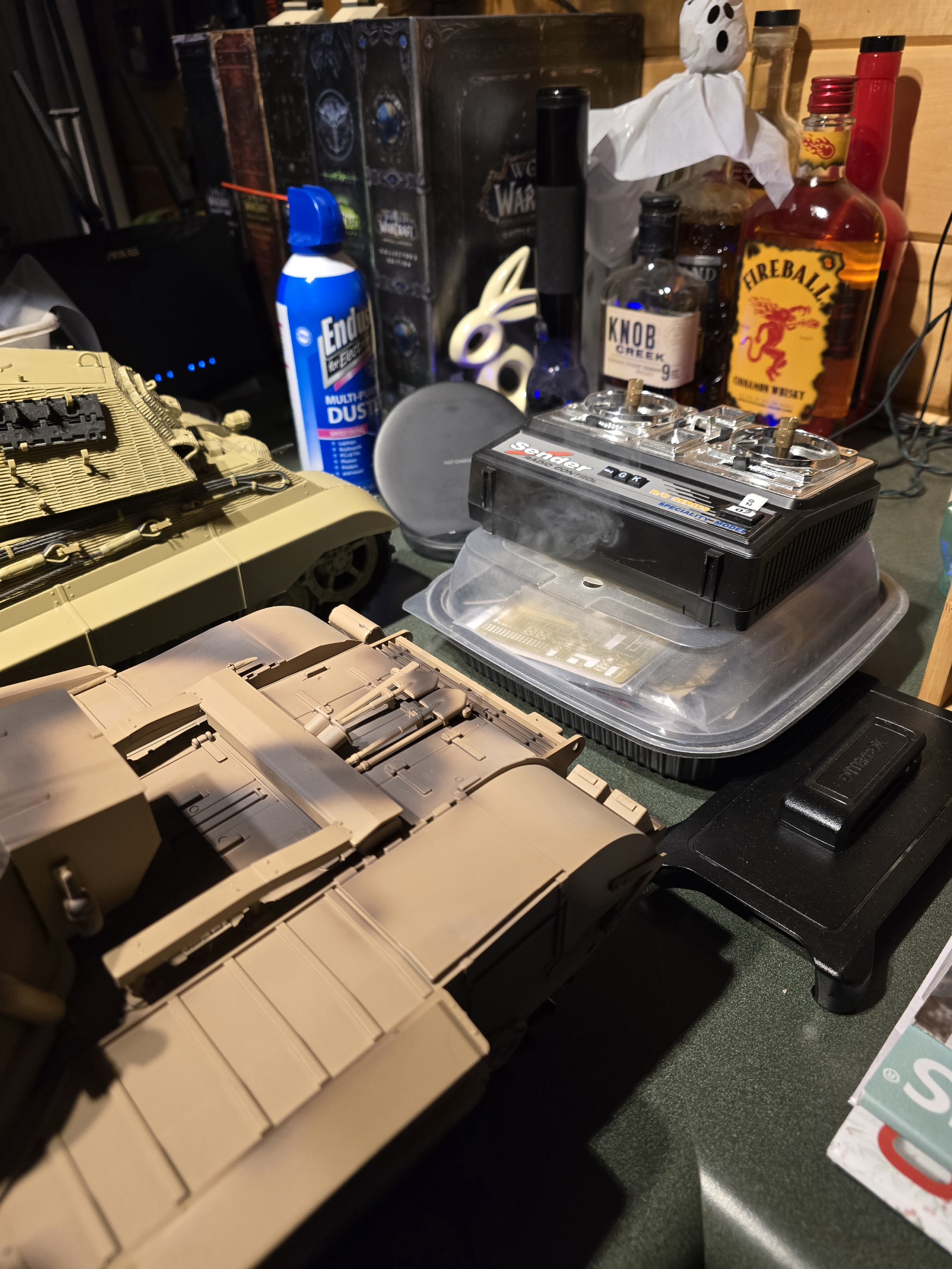

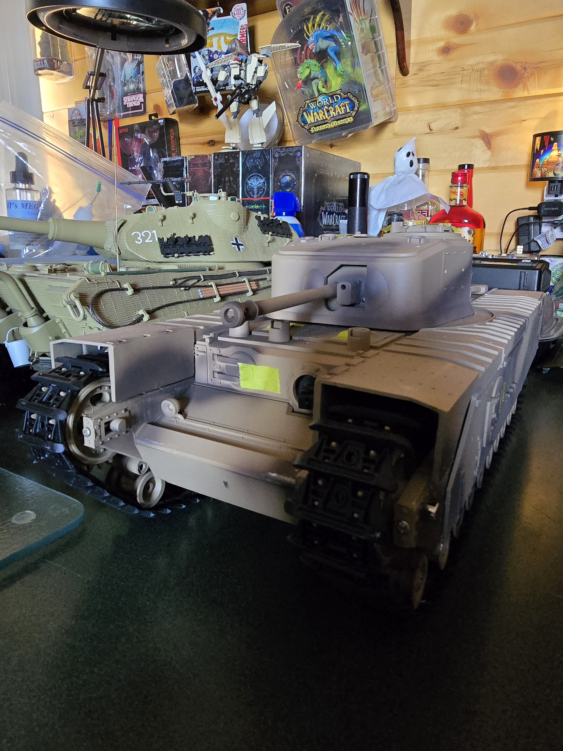

Familiarized myself with the Tongde Churchill today. Controller does a lot and is similar to the latest HL controller but seems flimsier somehow. Does a lot of setting variations through button combos. I reset it so I was sure that I was using the Tank settings, not an 'Infantry Vehicle'. Got the minimum firing main gun recoil adjusted and startup and mechanical sounds including MGs to my liking and left it alone. Spent more time than anticipated getting the basic detail bits attached. Most needed glue and or the 'holes of attachment' drilled out a bit. This tank will benefit from some good details and figures when I sit down to do the Build on it. A Tip: I spent some time drilling out the part A5 MG barrel to give it a better appearence only to discover it does not transmit the light from the Besa MG. I found two HL - like MG barrels in the track links parts bag and used those. I'll have to find good working bbls for those MGs come Build time. I charged the battery since it showed up almost dead. The paperwork calls it a Lithium battery but does not distinguish between Li - Po, Fe or On. I charged it as a Li-Po and it is at 95 % and works fine. Anyone know what type of battery comes stock with Tongde? Battery casing does not say so as well. Back to the King Tiger tomorrow.
P.S. The Smoker worked great out of the box!
