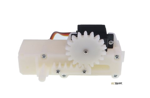

You can connect everything, but I'm not sure you'll fit it all in there. Have you considered servo recoil?
https://www.rctank.de/gun-barrel-recoil ... ation-unit

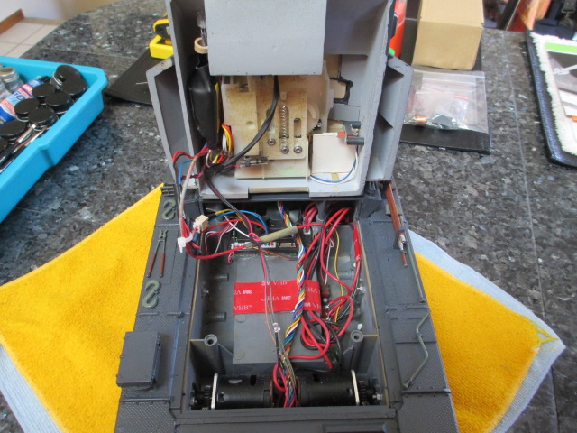

Yes it will fit and yes it will work. Key word here is work. My StuG Ausf B has the Taigen recoil. I fitted it because it came new in the Pz3 from Taigen that I used as a Base for that Combo Build.
But I did and it worked to add flash to the barrel of the MP 40 I used as the Aux MG
Not a lot of space to run a fiber optic cable..JPG (140.91 KiB) Viewed 692 times

PainlessWolf wrote: Wed Oct 22, 2025 12:48 pm Good Morning, MrChef!
Well thank you Mr. B.:thumbup: and of course Mr. PainlessWolf. :thumbup: and thank you for sharing that picture as well.
Questions though, did you mount the barrel directly to the unit or did you need to modify a bit? And if so do you have pictures of that mount or modification? It definitely looks like a job I'll undertake. Ironically looks easier than other things I've done that initially thought would be very difficult.
Thanks Kaczor, yes I've considered servo but would prefer to use this unit as I have a few. If all fits and works as Mr.Wolf attests then it will be a cinch. It's particularly attractive as to how the rewiring needs to be done is perfect for a Non turret tank.

Re: Stug III with Taigen Barrel Recoil?
Everything along with all textual griping, etc, should be here in the Build Thread. The biggest Bit of Issue came from having a nice Aluminum Short Barrel that came with the Resin Profiline Kit. The interior diameter of that Barrel was too small for the Flash Led provided with the recoil mechanism. I had to make up a different Barrel. Turned out Ok but stuck with me over the years. Here is the link: viewtopic.php?t=14564
