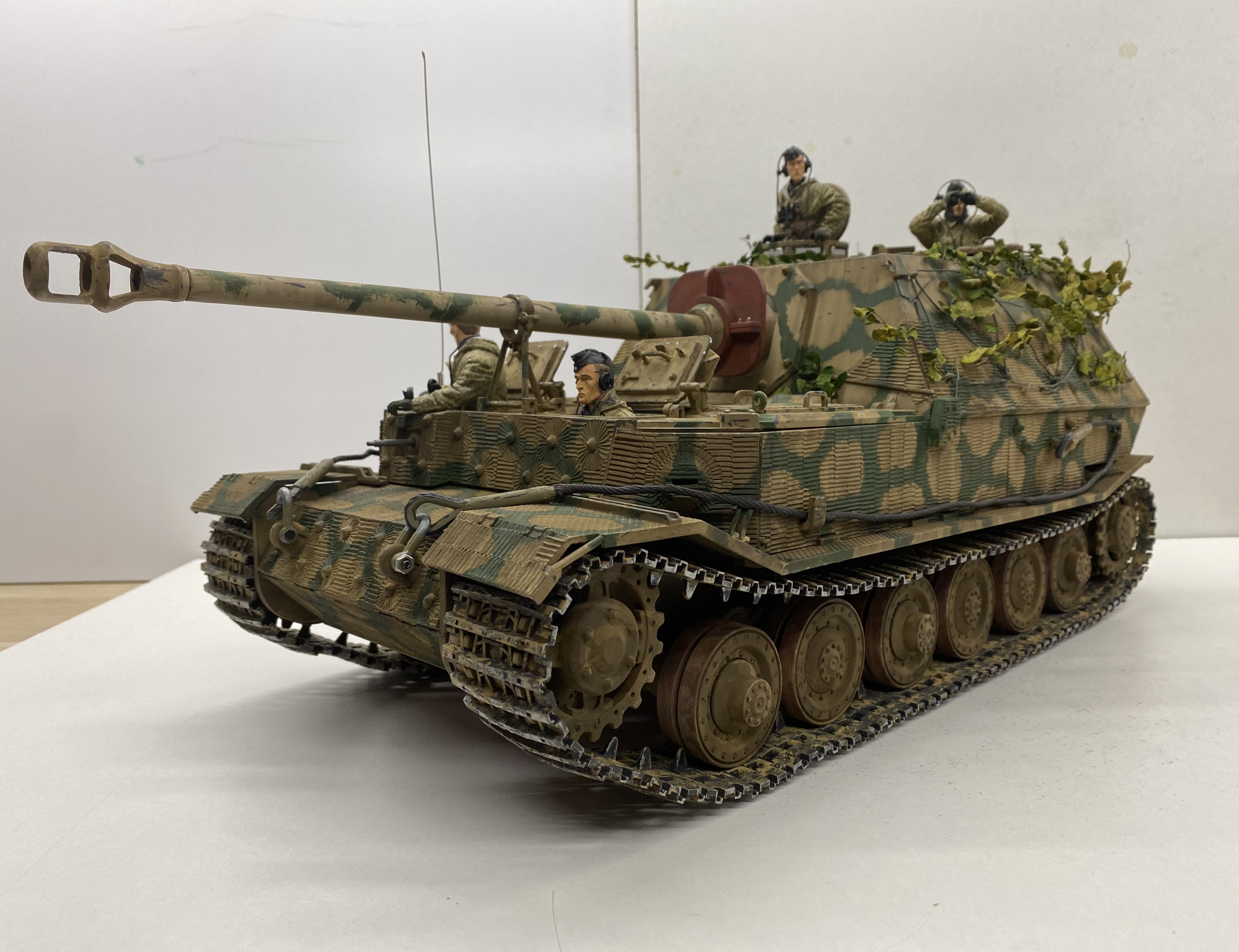

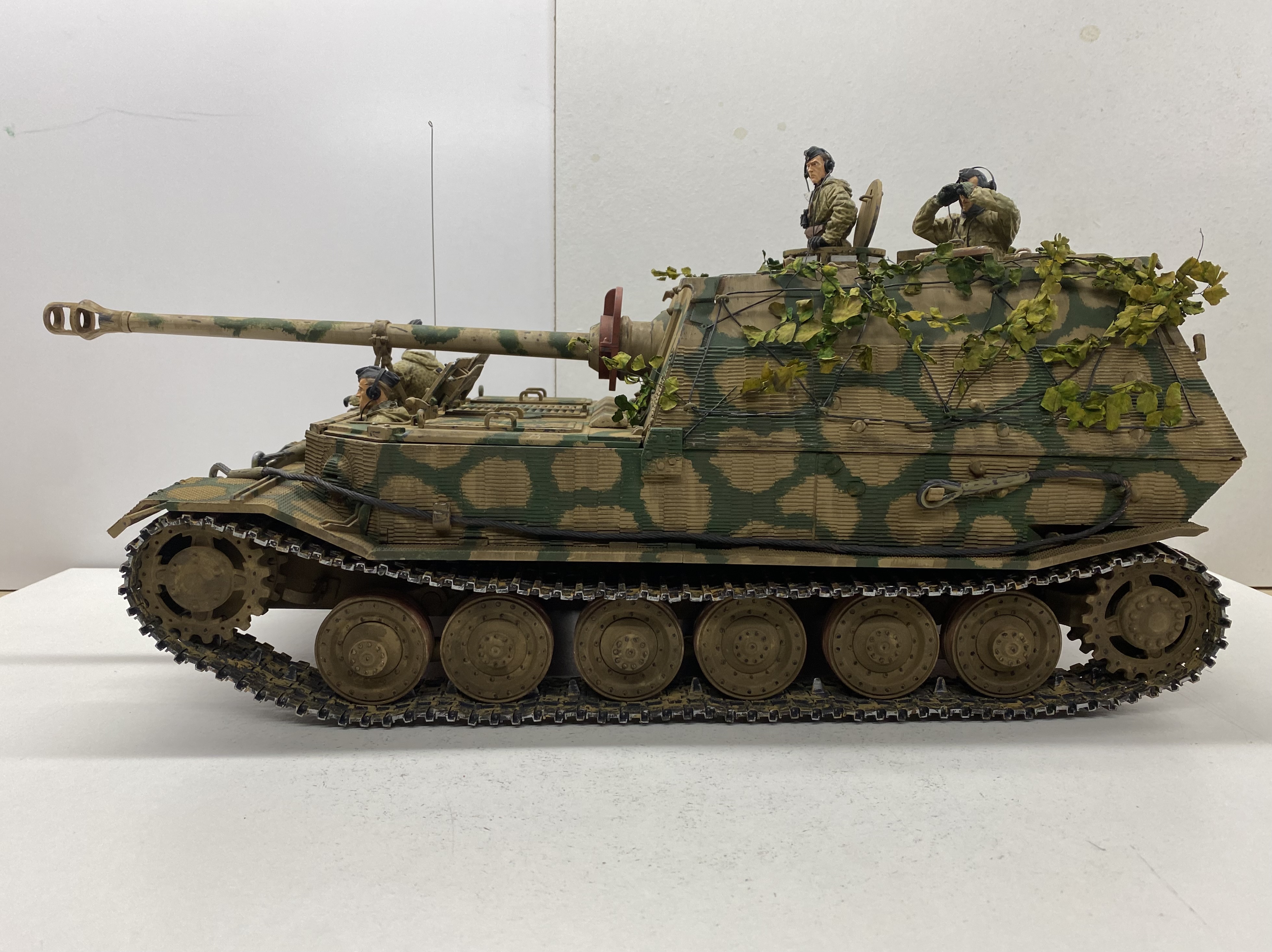

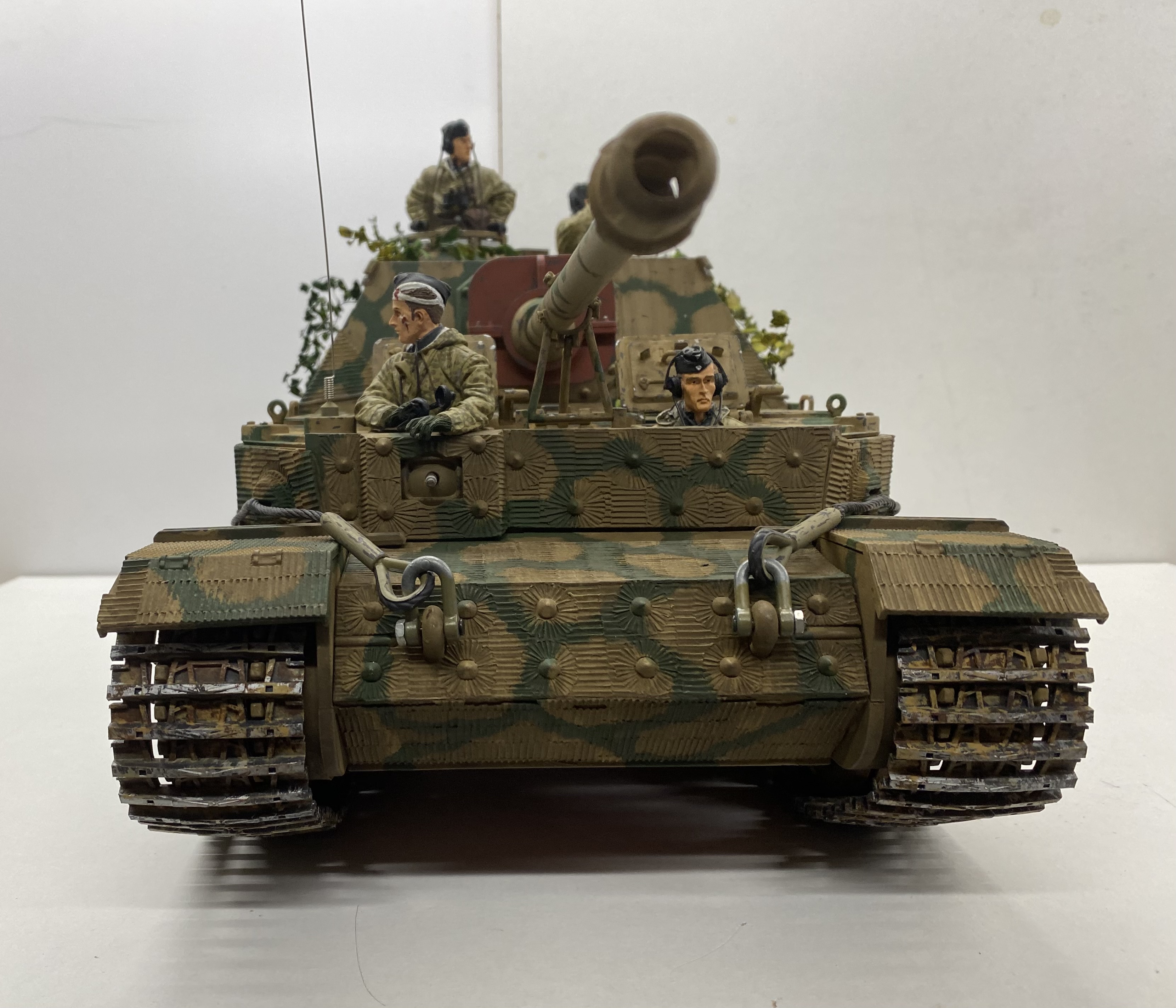

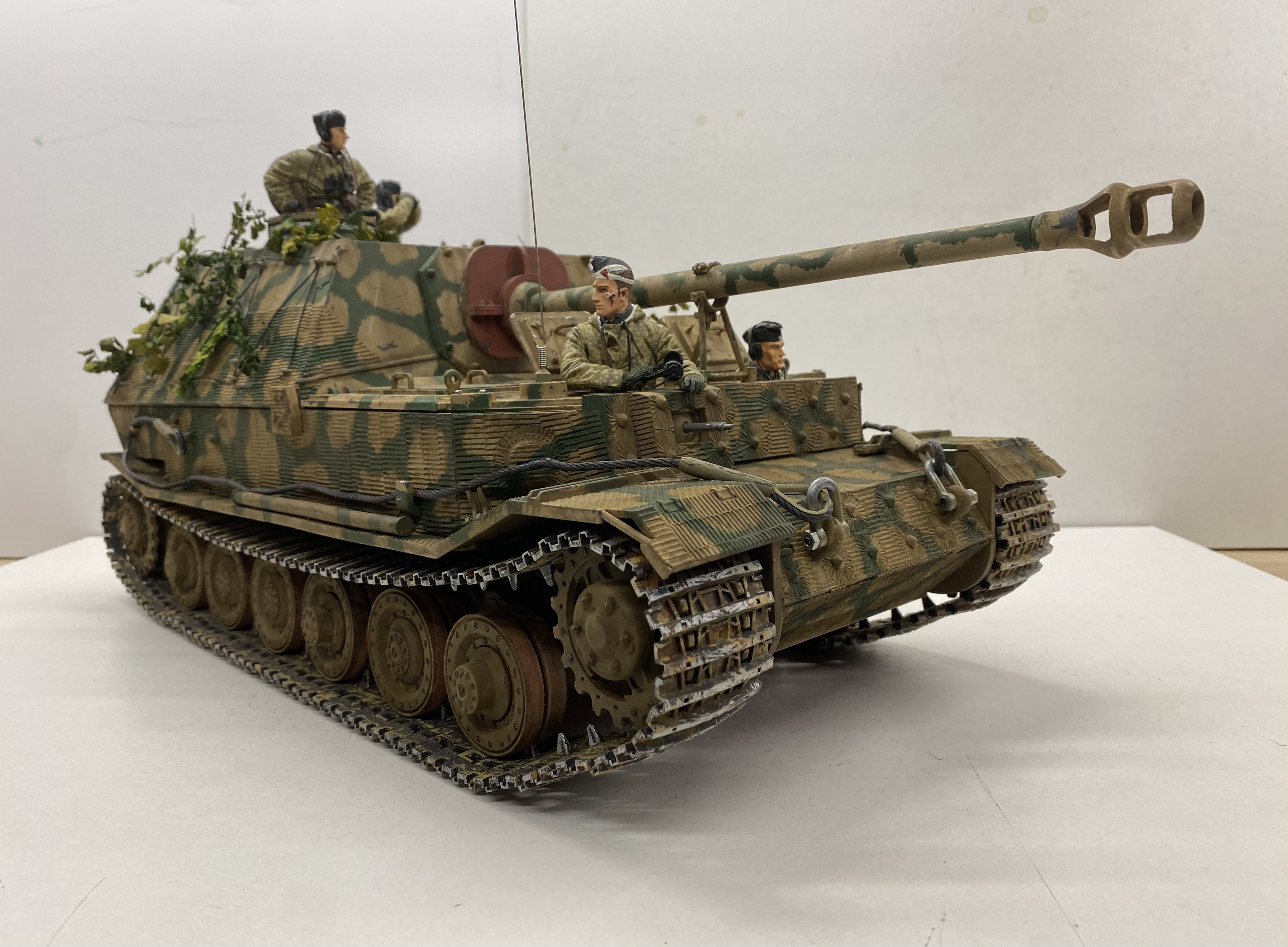

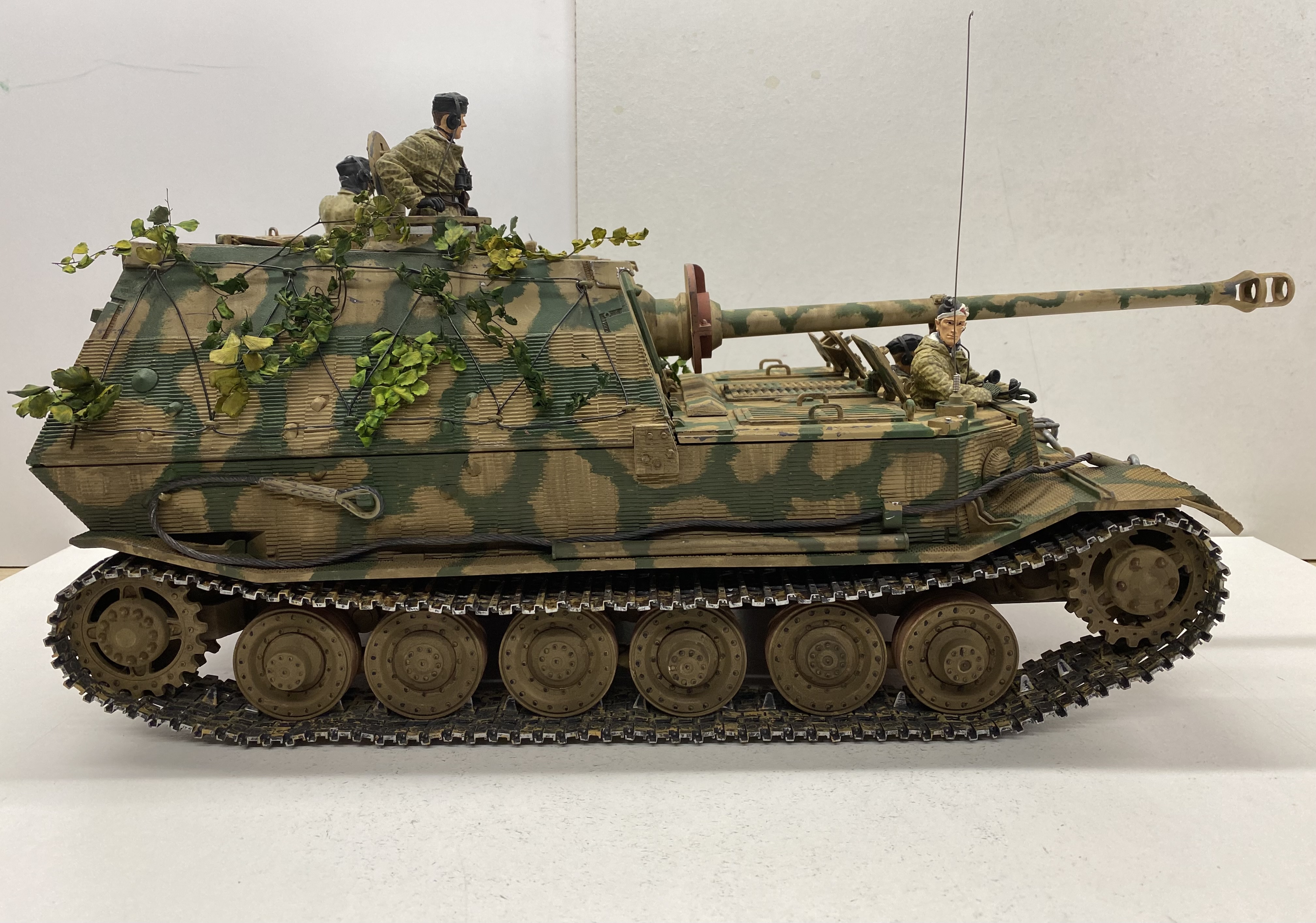

Finished this Beast last week:

Wow .Another beautiful build and as always a beautifully detailed crew to make it even more realistic. Rob you are a artist. :thumbup:

Thanks John!
But I got this model already build, from a friend at the German HLPF, almost 2 years ago.
It came complete with all the servos and so, to operate the maingun, and with the gearboxes installed.
Sprayed it in oxide red and parked it on the shelf until last week.
Also 2 years ago I bought a HL TK-7.1 for it, but haven‘t installed it yet.
The Dunkelgelb is out a rattle can from Fosco Army Paint.
The green camo pattern is added with a brush, Tamiya Flat Green.
Finally an Enamel wash AK300.
The brass towcables were painted in Old Iron, also from Tamiya.
Bend small electricity wires into half round hooks, drilles holes into the superstructure and glued them in.
Took 1mm metal cable/wire and went through all the hooks, painted the wires flatt black and added the foliage.
Rob.

:clap: Even the vegetation looks great a very nice build all in

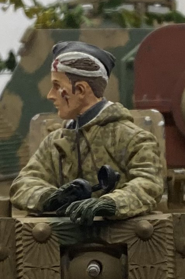

I am impressed by both the paint and leaf camouflage. The crew add so much, too, reminding me that I need to get hopping on painting more figures. I do agree that the HengLong TK7.1 will be a great way to run your beastie.
My eyesight isn't as good as it once was, so I thought the the assistant driver's head was bandaged and is cheek wounded. I did a blow-up of that part of your photo and I was right. Here's the blow up for others who might appreciate you job well done.
Asst. Driver.jpg (298.97 KiB) Viewed 1576 times

Absolutely outstanding! One of the best examples of scale foliage I've ever seen too!

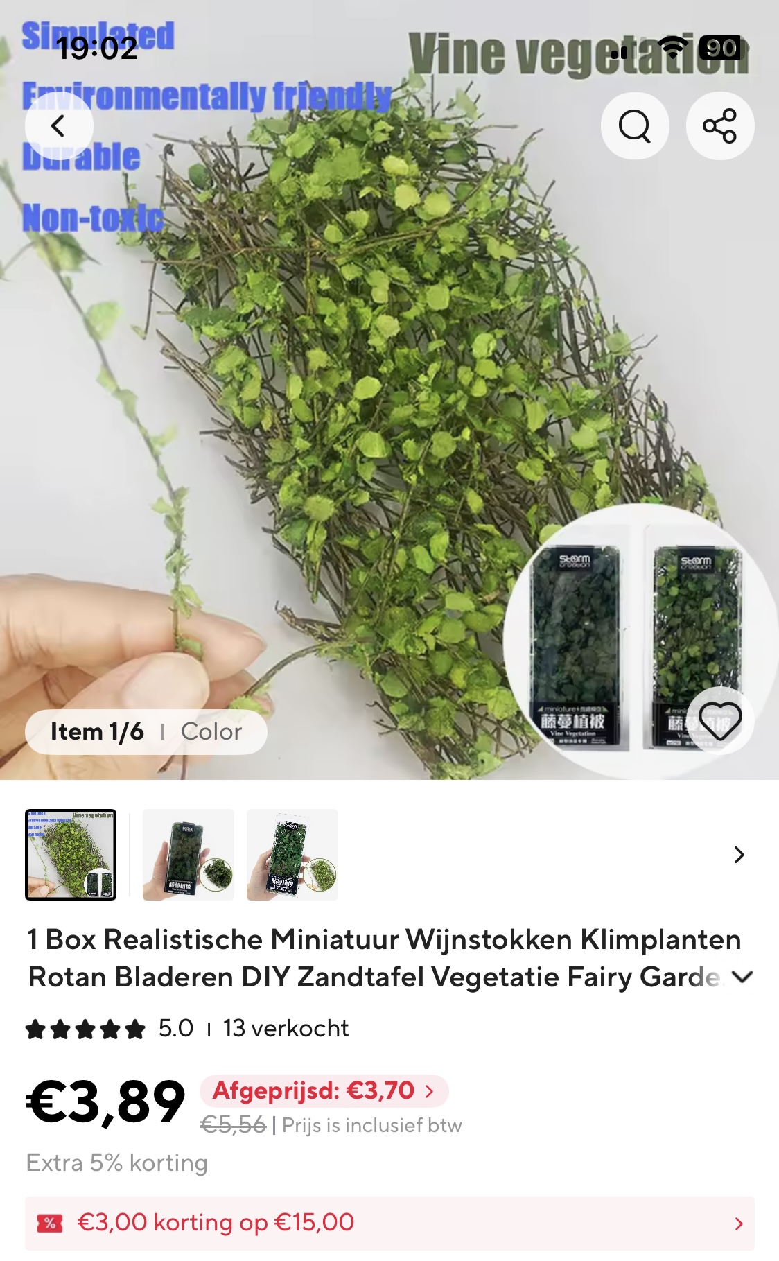

@Tom:
This foliage is available at Ali in different shades of green:
Rob59
Posts: 1317
Location: Netherlands
Re: Hooben Elefant
Post by Rob59 »
I am sorry, don‘t know how to post a link to that product!
