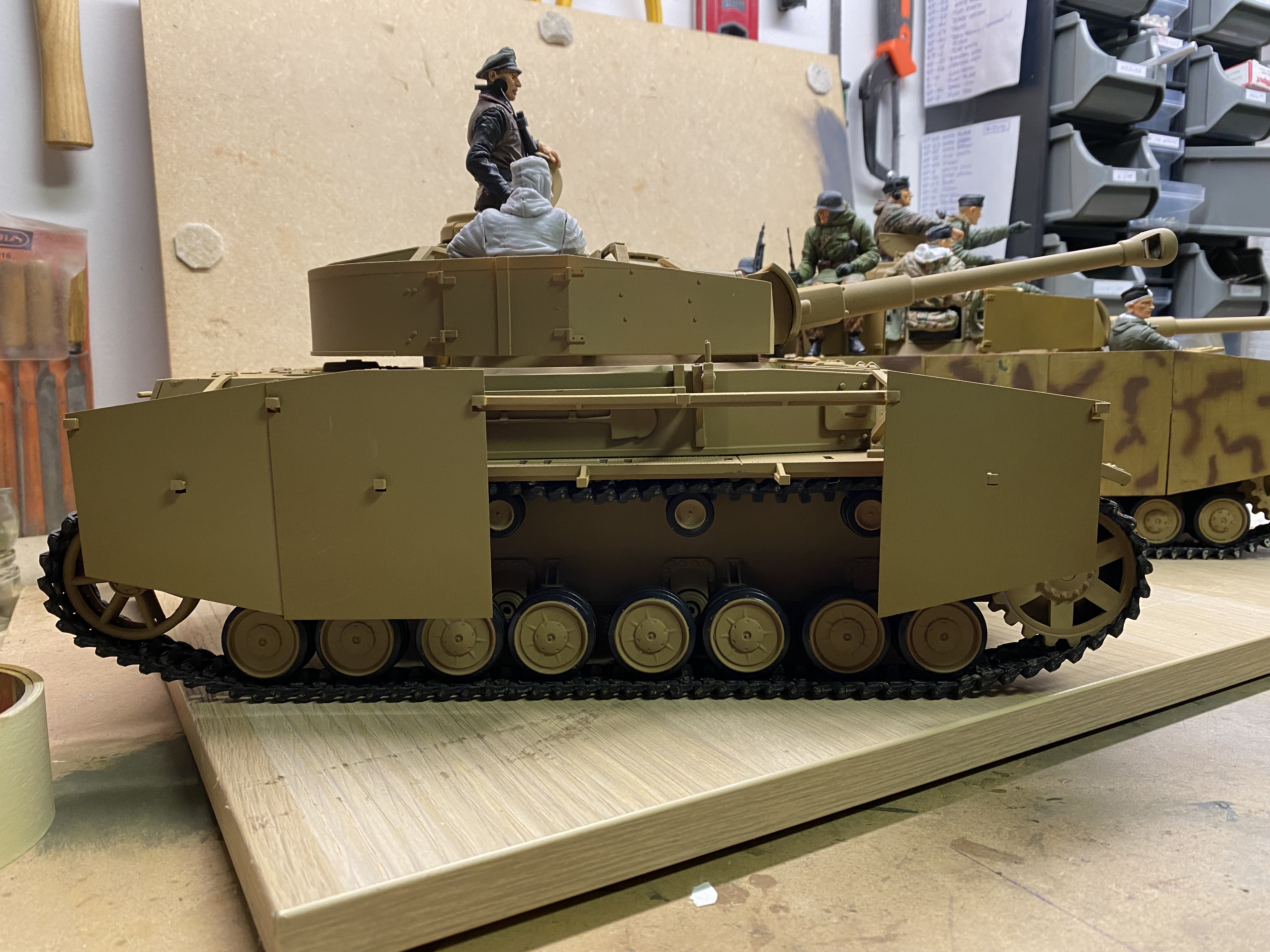

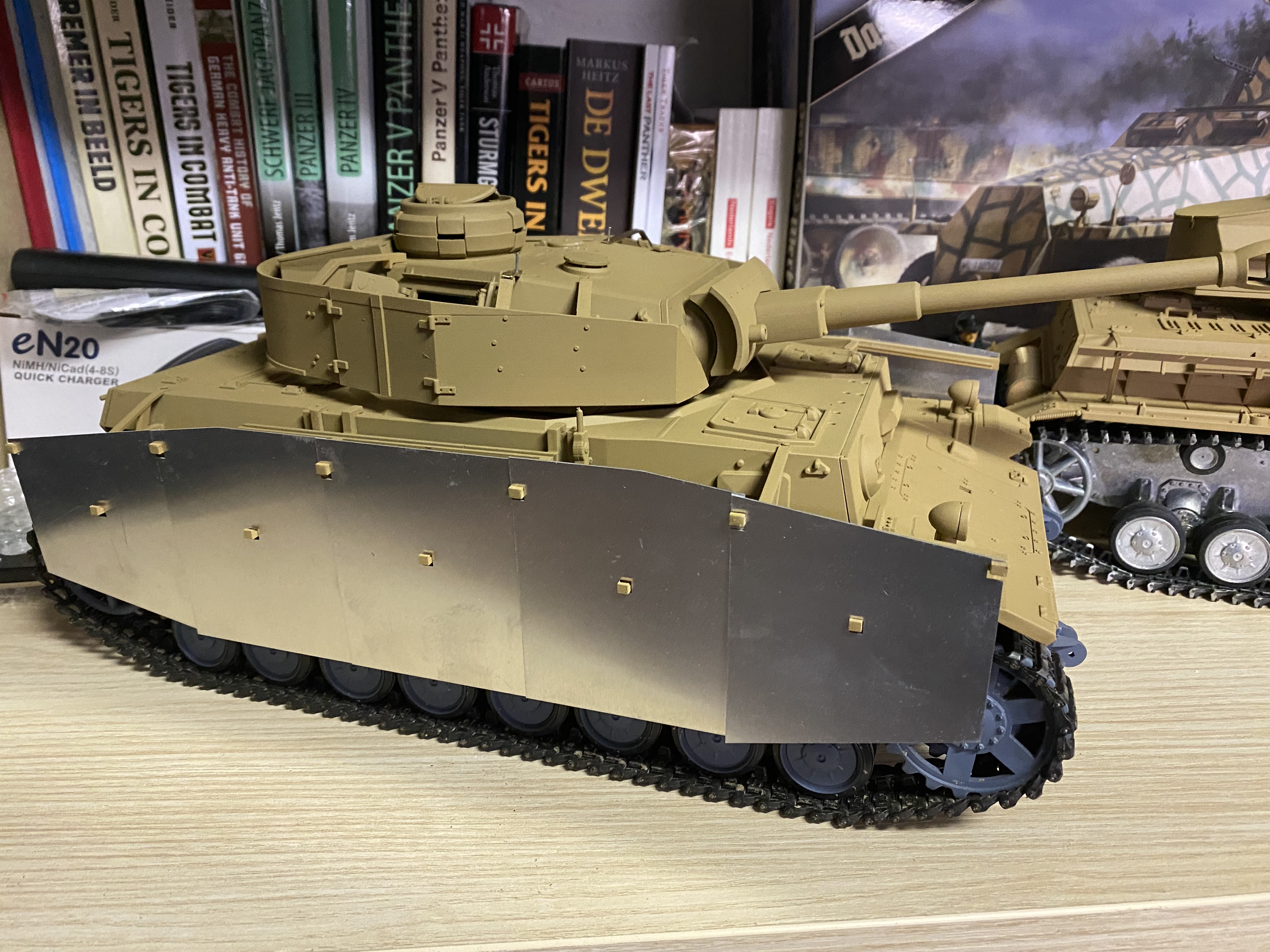

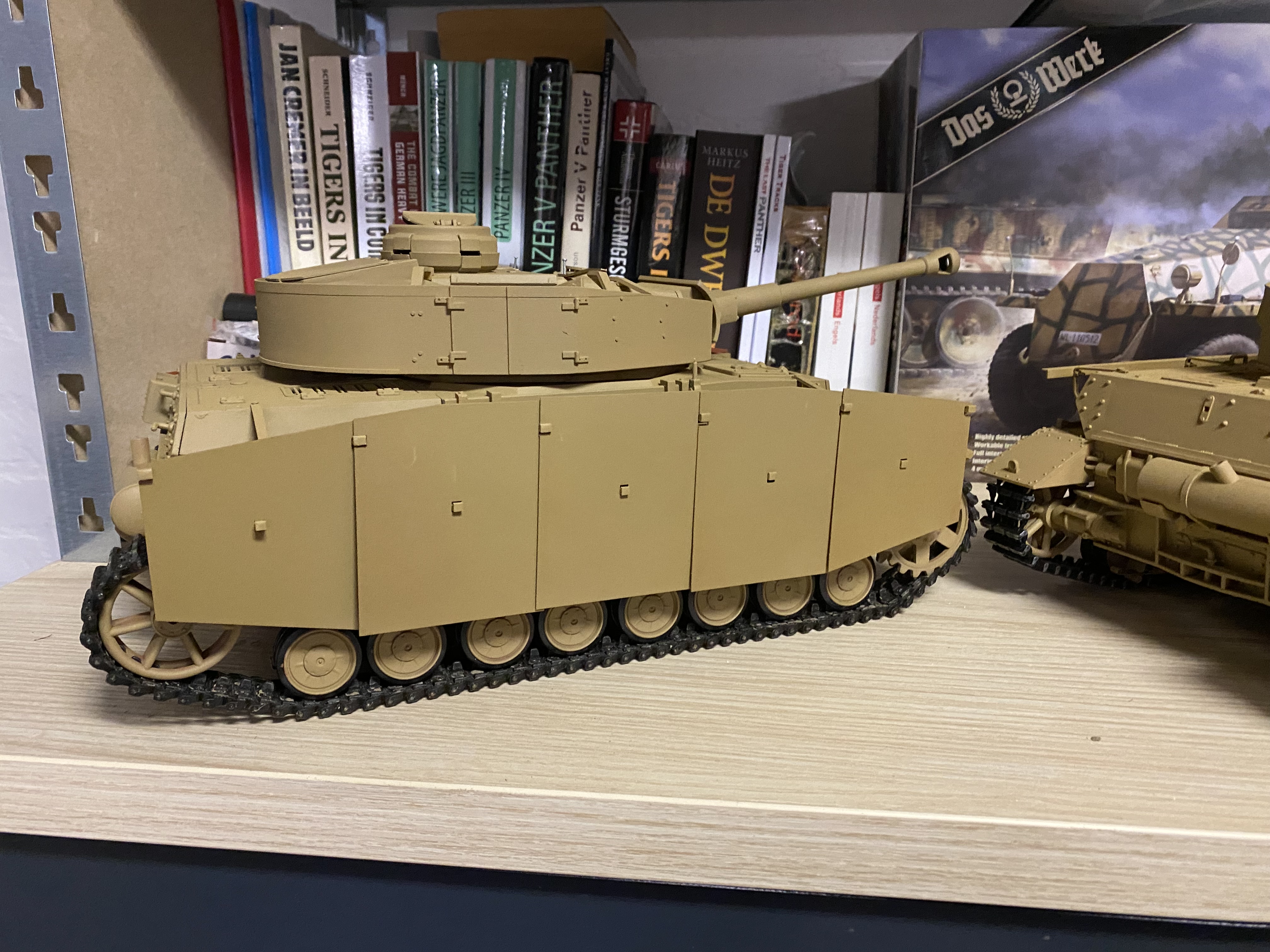

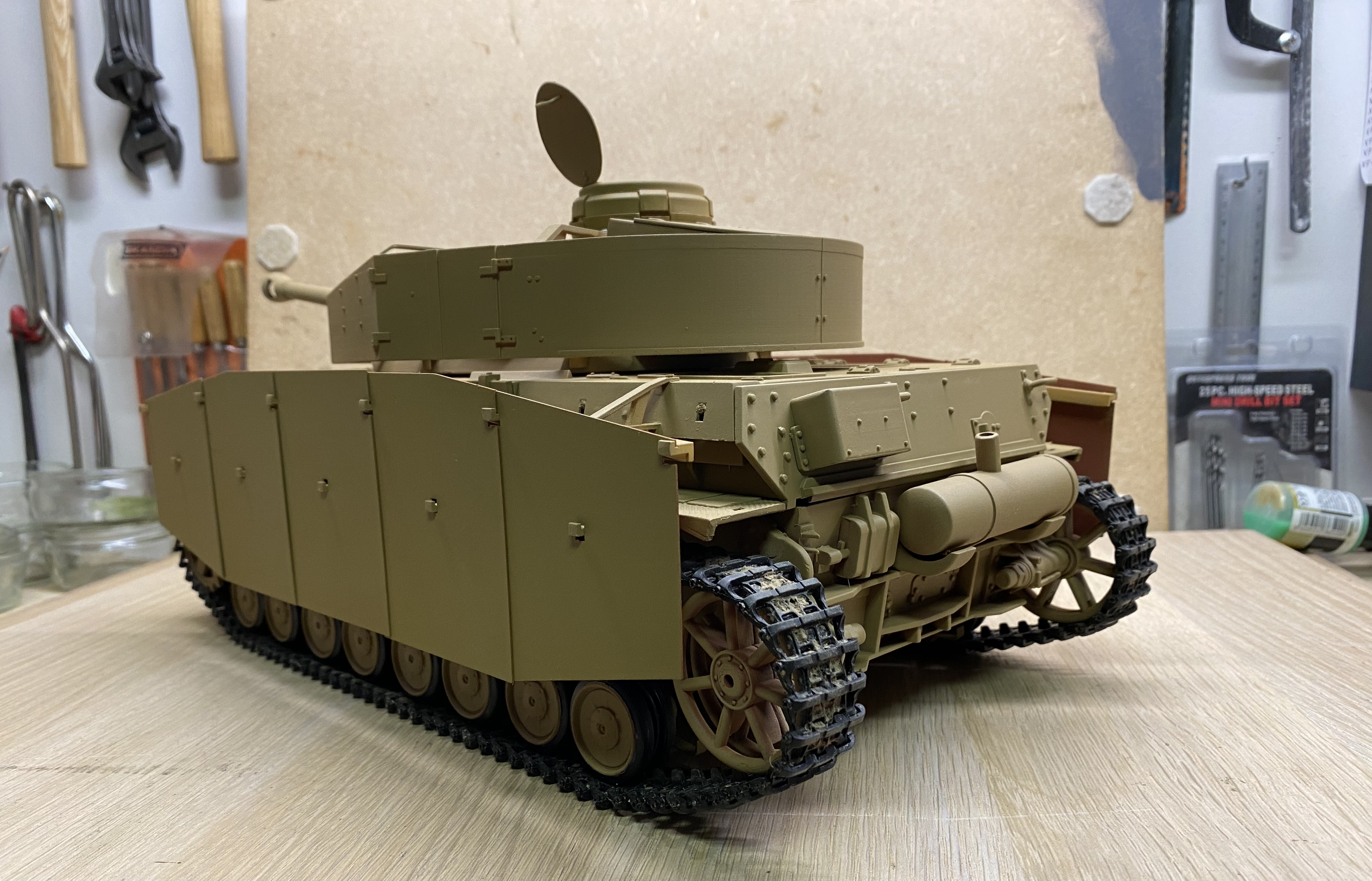

Re: 1/16 Schurzen armour.
Well, I do have that set too.
Normally I always make the side armour myself out of aluminum with brass brackets for my StuG's, Panzers 3 and 4, but got a bit lazy this time and decided to try that set.
And I must say, I was not disappointed at all.
Set comes complete with all the side armour, muzzle brake, spare tracks.
But the turret armour is quite thick I must say, but after painted it is not annoying at all, at least to me.
The brackets from the turret armour are quite fragile and tend to crack quickly so be carefull. I did replace several with homemade brass ones already.
The actual side armour is made of thin alu plates which can be hung onto brackets which must be glued up and underneath the fenders alongside the Panzer IV.
For now, this IV of mine is still in its Dark Yellow, waiting for the camo pattern.
So I cannot tell you whether the alu armour will stay onto its brackets during outdoor rides.
I can recommend this set to those who do not have the capeability to make 'm themselves, or do not have the time for homemade stuff which actually is a lot of work, measuring, fitting, measuring, sawing, filing and so on....
This set saves you quite some measuring and so, and it's actually just plug and play!
What I did do, I drilled holes in all the brackets (turret and side armour, except into the brackets which have to be glued underneath the fenders) and in the turret roof and upper hull also.
Glued small nails through the brackets into the turretroof and upperhull, just to get it a bit more secured than just glue.
I didn't regret buying this set at all!
Rob.
