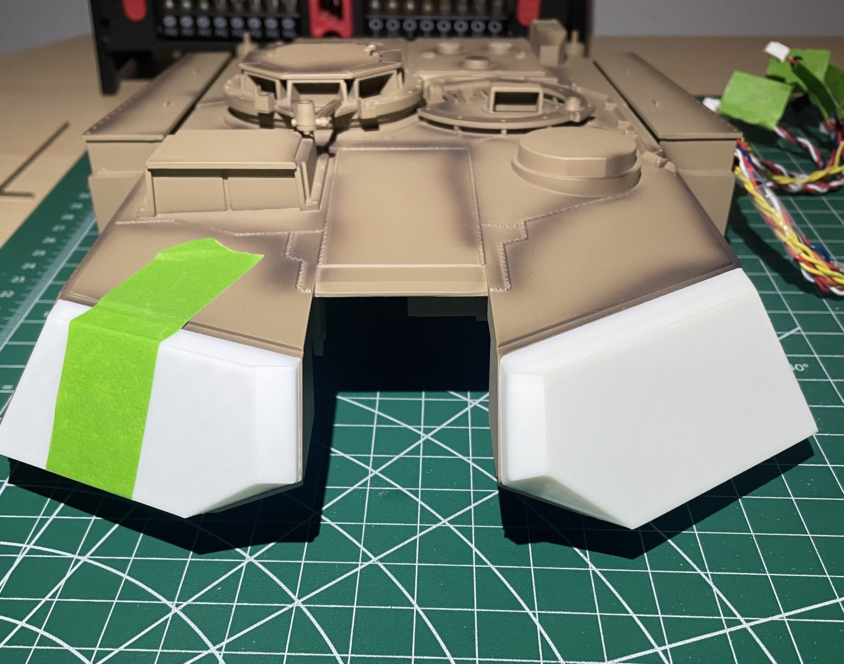

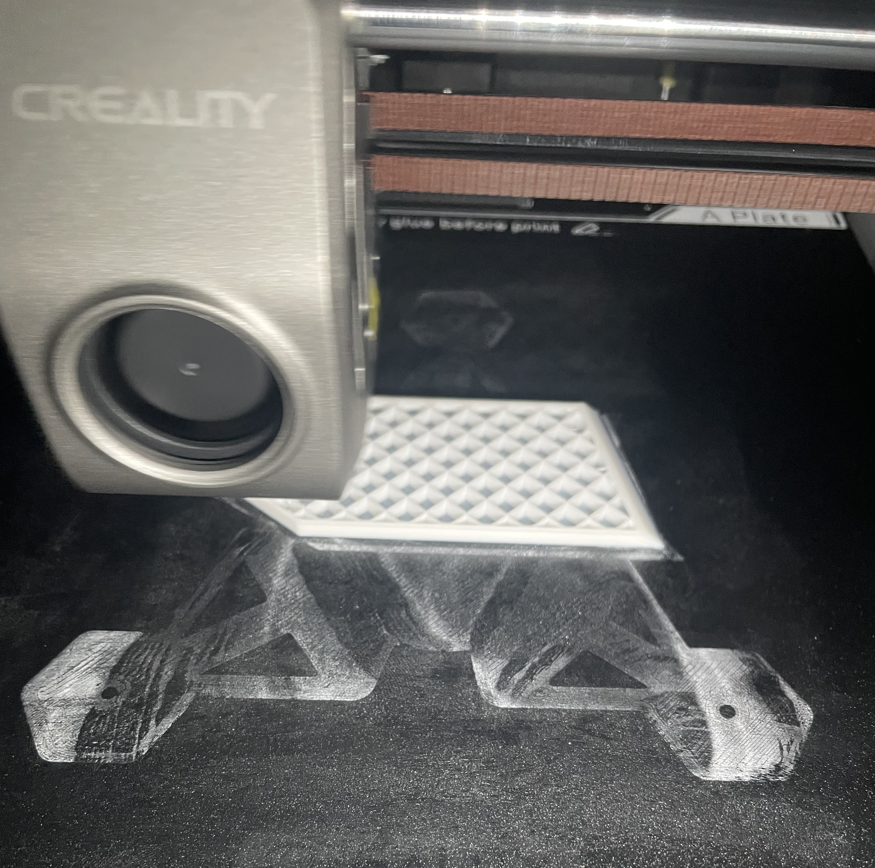

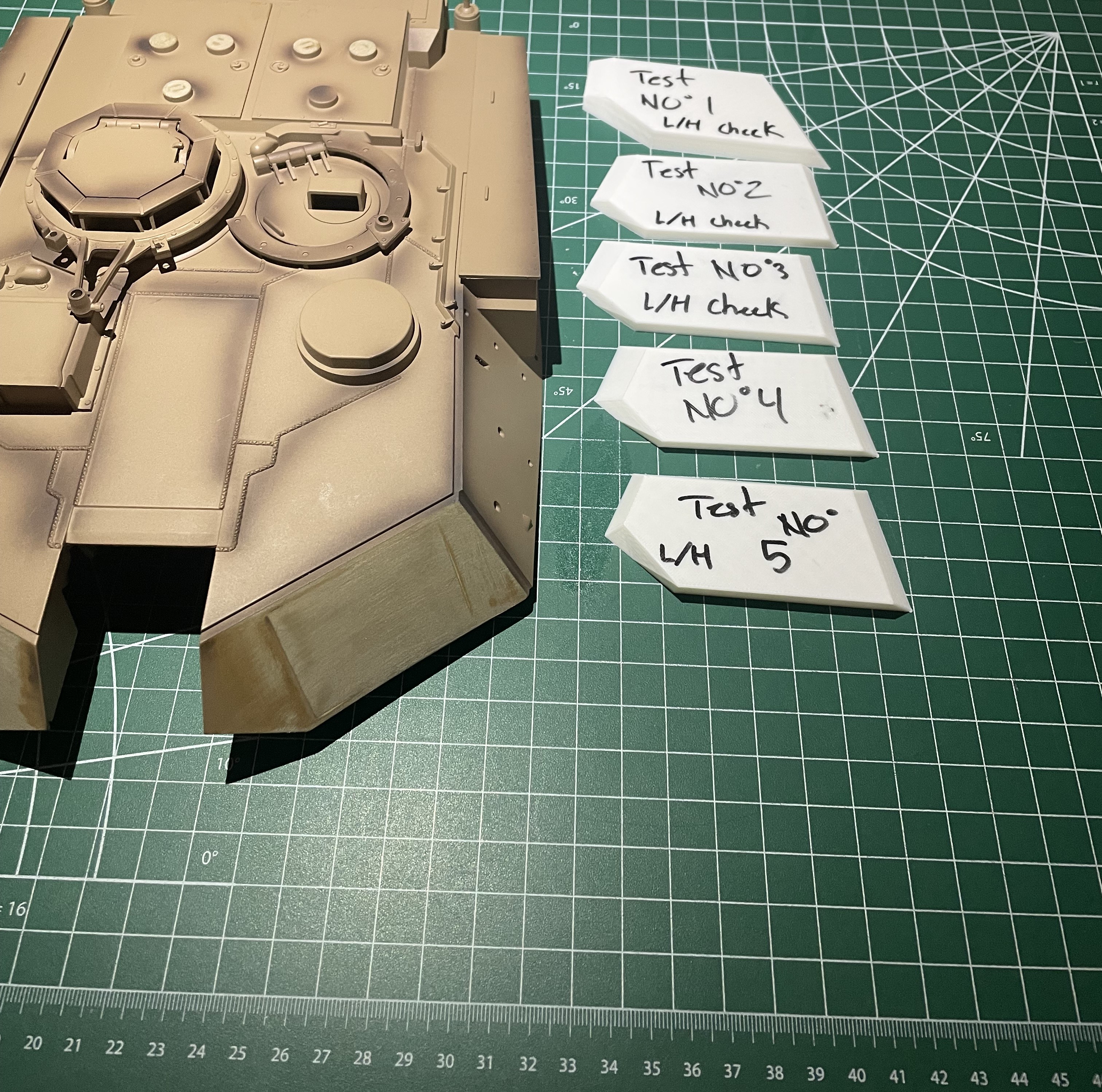

After surfing the web a handful of times and asking around the forms I decided to do the heavy lifting and make them myself, 3 blender attempts later, I finally had my first printable test. and low and behold. Wasn't to spec enough. So back to the drawing board and another handful of hours later I made a second test. And then a third, forth, fifth.

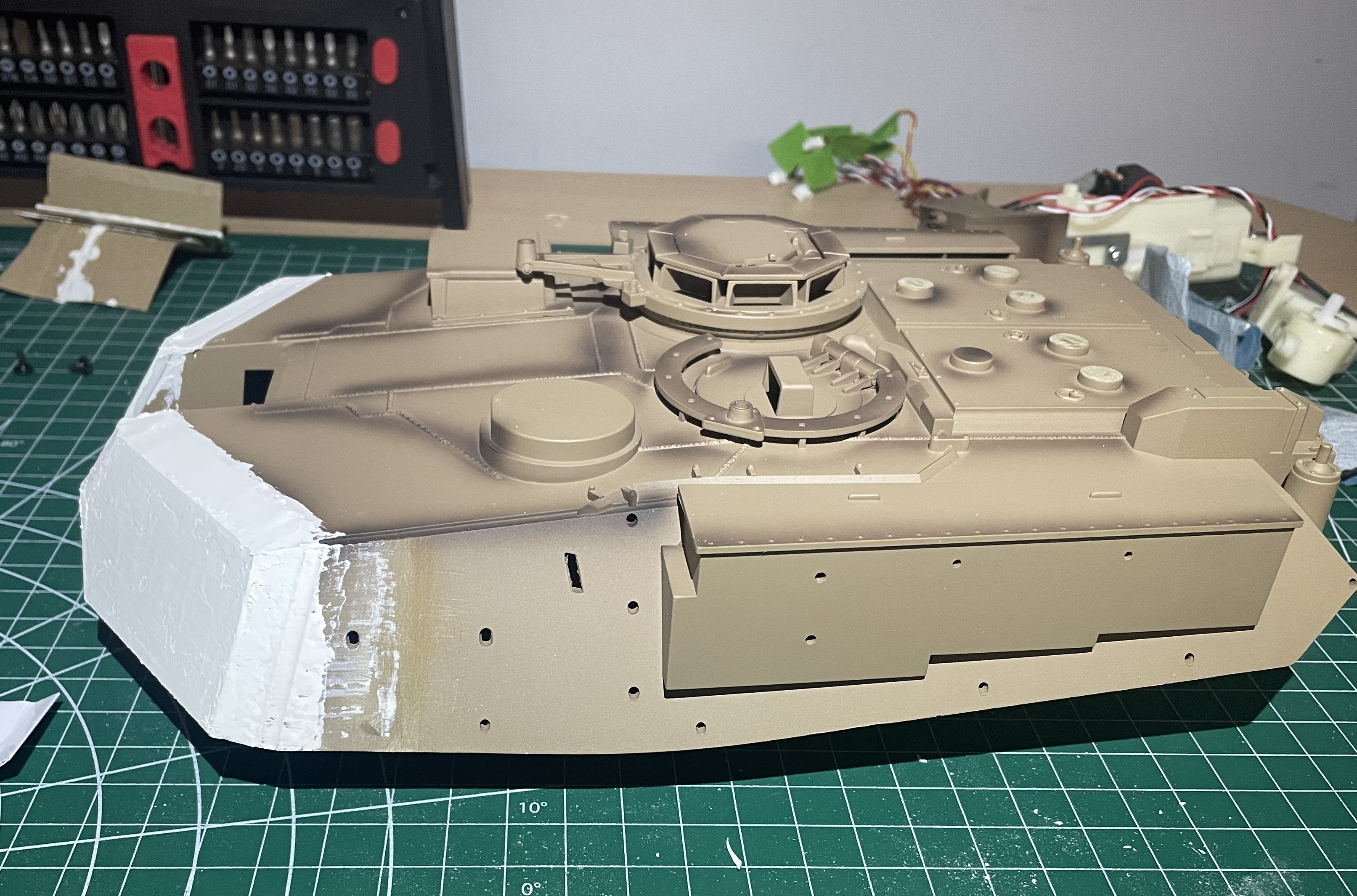

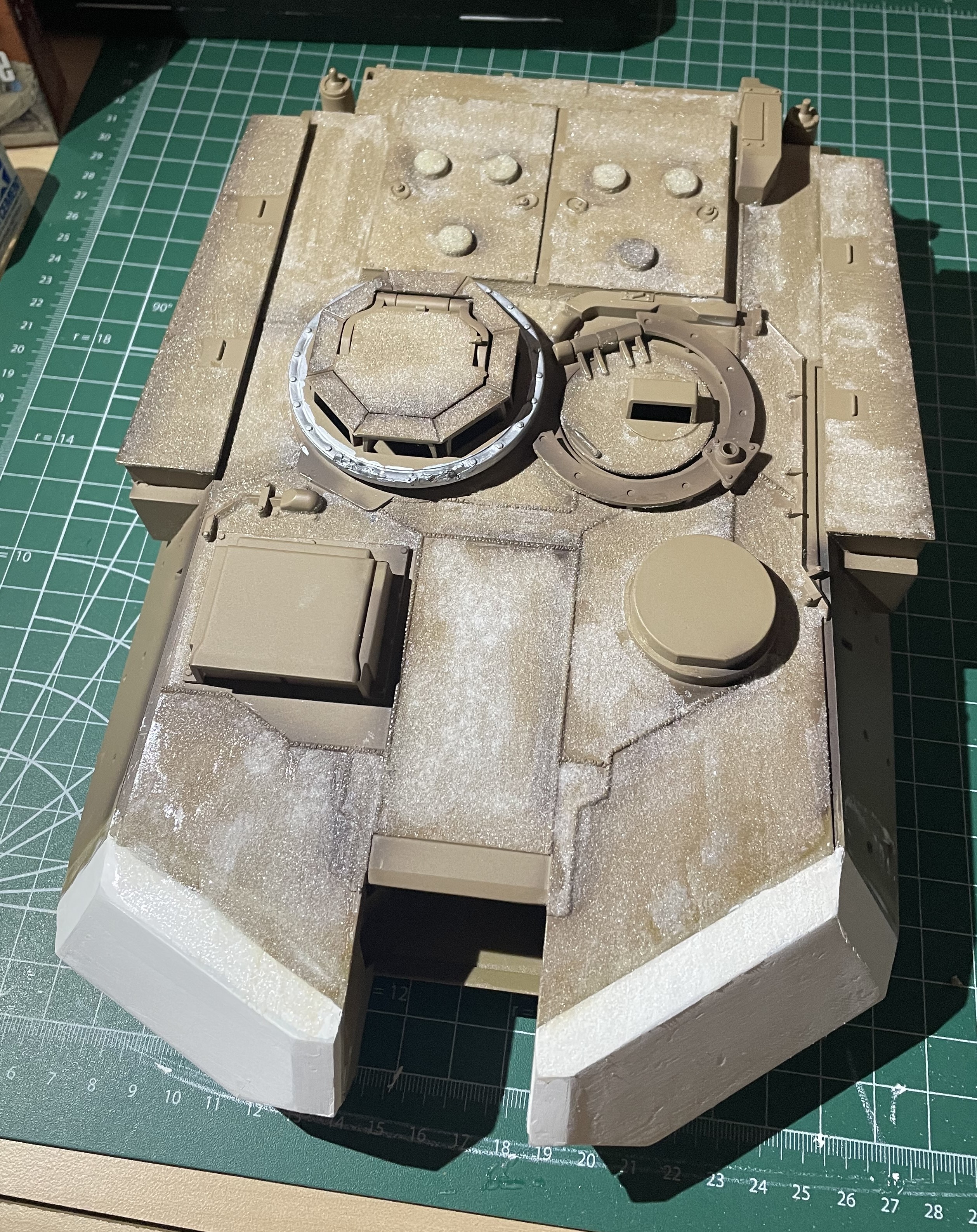

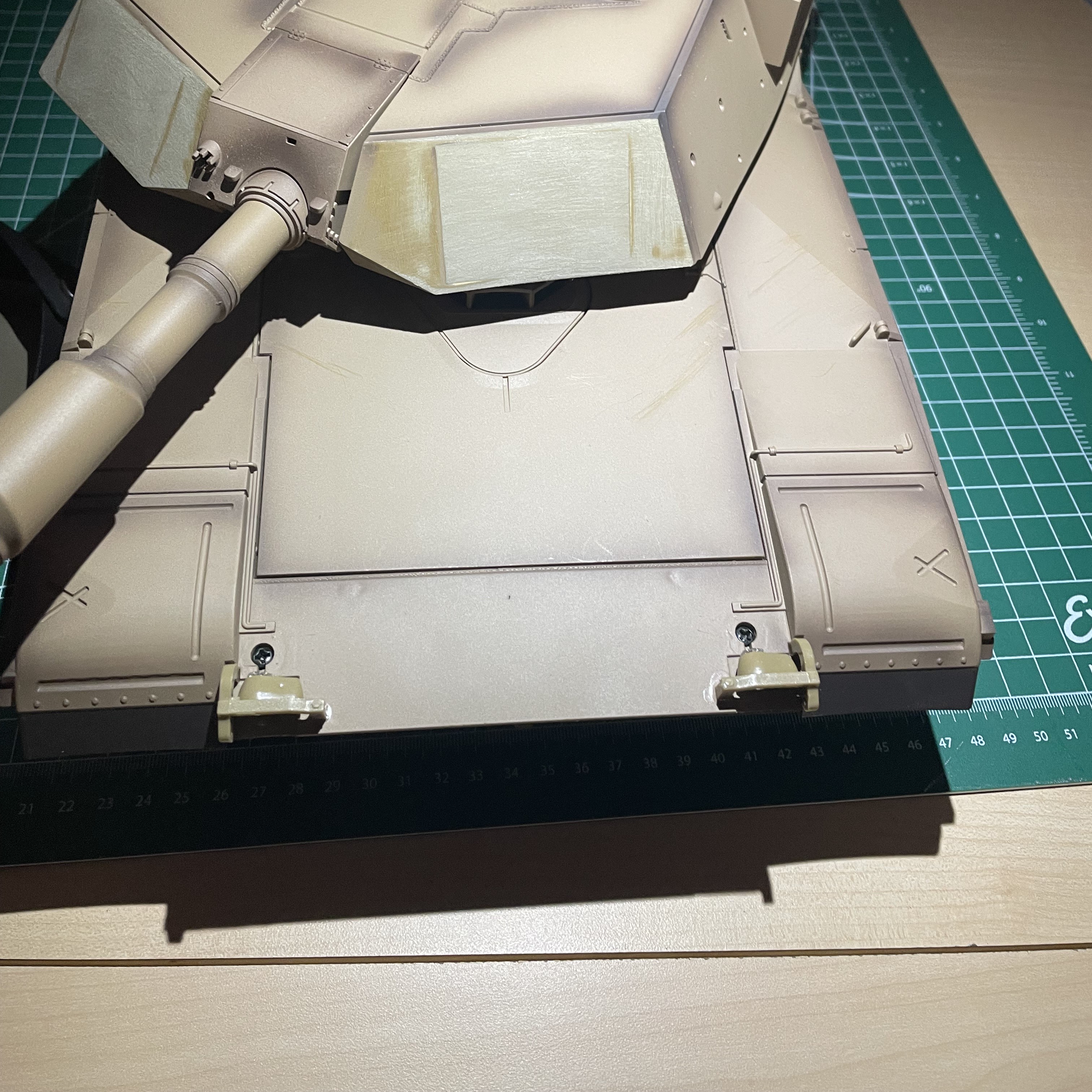

After about 8 iterations I was finally happy with the left cheek, and proceeded to the Right cheek. another 6 iterations later and the Right cheek was finished and ready for gluing. Once the glue was laid and the cheeks where applied. I began to add some tamiya epoxy putty to smooth over the layer lines and blend the edges together for a more seamless fit (not that there really was any lines to begin with) Next was to apply the anti-slip texture, and boy. what a pain that was. I really do wish the glue wasn't so fast at drying, cause it really made it rather difficult in applying it without having ugly overlays or gaps as I found out. But it all worked out in the end More to follow in the coming weeks,'

It definitely adds more detail to the model. However there are various spray cans that you can buy (only finding out after buying 2 AK products) and they make it significantly easier to apply and evenly cover the required areas on the model. There's even an airbrush application from VMS.HERMAN BIX wrote: ↑Sat Jun 07, 2025 5:56 am And what a project this will be !
Now moved to the best section for it and I already noticed a product I had no idea about, the non-slip .
Could've used that on the Merkava I did recently![]()
My only real gripe with the AK product was how fast the glue dried. It began curing within 10- 15 seconds after brushing it into position. So maybe I'll have to try another type of glue that cures a bit slower for a more even coat.

I don't think they had 1/16 in mind for those glues.11C wrote: ↑Sat Jun 07, 2025 11:40 amIt definitely adds more detail to the model. However there are various spray cans that you can buy (only finding out after buying 2 AK products) and they make it significantly easier to apply and evenly cover the required areas on the model. There's even an airbrush application from VMS.HERMAN BIX wrote: ↑Sat Jun 07, 2025 5:56 am And what a project this will be !
This is that the Tamiya Cement Texture paint looked like before paint:
And after paint:
