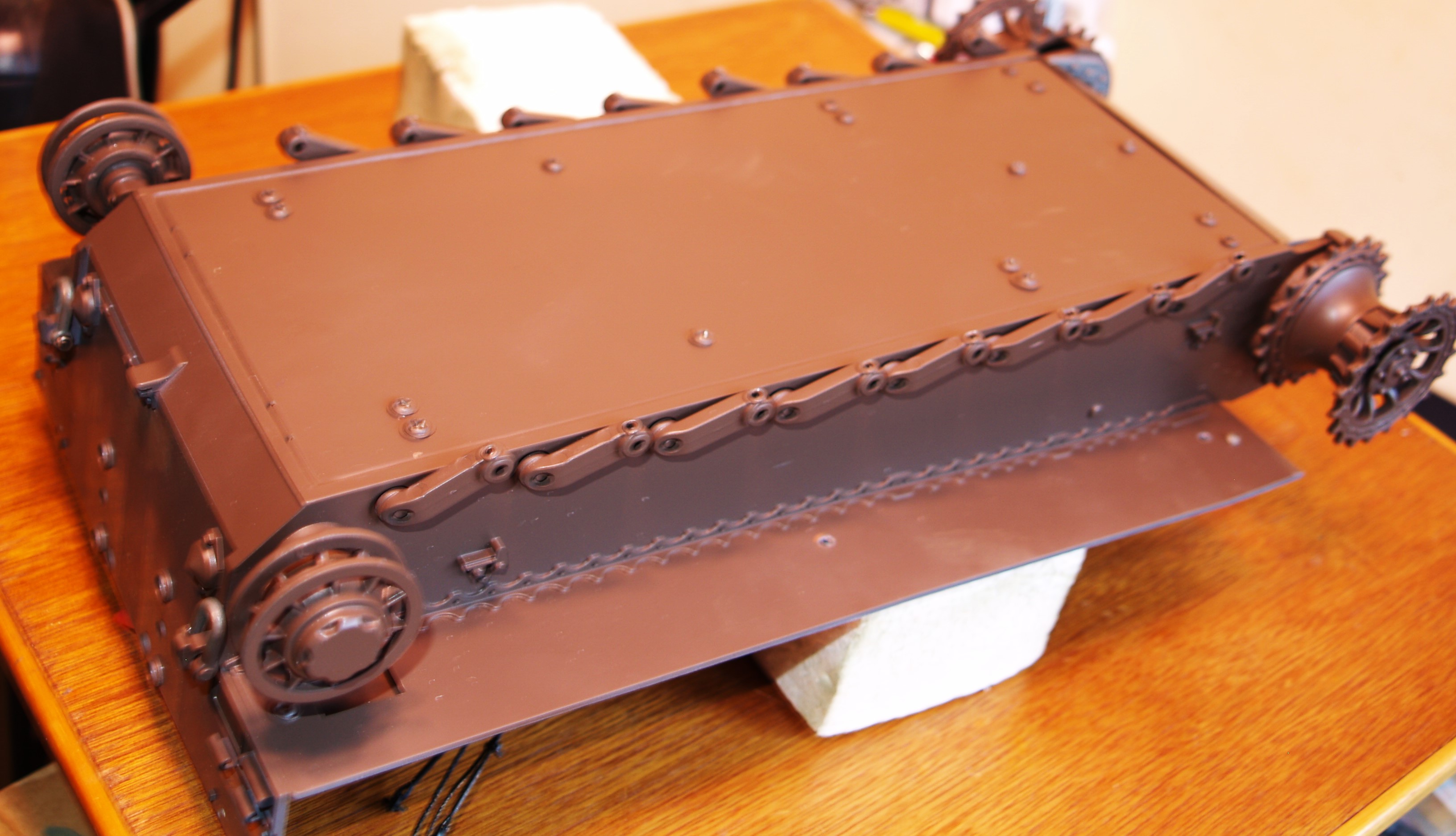

My Tiger - started many moons ago :shifty:
Asiatam hull ( yes , the 'original' it's that old ) Now has Henntec tensioner , steel 'boxes with drive shaft bearings , Hull top bracing strip
plus some magnets to keep it together . All the usual stuff :/

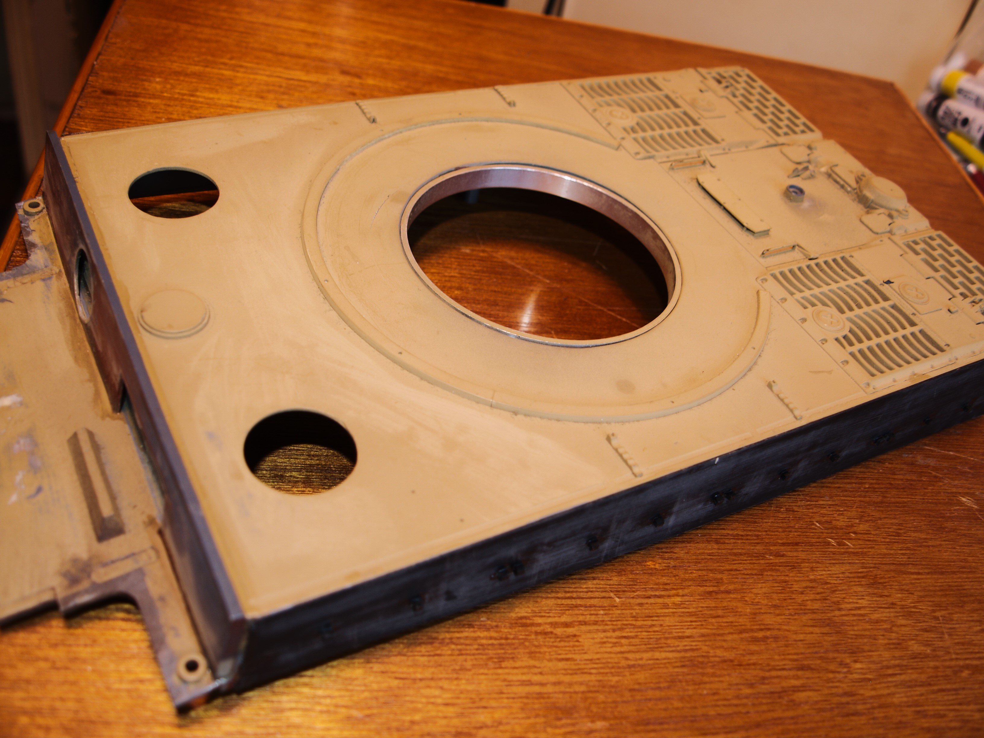

Ditto the HL upper mods - re centered turret ring ,opened hatches , 'late' engine deck details.
I also removed the mud guards , with a big hacksaw @) no messing about here , I'll have proper carnage , me.
According to refs the hull is 1mm too narrow - so the sides were then skinned with .020" / .5mm styrene , CA , trim , quick , simples ,job done :D

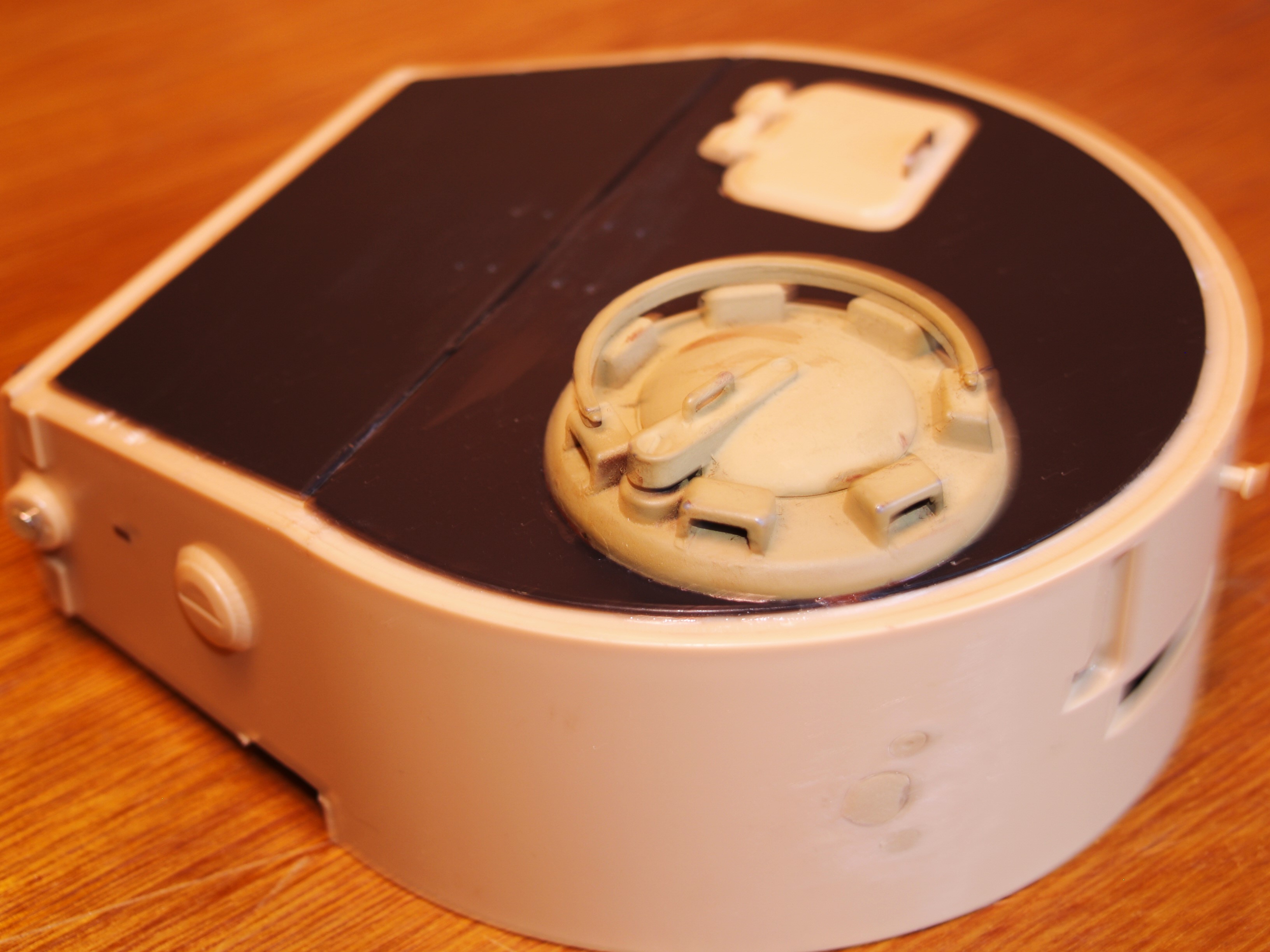

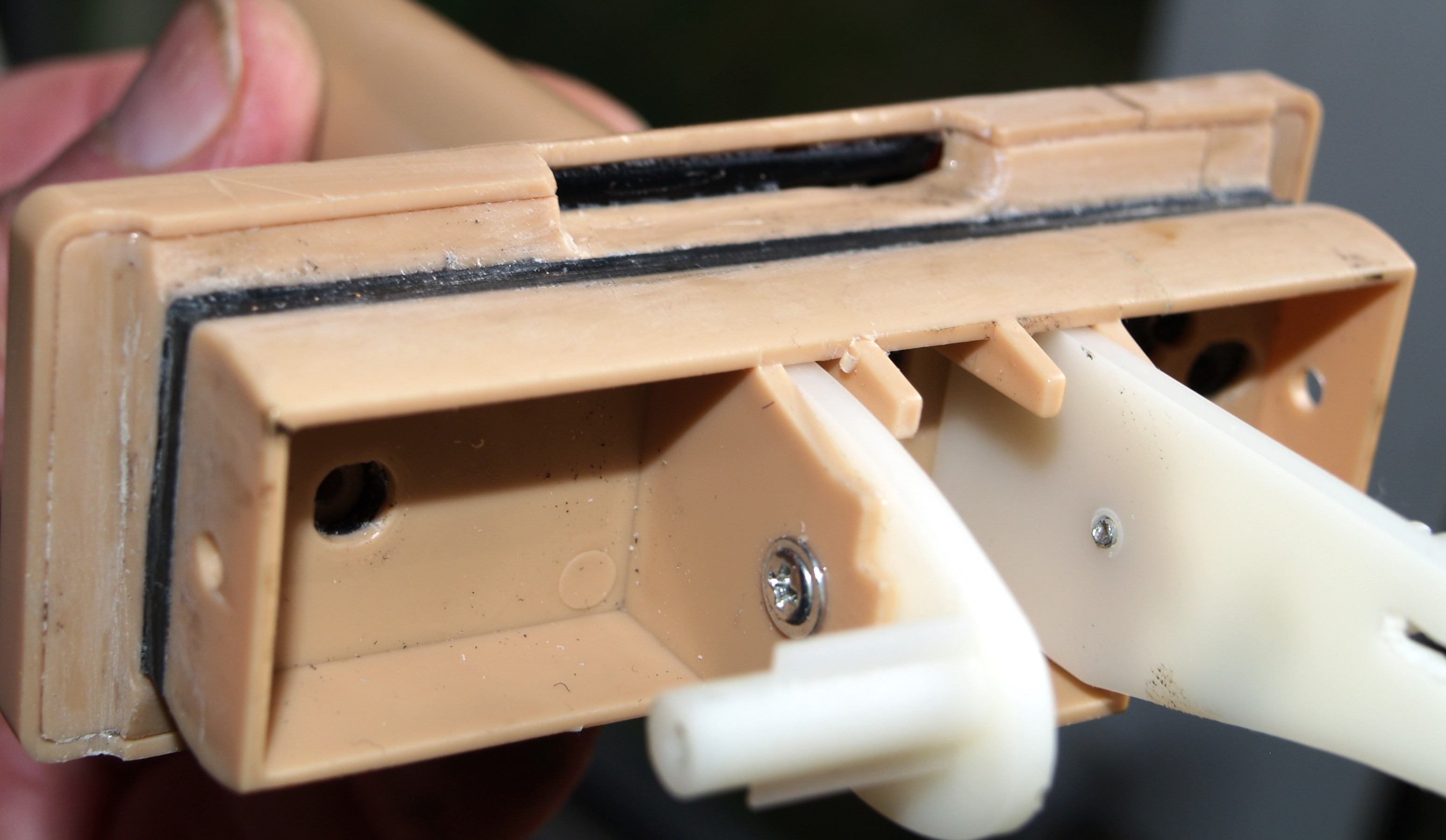

Next the turret , a Taigen recoil jobbie , courtesy of Dave 'n Julie @ Forgebears emporium . Again this too received the cut 'n shut treatment to correct the shape , with the later '40mm' roof etc. plus a scratched new lower part with recentered ring.
Mantlet mod.JPG (524.11 KiB) Viewed 1972 times
The Mantlet was also narrowed to suit , the trunnions were recentered more to scale - a packing piece is needed here. and a bit of fettling with the recoil unit because this new fulcrum point alters the elevation a little .

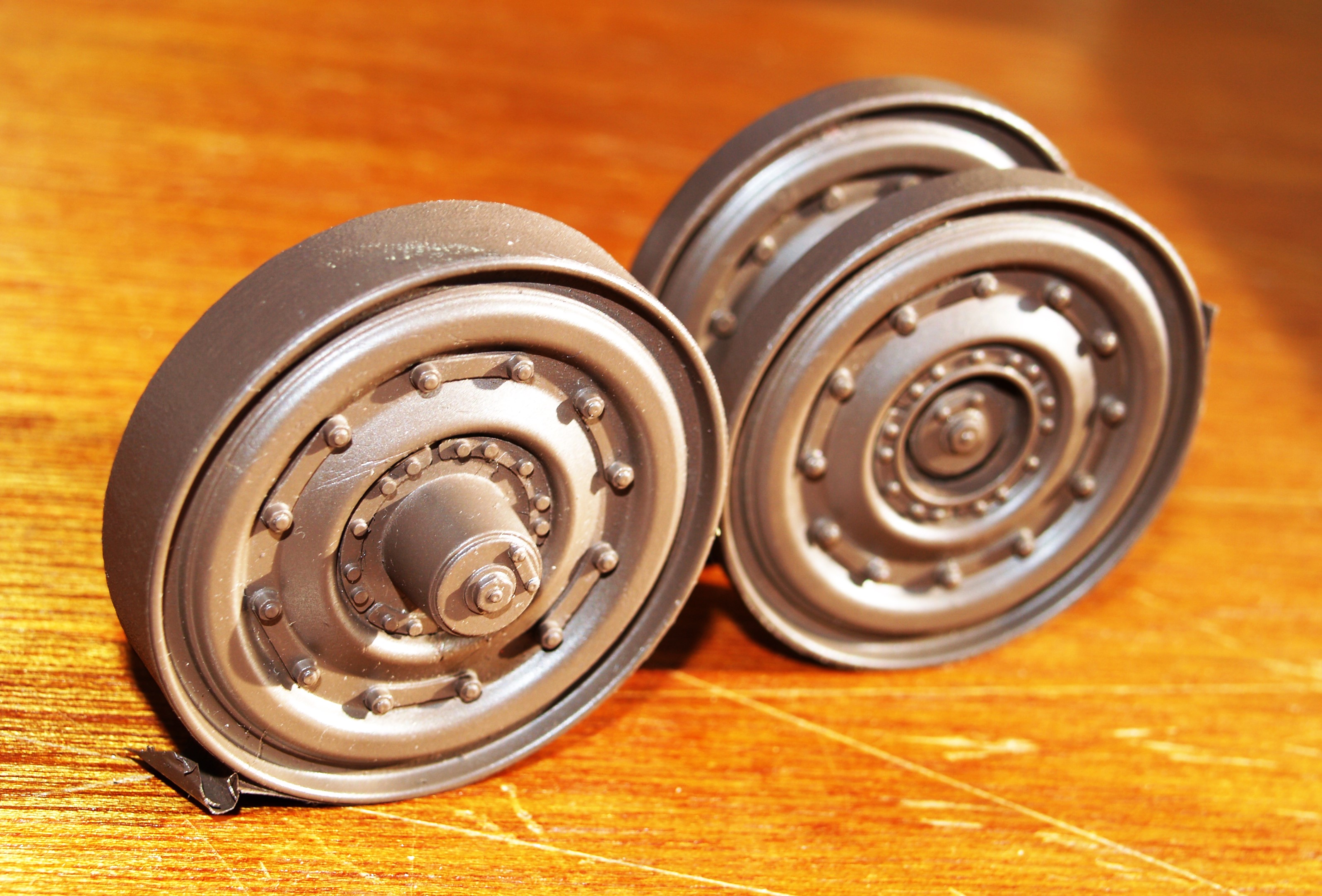

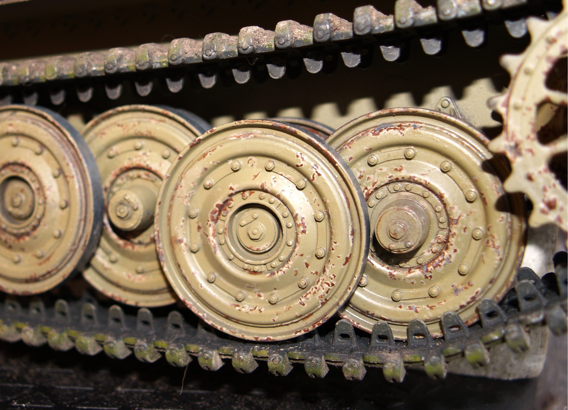

Steel wheels- oh yes ,lots of them .
So , for a break I did some more painting.
- All this will fade under a filter and weathering .

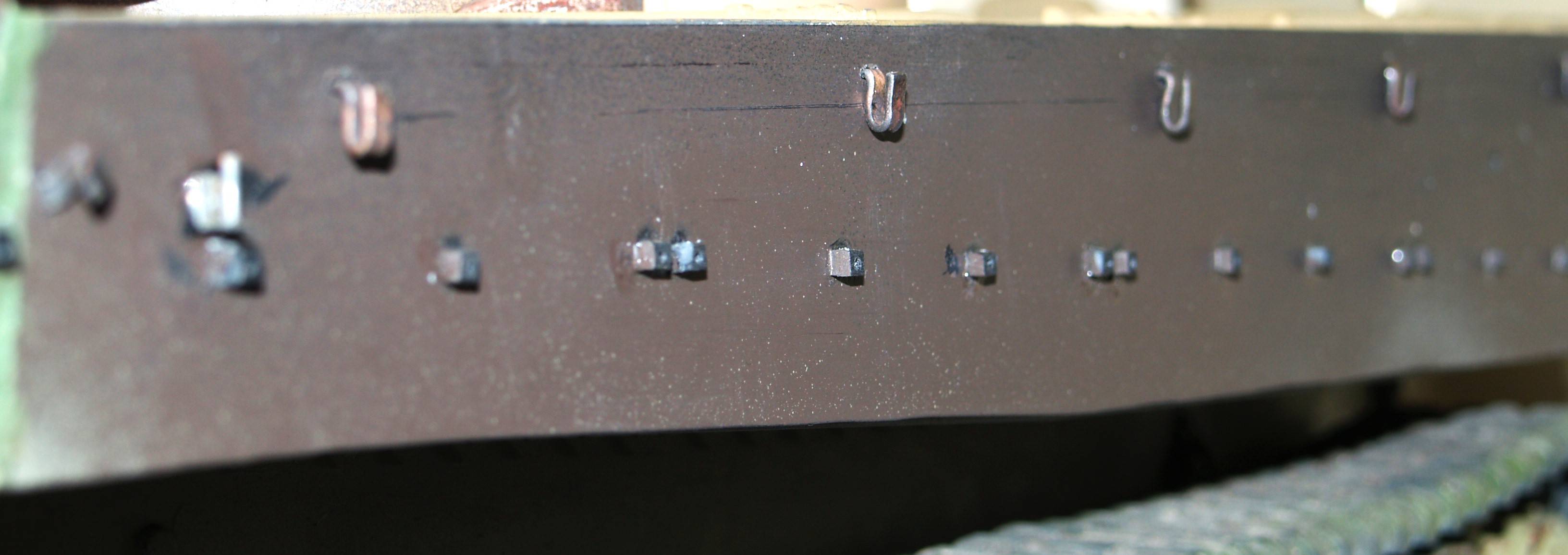

cable and mudguard mounts.JPG (452.43 KiB) Viewed 1924 times

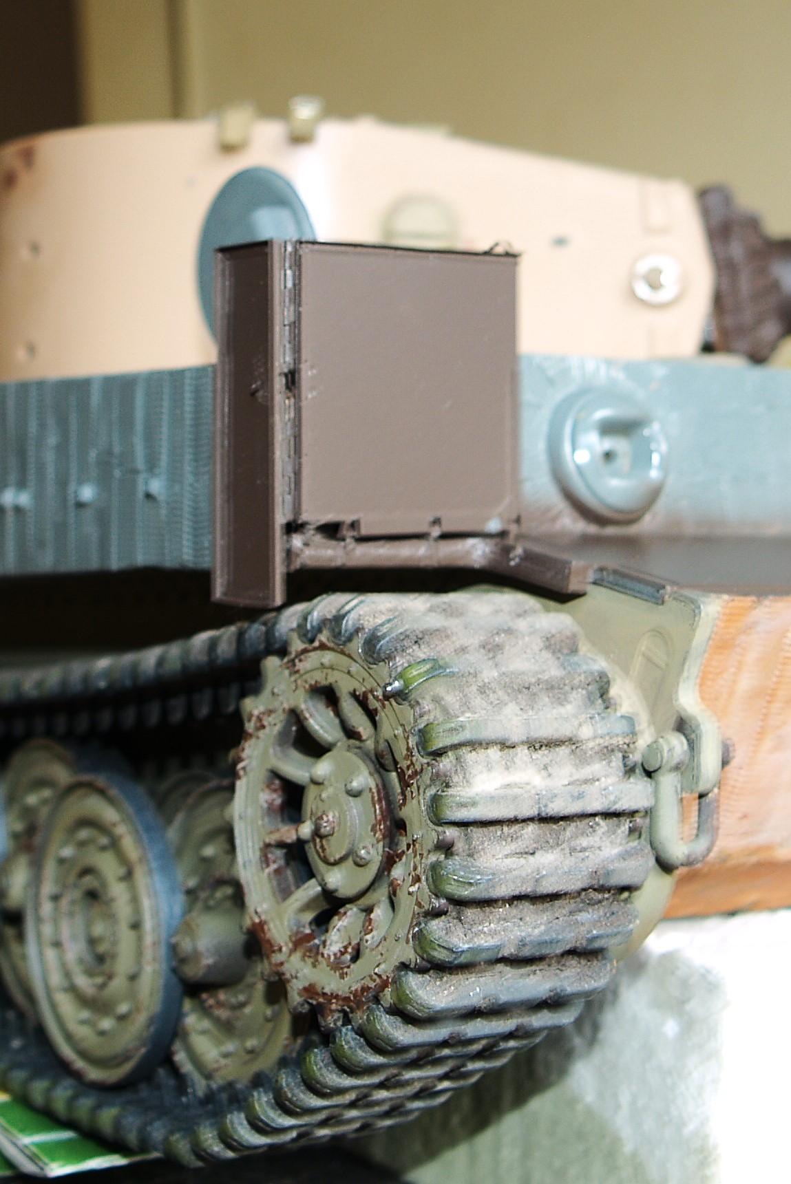

Little blocks of styrene for the Mudguard mounts and cable hooks from heavy duty packing staples An idea I pinched from another forum member :shh:

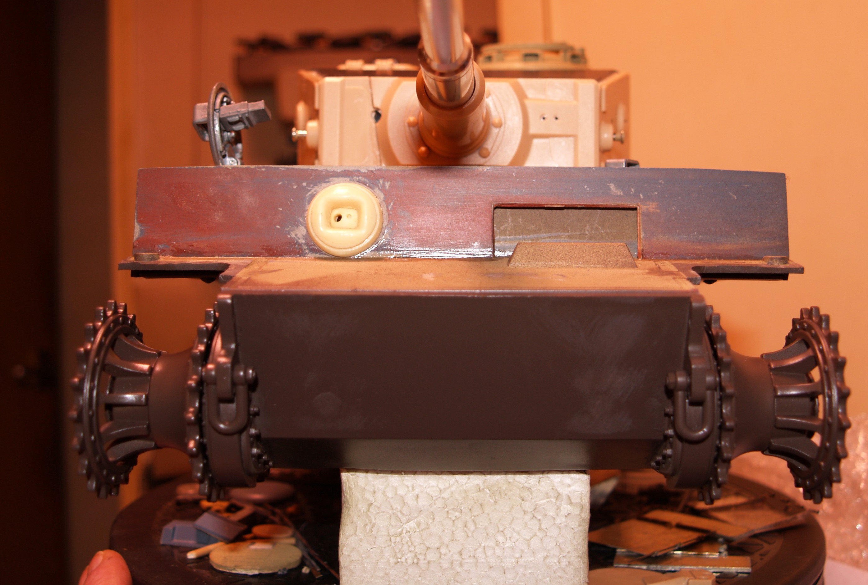

Hull front , with home made kugelmount , the visor is getting a good seeing to as well . . .
Now , ETCH BRASS-and other shenanigans

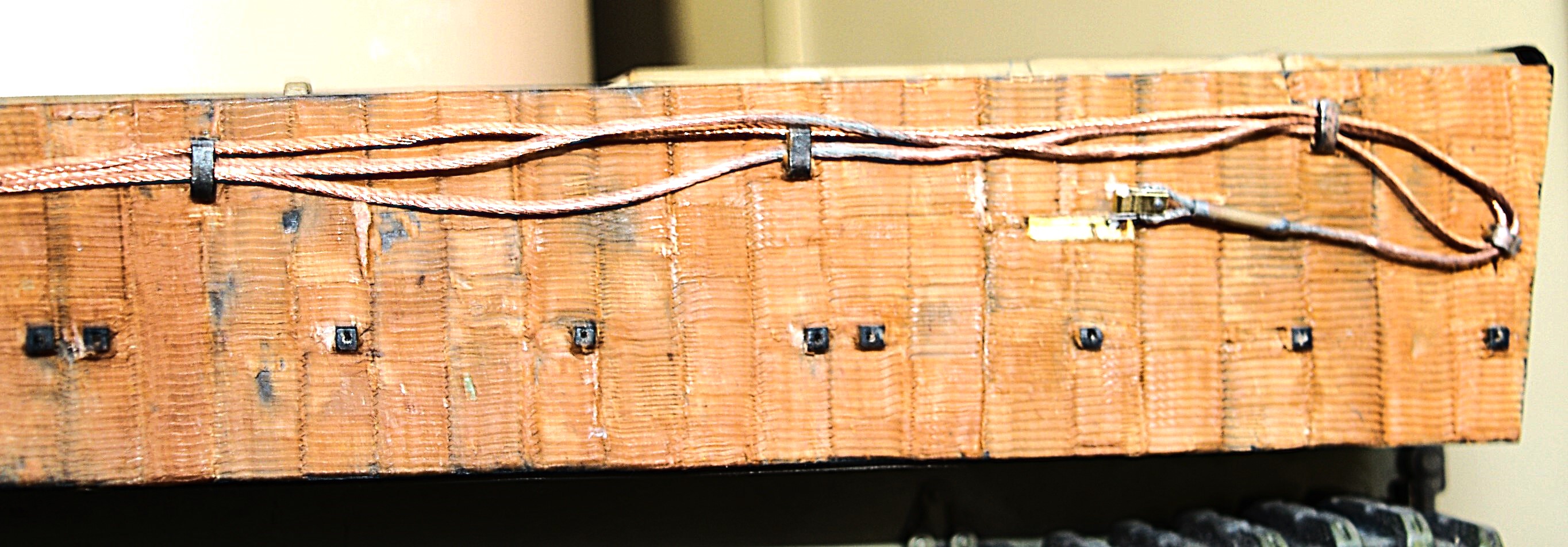

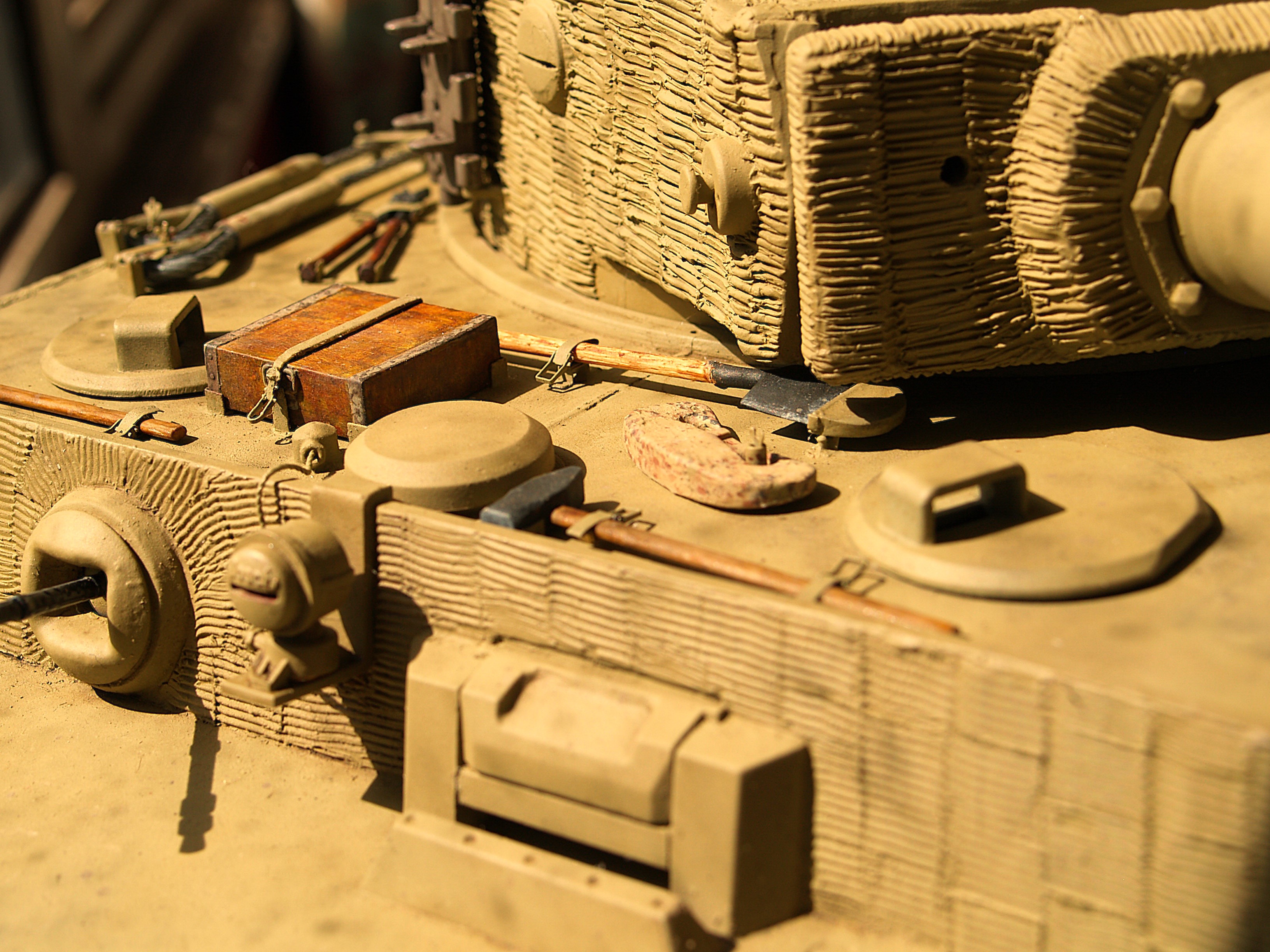

15 metre track cable end.JPG (995.9 KiB) Viewed 1924 times

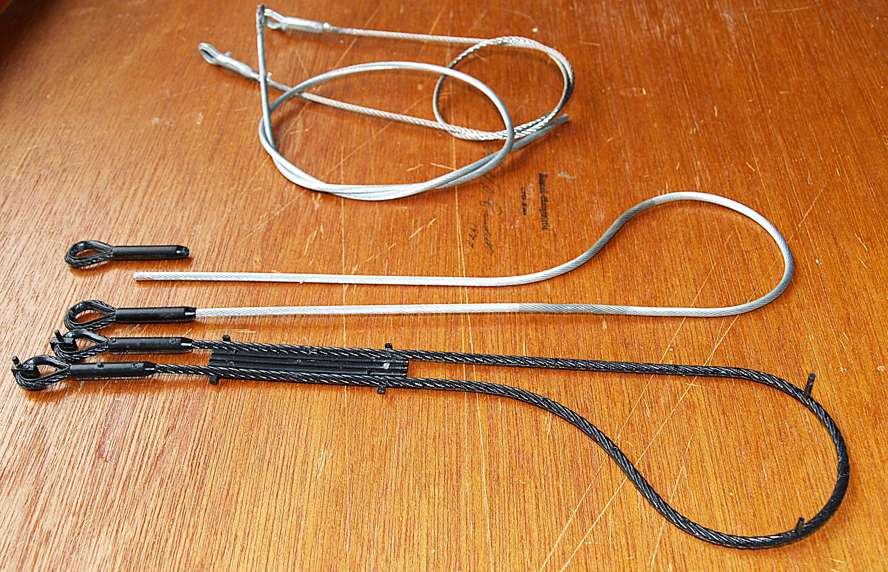

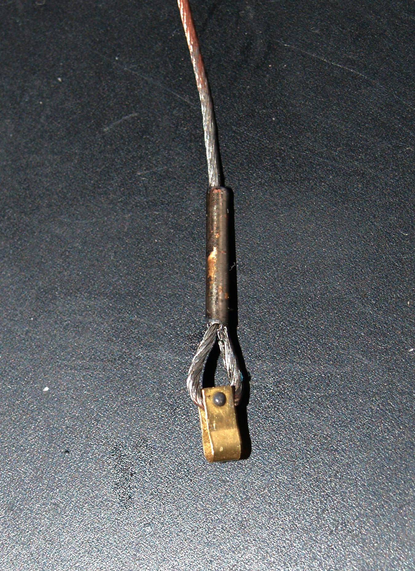

I used Voyager P .E. sets # 16009 Mid production , # 16011 Fenders and # 16012 engine grills .
16009 is quite comprehensive , and has a nice metal track cable that comes with resin ends , these would be too fragile so I used the solder 'paint' to do the entire cable , then slipped on a piece of brass tube , bent the wire back onto itself and resoldered it permanently.
after checking it for length I did the same at the other end . It helps retain the shape and gives a realistic metal look :thumbup:
Fenders.

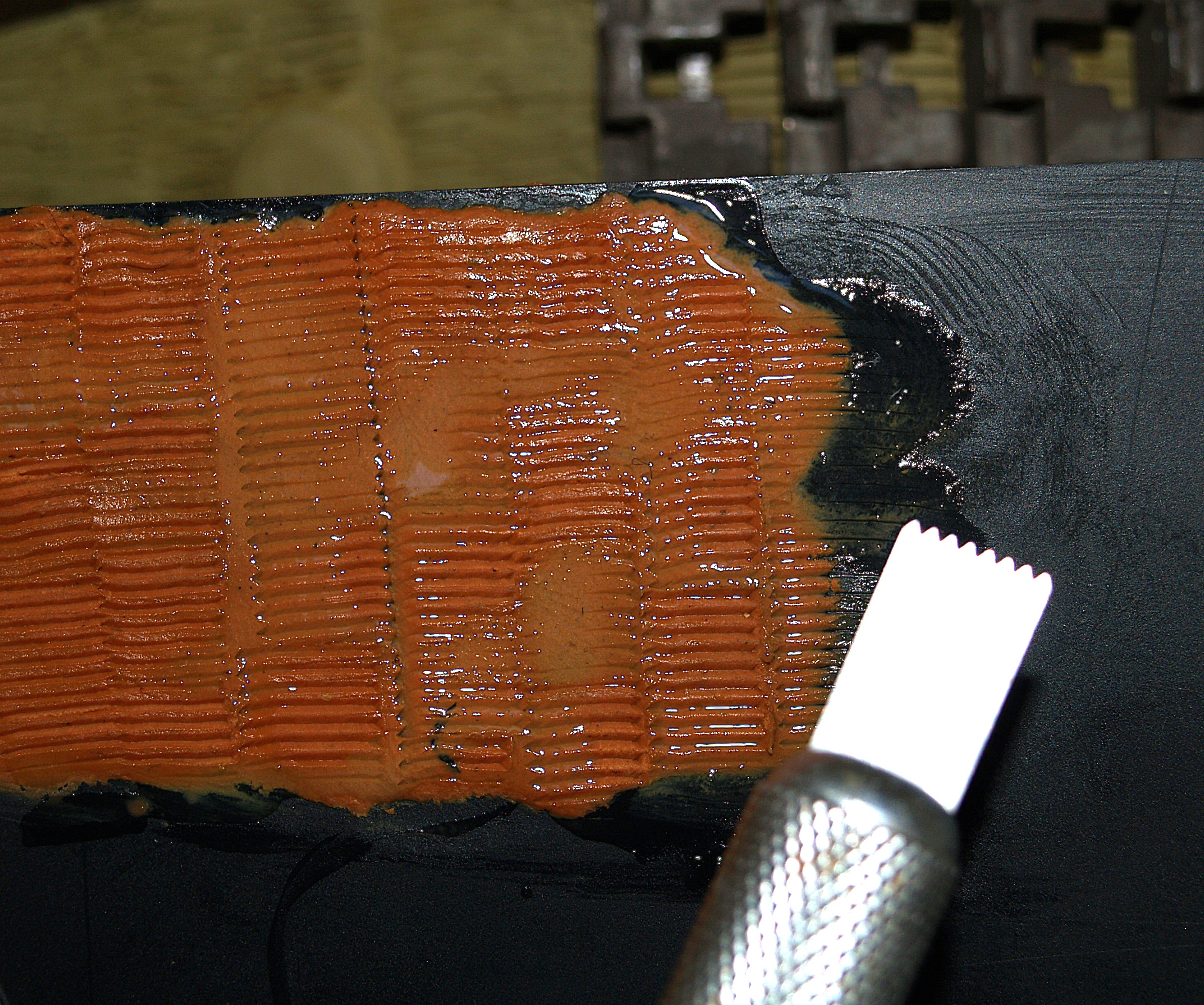

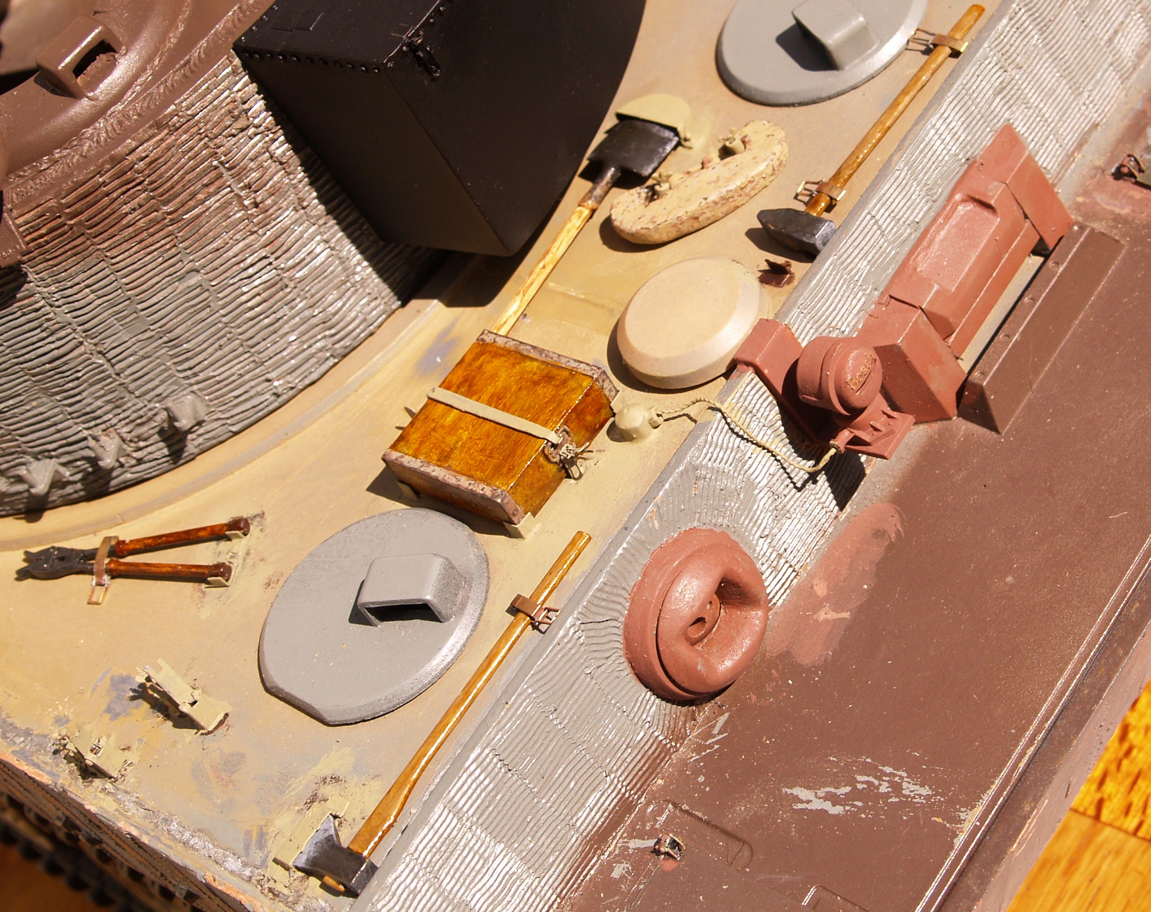

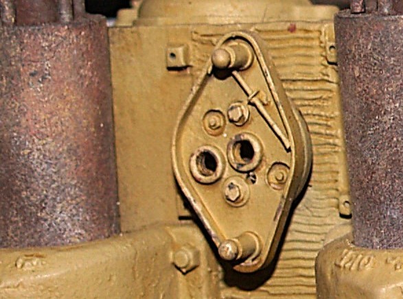

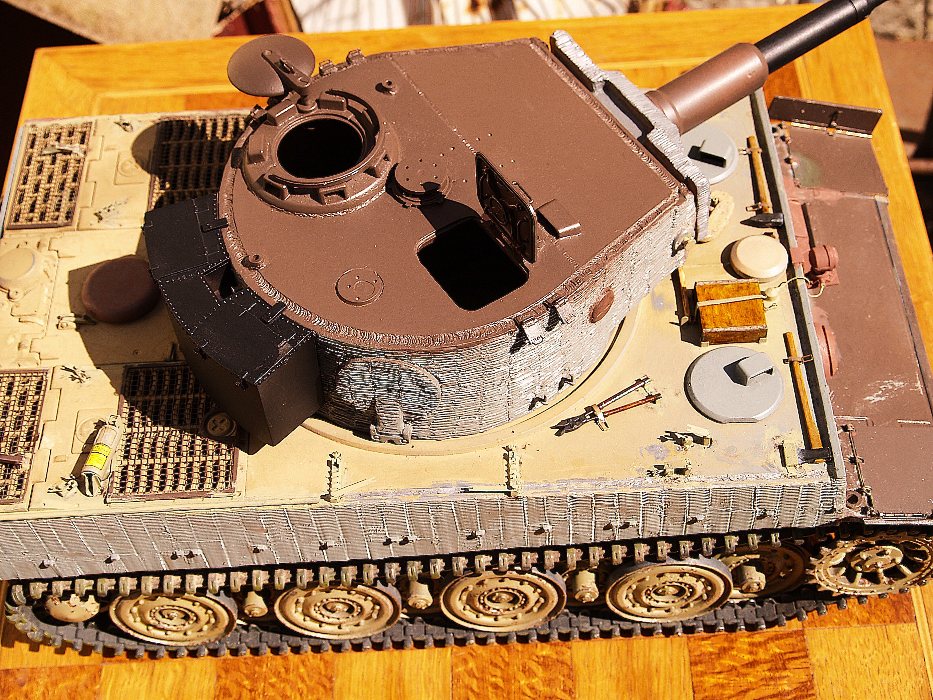

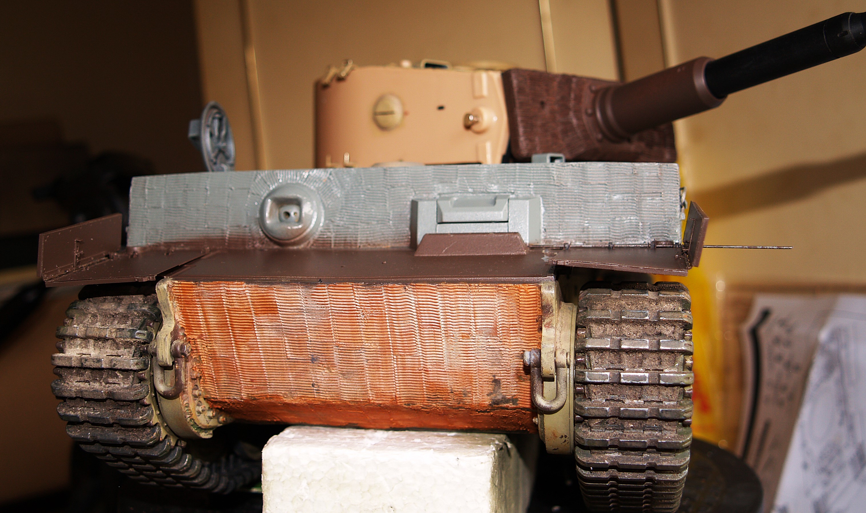

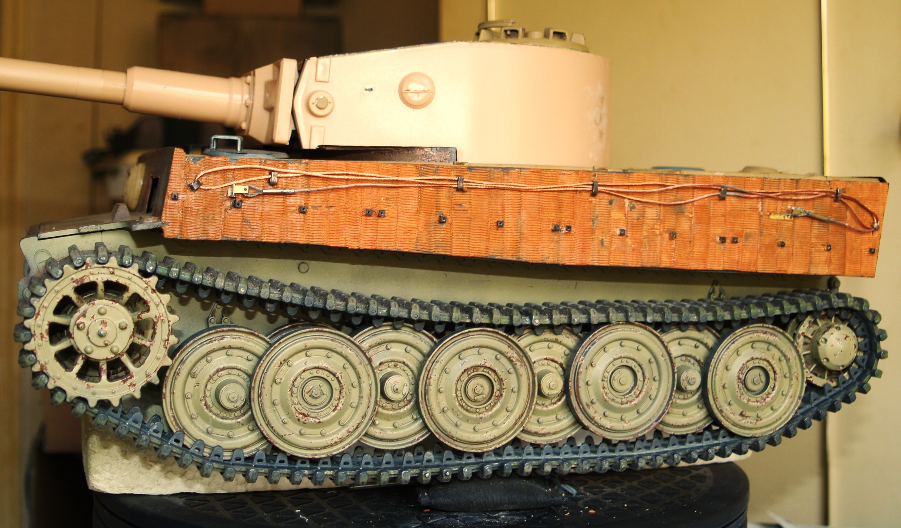

[AND NOW . . . . ZIMMERITT !
This is a test piece - Milliput , about a pea size at a time . Spread out almost paper thin , levelled with water until smooth
Now the secret - I 'obtained' a tool from a Hobby boss kit - a kind of 1mm pitch etched saw edge thingy , (maybe a used saw blade might work)
Then I coated the milliput with dish washing soap - it stops the milliput sticking and dragging damaging the finnish , stopping frequently to wash the tool .
Leave overnight , and rinse off with water , loadsa bubbles ! when dry -
LH hull.JPG (975.29 KiB) Viewed 1923 times
more anon , TTFN. B.

Well done on the zimmert :thumbup: . Excellent result. Can you buy the application tool by itself.

Bravo, blimp: I made mental note of the heavy box staple trick and your Zimmerit method. The surgery on the turret and gun mantlet impress me.

Sorry John , I haven't seen the tool as a separate item but will dig around and let you know .

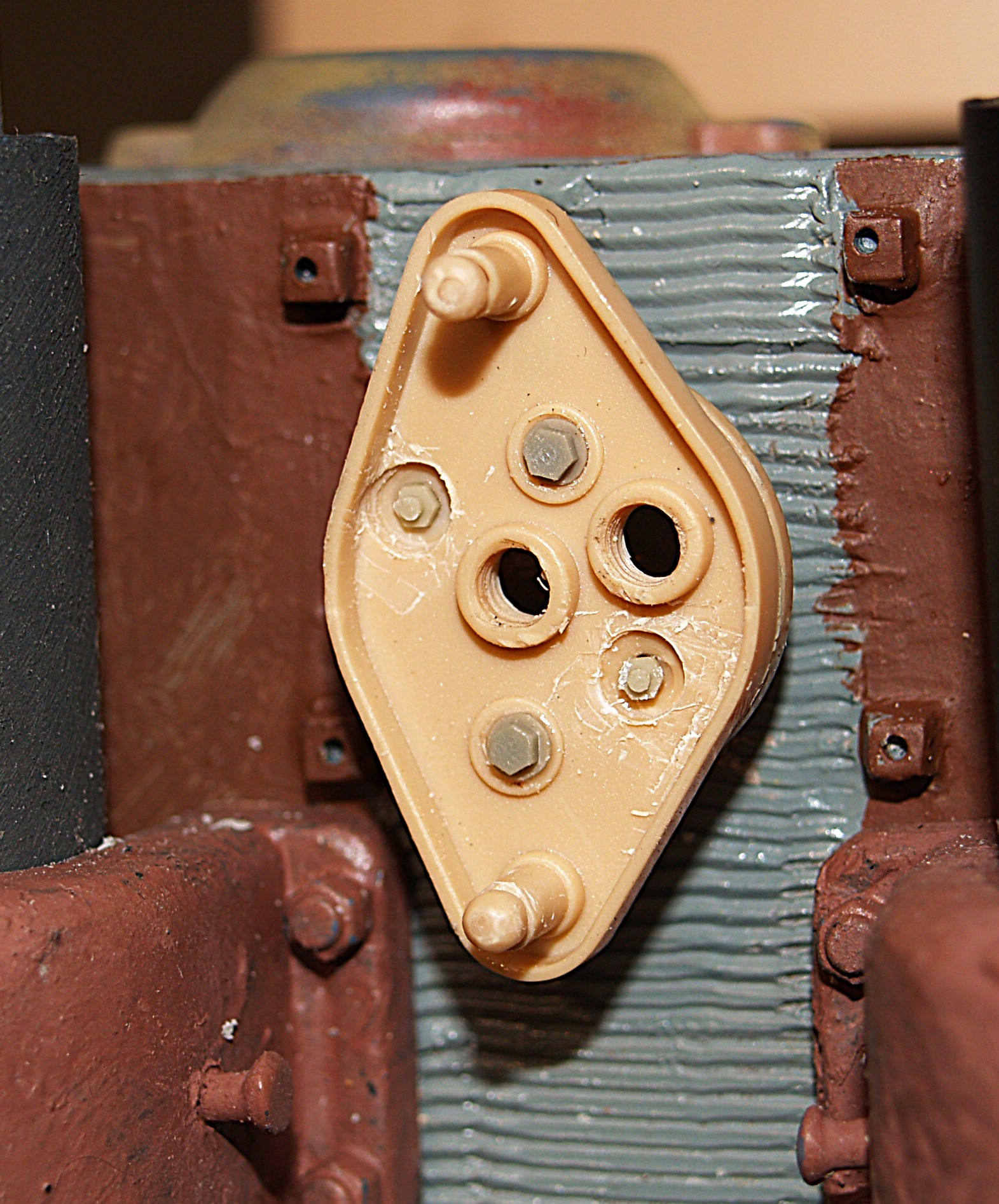

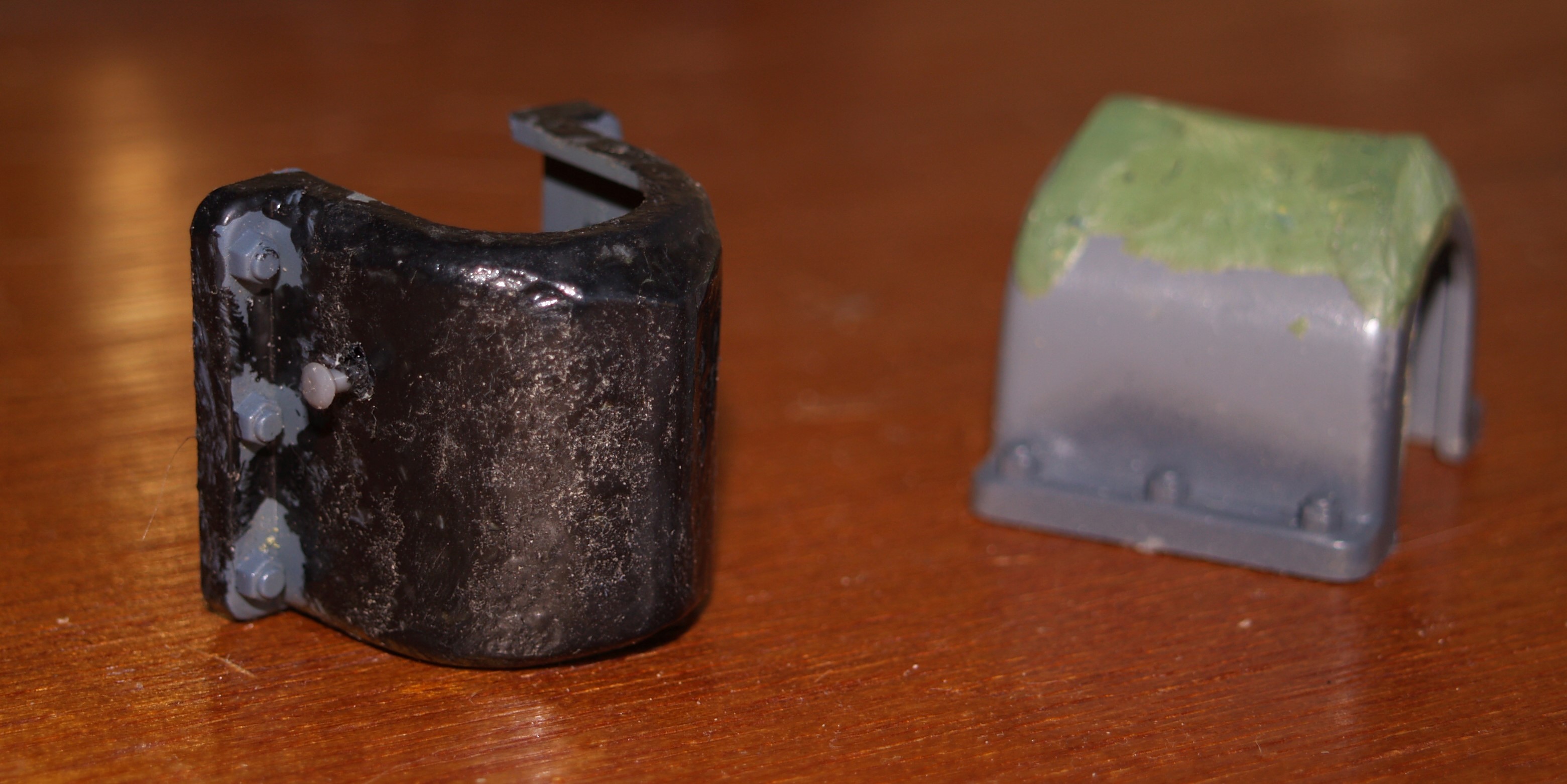

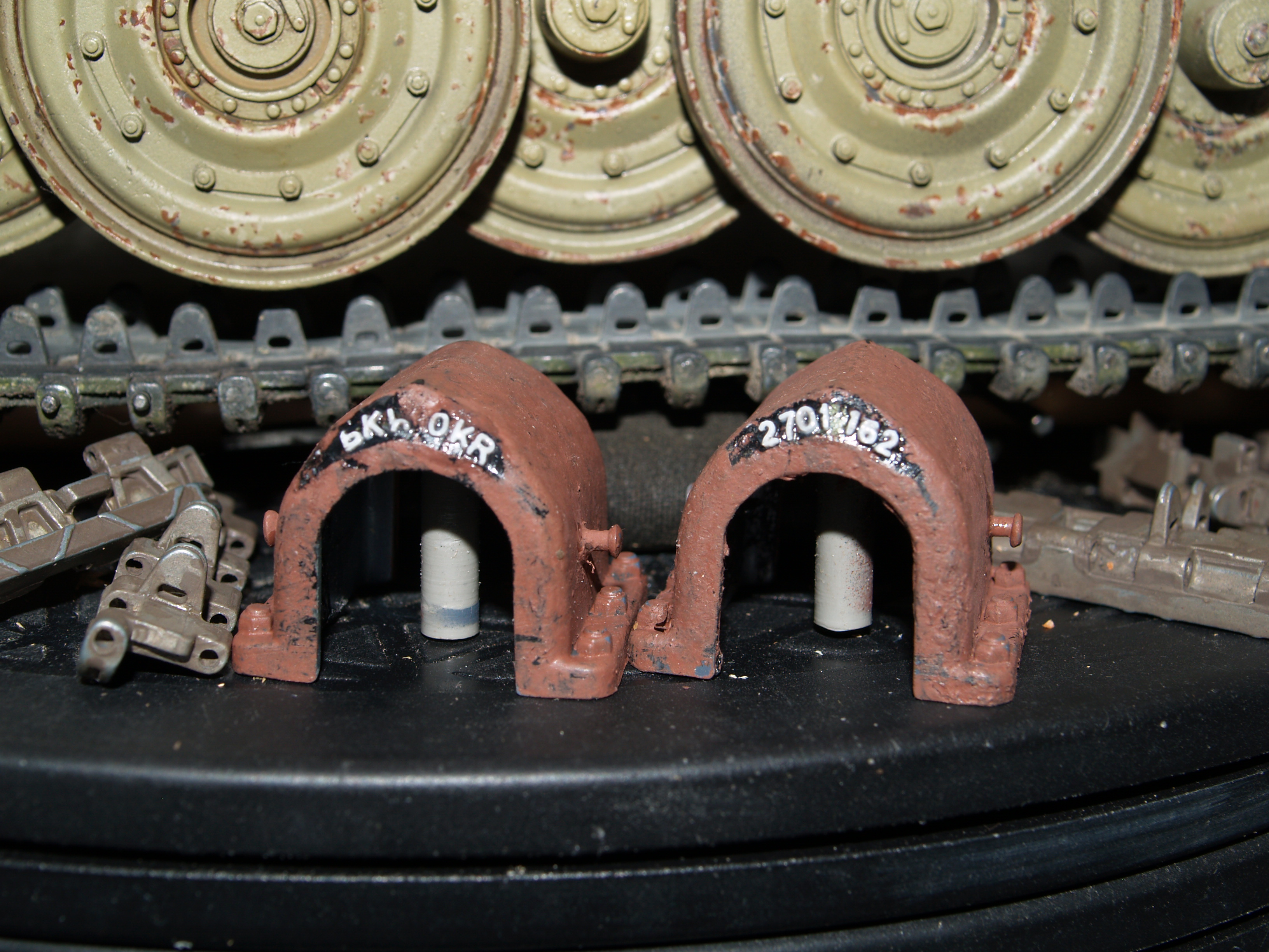

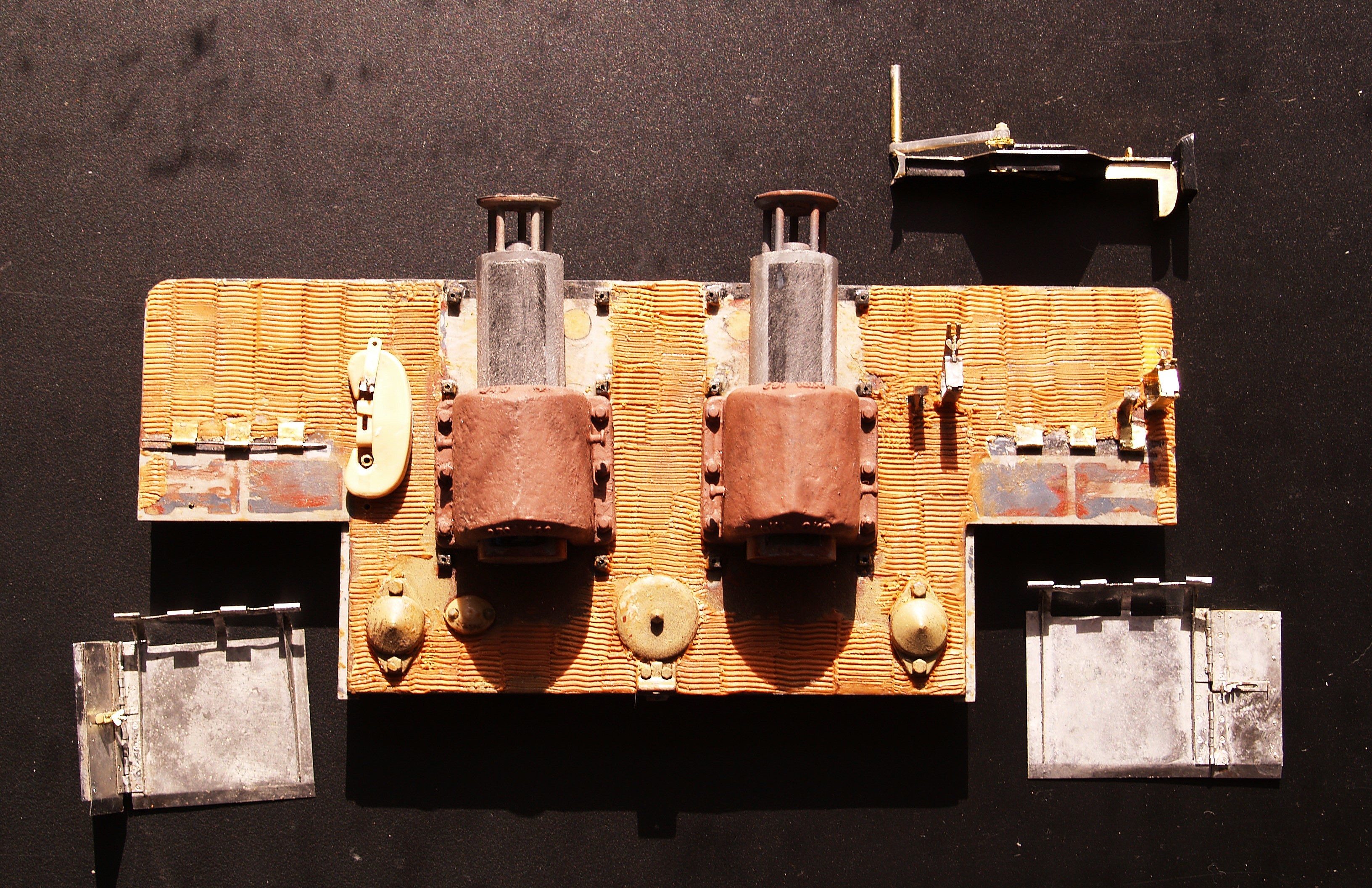

For the rear panel I decided to go for the minimalist look , the heat shields had to go .
The original HL exhaust covers were built up with green stuff , cast texture was done with dissolved styrene and some sprue 'rivets' made the lifting lugs .
Not happy with my first attempt , I re-did the foundry marks with 2mm. Slaters No's and letters.

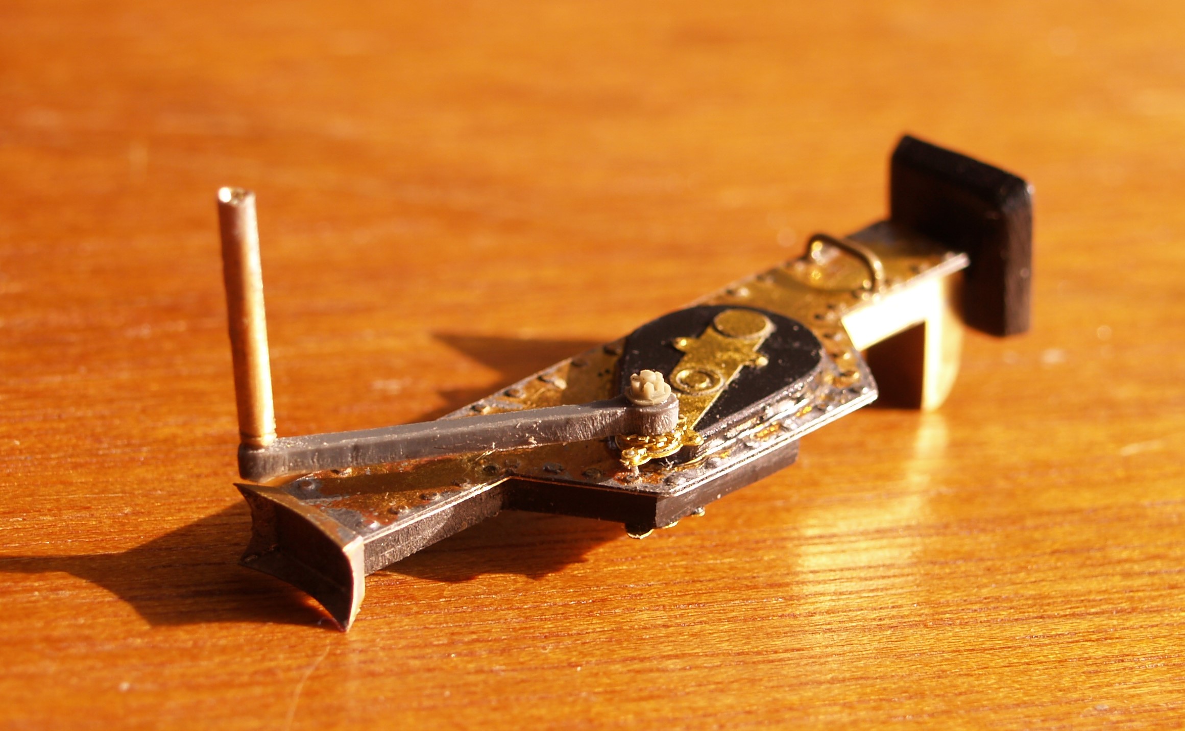

Jack
15t jack.JPG (461.31 KiB) Viewed 1891 times
old-new adaptor.JPG (475.47 KiB) Viewed 1891 times

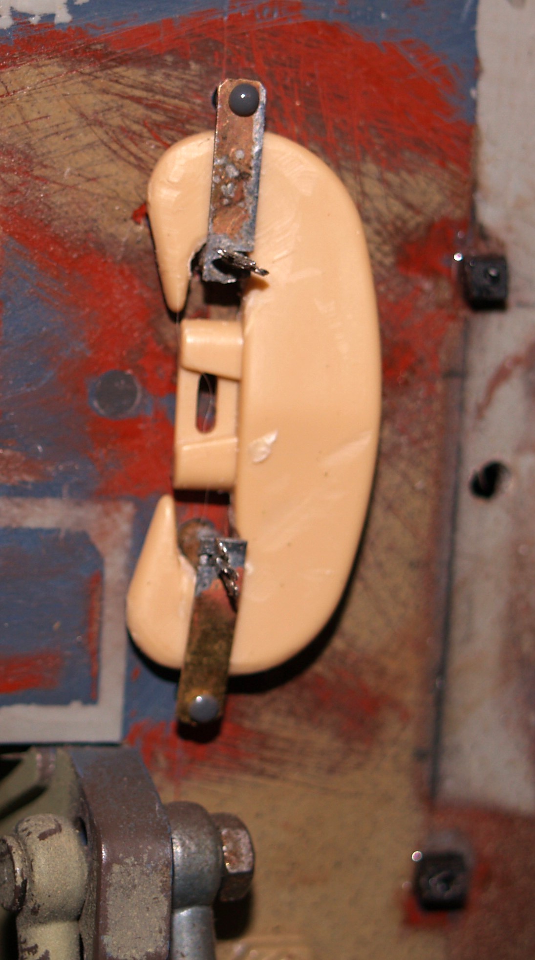

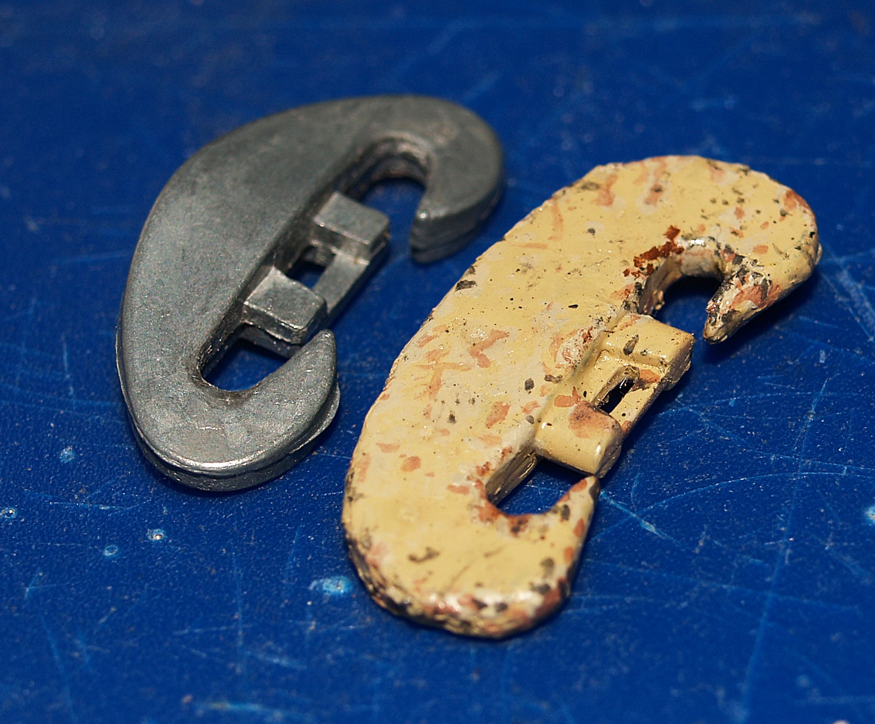

I sourced the correct size C hooks B| [/center] [attachment=2]C-hook types.JPG
C-hook types.JPG (526.56 KiB) Viewed 1891 times
C hook mount.JPG (289.64 KiB) Viewed 1891 times
rear panel.JPG (1.88 MiB) Viewed 1891 times
Back end , with new brackets etc.

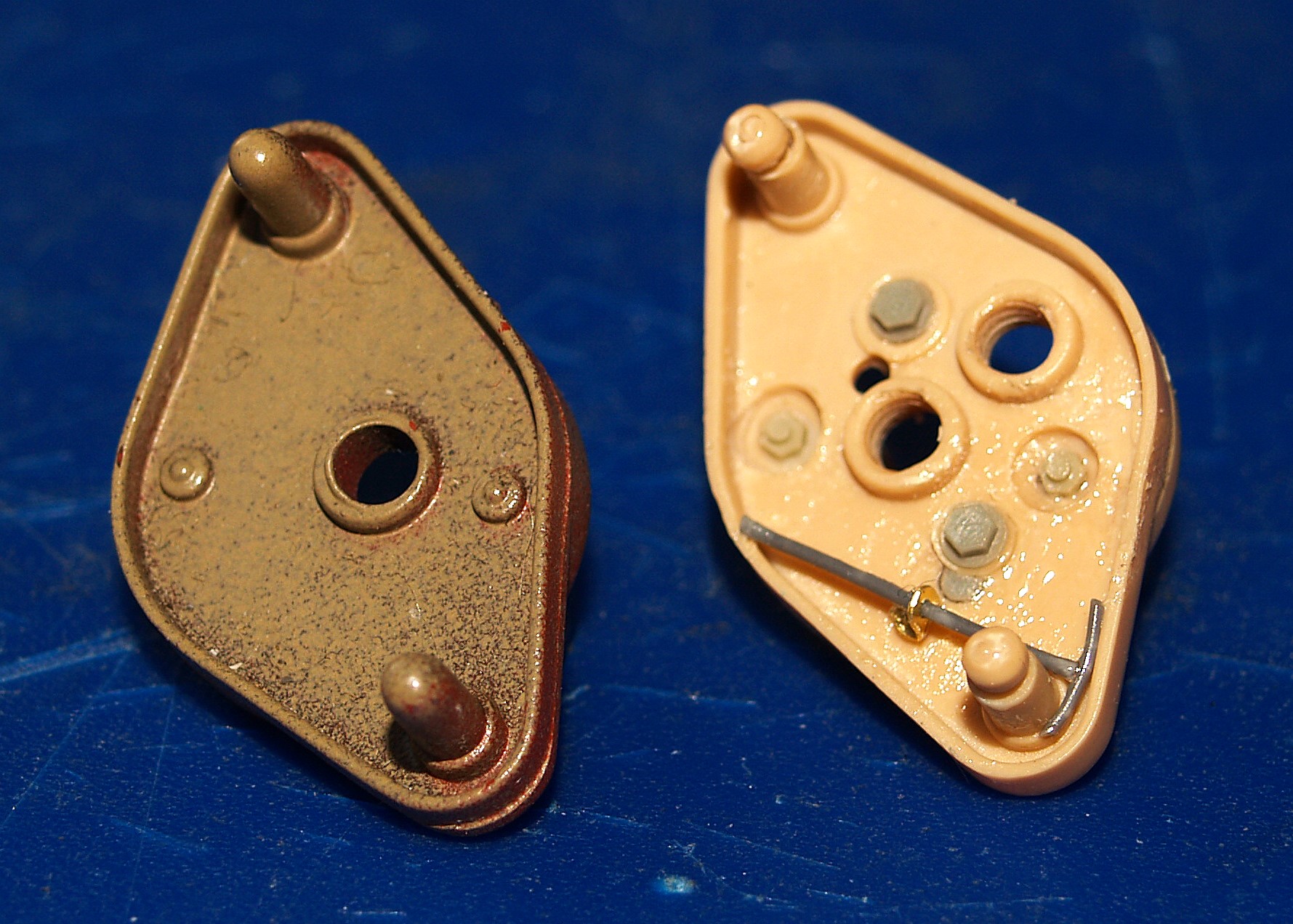

late adaptor (2).JPG (626.67 KiB) Viewed 1891 times
:haha: with paint , probably my favorite detail.
Late adaptor.JPG (81.95 KiB) Viewed 1891 times

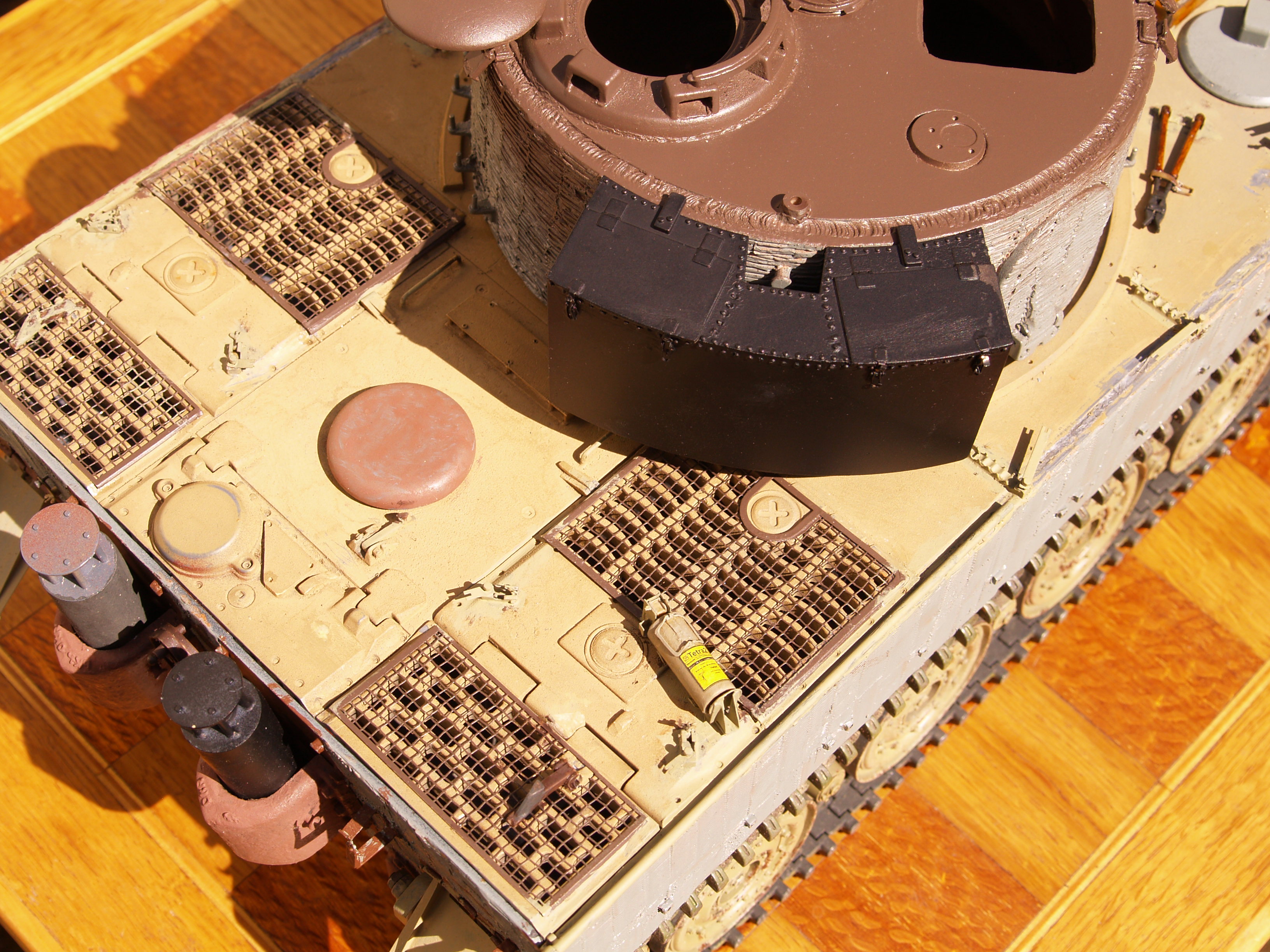

Final bits .

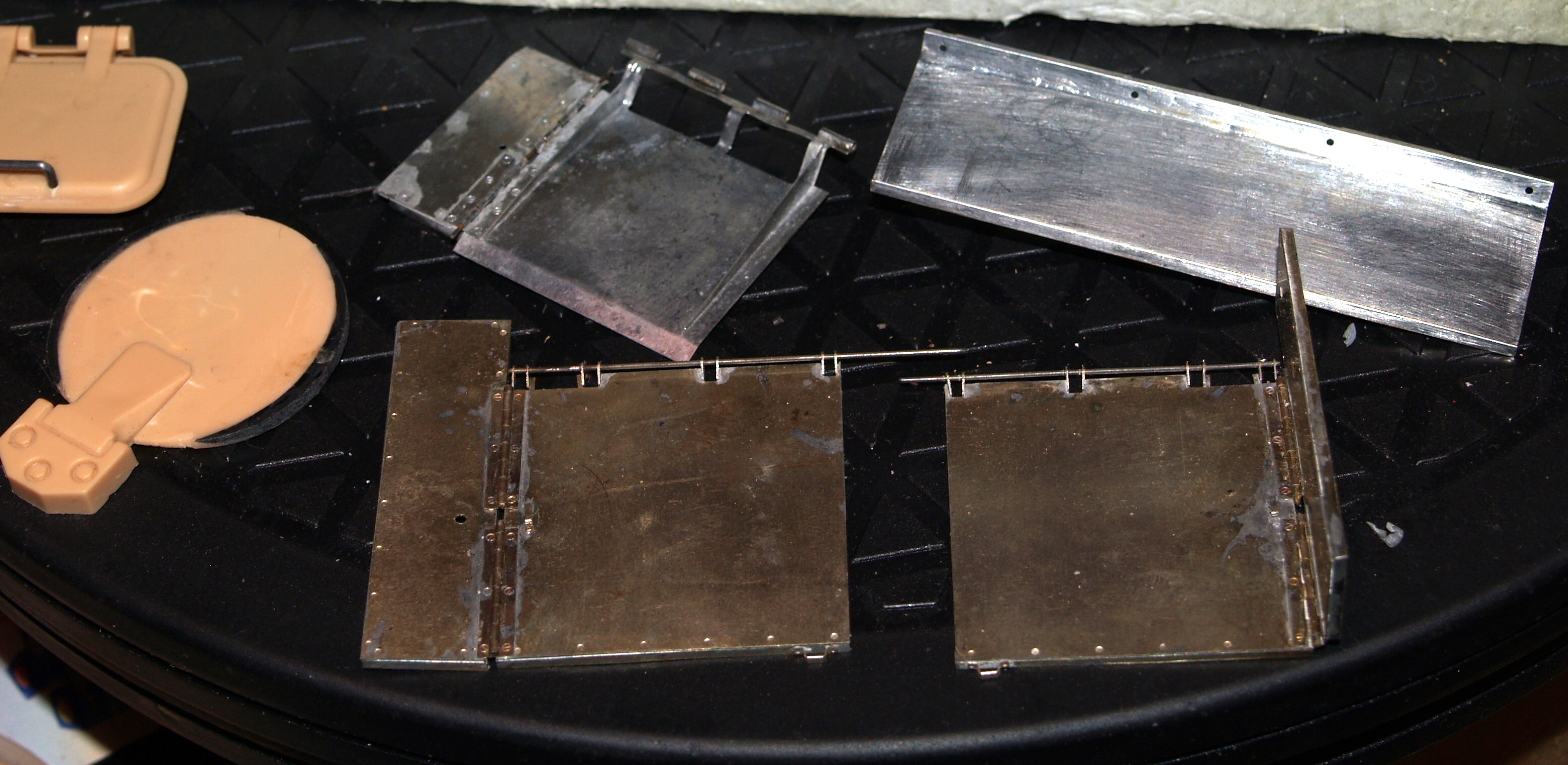

The voyager fenders are fully posable - and fragile , I may glue/solder them.
front m guard.JPG (337.19 KiB) Viewed 1870 times
front zimm.JPG (1.1 MiB) Viewed 1870 times
riveting the bin.JPG (1.06 MiB) Viewed 1870 times

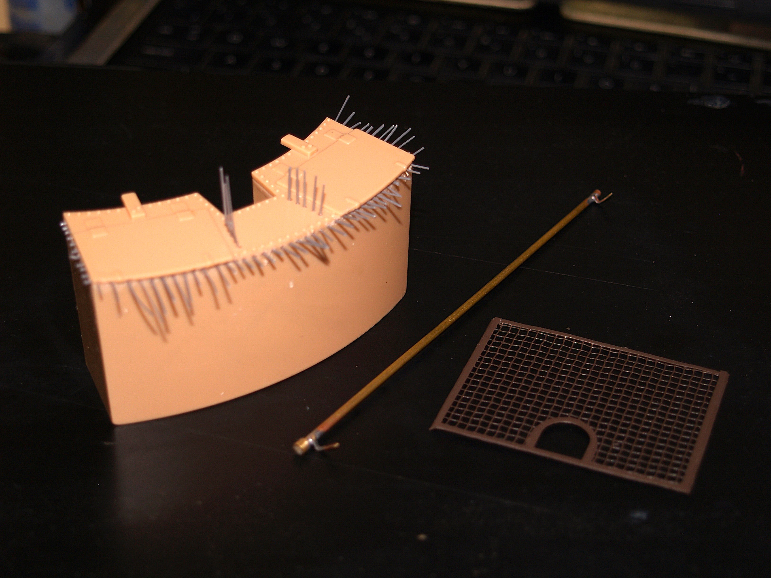

Adding the missing rivets to the turret bin , spare aerial tube from brass , and engine screen.
- the Voyager engine mesh panels are slightly too big , so I re-framed them with scrap PE and added pins for better location.
Turret was Zimmed by hand , to give the typical henschel look.

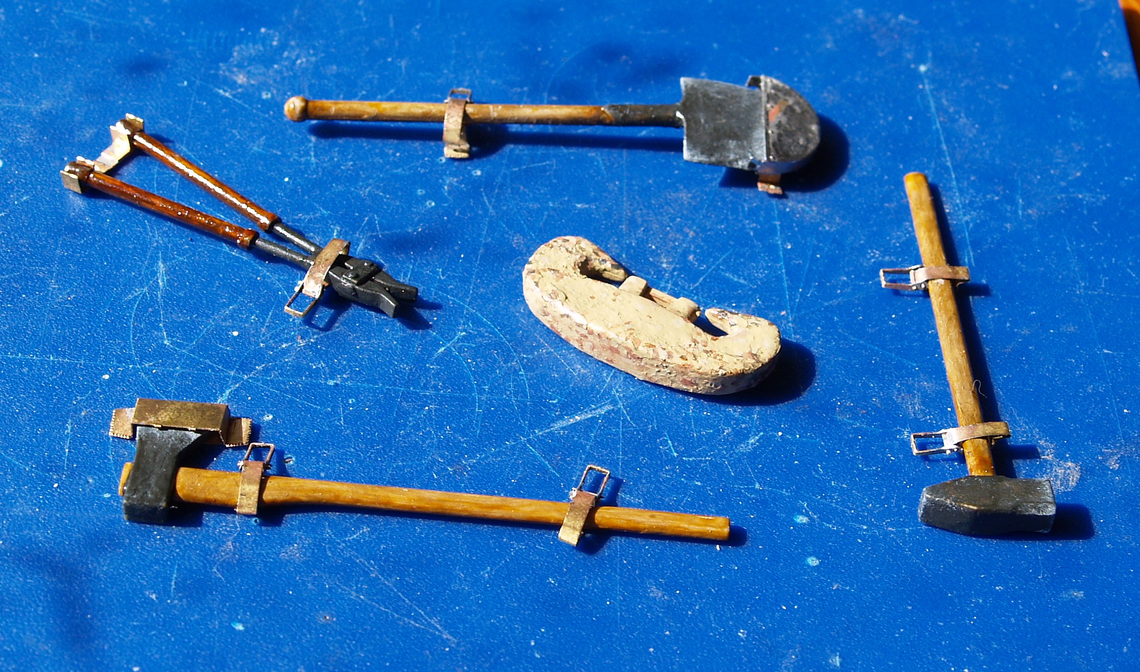

Voyager clamps , fire extinguisher holder and cleaning rod holders fitted.

Sorting the clasps and tool positions
