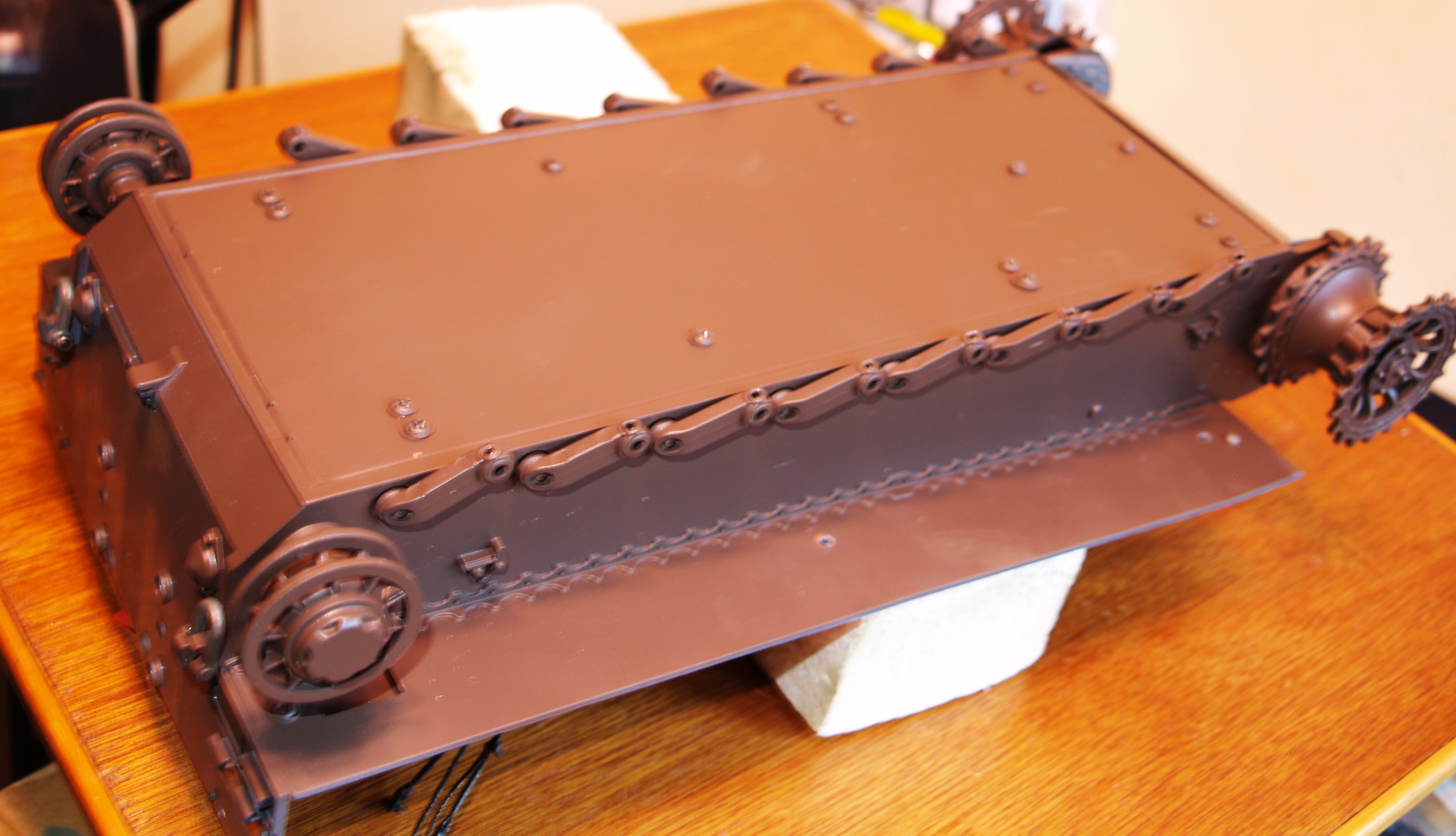

- P3118167.JPG (695.16 KiB) Viewed 1993 times
Asiatam hull ( yes , the 'original' it's that old ) Now has Henntec tensioner , steel 'boxes with drive shaft bearings , Hull top bracing strip
plus some magnets to keep it together . All the usual stuff

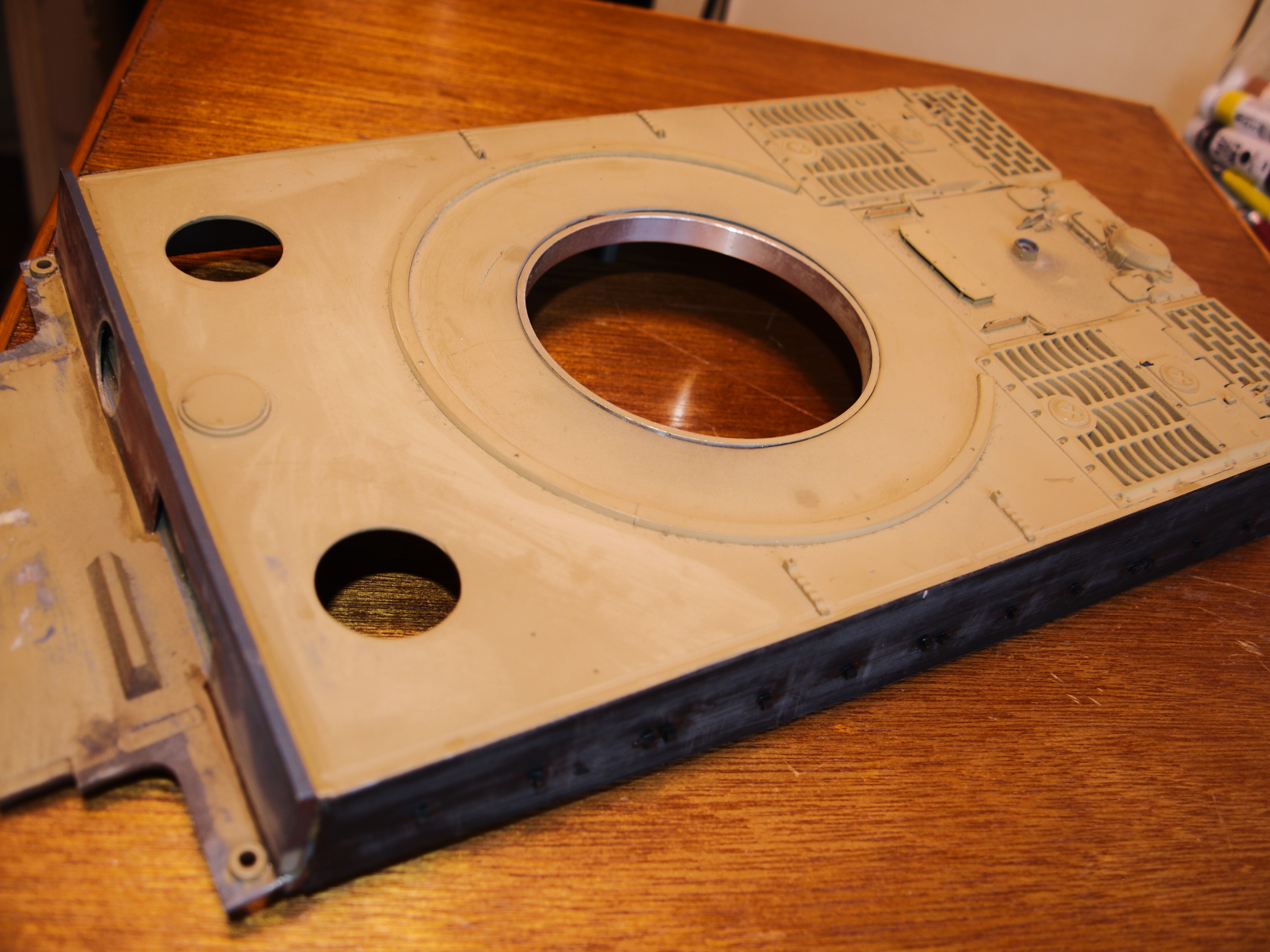

- P3118166.JPG (1.01 MiB) Viewed 1993 times
Ditto the HL upper mods - re centered turret ring ,opened hatches , 'late' engine deck details.
I also removed the mud guards , with a big hacksaw
no messing about here , I'll have proper carnage , me.
According to refs the hull is 1mm too narrow - so the sides were then skinned with .020" / .5mm styrene , CA , trim , quick , simples ,job done

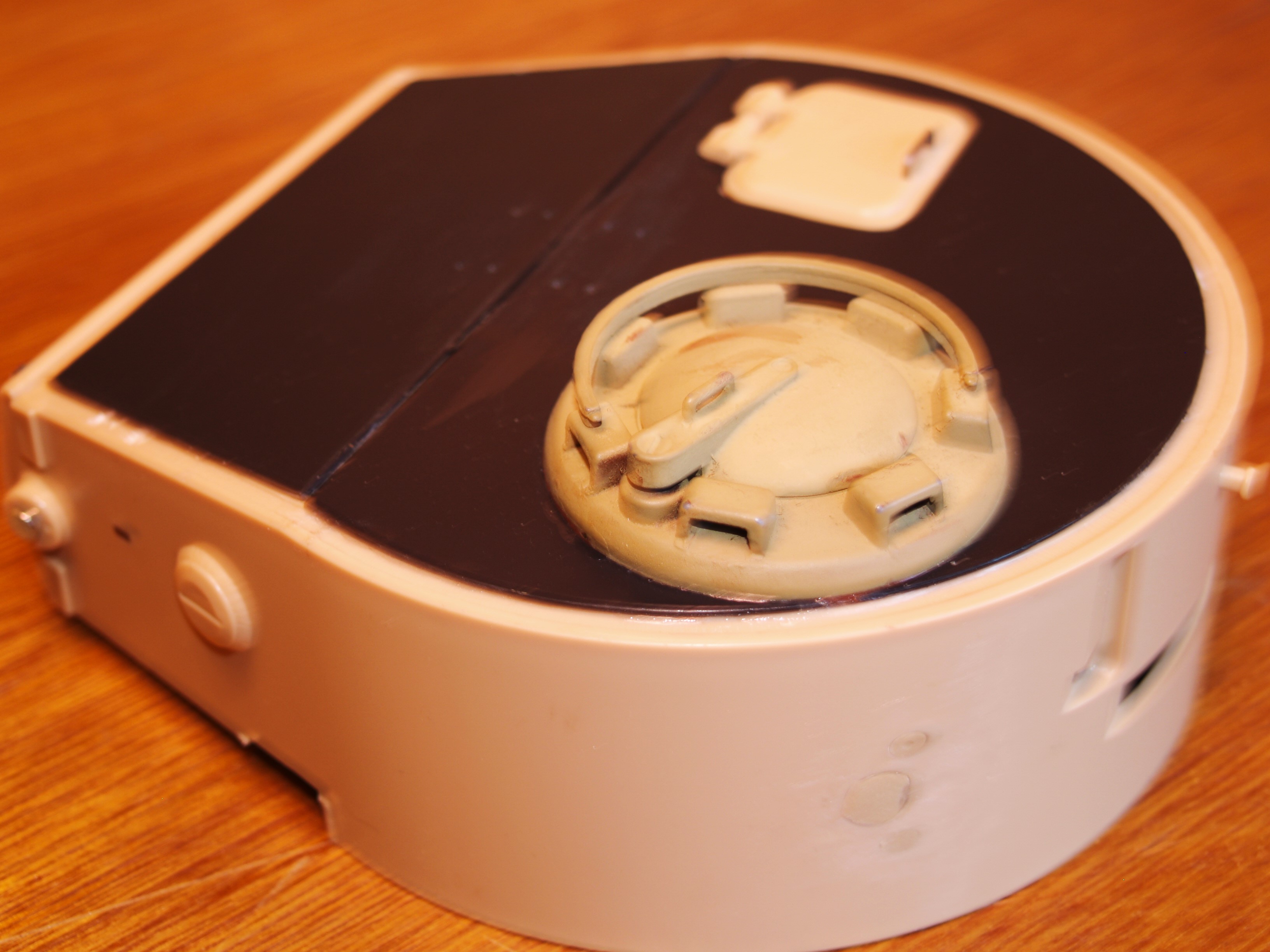

Next the turret , a Taigen recoil jobbie , courtesy of Dave 'n Julie @ Forgebears emporium . Again this too received the cut 'n shut treatment to correct the shape , with the later '40mm' roof etc. plus a scratched new lower part with recentered ring.

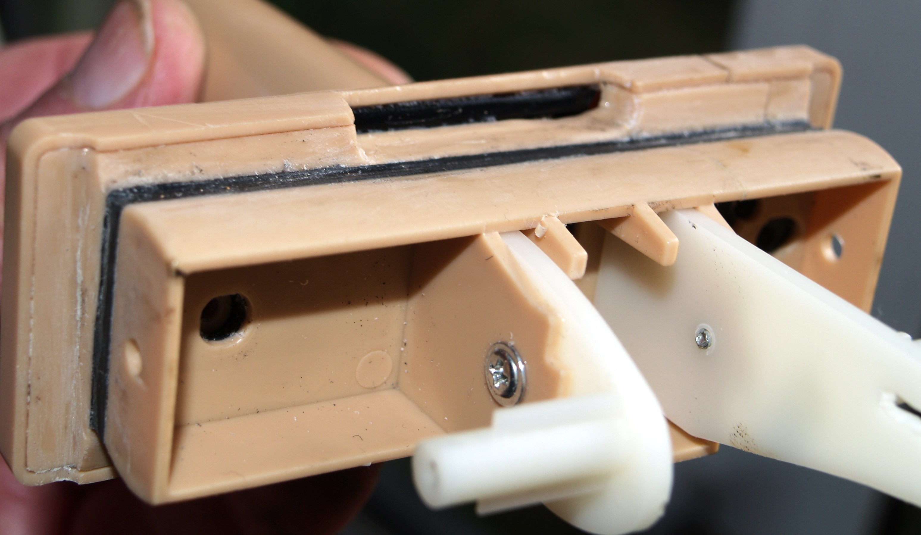

- Mantlet mod.JPG (524.11 KiB) Viewed 1993 times
The Mantlet was also narrowed to suit , the trunnions were recentered more to scale - a packing piece is needed here. and a bit of fettling with the recoil unit because this new fulcrum point alters the elevation a little .

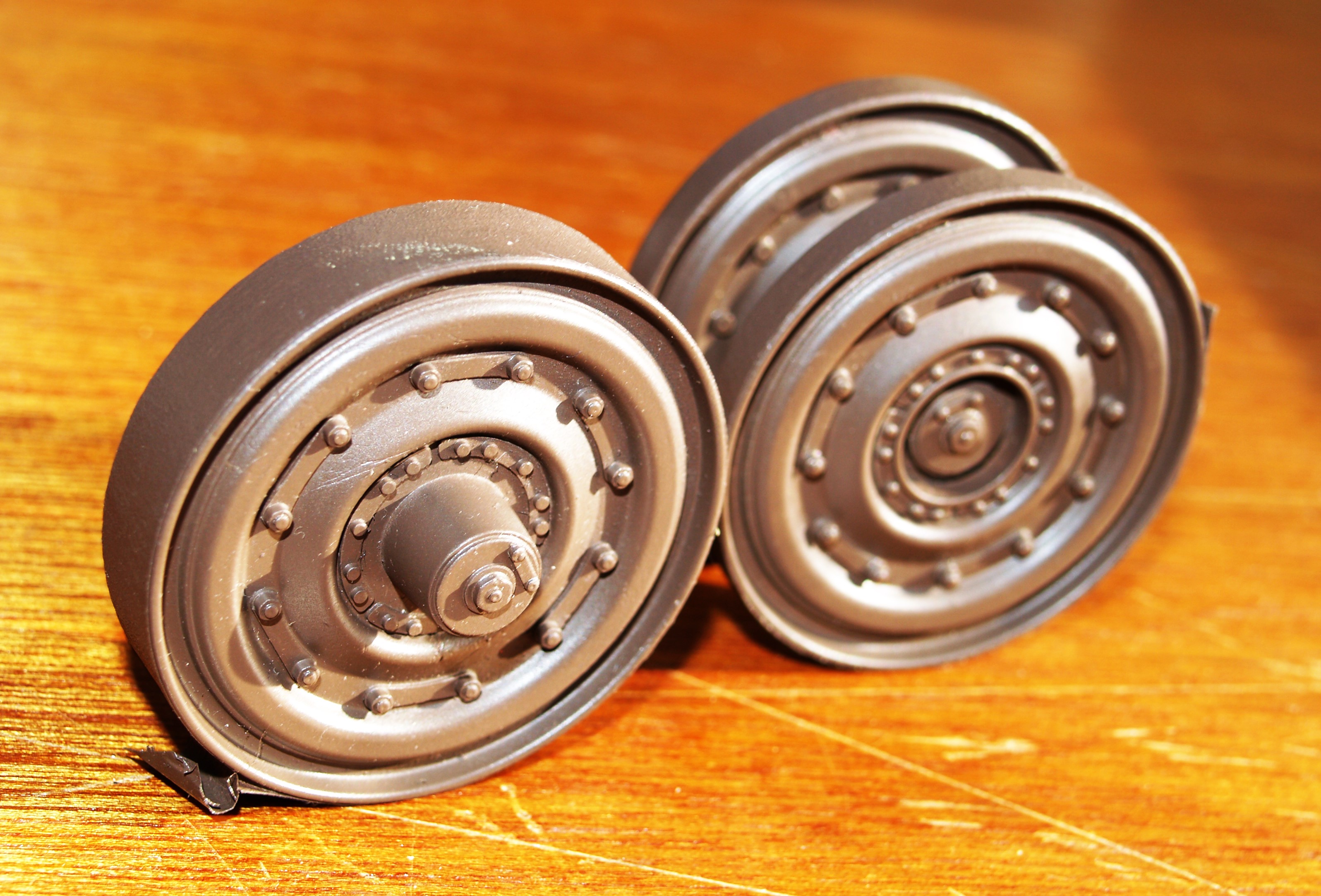

- masked n primed.JPG (1.1 MiB) Viewed 1993 times
Steel wheels- oh yes ,lots of them .

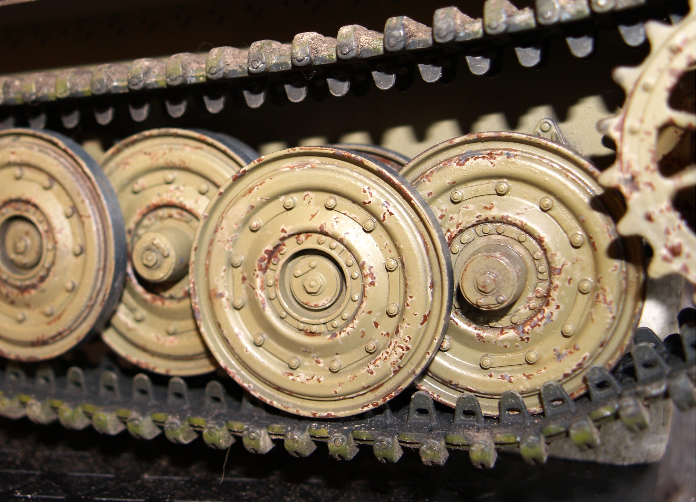

- Chips.JPG (694.1 KiB) Viewed 1993 times
- All this will fade under a filter and weathering .
