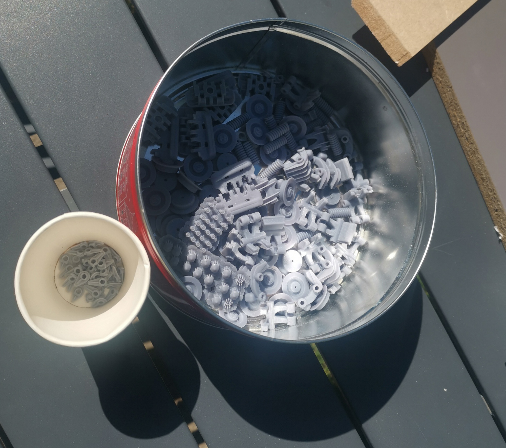

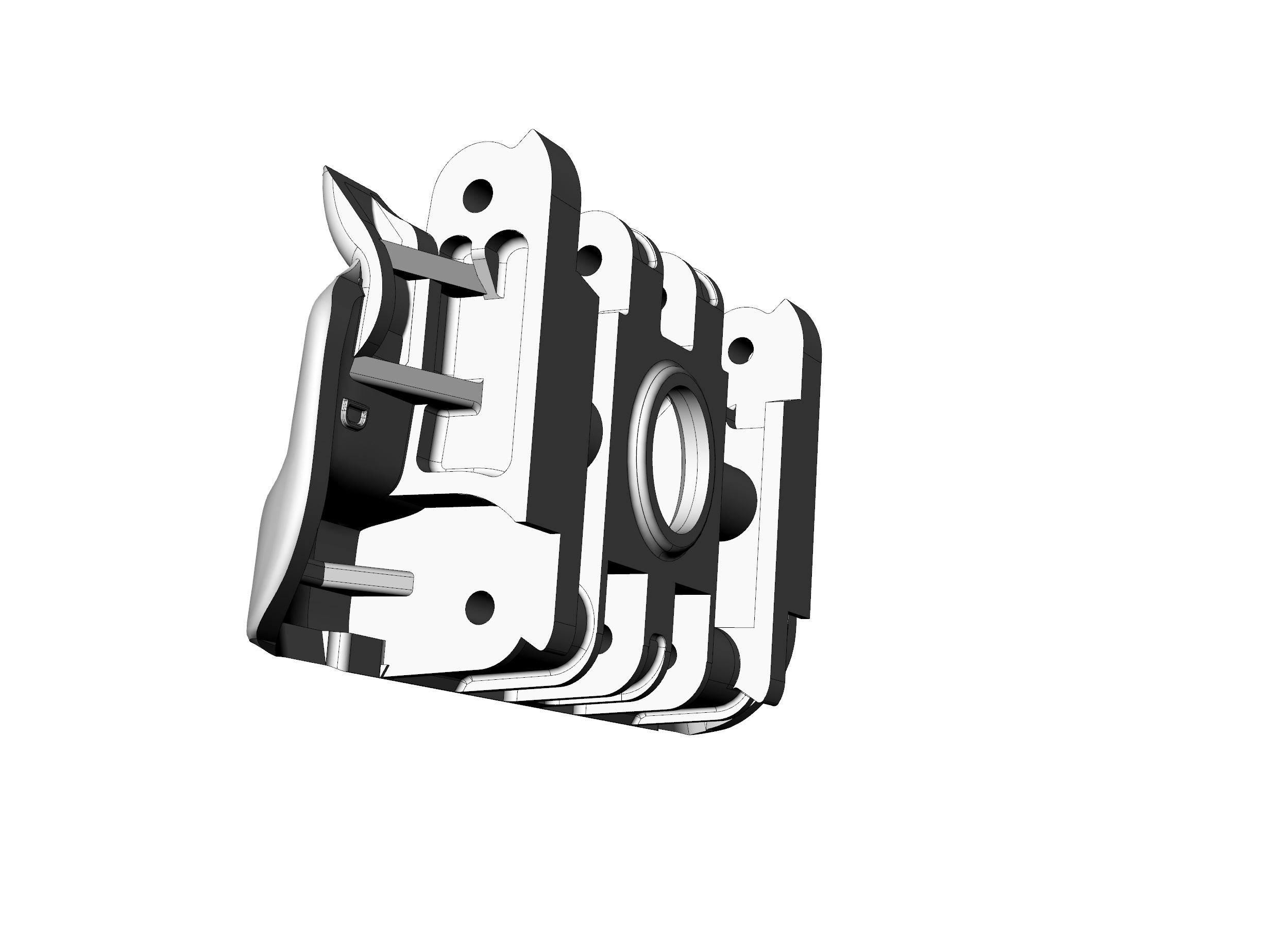

My first Churchill is a great runner, one of the best I have (Tamiya tank included), I was not expecting that when building it. But the other day, I was running it in the park and I lost a wheel, I never found it. I had to print another one, not a big deal, I had the file... wait, while I was browsing all the files I created for the Churchill to find the wheel, I realize I did a lot of work and that building a second Churchill would be super fast. So I ended up printing the missing wheel... and a whole new set of wheels for a new Churchill.
2 days later I had that :

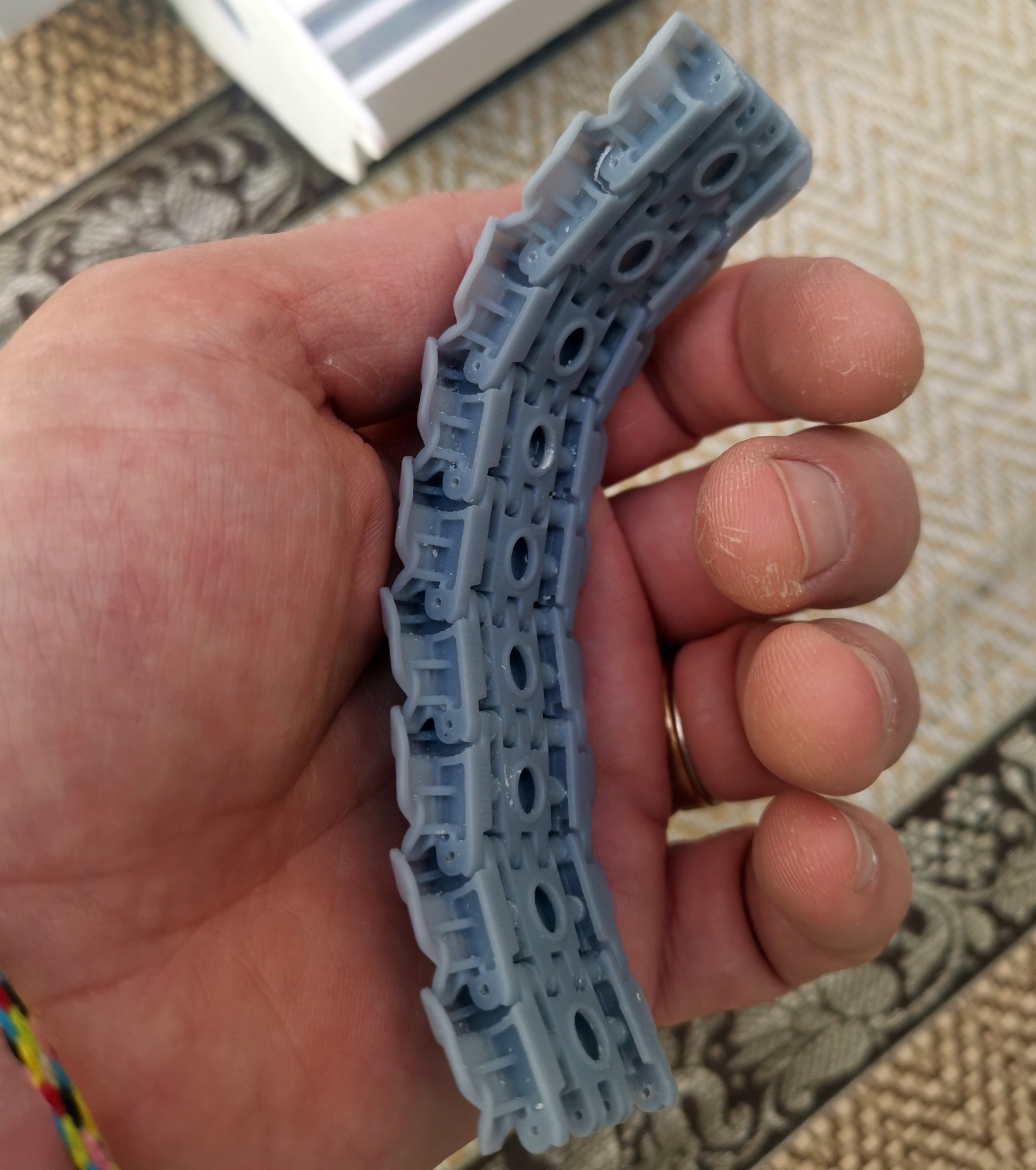

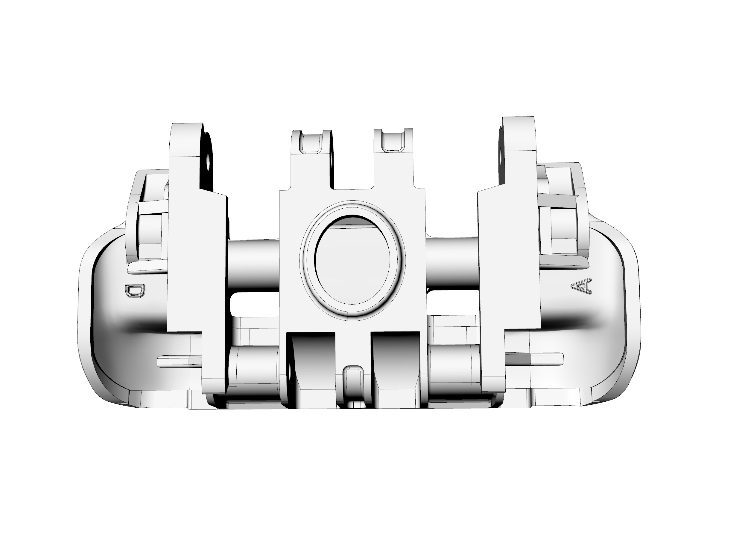

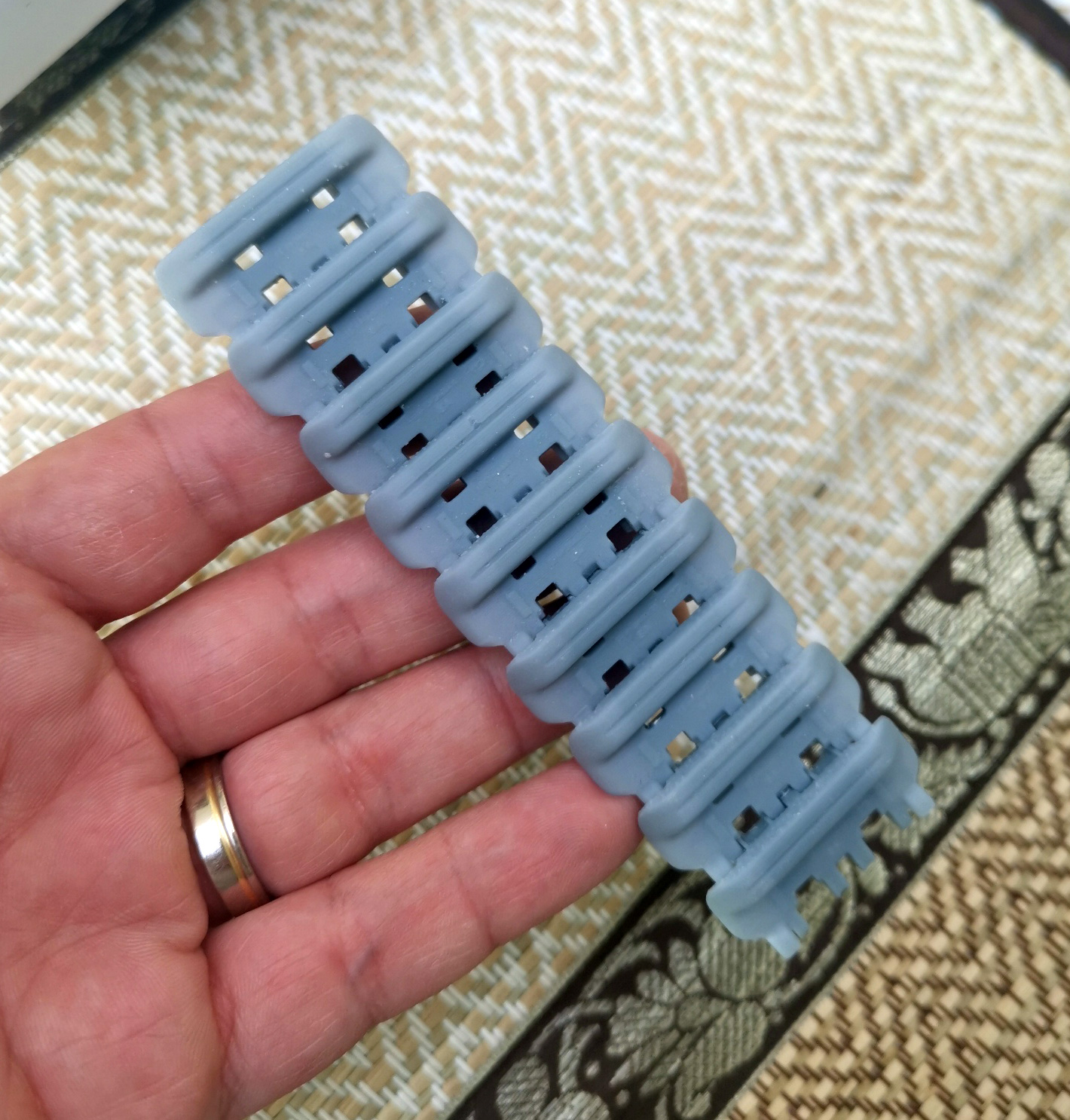

When I was building the first AVRE, I knew it would be a SBG and I was quite frustrated because 80% of the SBG and I think 100% of the ones that landed on D-Day, had the early tracks (I had the late metal ones made by DKLMRC). I always liked the early tracks better on the Mk IV and previous Churchill version. No question regarding the Mk VII obviously. :)
So I designed the early tracks, using photogrammetry of an original one to be as accurate as possible.
But I did not want to print them on a FDM printer. I would lose details, I never been able to print correctly track links with that kind of printer and most important : it takes forever.
I wanted them to be resin but I was affraid they would not be strong enough.

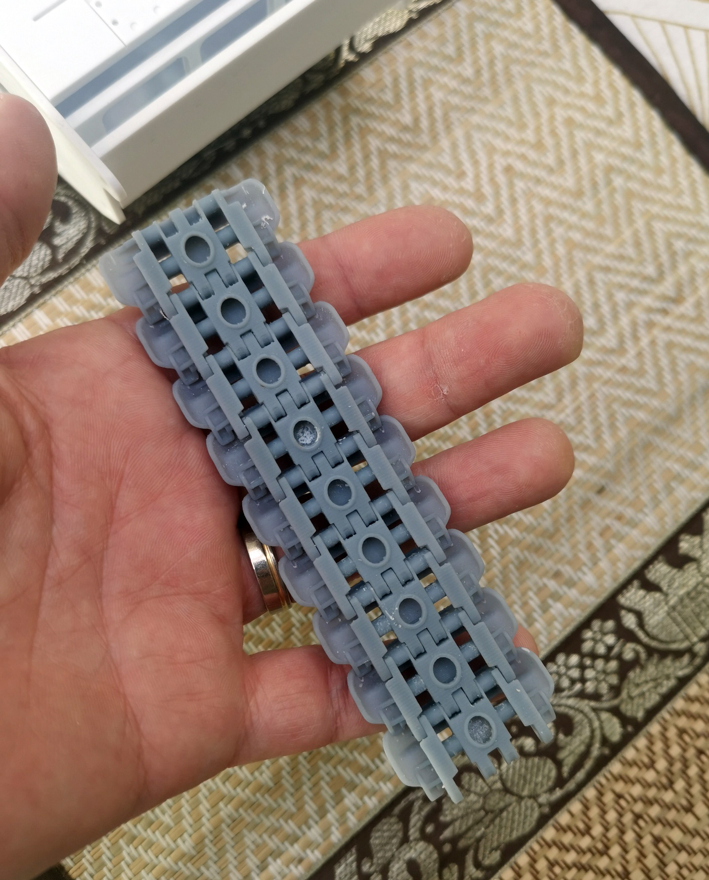

I did a print test with some Siraya resin. It was quite promising but very brittle :
Then I came across one of @tankme 's thread : viewtopic.php?t=36203
He mentionned he used Sunlu toughness resin and that the tracks were performing well. I had to try. And I did. It's the best resin I have ever used for tracks ! It's strong but a bit flexible, so the parts won't break.
I now have printed the set of 2 tracks with that resin. They are great, can't wait to try them !

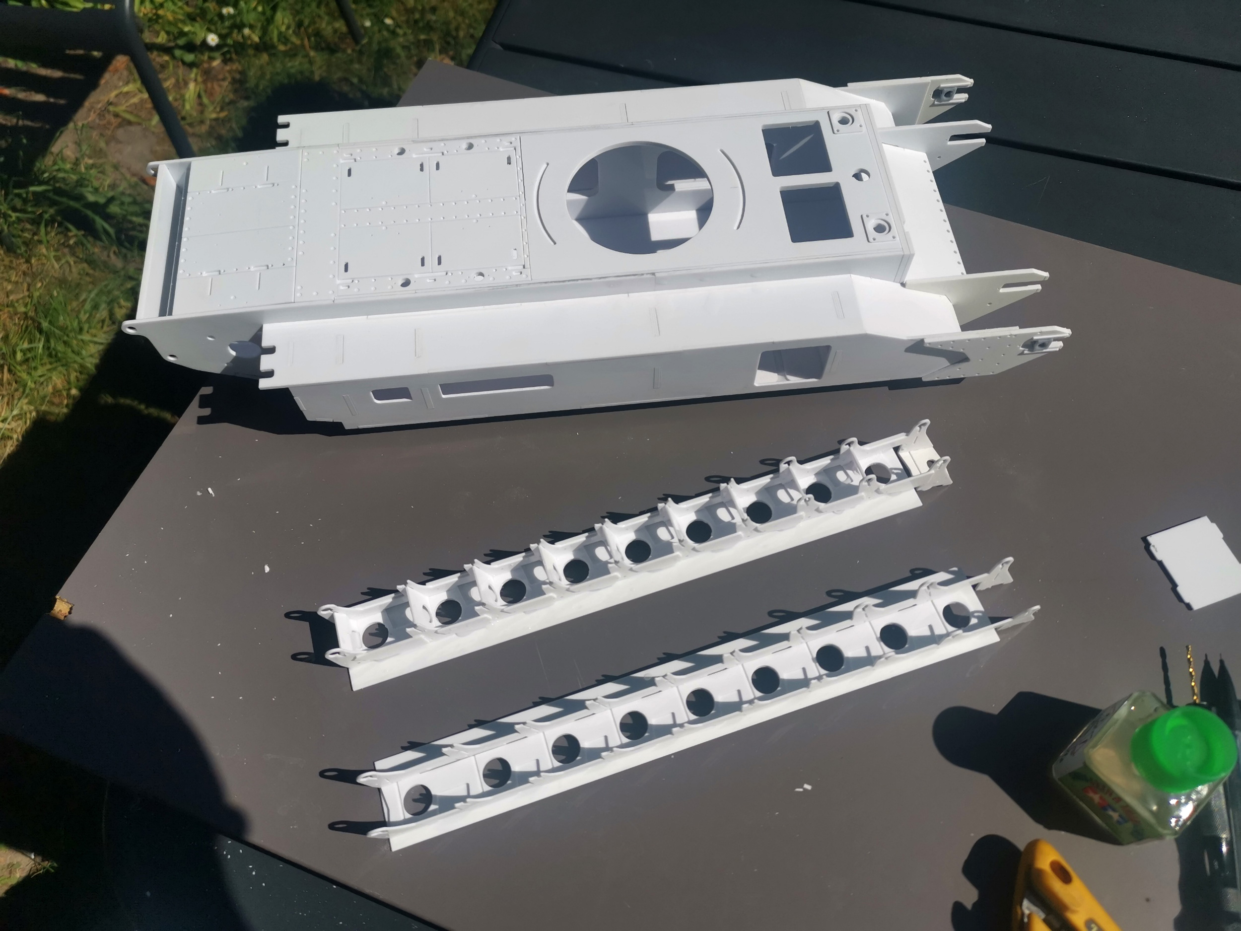

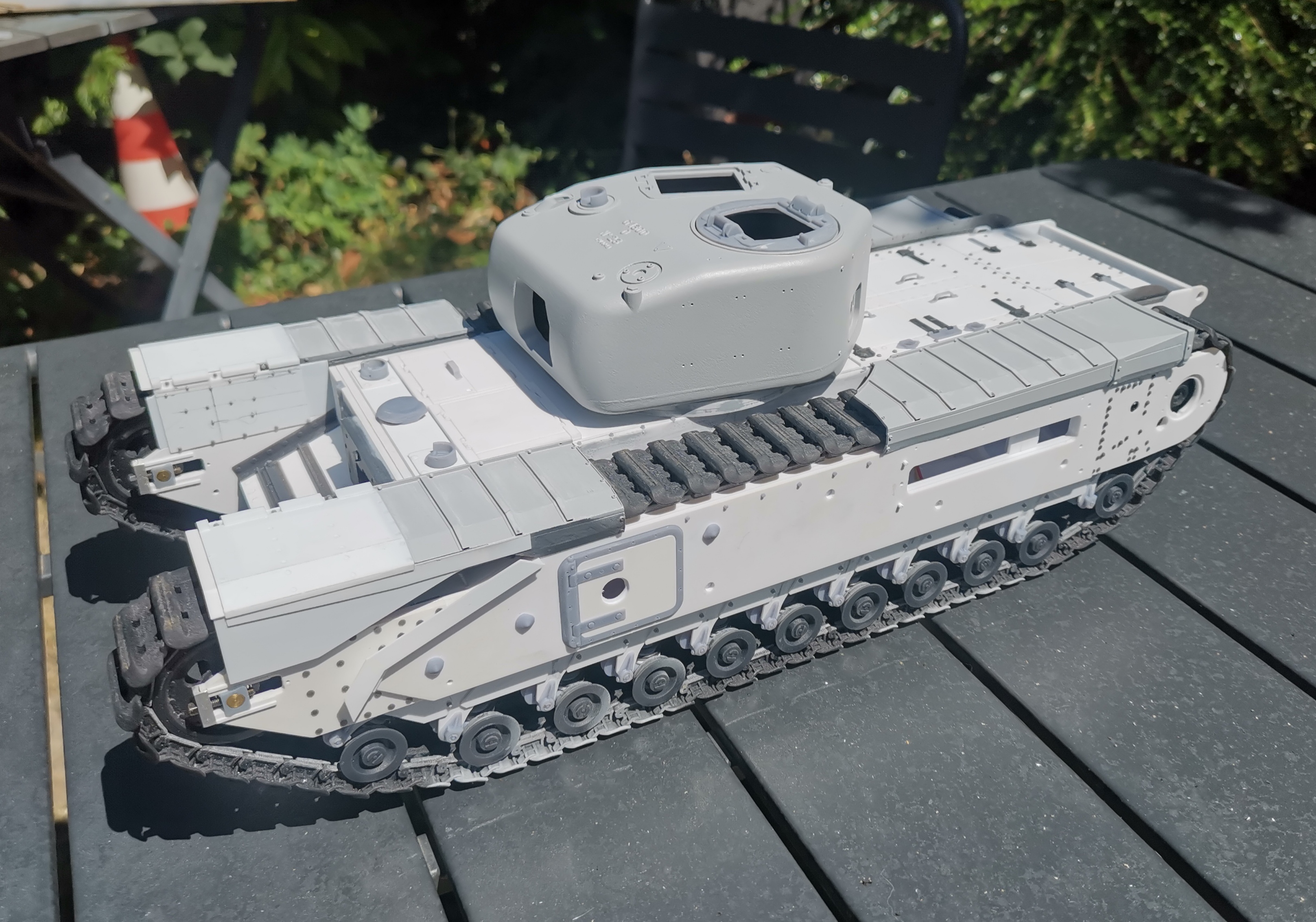

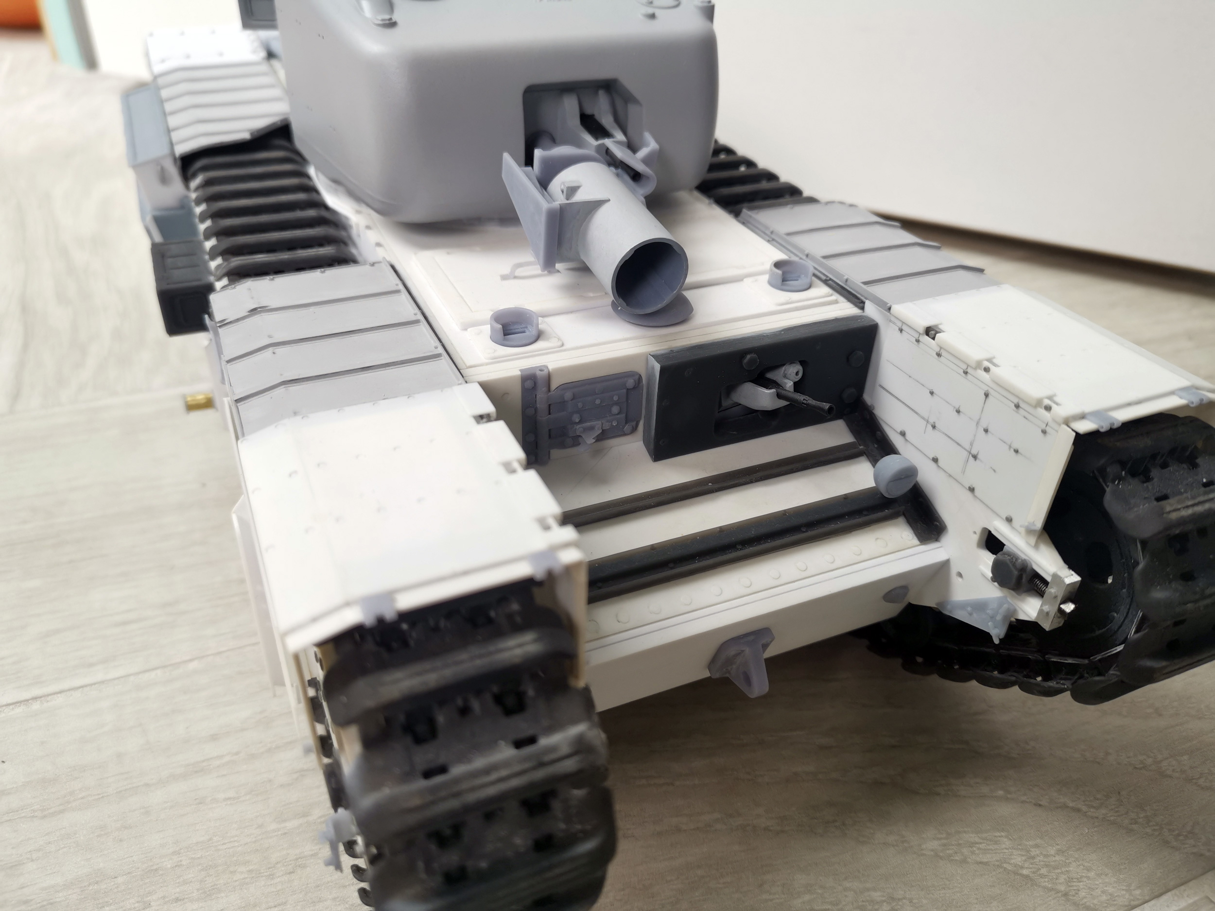

I did some progress on it but I crashed my CNC, I'm waiting for parts to replace the broken when but I suspect the motor controller is broken too so it may take a while until I received everything I need to get it running again. Too bad because I was close to the end!

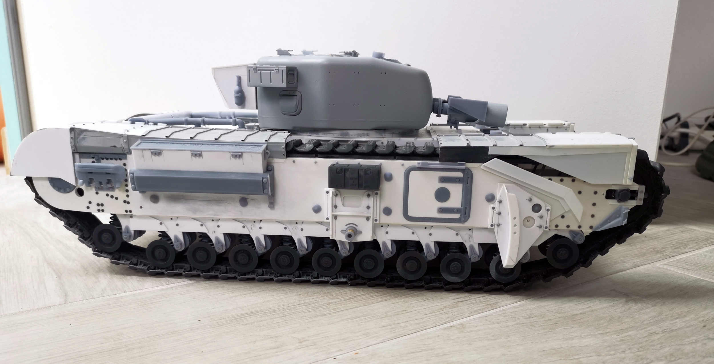

I finally find the Churchill I'm going to depict, it's going to be a log carpet, it'll be the 1F as seen in the pictures posted earlier. It has the middle section of the track guard removed like on every Churchill AVRE of the First troop.
It's hard to see on pics but those Churchill carry some ammo box on the hull (and on the turret), spare tracks (locations is different from a Church to another) and a kind of weird steel frame on both side, attached to the side air filters.
The tank is now in running condition and the printed tracks work like a charm. I used Sunlu toughness black as suggested by tankme and I'm very happy with the result. As strong as HL plastic tracks, if not more.
My parts for 3D printing :

Glad the resin worked out. I found that it was pretty good as far as being dimensionally accurate which is harder for the more flexible resins. Ran my Kranvagn on the resin tracks again this weekend and they held up great. I did have to remove a link as they did stretch some, but that is to be expected for any set of tracks.
Yes it's very good!
As you said it's dimensionally accurate, it's perfect for tracks. I'll have to remove a link on each track very soon too.
This resin is also good to print fine details that may break easily with regular resin on an RC tank.
I did print the track guards with that resin because I had very thin details on some places (0.2mm thickness) but the parts warped more than the ones I made with regular resin on the other Churchill.
Anyway I'm very happy with this resin and I'll be able to build all the tanks I had in mind that I couldn't build because of no available tracks.

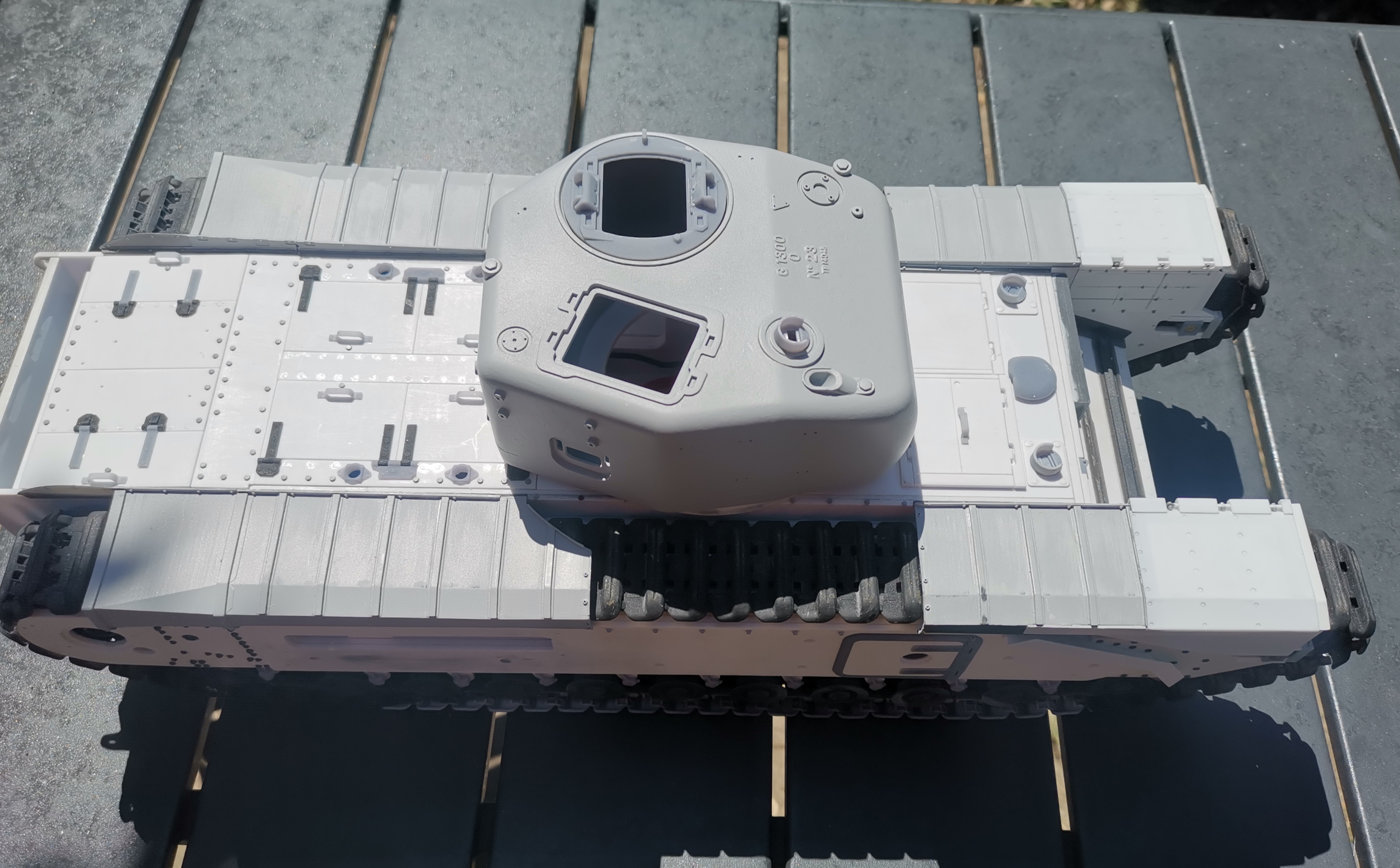

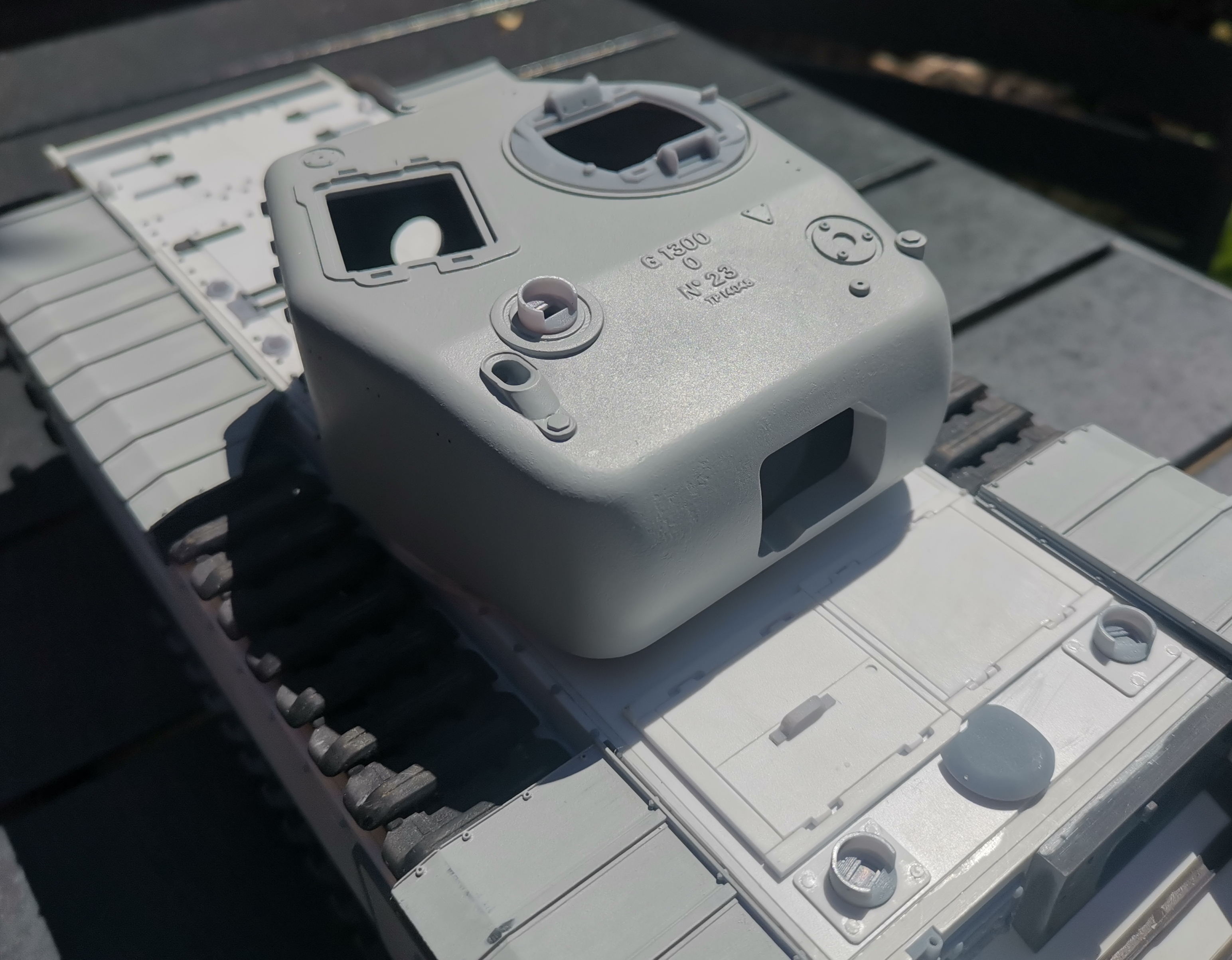

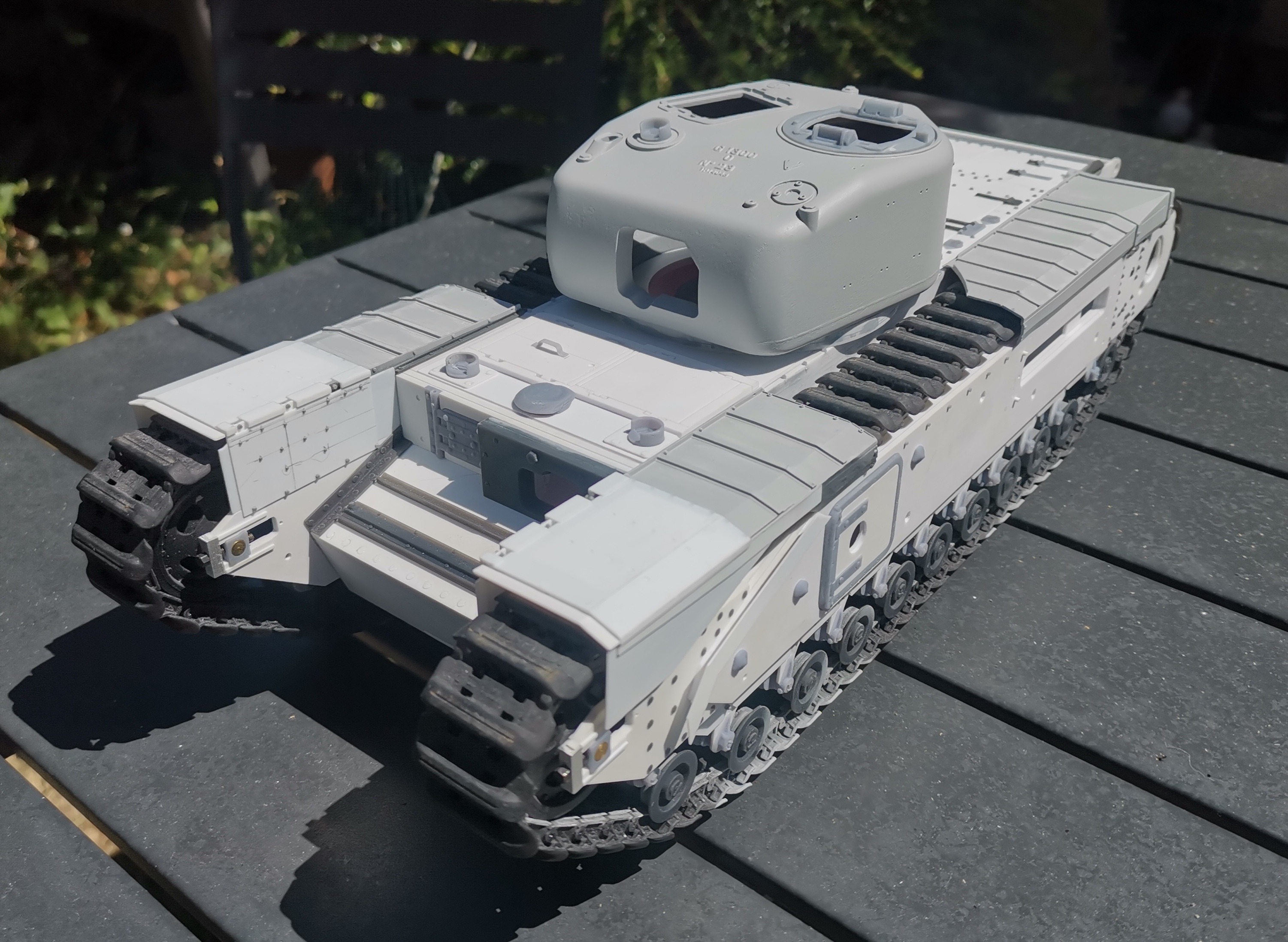

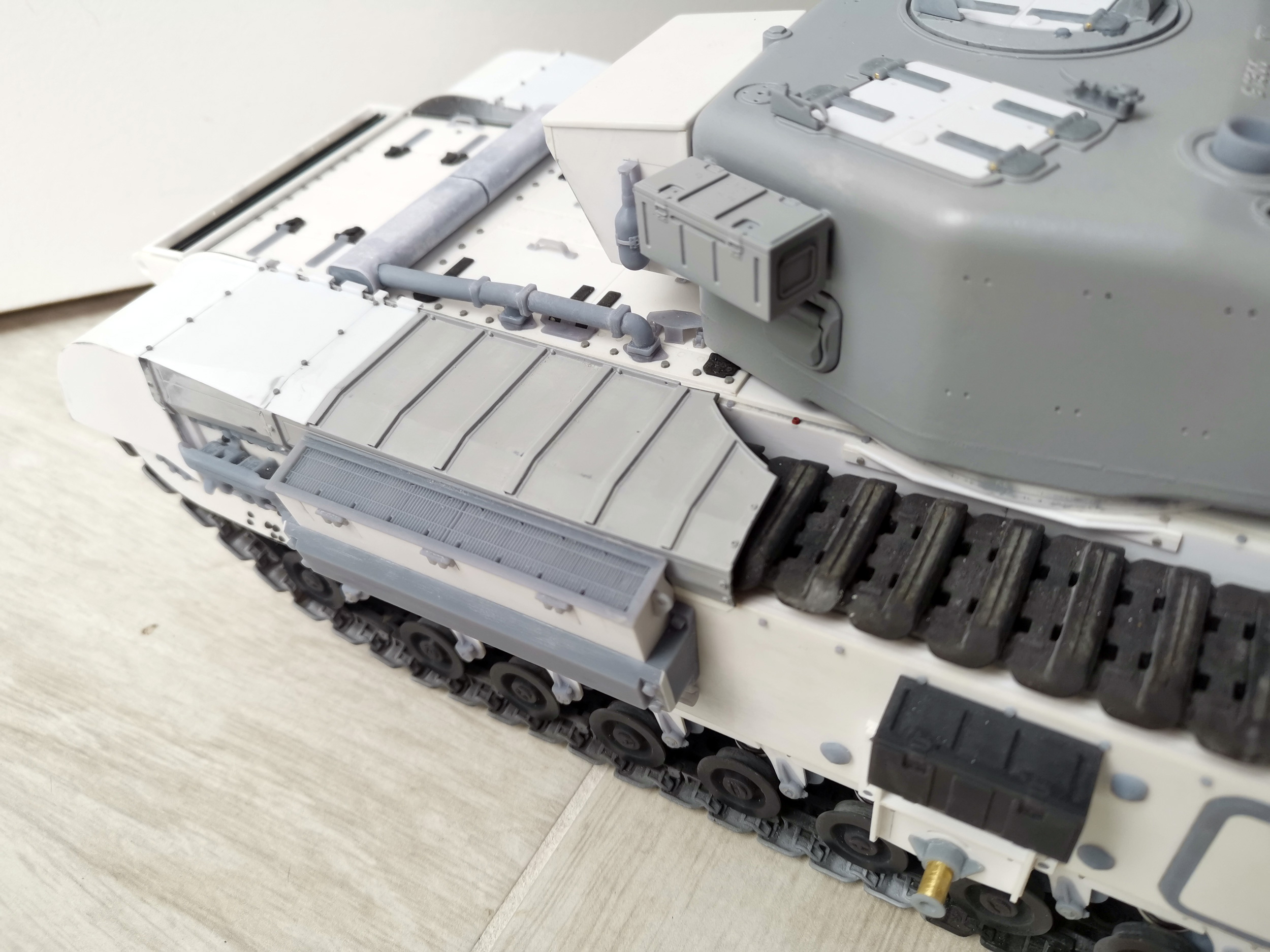

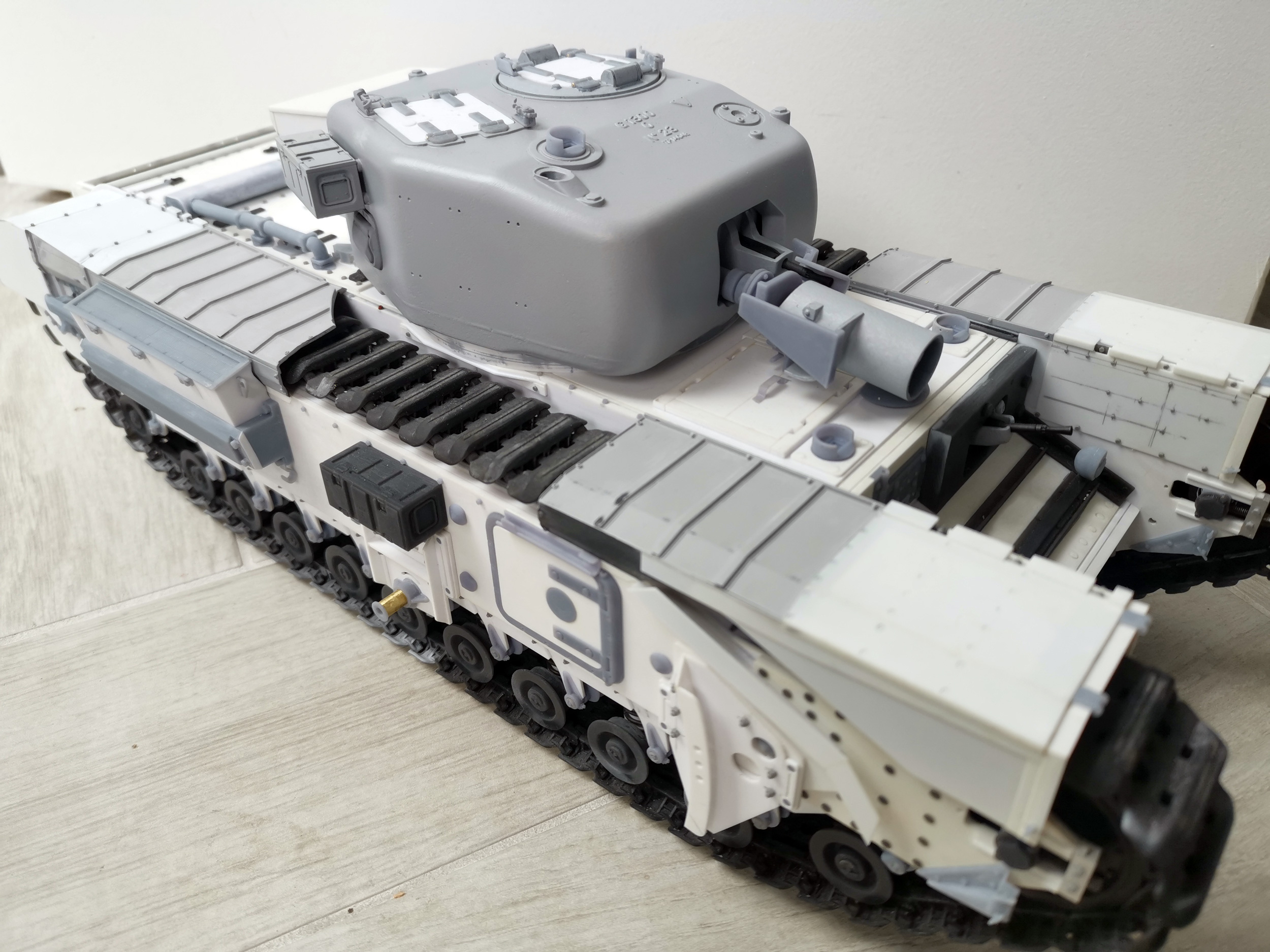

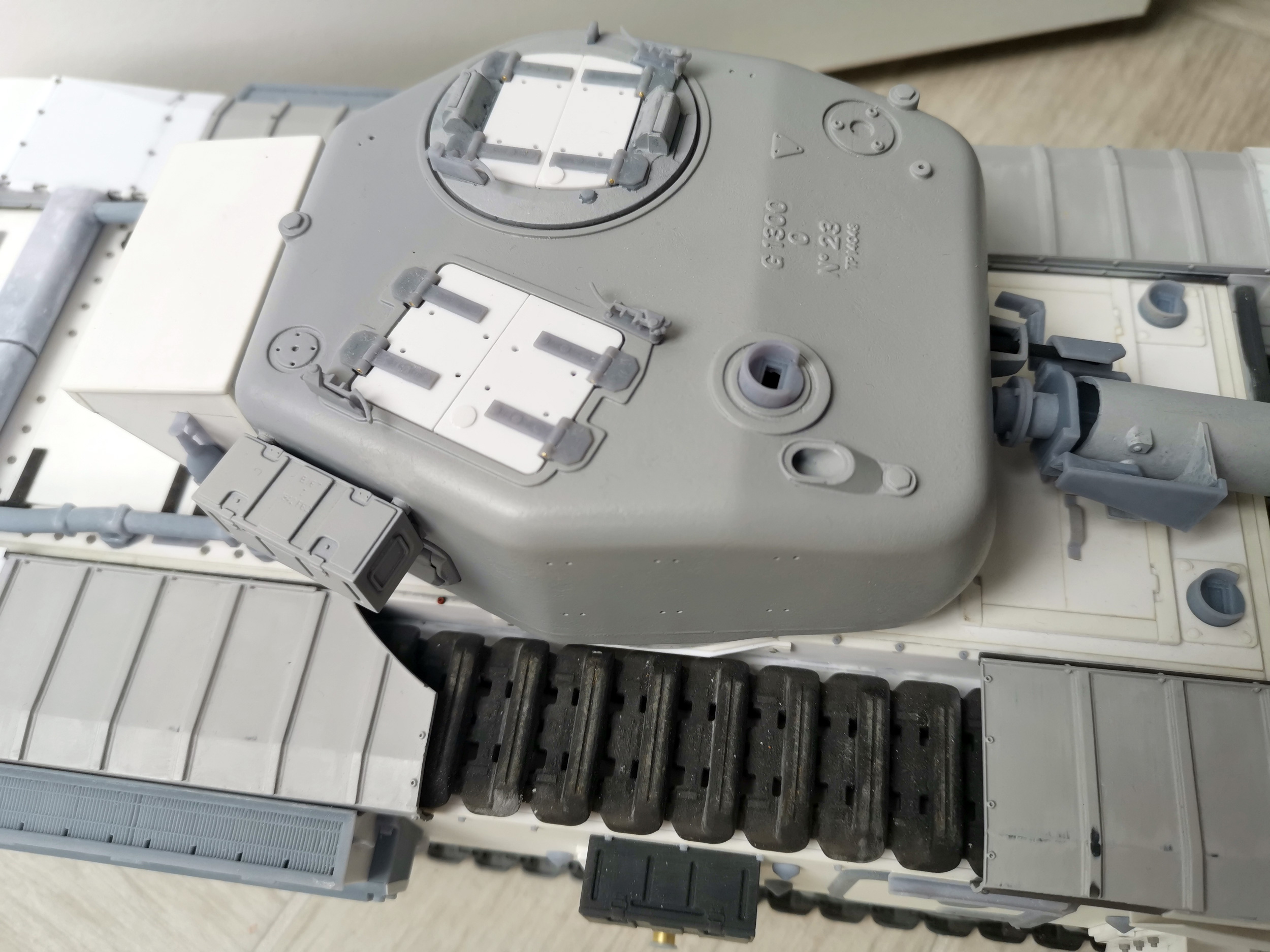

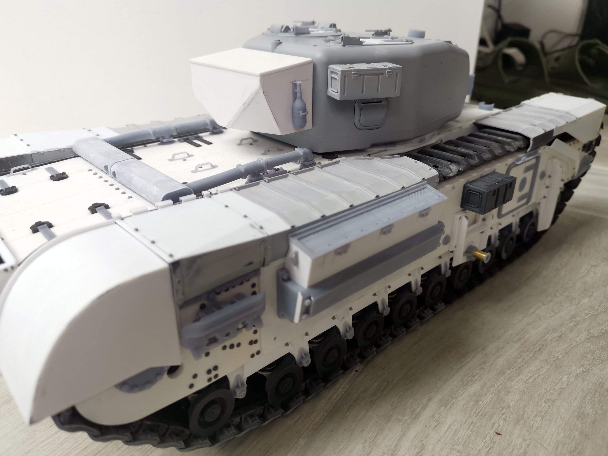

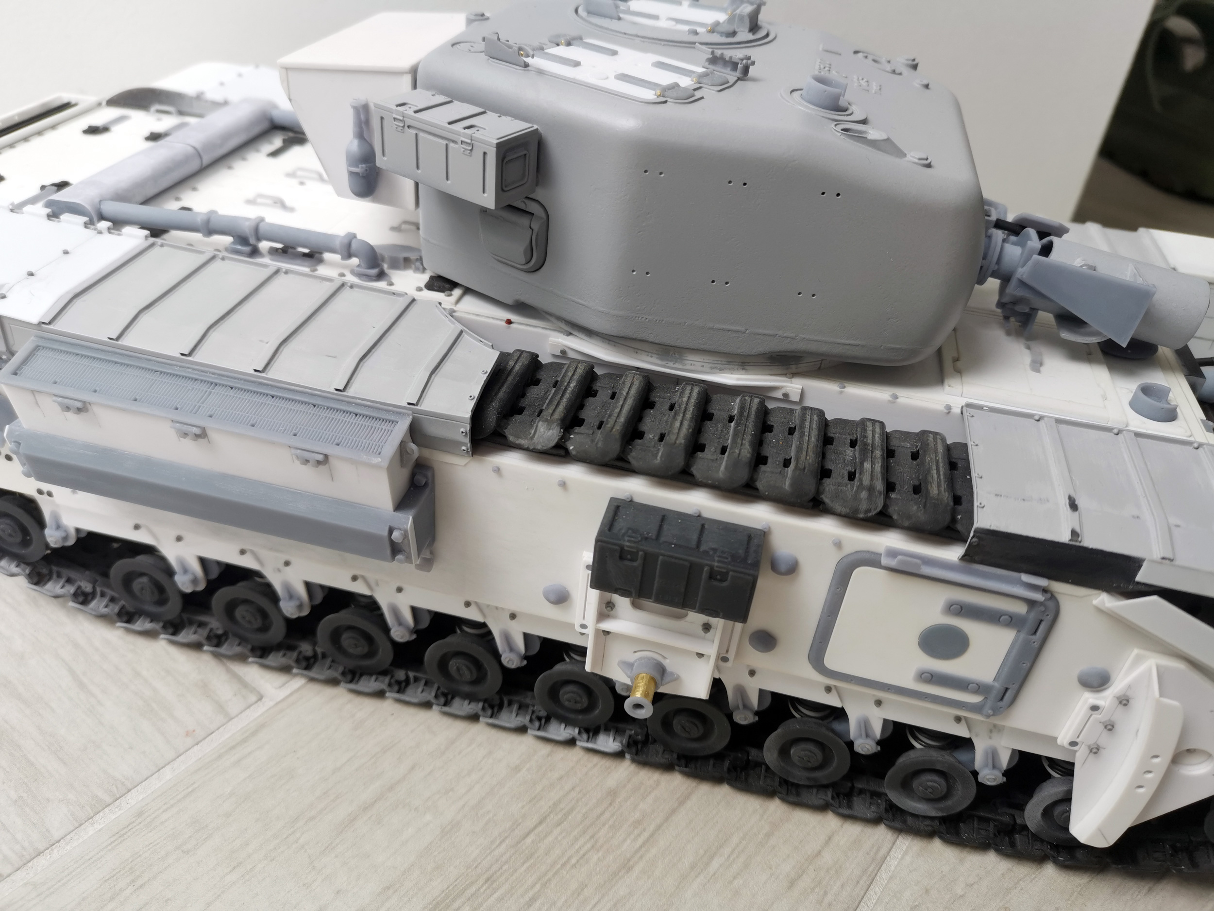

Hey guys, I finally made some (good) progress on it. I'd like to finish it as much as I can to be ready to put a coat of primer to protect it until I can paint it next spring. We should have some good temp and no rain next week, it'll be good for primer time.
I added a lot of details and started to add the specific stuff to these Churchill AVRE like the ammo boxes on the turret and hull (I suspect they were used to store other stuff than ammunition, it's written something like 2" shackle on one of the hull box).
Next I will add the spare track links on the hull sides.

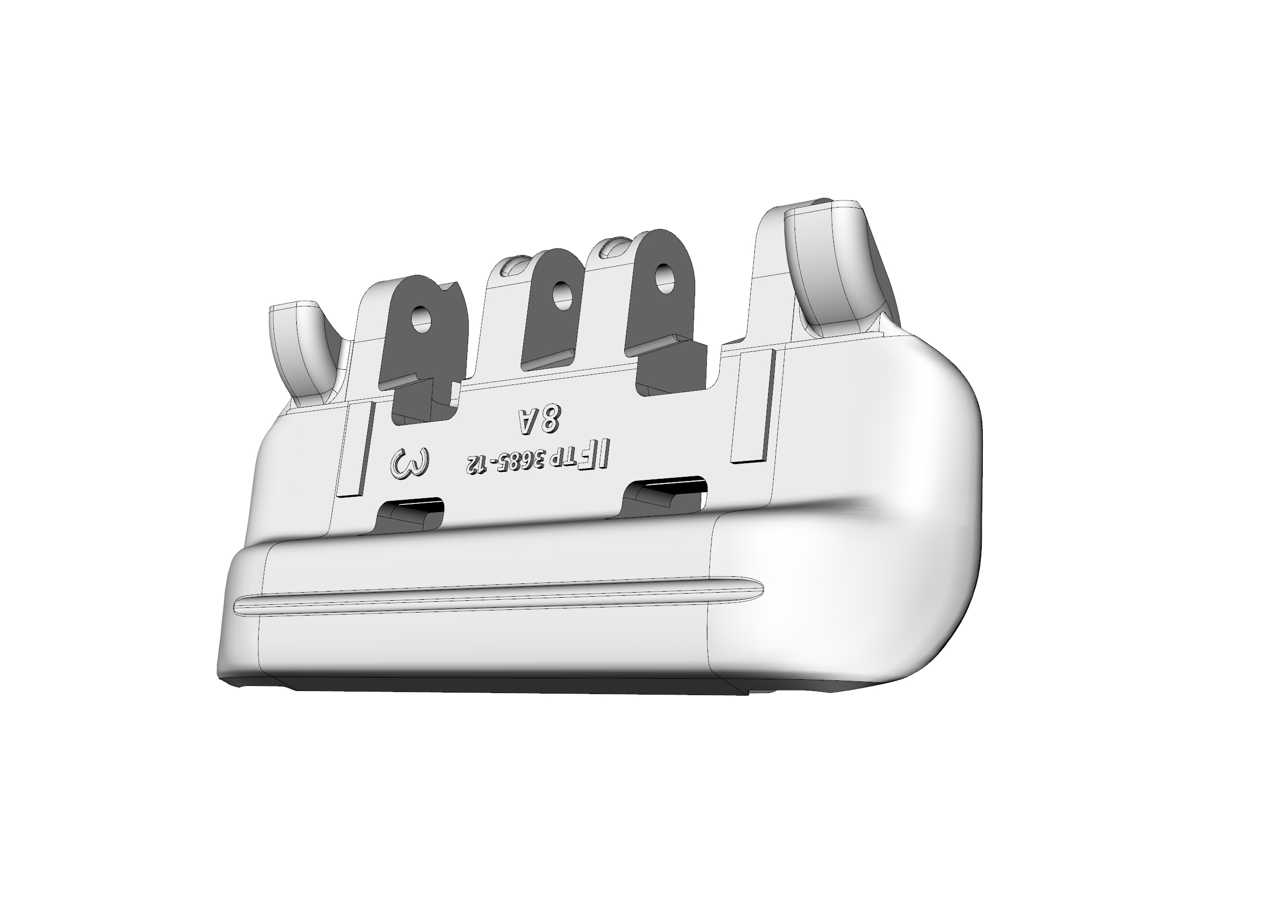

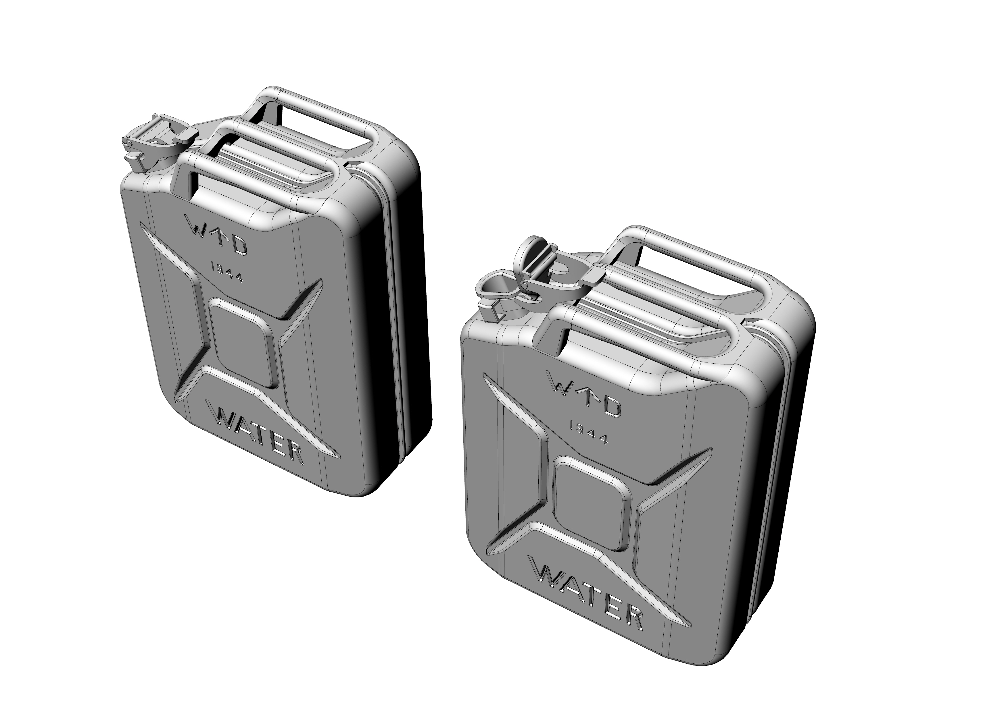

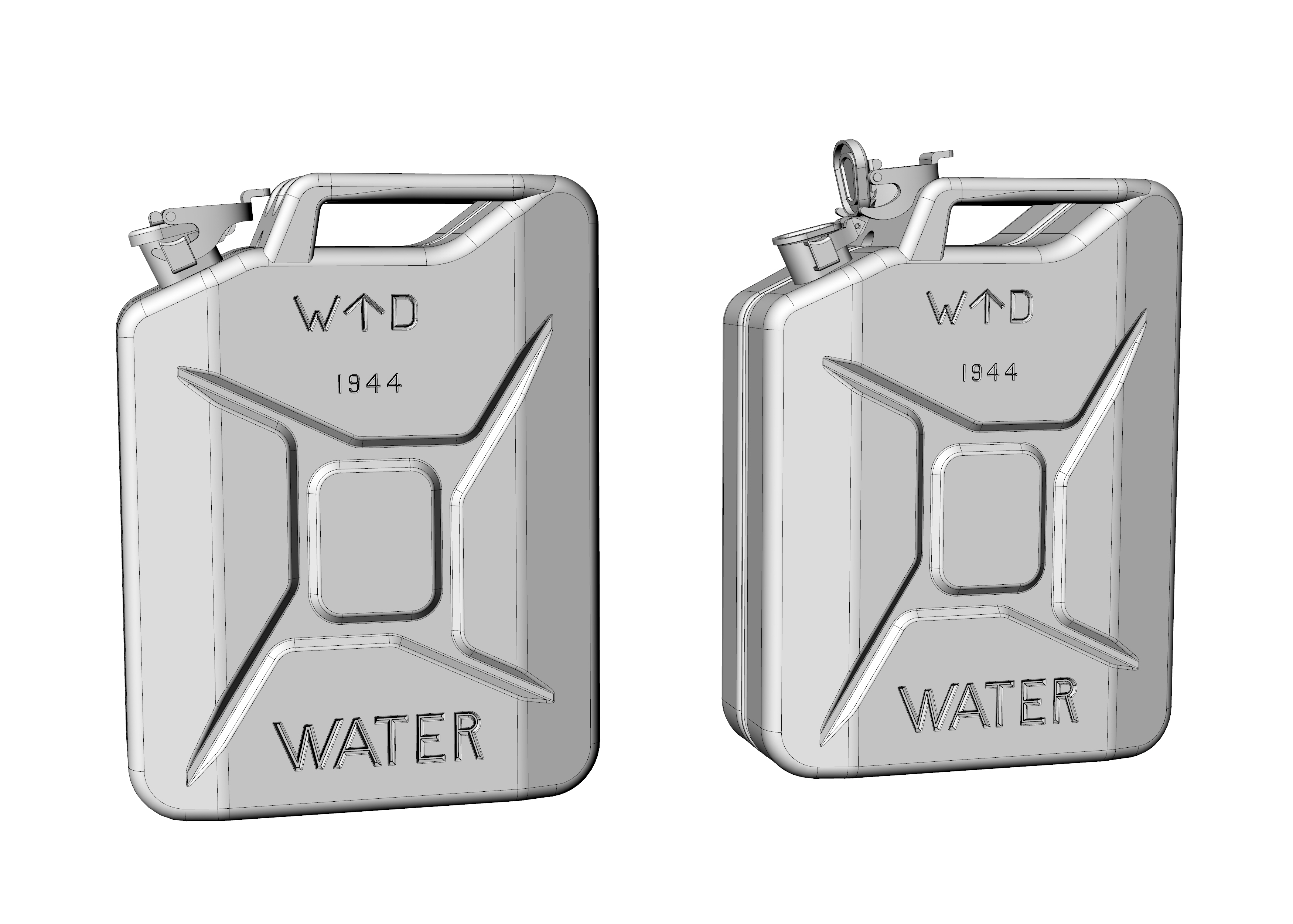

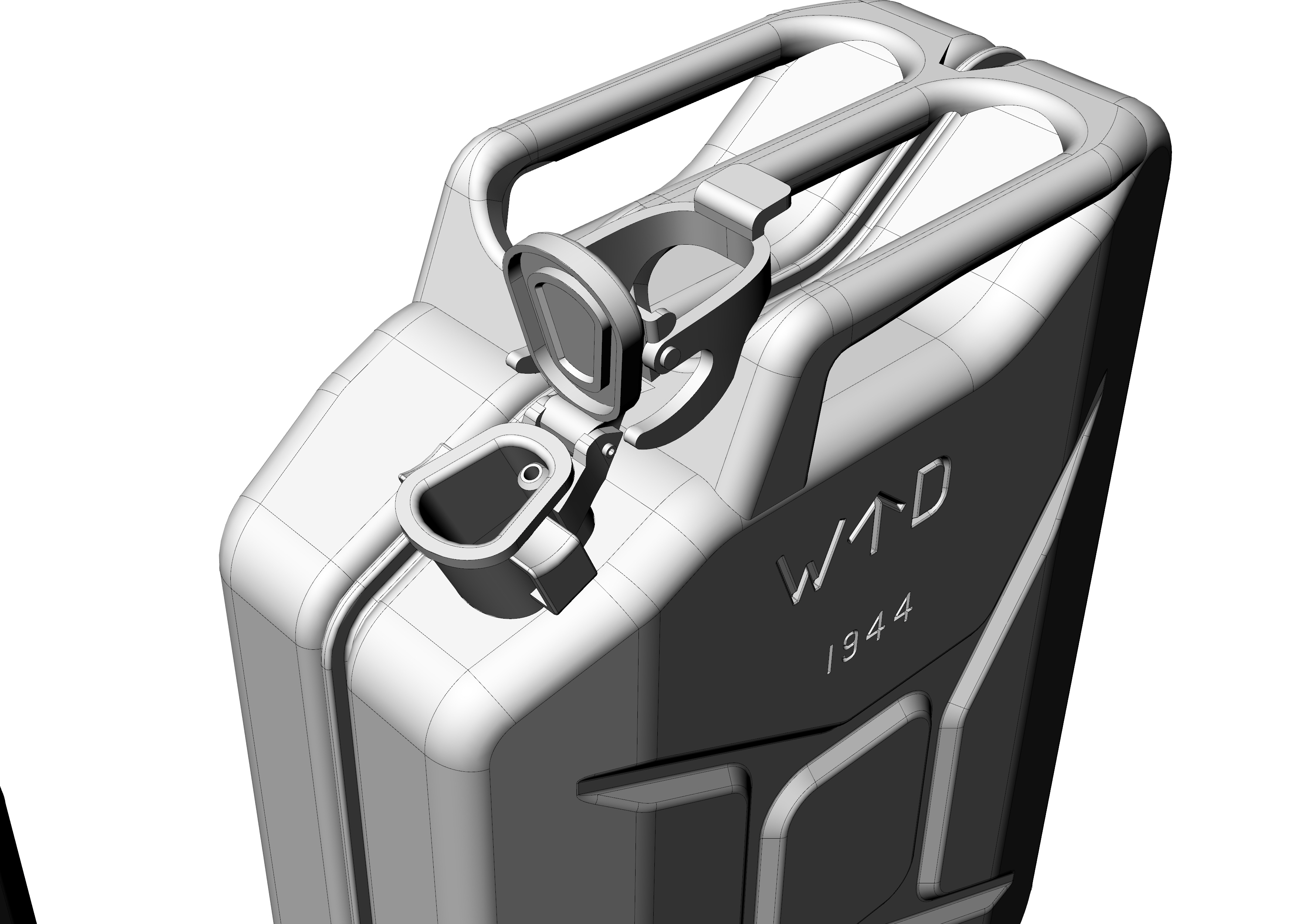

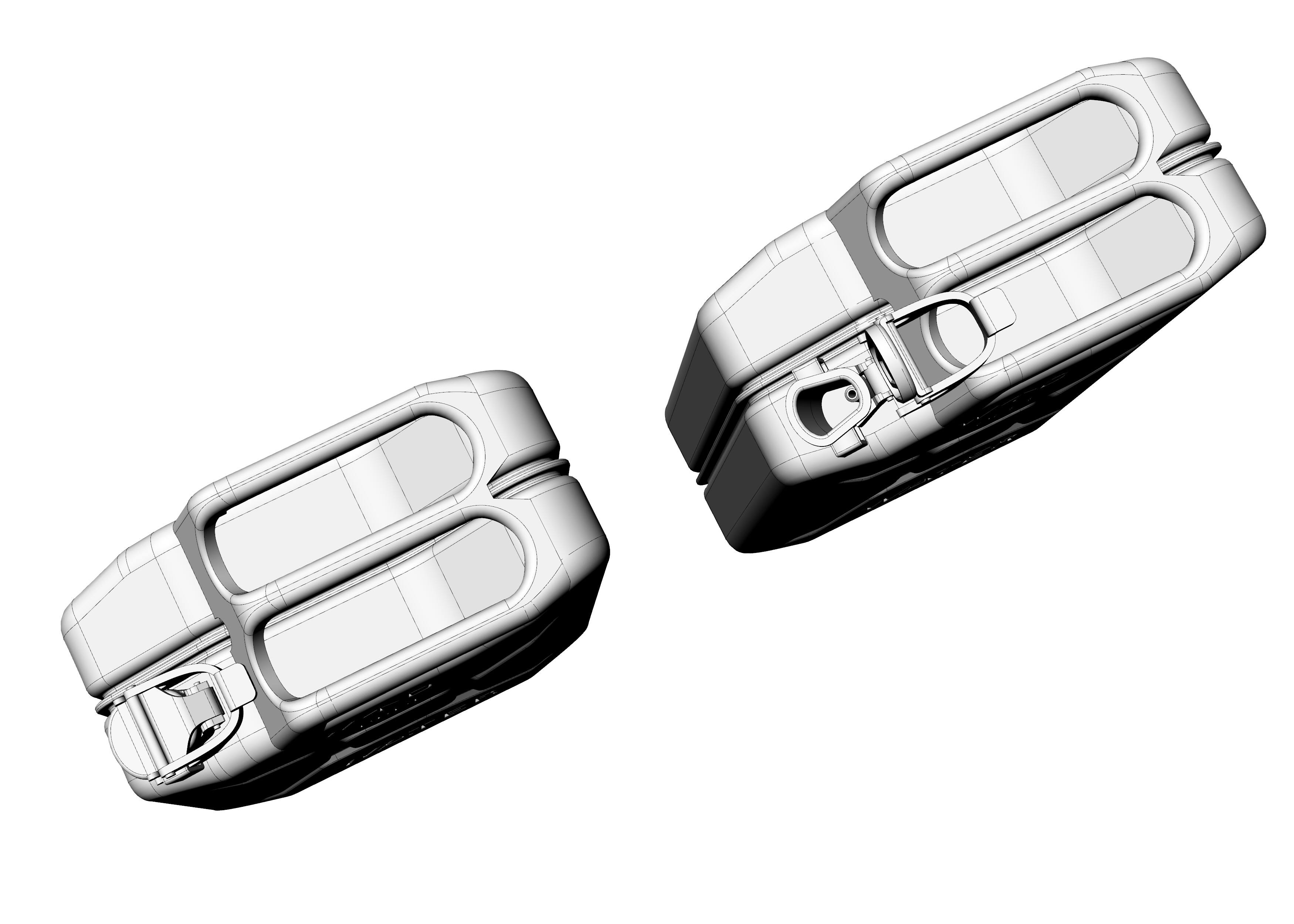

While looking at the stuff populating those Churchills, I saw a water Jerrycan attached to the spare bogie :
Of course that's something that I'l like to add, I have some German styrene Jerrycan from Classy Hobby that I could have used (they are exactly the same than the ones used by the British, I could have just fill the German stamped writtings). However I decided details are not that great and I wanted english writtings so I had to design my own :)
WWII British Jerrycan_1.jpg (1.04 MiB) Viewed 1214 times
WWII British Jerrycan_2.jpg (1.04 MiB) Viewed 1214 times
WWII British Jerrycan_4.jpg (1017.25 KiB) Viewed 1214 times
WWII British Jerrycan_6.jpg (1.16 MiB) Viewed 1214 times
