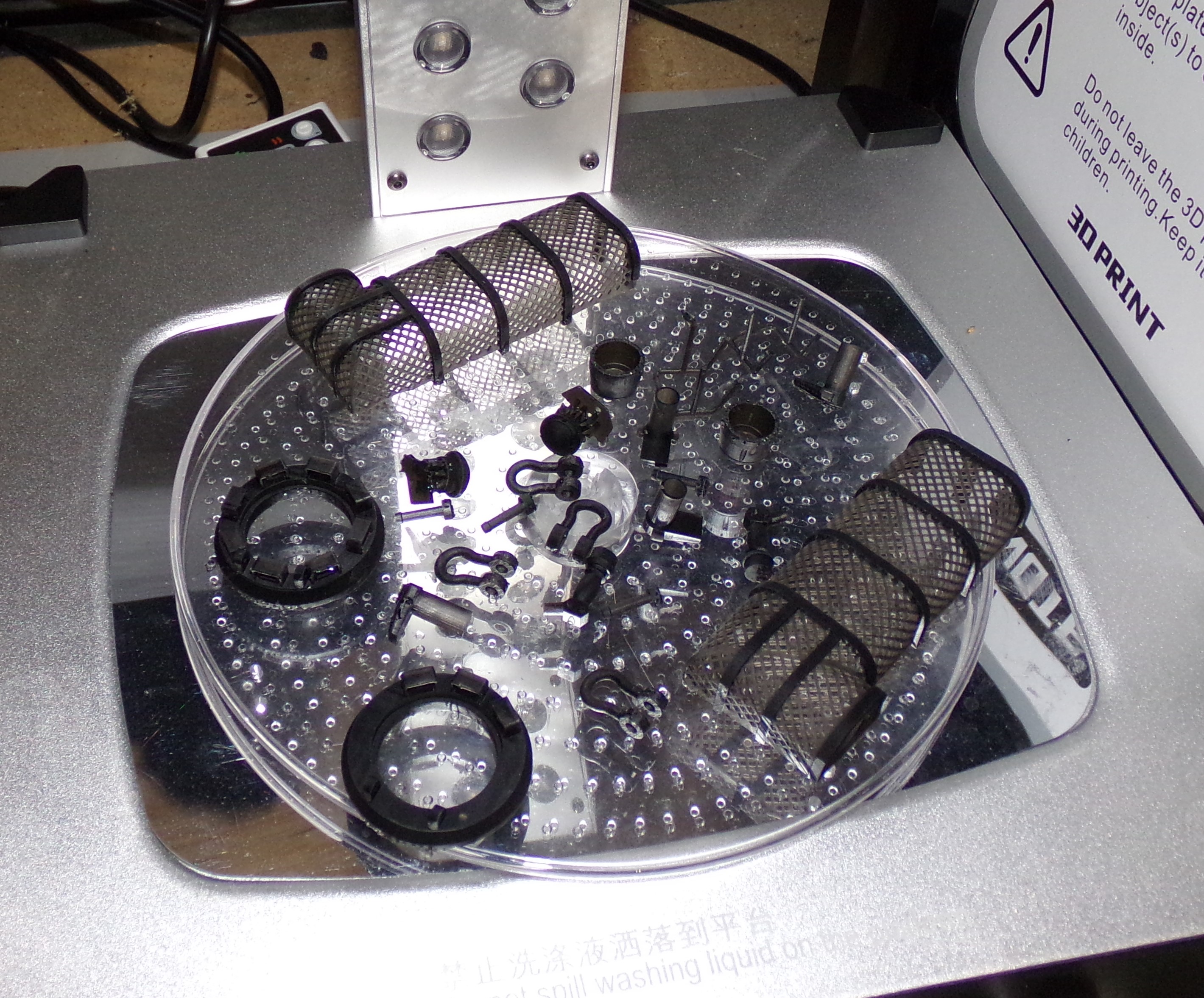

I was surprised when Inkor announced the Kranvagn, but since I like weird tanks I decided to print it. Since I just started printing it a few days ago I thought I'd enter the fray. Being a paper panzer the details are a little scarce on the model so it has been printing super fast. I have about 3 days of printing so far and it already looks like a tank. I've started with texturing the turret as it looks to be a cast piece. Not sure yet how I want to paint it.
Parts fresh from the resin curing station.

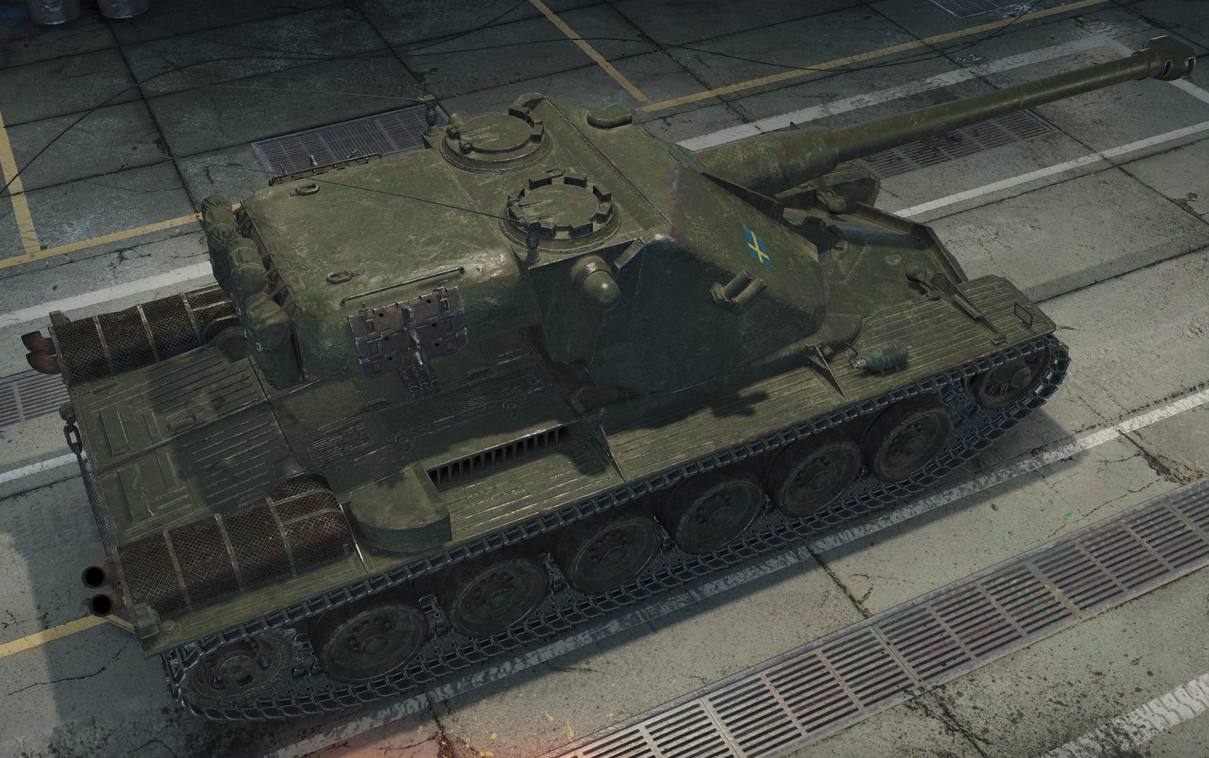

MrChef wrote: Sun Jul 14, 2024 3:35 am I think it's super, super, super cool you can just print tanks up like this. Do you have any pictures of the "real" paper panzer? I've not heard of this one before and am intrigued. I can't wait to see how this one turns out as well.
The Kranvagn only existed as blueprints so no real examples were made, but it has been reborn as a World of Tanks playable heavy tank.
There is some info about it here: http://ftr.wot-news.com/2013/12/12/kran ... velopment/
And a pic of the completed tank:
Screenshot 2024-07-14 054800.jpg (525.98 KiB) Viewed 4643 times

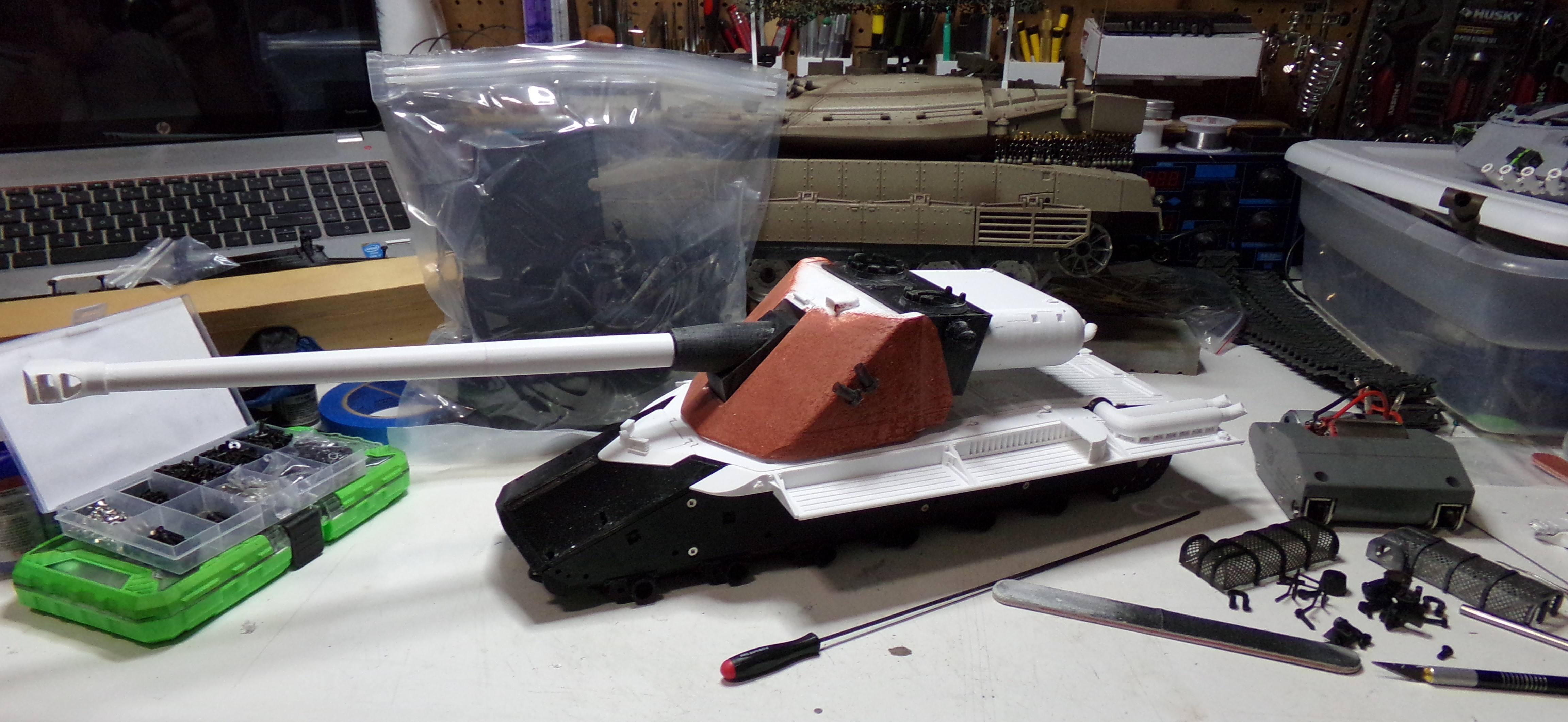

tankme
Posts: 3249
Location: Elgin, TX
Re: [Paper Panzers] Swedish Kranvagn
Post by tankme »
Making progress...
Elevation arm and servo installed.
Recoil servo and hatches mounted.
Gearbox dry fit. I had to remove the rear brace as it didn't fit with the gearbox. The gearbox is an exact fit, no room on either side so I'd say the rear brace isn't needed.
Road wheels, suspension, exhaust covers, and front fenders installed. Road wheels were modified to accept bearings.
At this point the tracks and a few detail items are all that are left to be printed. Initial prints in PETG for the tracks didn't look good. I'll probably be printing them in resin. I haven't permanently attached the turret halves yet as the servos need to be adjusted and a apple mount needs to be mounted in the loader's hatch. Can't really adjust the servos once the two parts are mated together and it's a bit of a pain to put them together and take them apart repeatedly.
That's all for now...

Just a brief bit of progress...
Got the cast texture added to the turret, got all of the internals wired up/tested, added all the small details, and shot a coat of primer on it. Still needs to touch up work, but the project is progressing.
