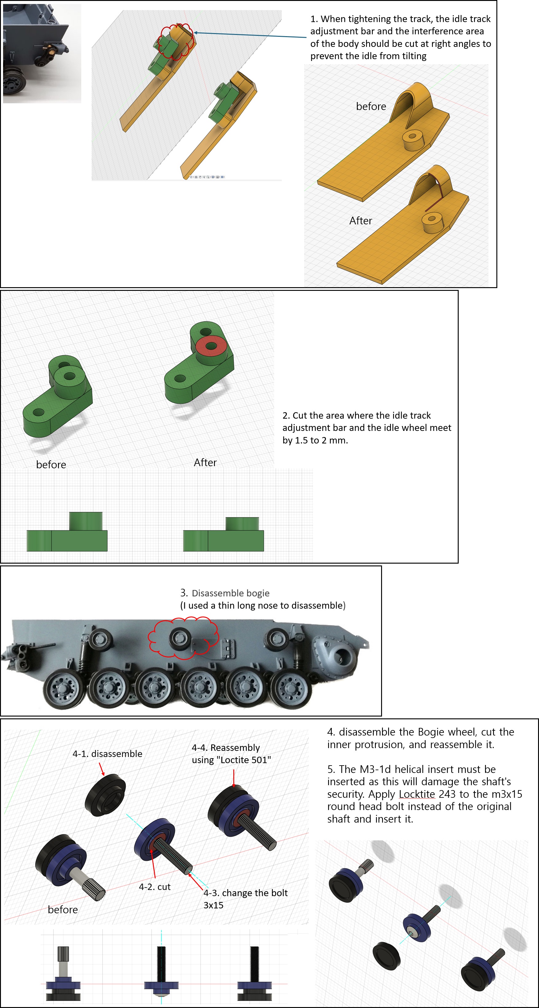

so I researched it. As a result, it's a problem that occurs because the idle wheels are not aligned properly with the bogie wheels, and since some twisting occurs in the body material, a perfect solution is difficult, but it can be improved a lot.
Warning
I wouldn't recommend this unless you're good at DIY and MODING. There's a risk of the chassis getting damaged.
6. The idle wheel should be completely disassembled, the inner product number should be trimmed and flattened, and then reassembled
p.s I bought and installed the product in the this from toucan, but it didn't work. It's very difficult to install it because it's not a proper product. (It can't be installed in the torsion spring.) If there's someone who's worried about the same problem as me, I hope this thread will solve it.

Your excellent drawings should help anyone who wants to make this correction to the HengLong PzKfw. 3. People should be able to find the instructions by searching under HengLong Panzer3.
