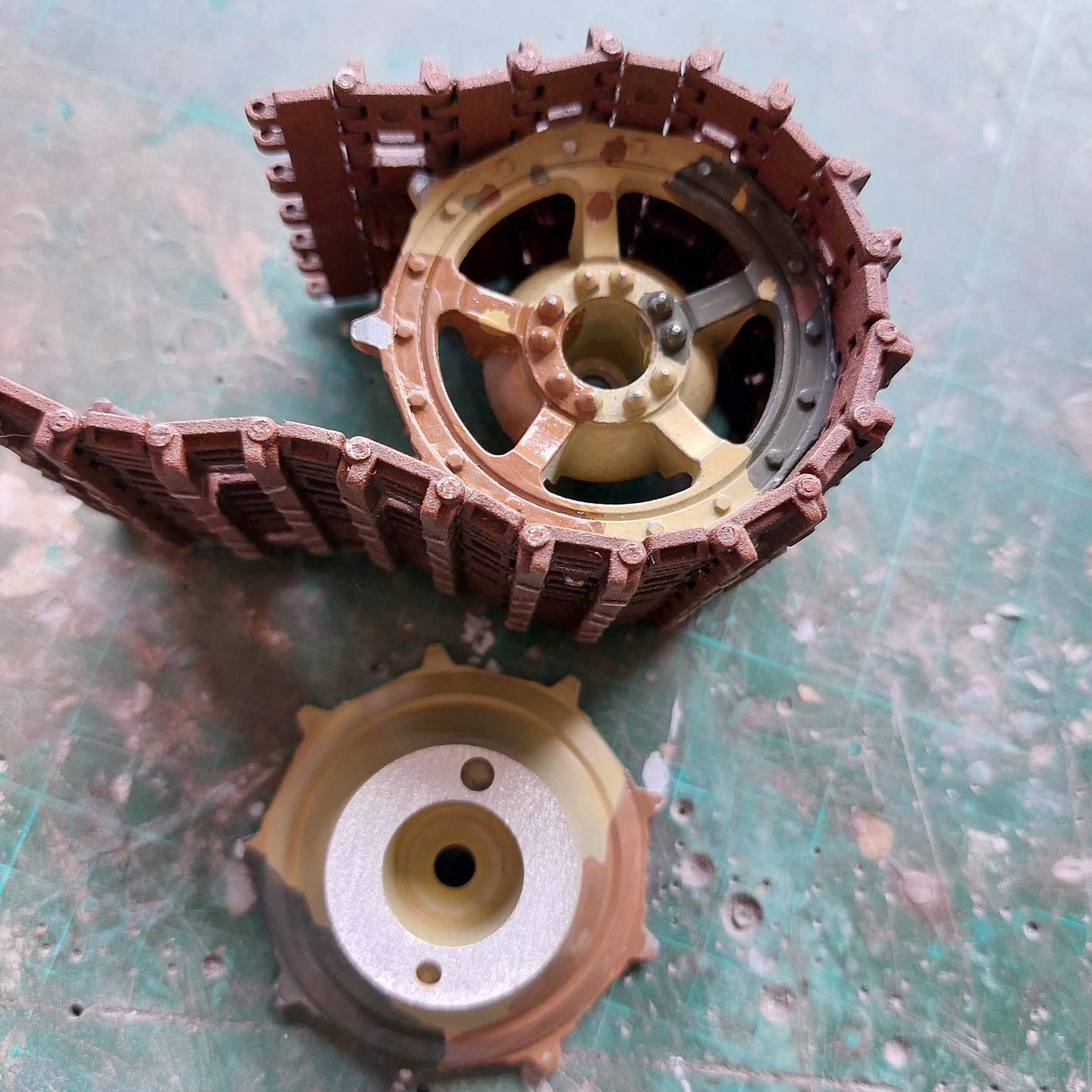

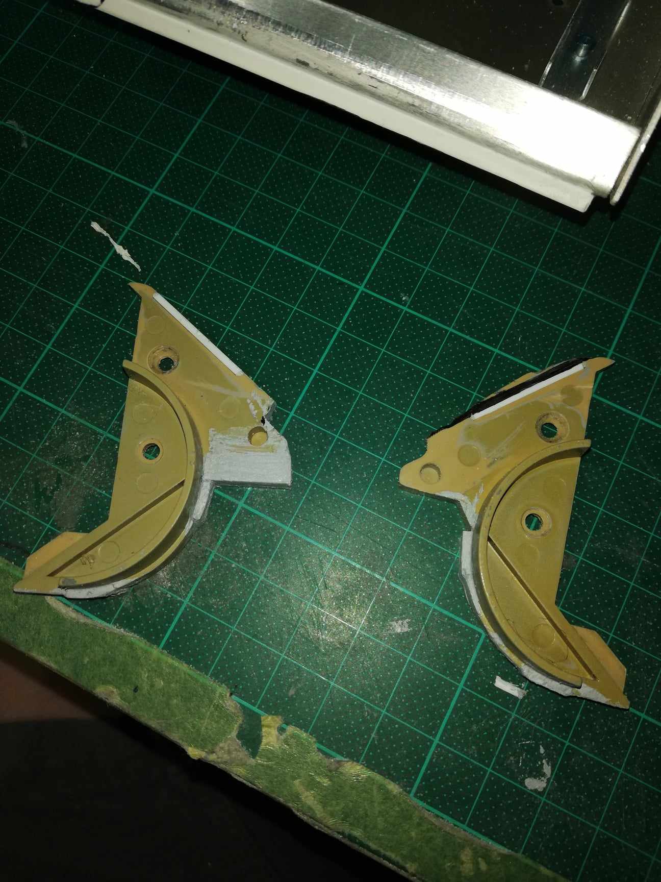

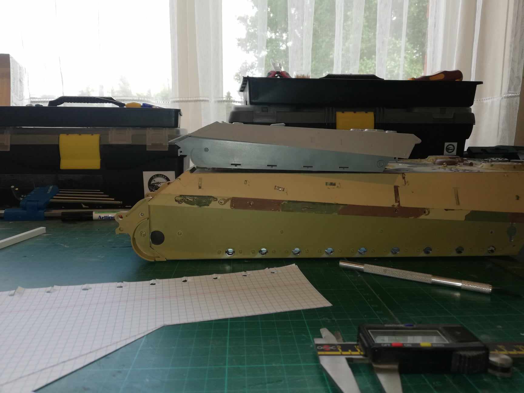

It started with a 2nd hand Tamiya King Tiger, which I wanted to convert to an E-75 with 105mm canon
First I modified the metal sprockets from Tamiya so that I could use the metal tracks from Taigen.

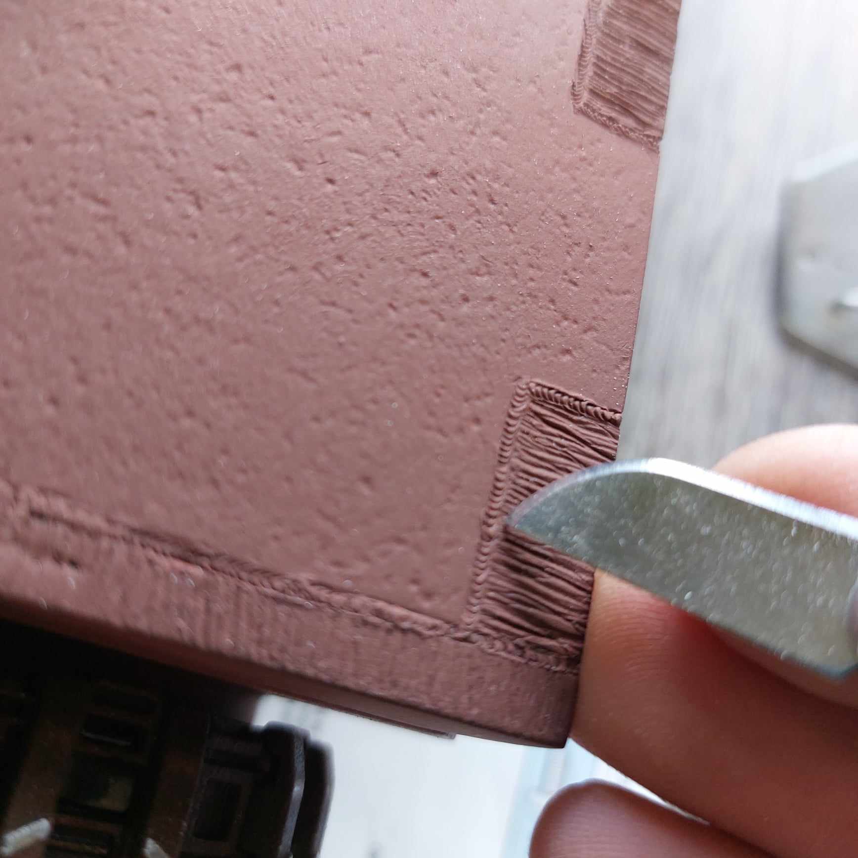

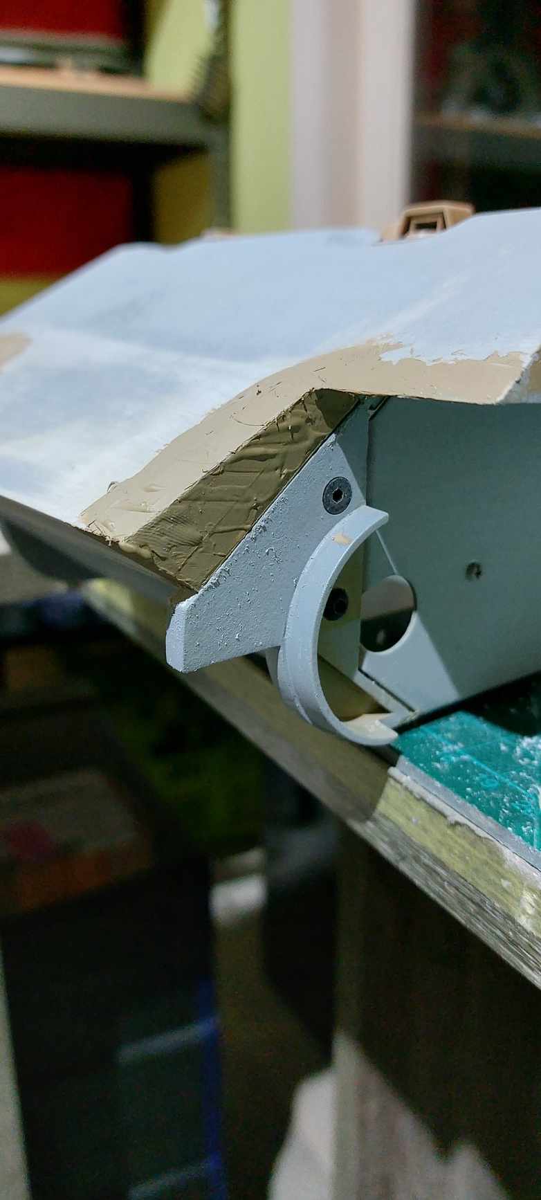

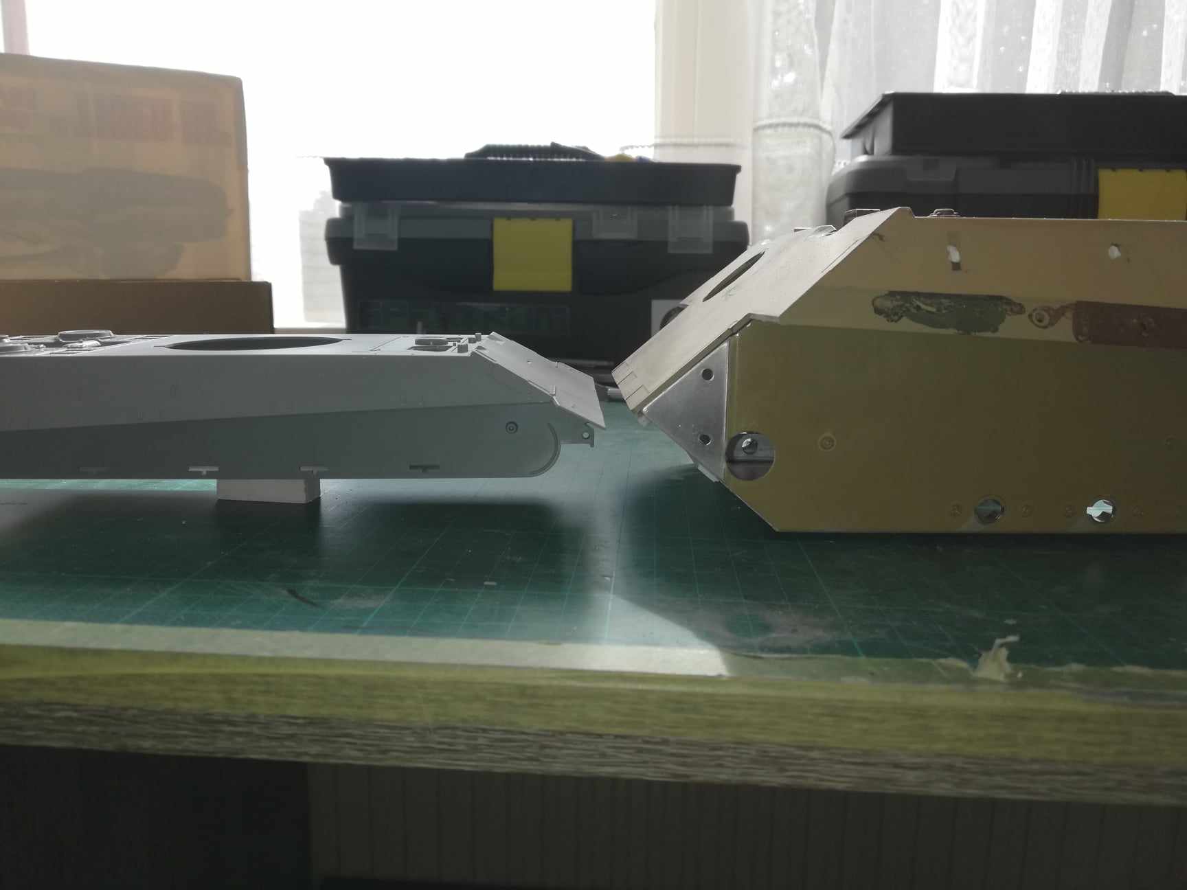

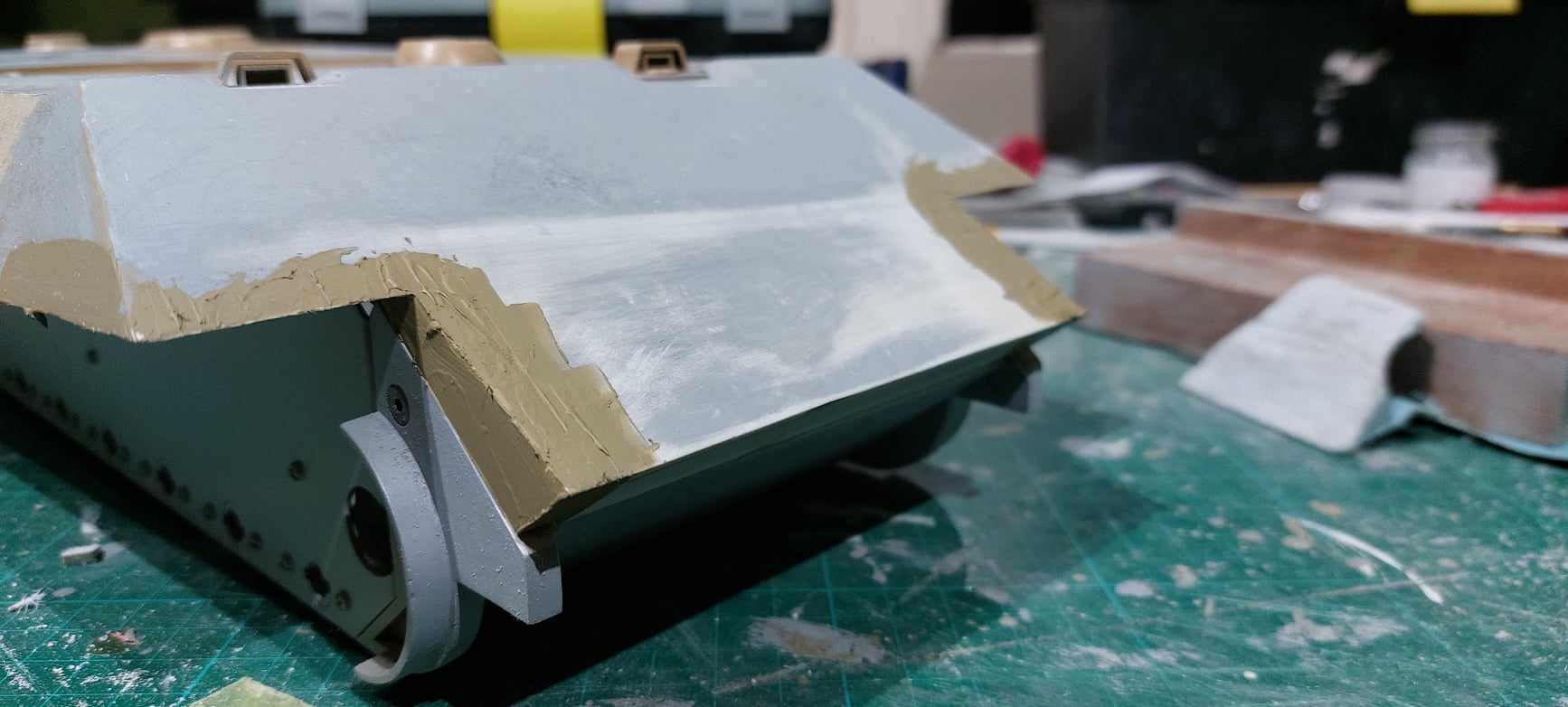

The front armor of the E-75 has a different angle, so using a 1/35 scale model I converted it to 1/16 scale and adjusted it with plastic card.

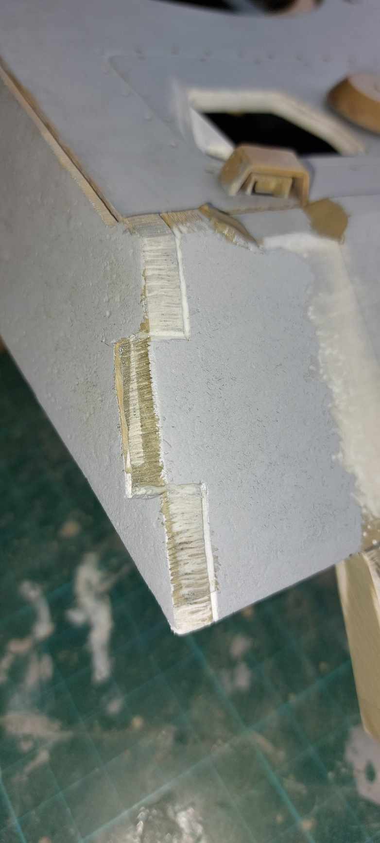

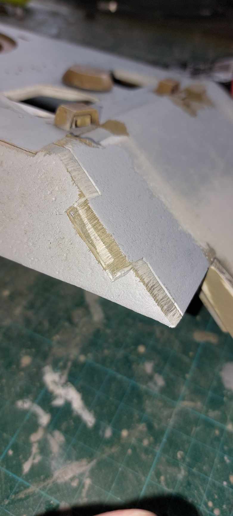

Once I was satisfied with the result after a lots of putty and sanding i made the flame cut marks en start with the welds.

Hi Ecam,
The taigen metal tracks fit around the tamiya sprockets, but the sprockets are a little to wide for te tracks.
so I made one side of the sprocket a little thinner on a lathe.
as you can see i adjusted the bottom part of the sprockets on the lathe
now it is a perfect fit.
as for the flamcutmarks, I made this by scratching with the sharp point of a semi-circular knife.
I also did that where the welds should be, but much deeper

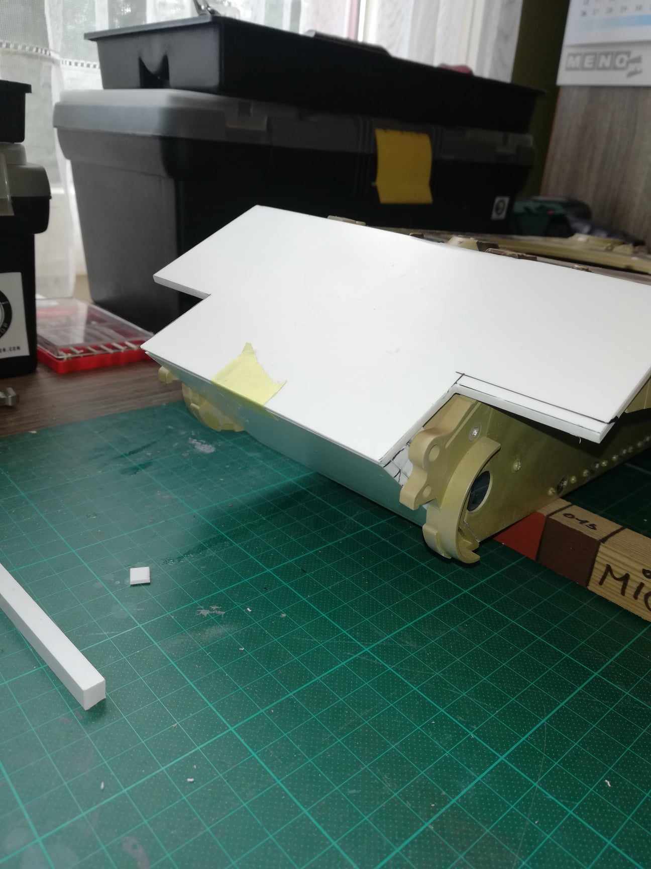

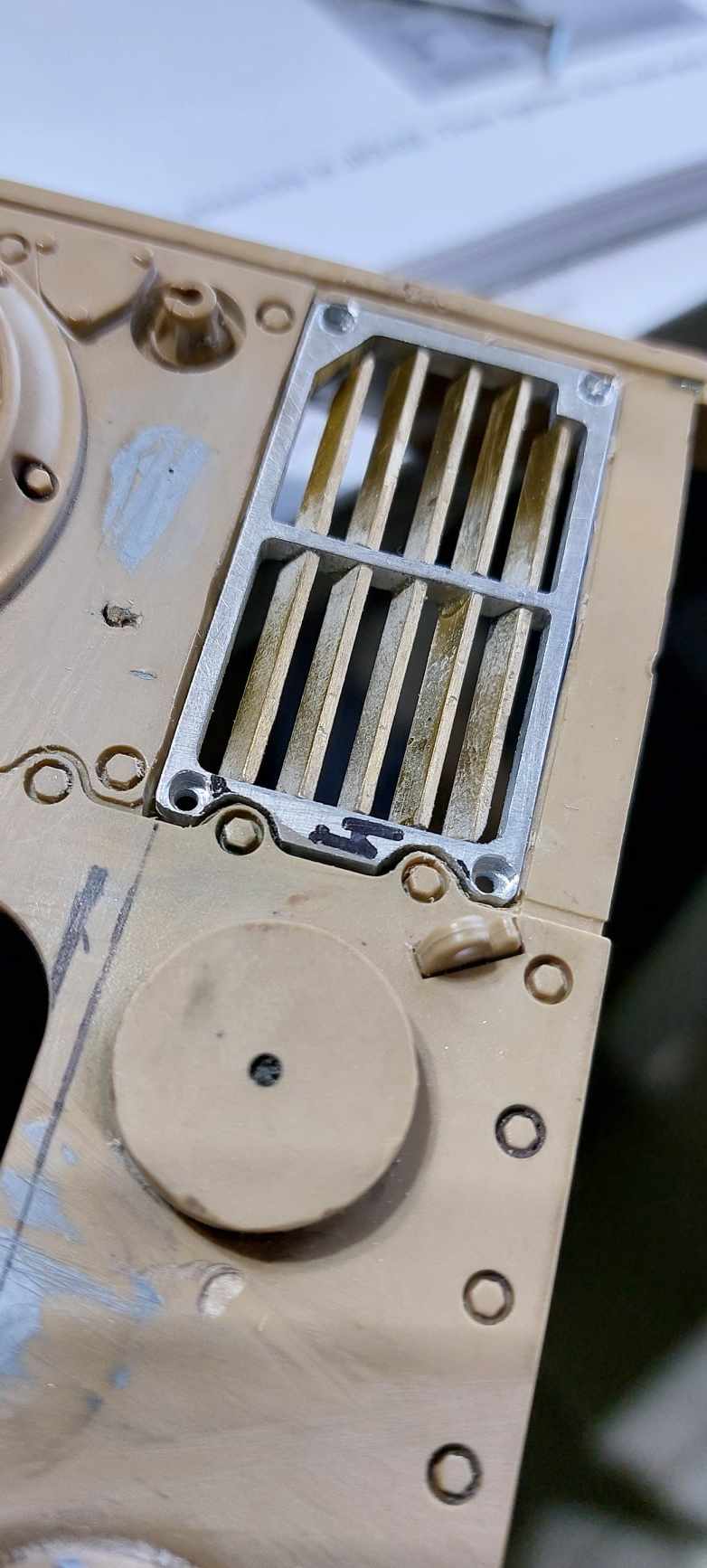

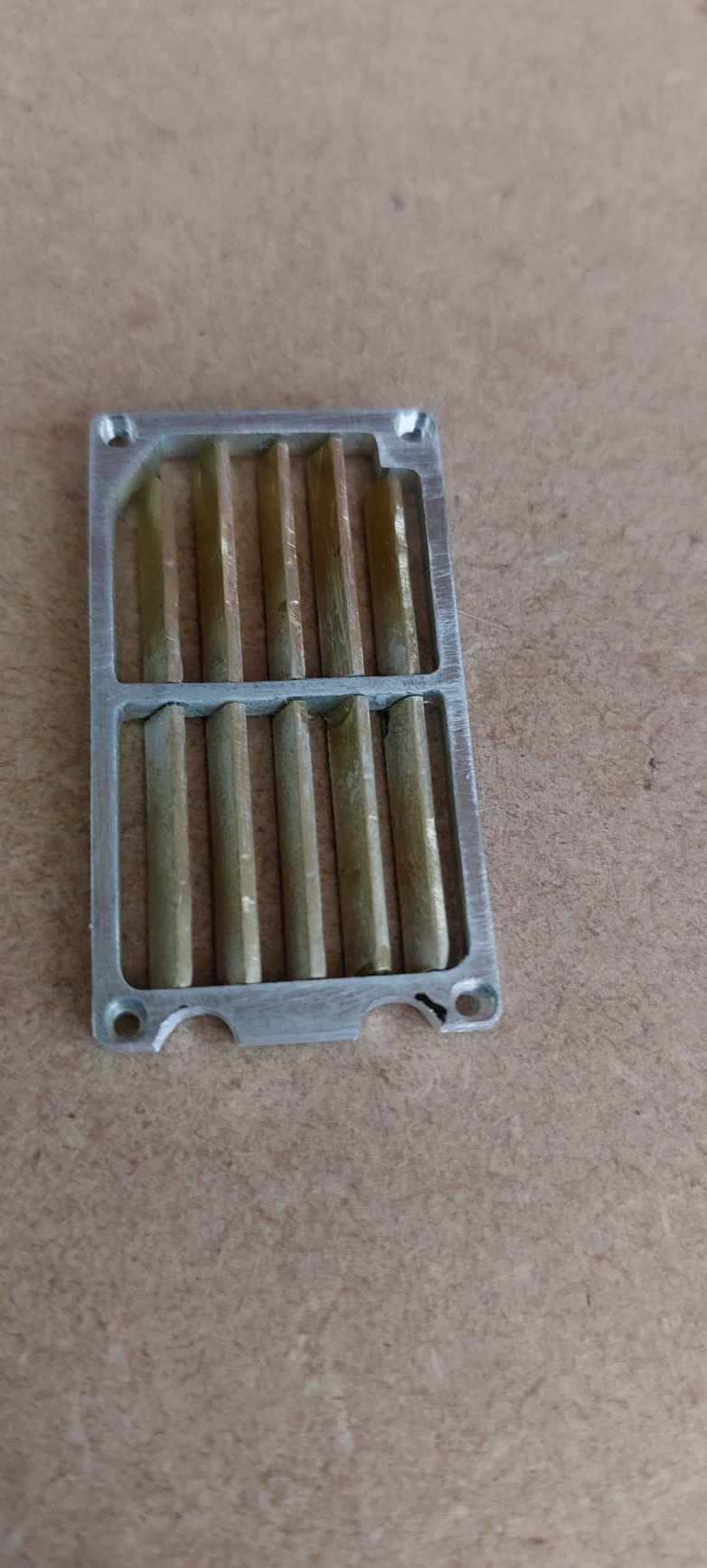

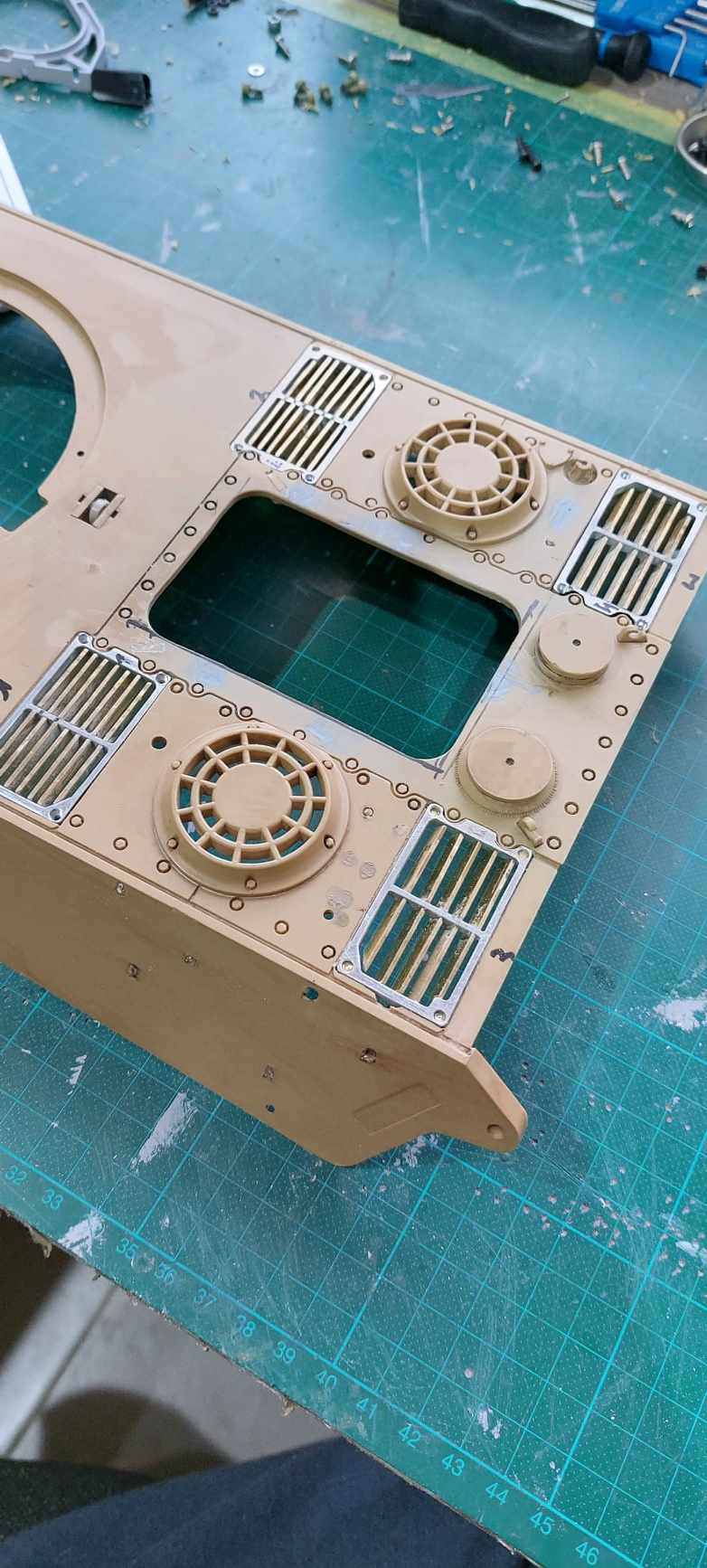

Here I modified the engine deck.
First I made the opening for the engine cover larger so that I can make a 3-part cover on it.

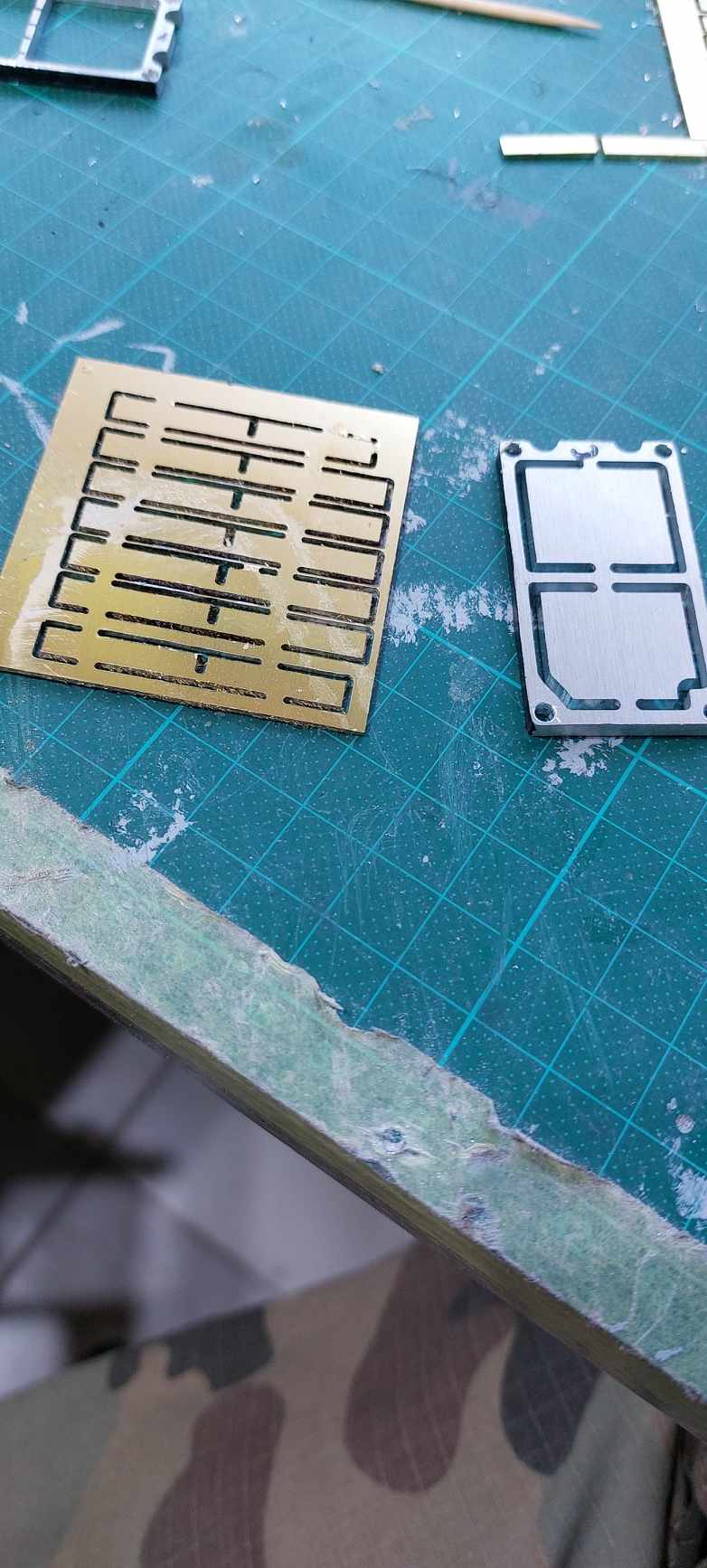

Then I adjusted the ventilation grilles.
At Ludwigs-Hobby-Shop I found grilles that I find more suitable for the E-75. These come in kit form and still need to be assembled.
The grills can be made to your own wishes, I chose 2 different types
The original grilles are then cut out and the new ones placed in.
The grills were very time consuming but I am satisfied with the result, on to the next update
