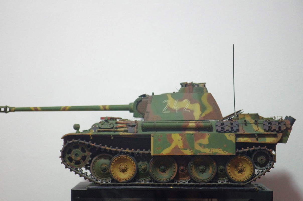

Hi All,
I once created a thread here when I was detailing my HL Panther. Unfortunately all my photos were lost when my image hosting provider went to a paid service and I failed to retrieve them.
Here are profile pics of the tank currently. My final modifications were to the suspension to get the correct track droop. Enjoy.
I was going for this look of a Panther fresh out of the factory production line with new torsion bars.

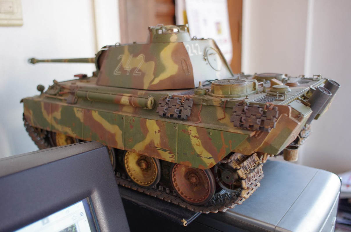

Sure. Here are some views of the tank.

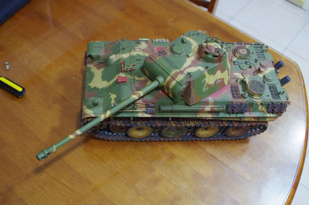

Here is a top view of the tank. You might be wondering why (with the turret rotated like this) the part underneath the turret is still in its red oxide primer color instead of the camo colors. I figured the factory crew would not have had the time (nor the inclination) to rotate the turret a full 360 degrees just to make sure all areas underneath the turret got painted with camo. The red cross painted on the engine deck ventilator indicates this Panther as having the new cooling ventilator design issued to Panthers at the factory starting Nov 1944.

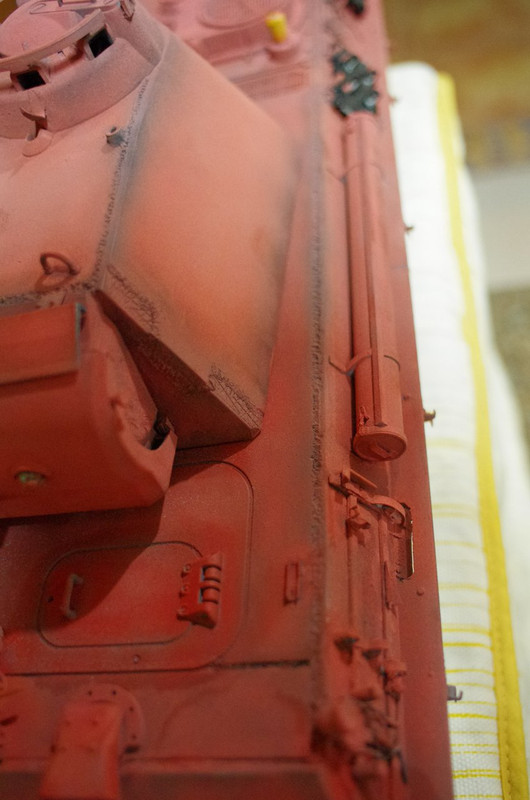

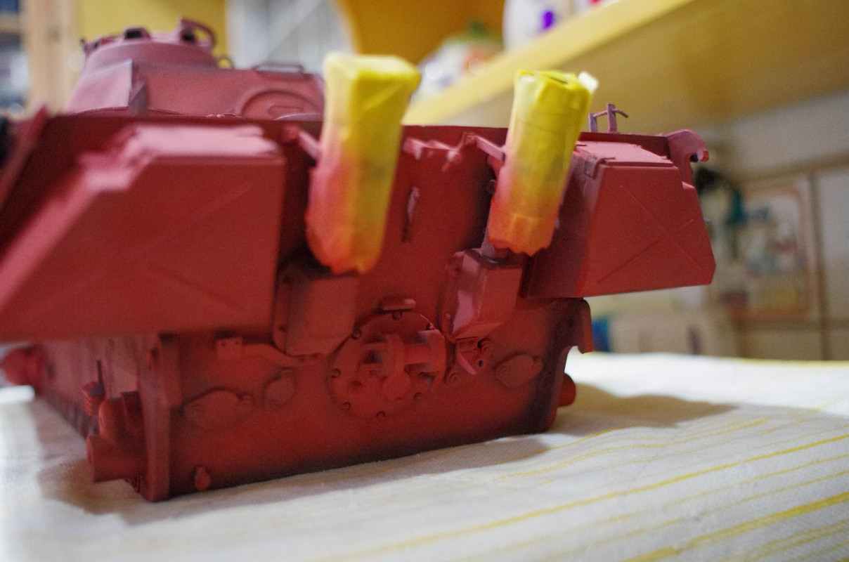

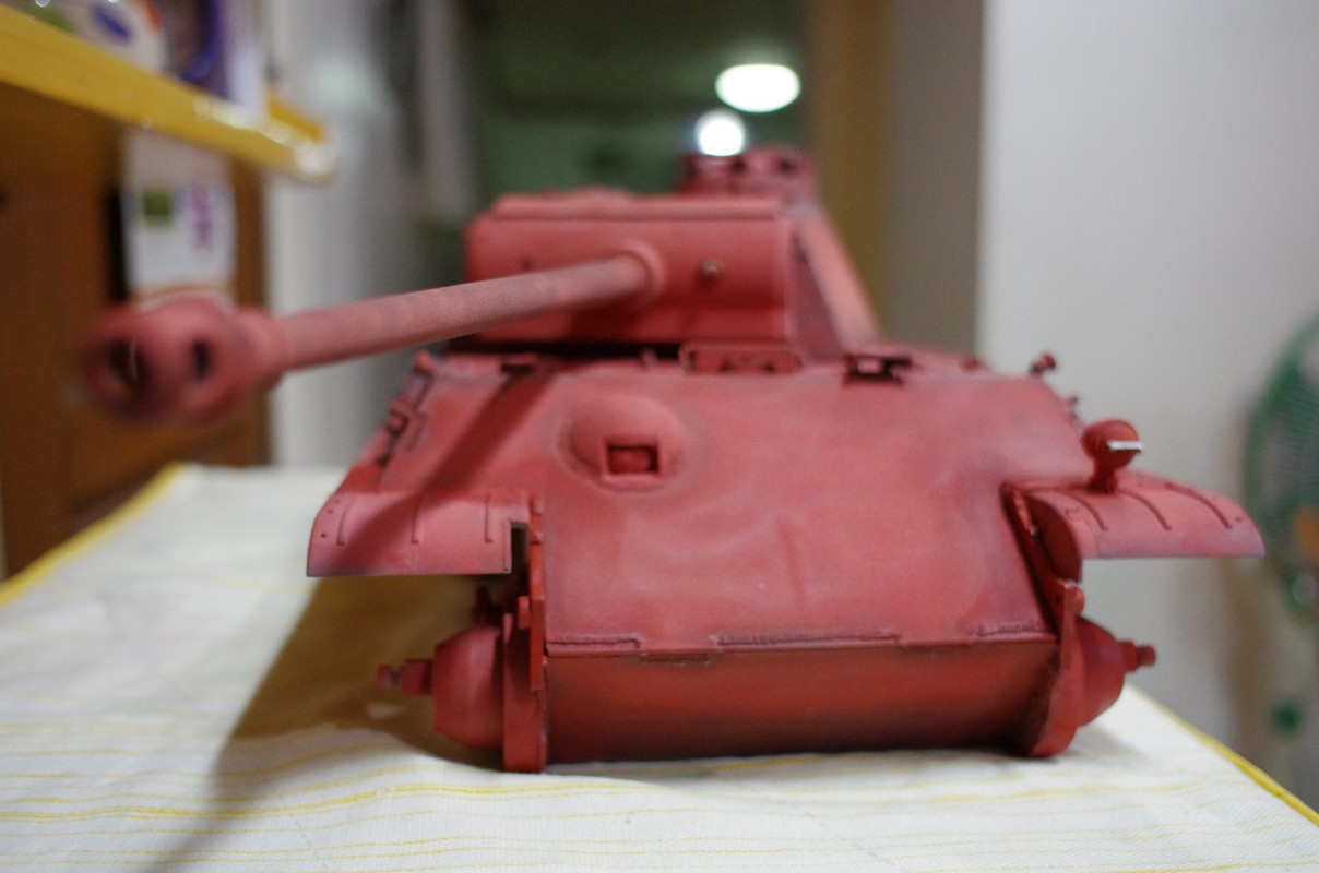

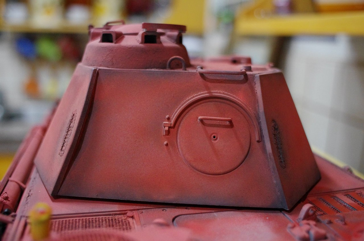

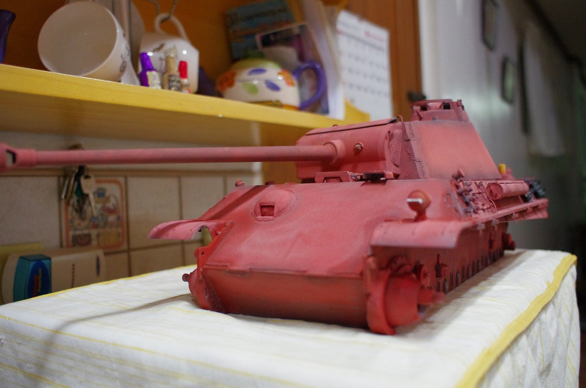

Speaking of red oxide primer I even simulated the process of painting the red oxide primer at the factory before the application of the camo colors. Like I said earlier in my post I was not able to save most of the photos during the period I was detailing the tank but here are some that survived.
Even at this early stage I was already spraying black on areas where shadows would fall or to highlight areas like corners where 2 plates meet or along seams. I plan on spraying the camo colors as thin as possible (I hoped) that these shadow effects would still be visible and make the tank "pop" or have that 3D effect.

Details of the gun cleaner stowage container and empty tool racks. You can also see my attempt at weld lines.
And finally details of the rear

Really impressive paint work. Like the primer under the turret. Had no idea of the hull change in the different marks, good info for the rest of us.
Eric
Posts: 5464
Re: Heng Long Panther
Ecam is right: atop all your other sharp-eyed details, that primer showing under the turret makes for a convincingly logical possibility, especially for a late war German tank. :thumbup:
