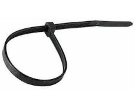

Hello, I think you are talking about the part coming out of the tank? then a small metal wire, which goes around and twisted the two ends together, or a small Rilsan collar, easy to replace when dismantling?
There are small sizes

I have currently secured the smoke unit to the upper hull, using a loop of wire.
I don't know how long it will hold up. I will probably order the hooks that were reported to me!
