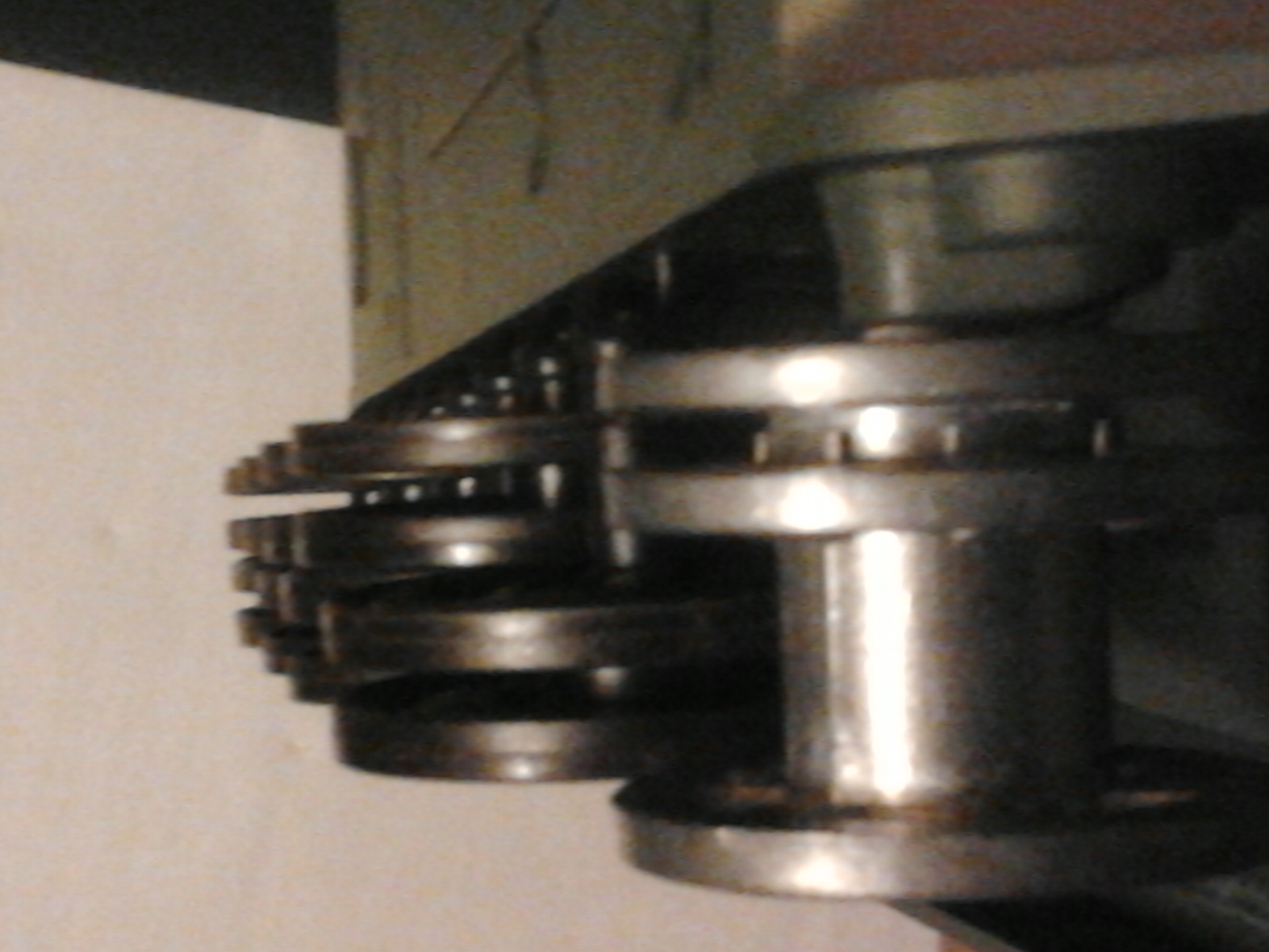

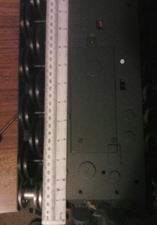

I have three Heng Long King Tigers, one I haven't checked, but two are like this, and this is why I would think twice about using a Heng Long KT chassis without heavy modification.
2015-01-13 01.16.29.jpg (625.81 KiB) Viewed 644 times

Re: King tiger HL lower hull with Taigen upper hull
For the reason Son of a Gunner illustrates, I would go with the Taigen (or Torro, same thing) lower hull. As for the electronics, it's tough. I by far prefer the Taigen/Torro V3 board and sound modules over HengLong's sound, but the newer HengLong 6.0 and later control is much more flexible and better at low speed. If you are up to it, see if you can get a Taigen lower hull and add aftermarket electronics. If you ask here on RCTW which aftermarket electronics are best, you can watch the fireworks fly. :P But you will see some, at least a bit, of agreement on which to avoid. :thumbup:

Son of a gun-ner wrote: Mon Jan 23, 2023 12:32 am I have three Heng Long King Tigers, one I haven't checked, but two are like this, and this is why I would think twice about using a Heng Long KT chassis without heavy modification.2015-01-13 01.16.29.jpg20210110-162751.jpg
+1 that this is a real issue. My HL T1 had so much camber that the majority of the outside road wheels didn't touch the track.
