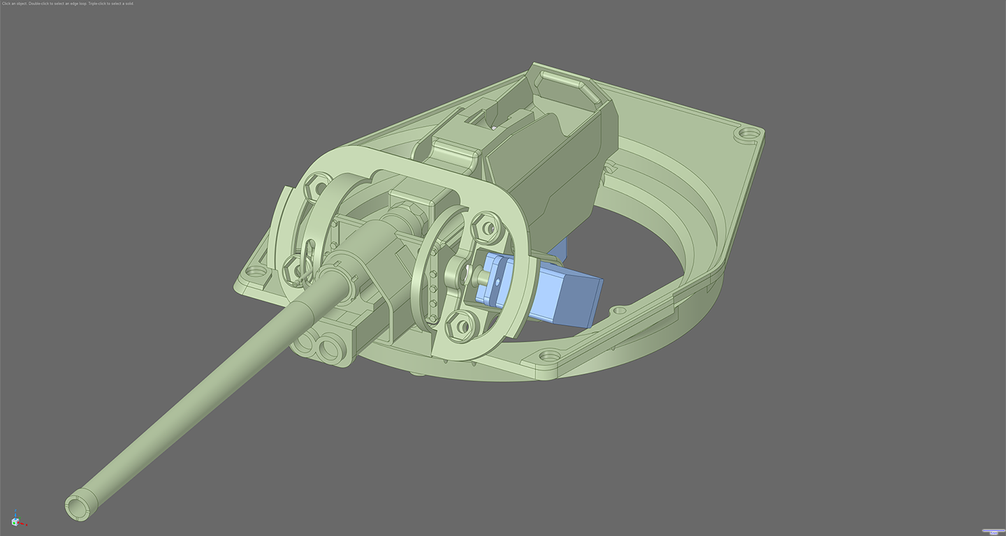

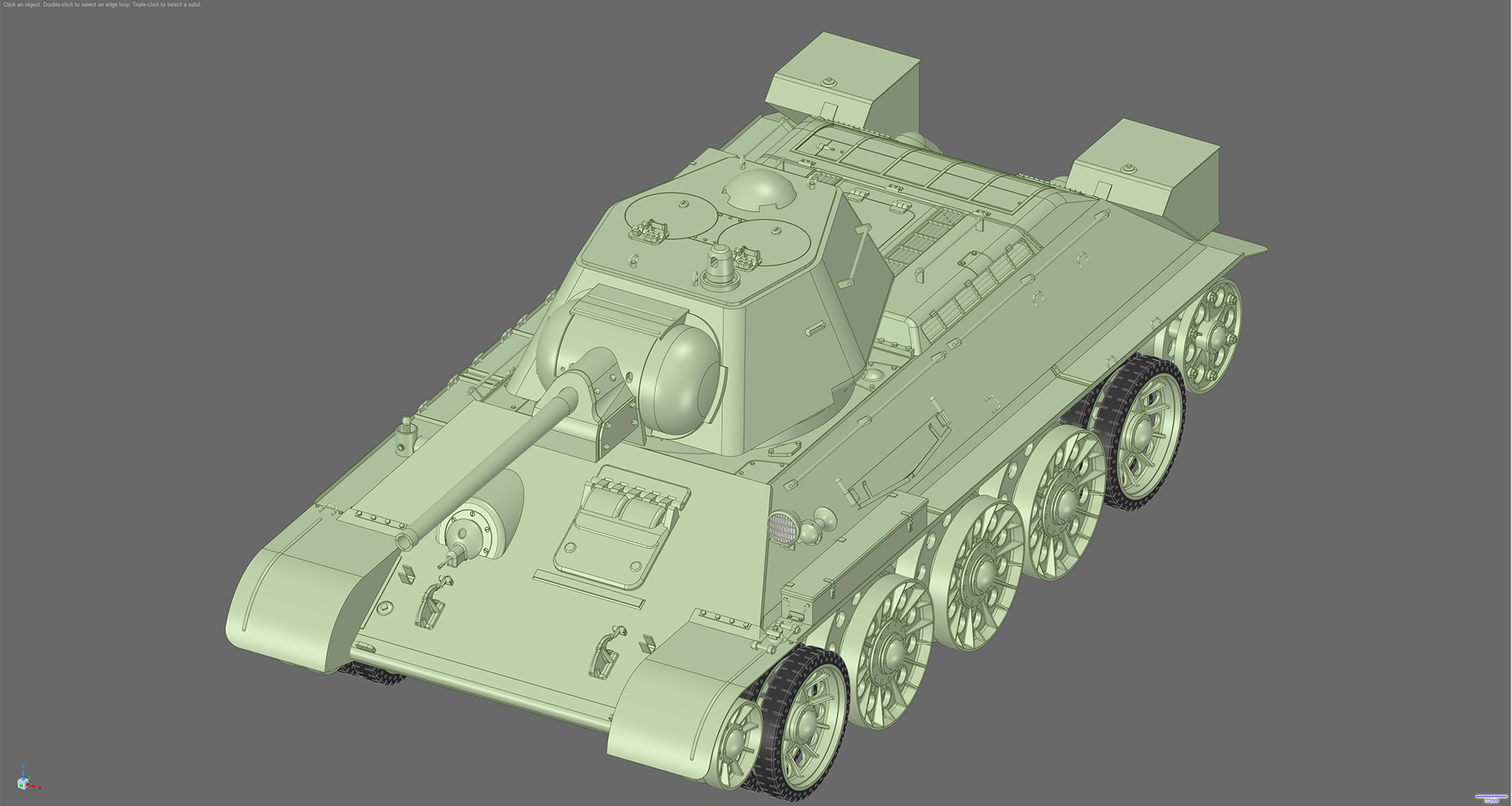

After a pretty long break earlier this year, I got my hands on Francis Pulham's excellent T-34 Shock, which has hundreds of photographs covering the development and evolution of the T-34. It inspired me to design and build a series of conversion kits for Heng Long and Taigen T-34/85s; ones that'd be more straightforward than converting a Trumpeter kit, and offering more options than just those two turret shapes. I know this is pretty ambitious, but I've really been enjoying the design aspect a lot more than I have more traditional modelling on previous builds. It's going to be a long-term project, but here's where I'm at after about two months' worth of CAD work:
I've made an elevation/recoil system that looks like the F-34 gun, trying to hide the servos as best I can. Should be useful for the earlier variants with the single large hatch.
I've got the recoil servo inside and under the recoil guard, and the elevation servo in the commander/gunners station.

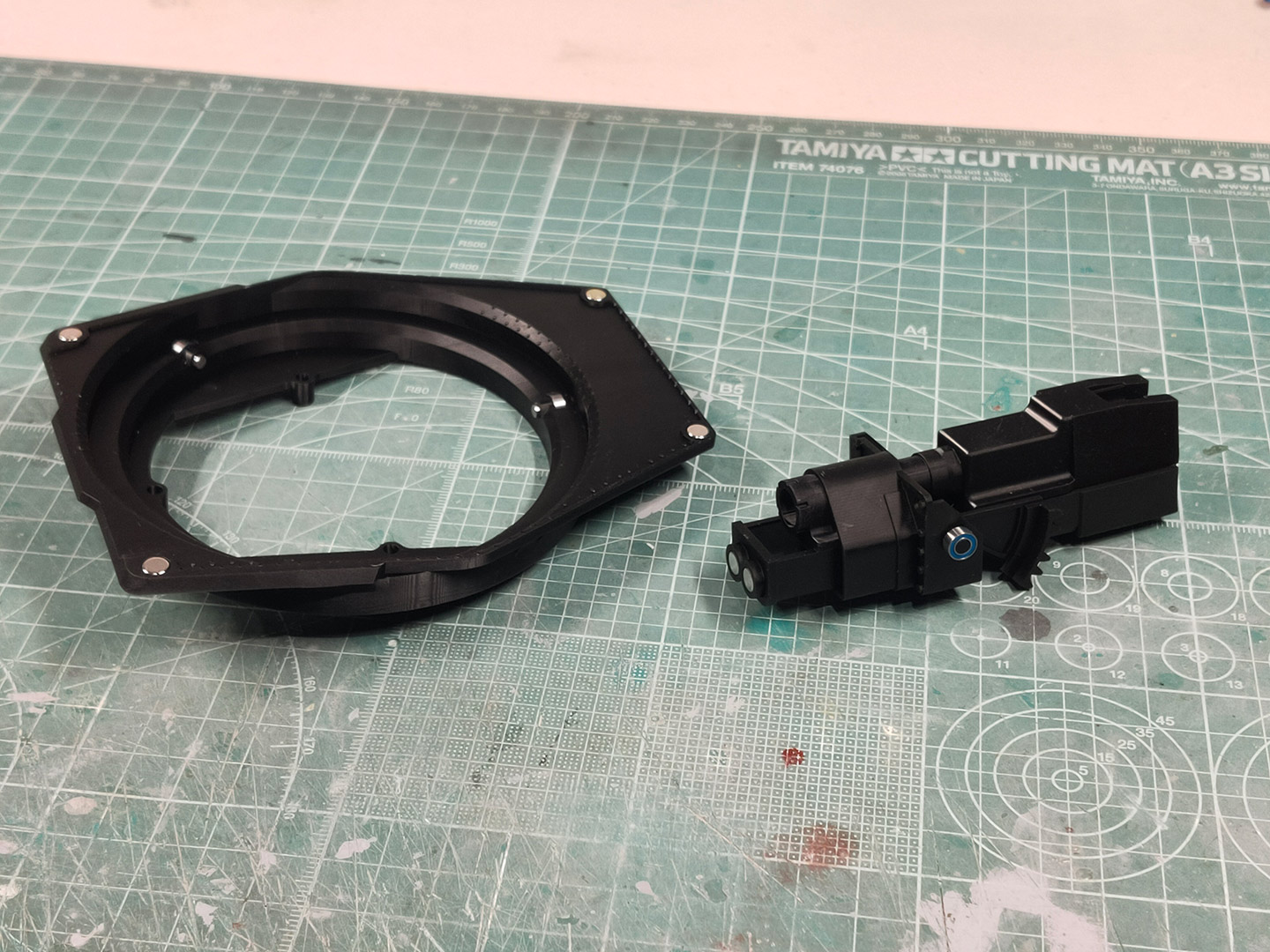

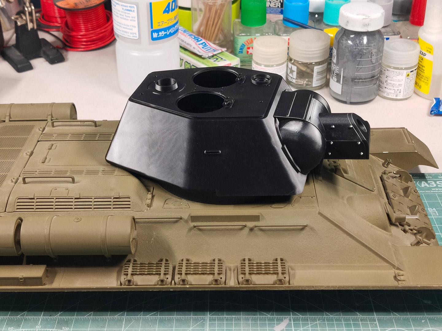

Finally got around to some test prints earlier this week, and I'm pretty pleased with how it's going so far:
There are magnets to hold the upper and lower halves of the turret together, and to hold the mantlet to the gun mount. Bearings on the gun trunnions for smooth elevation, and in the turret ring to roll on the upper hull.
I'll supply each kit with all of the hardware needed for assembly. There won't be just turrets but wheels, hatches, fuel tanks and exhausts for a complete conversion. Eventually I'd like to do the assault guns and TDs based on the T-34 too. Should keep me busy for a while yet!

wow, you have been busy
What printer are you using?

Those look really impressive quality, when you get to the full tanks could you make me a couple for the fighting girlfriend?

looks very good, quality of printing is awesome.

That looks fantastic and so well thought out. Great work

Wow, the print looks so crisp! Nice idea with magnets also. Are ypu planning to sell those files somewhere (especially recoil mechanism).
Re: Every flavour of T-34
Very impressed with the print quality. If I had that turret I would swap it with the Trumpeter one and finish my T34/76 project.

Many thanks for the kind words everyone, I'm genuinely flattered! I'll try to answer all of your questions:
I've got a Phrozen Sonic Mini 4K and Sonic Mighty 4K. I use the Mighty for large parts like the turret (50 µm resolution), and the Mini for detail parts like these (35 µm resolution).

I'm not planning on selling any files, mostly because I've been designing these to my printers' capabilities based on the particular mix of resins I'm using. Other people might not be able to print them! I'm also constantly updating them, nothing's ever finished.
