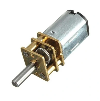

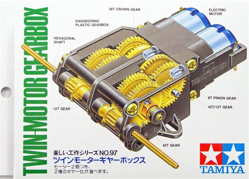

For motors - there are cheap motors with small gerbox available. Also Tamiya Twin Gearbox.
For battery i.e. lipo 2S (7,4V).

where could I find the Tamiya Twin Gearbox in Europe?Kaczor wrote:For motors - there are cheap motors with small gerbox available. Also Tamiya Twin Gearbox.

I don't know where do you live but in Poland Tamiya Tiwn Gearbox is available in every online modeling shop.
