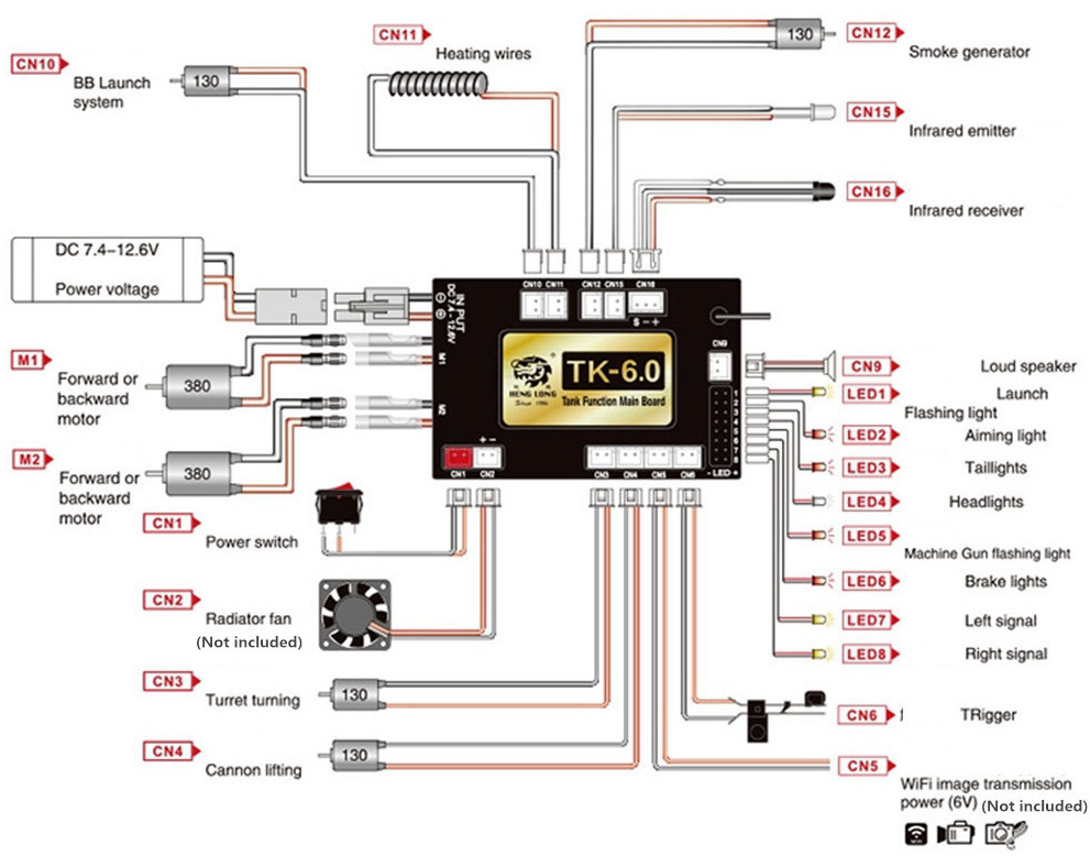

Thanks I have this in the manual but it doesn't tell me what colours go where

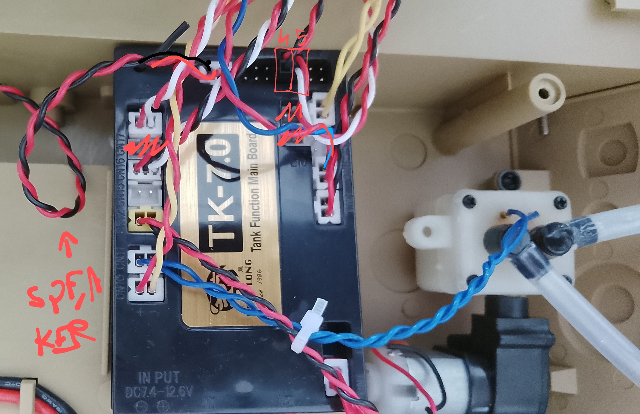

Here,i hope it will help its a 7.0 but wires are the same,hope it helps,the slots covered in red are for7.0 so i removed them
IMG_20250721_133200 (1) (1).jpg (620.83 KiB) Viewed 1375 times
