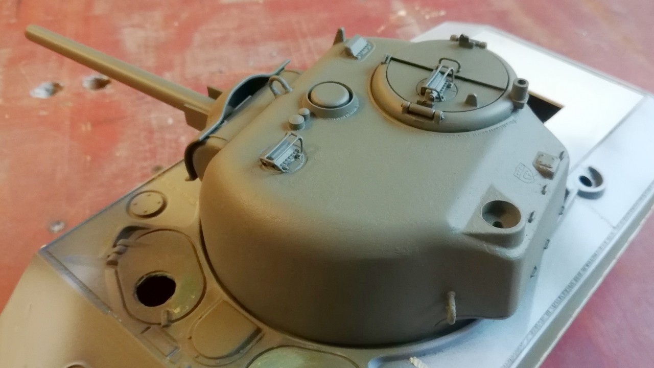

On to some turret mods. Low bustle, modified turret vent and early commander's hatch.
I bought this lathe for tanking.
This is more of the aluminum .020 that appears in the Priest thread. Epoxied in the hatch and the small ring will slip on from the bottom to hold hatch in place and allow it to turn. Some guys print these, others order them but I wanted to take a shot at making one.
I also sanded down most of the blister that was on the later turret to fit the larger late commander's hatch.

Not a big deal but I did manage to make the periscopes able to turn. The periscope mounts came from my brother and I think they came with one of Nick's turrets.
A few details and some weathering to do yet, but this is just about complete. I moved the HL elevation mech to the opposite side of the turret giving room for the commander.
