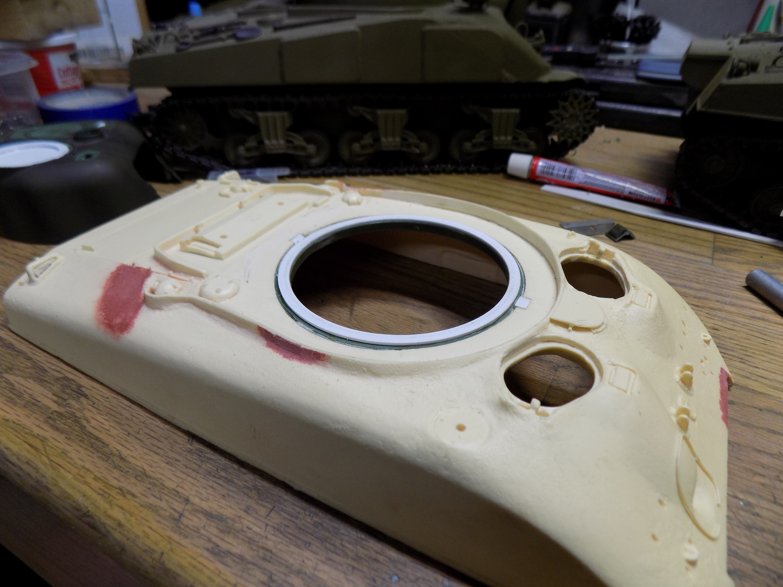

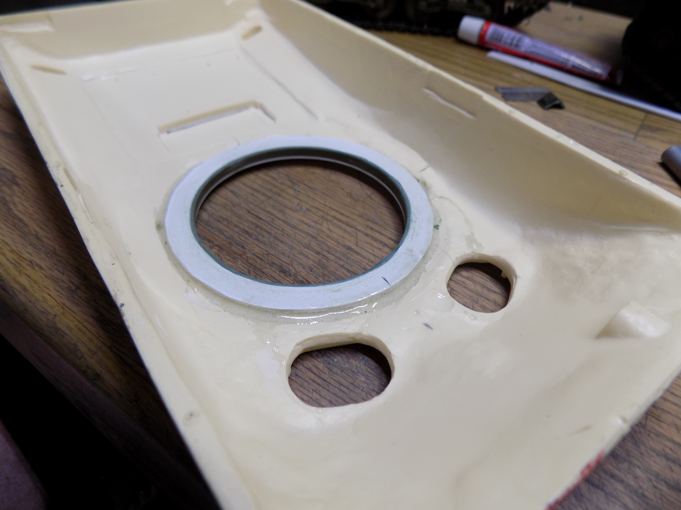

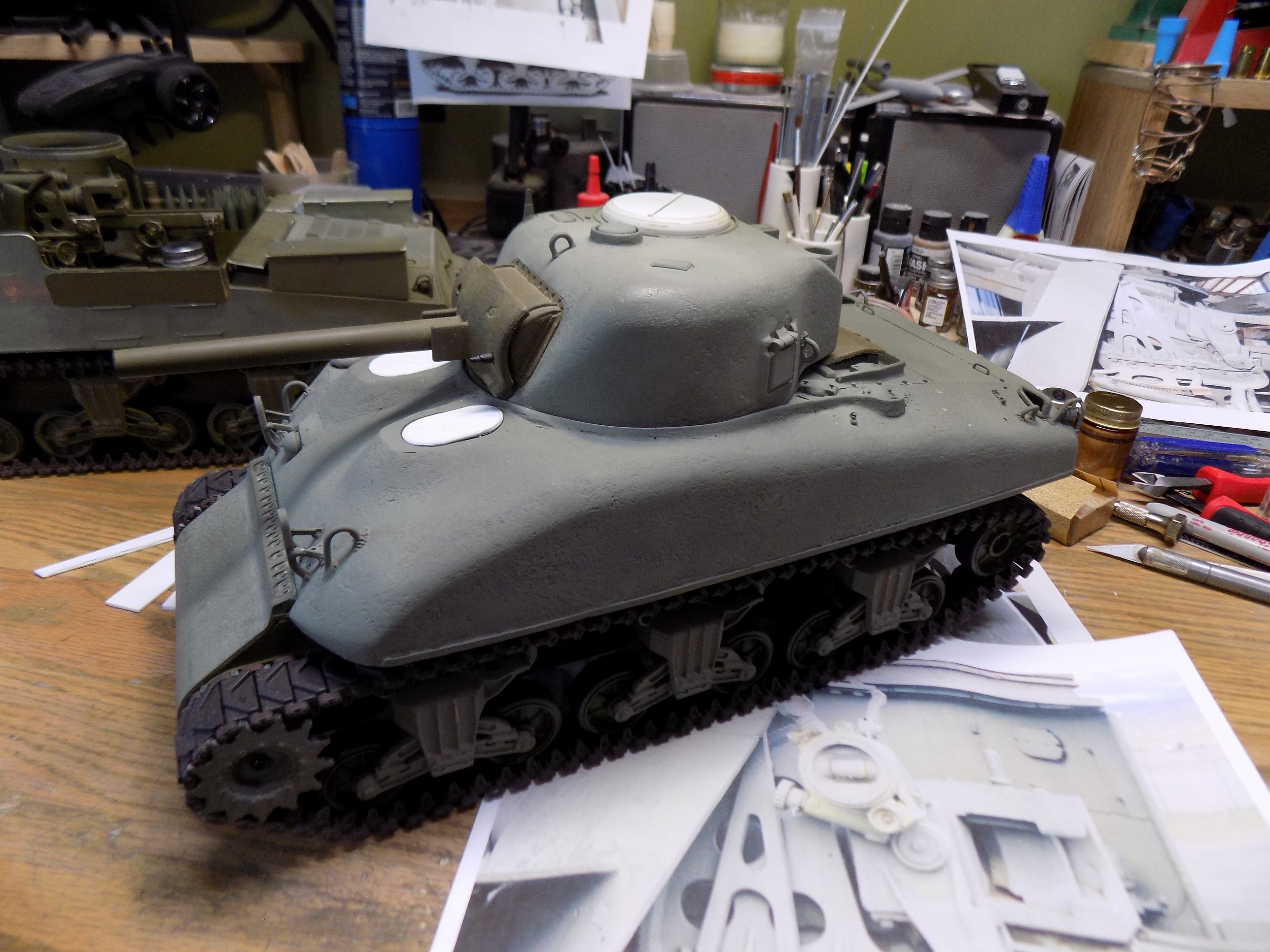

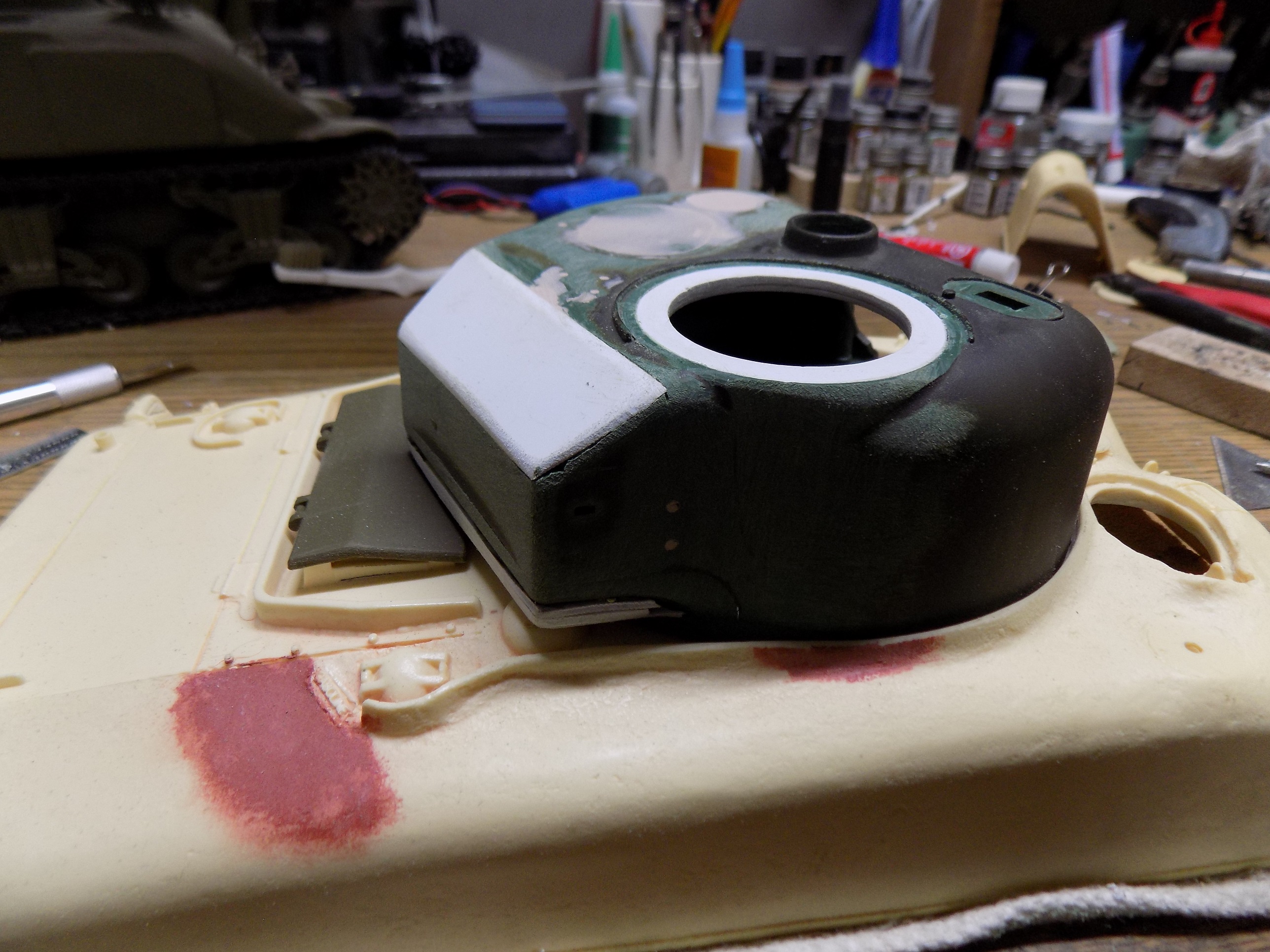

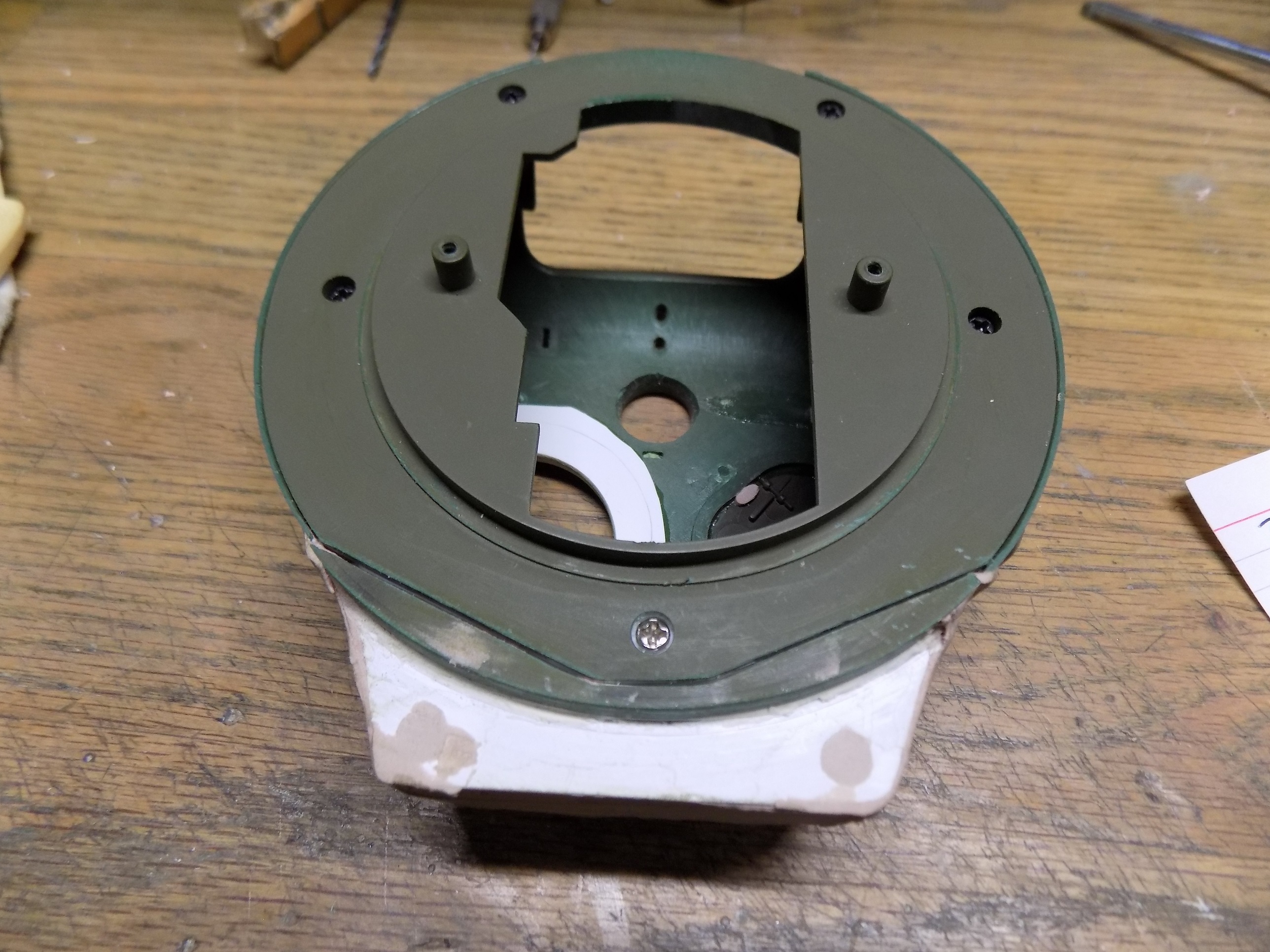

My brother gave me the hull and I have no idea of the origin. It was set up for the Tamiya turret so first off I cut a turret ring out of an HL spare hull. Out of the dozen HL Shermans I have built or building, only three have used the HL upper. One of those was the Jumbo. Though the Priest is using the back half of one. The resin hull had a high point in the center of the ring so I added a spacer to the top of the turret ring and trimmed the lower to fit the HL turret and drive ring. Yes the nose will get some work for the narrow hatches (and other hull mods), but that may be a bit down the road. Today's work was really a stall waiting on the last of the DUKW parts to show (tomorrow).
M4A1 5.JPG (992.67 KiB) Viewed 22 times
M4A1 6.JPG (848.19 KiB) Viewed 22 times

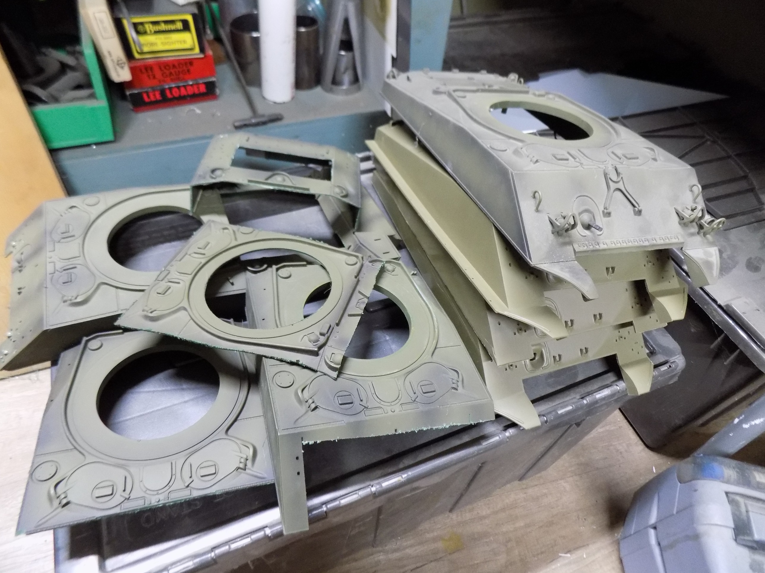

Thankfully I have a supply of upper hulls and turrets to play with.

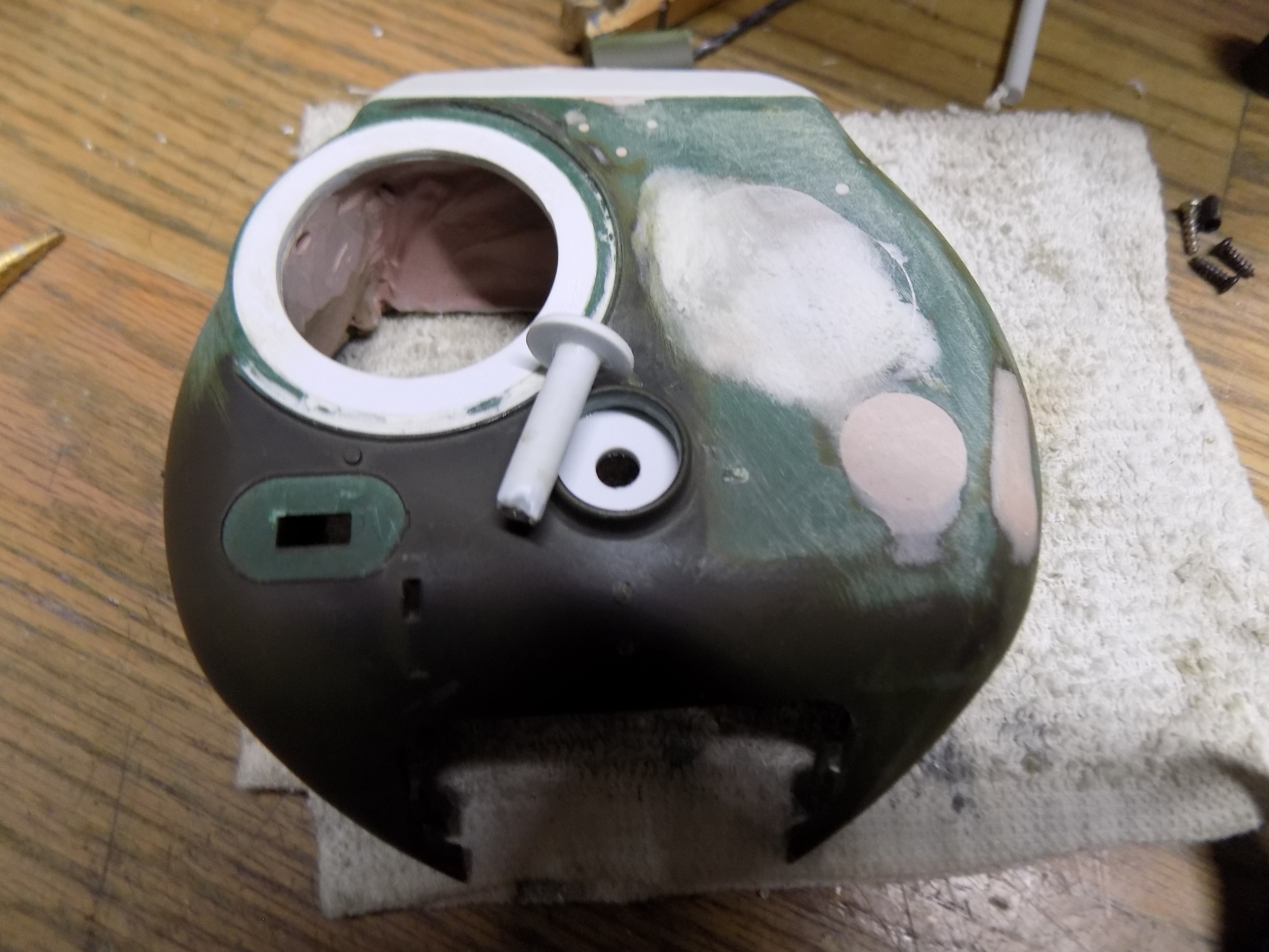

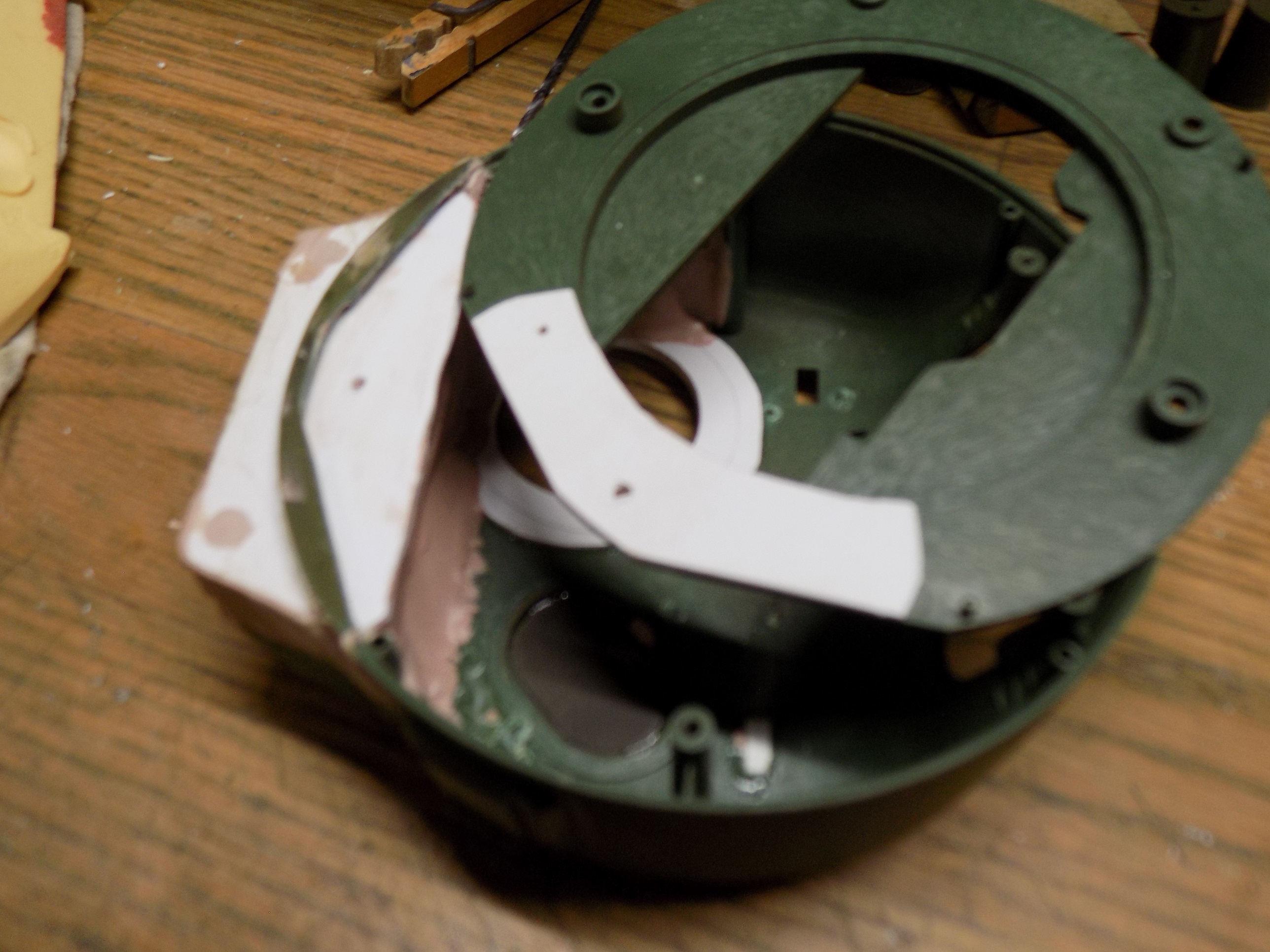

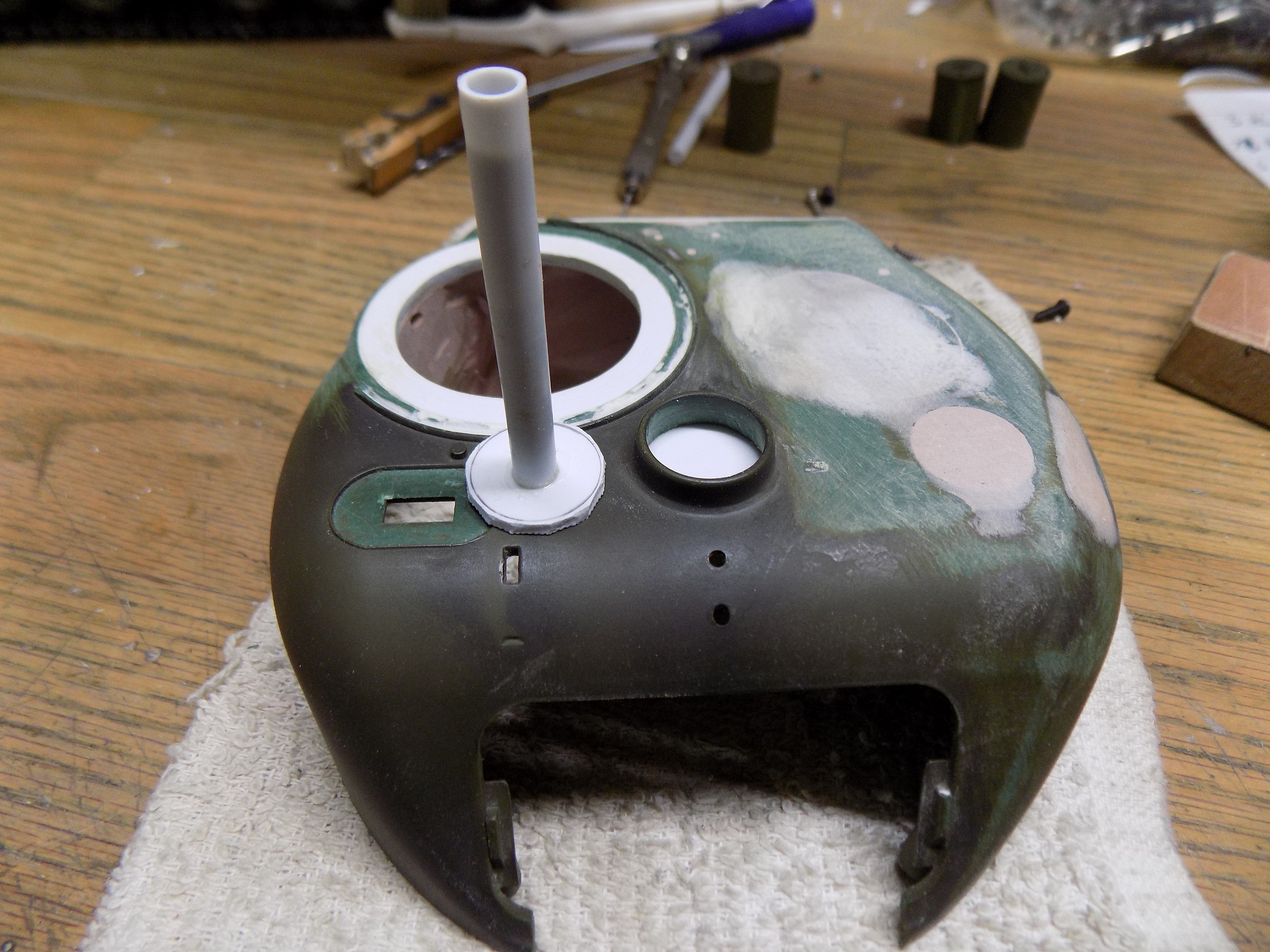

On to some turret mods. Low bustle, modified turret vent and early commander's hatch.
M4A1 9.JPG (1.17 MiB) Viewed 22 times
M4A1 10.JPG (1.02 MiB) Viewed 22 times
M4A1 11.JPG (1.14 MiB) Viewed 22 times
M4A1 12.JPG (1.33 MiB) Viewed 22 times
M4A1 13.JPG (1.21 MiB) Viewed 22 times
M4A1 14.JPG (2.14 MiB) Viewed 22 times

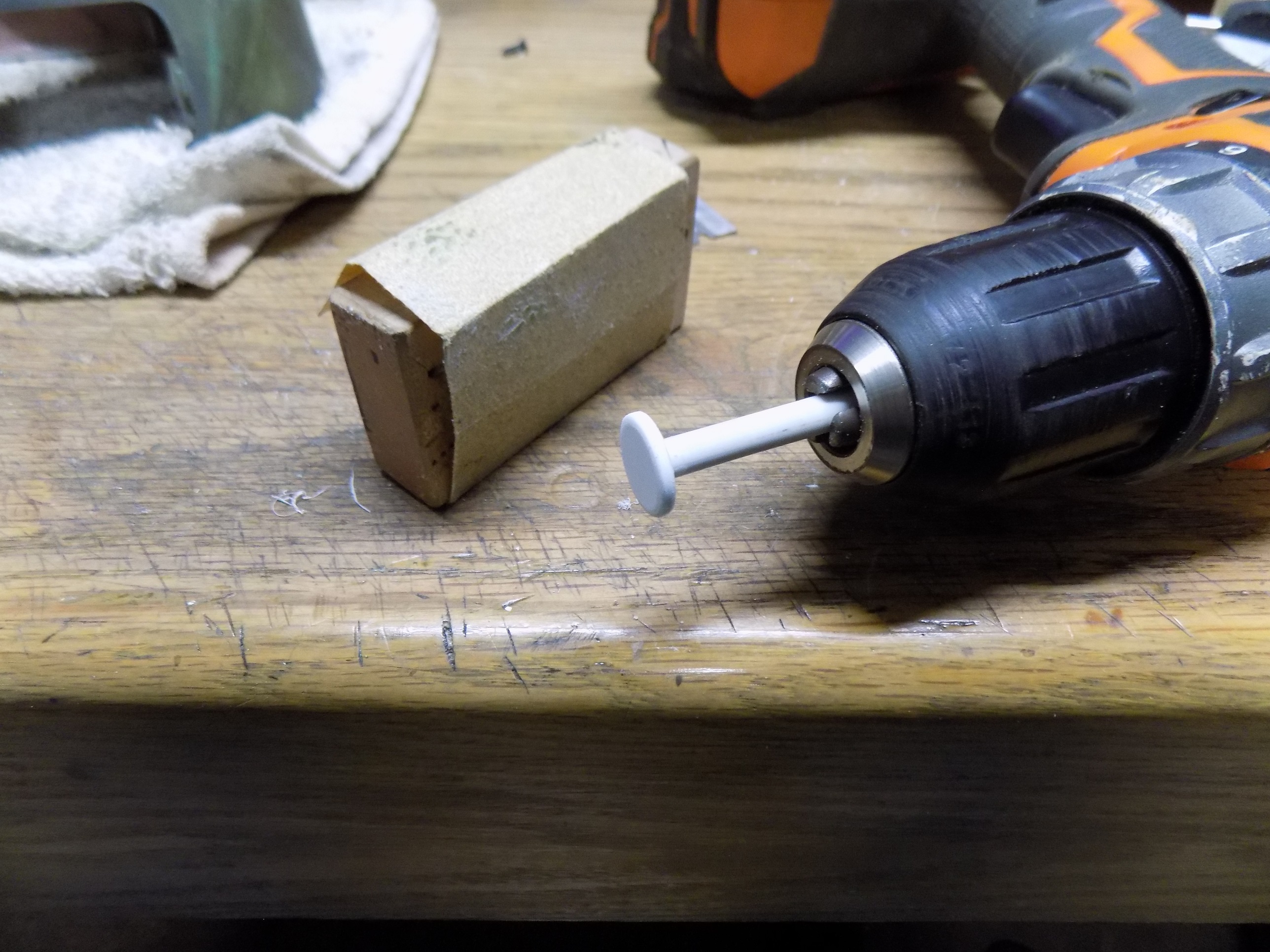

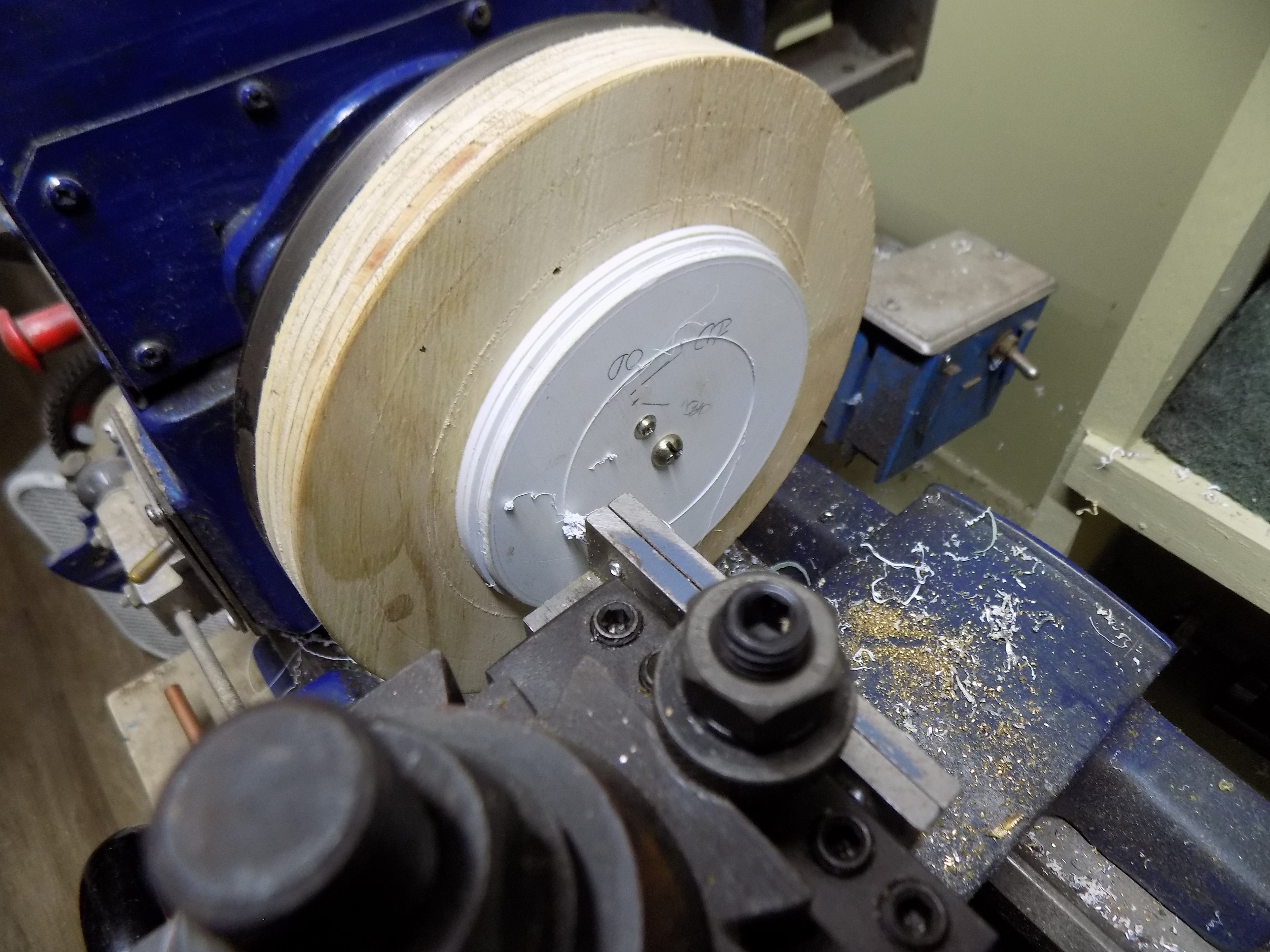

I bought this lathe for tanking.
M4A1 15.JPG (1.25 MiB) Viewed 22 times
M4A1 16.JPG (1.48 MiB) Viewed 22 times

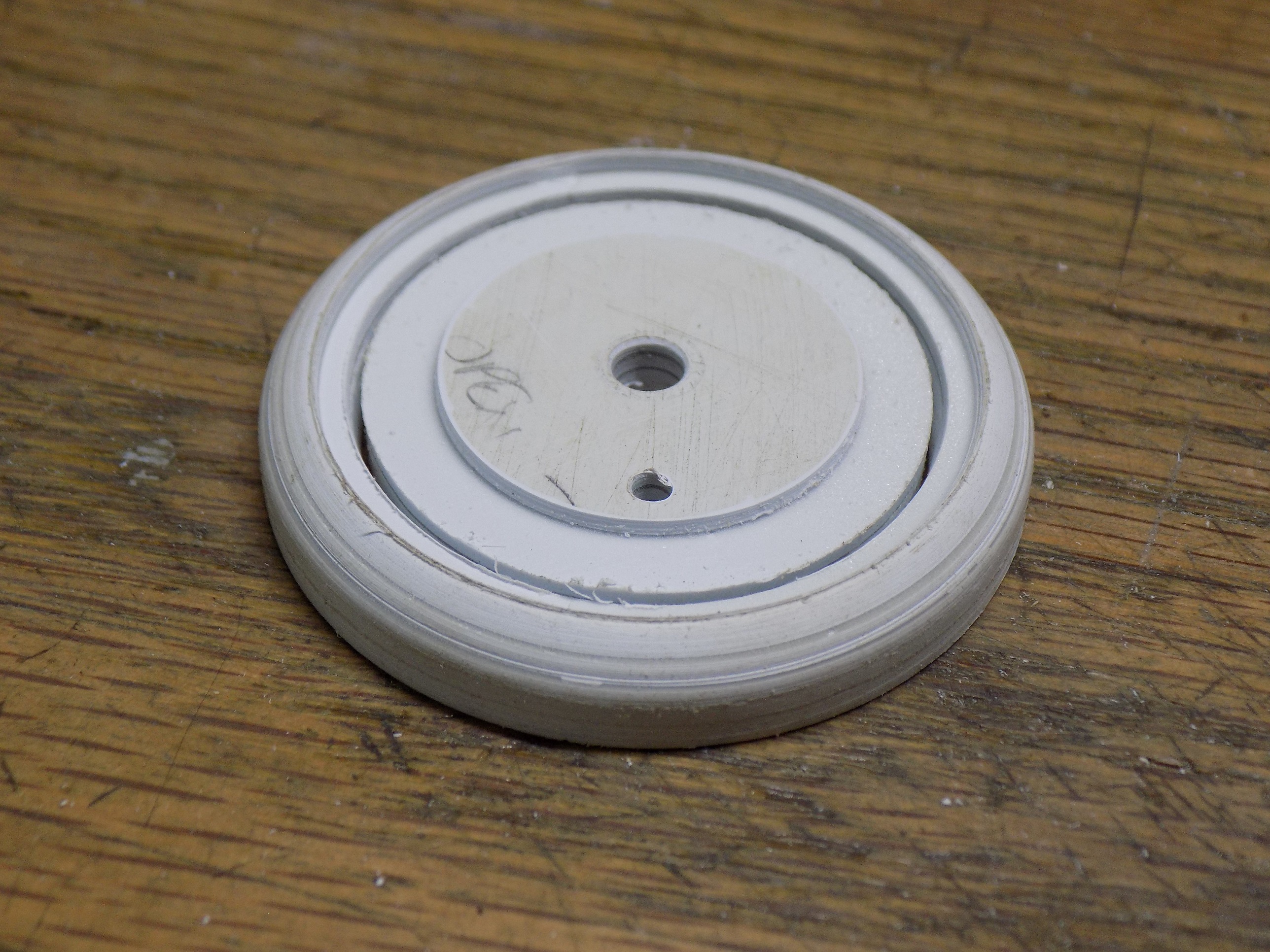

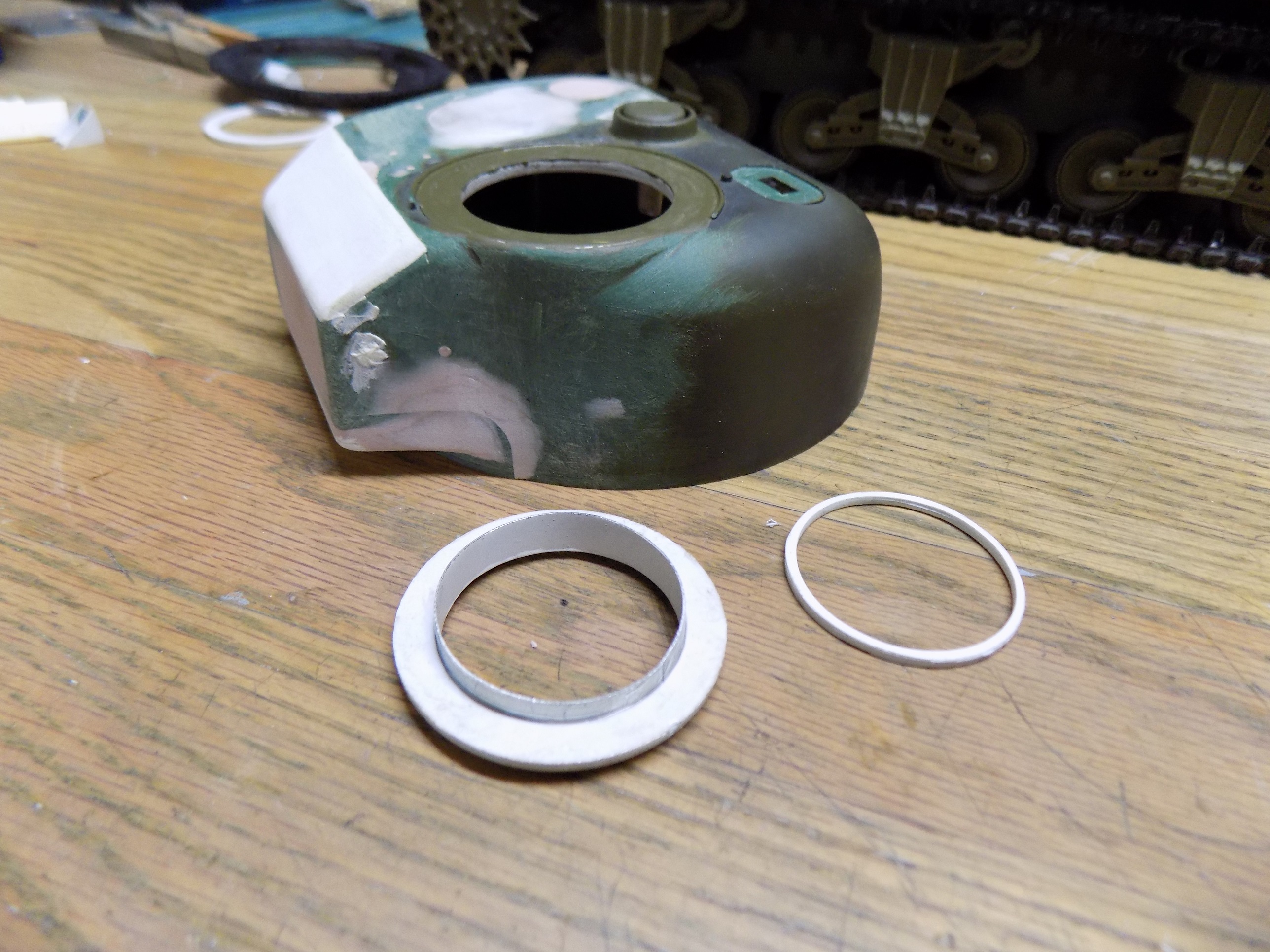

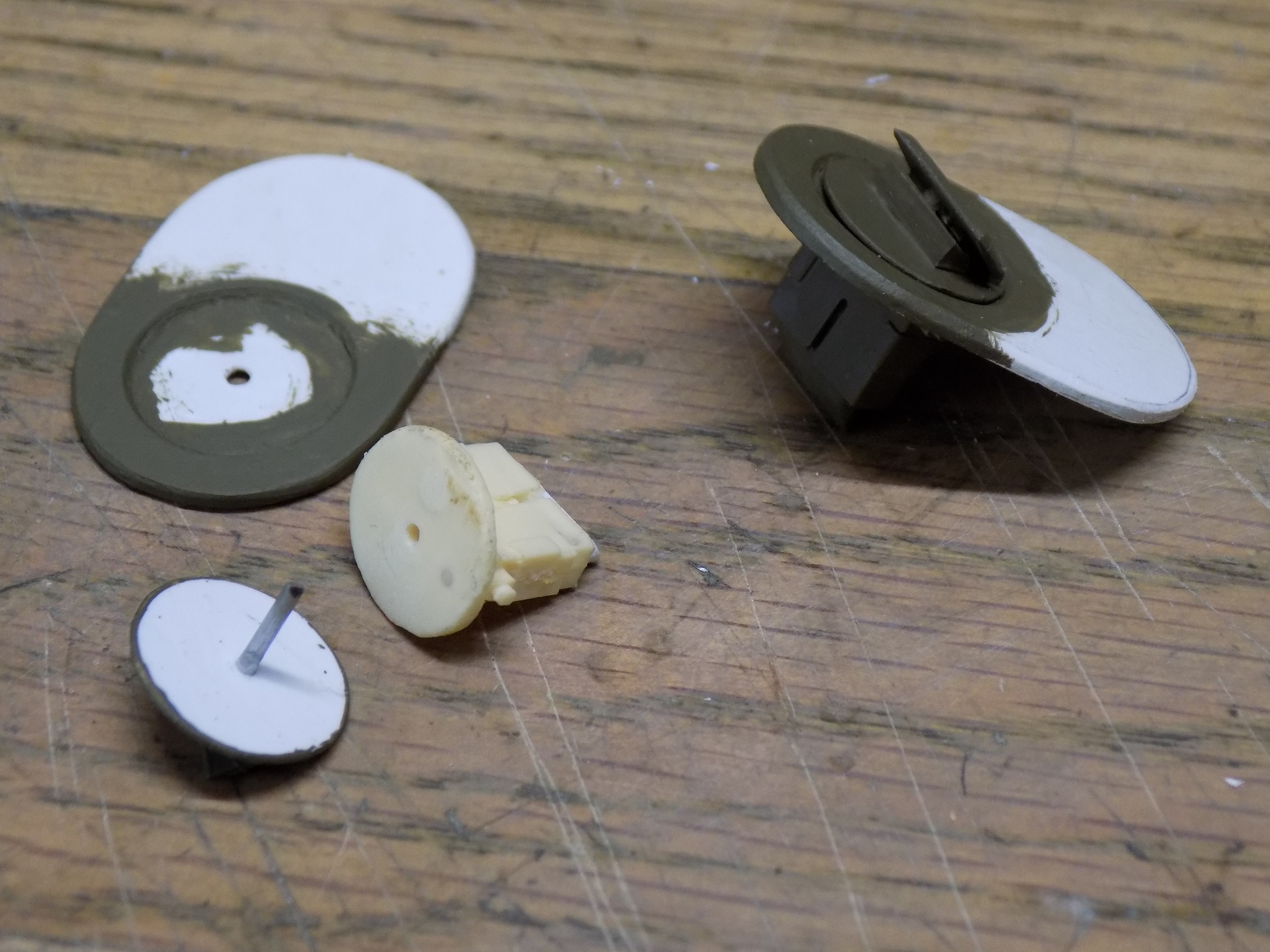

This is more of the aluminum .020 that appears in the Priest thread. Epoxied in the hatch and the small ring will slip on from the bottom to hold hatch in place and allow it to turn. Some guys print these, others order them but I wanted to take a shot at making one.
M4A1 17.JPG (1.21 MiB) Viewed 22 times
I also sanded down most of the blister that was on the later turret to fit the larger late commander's hatch.

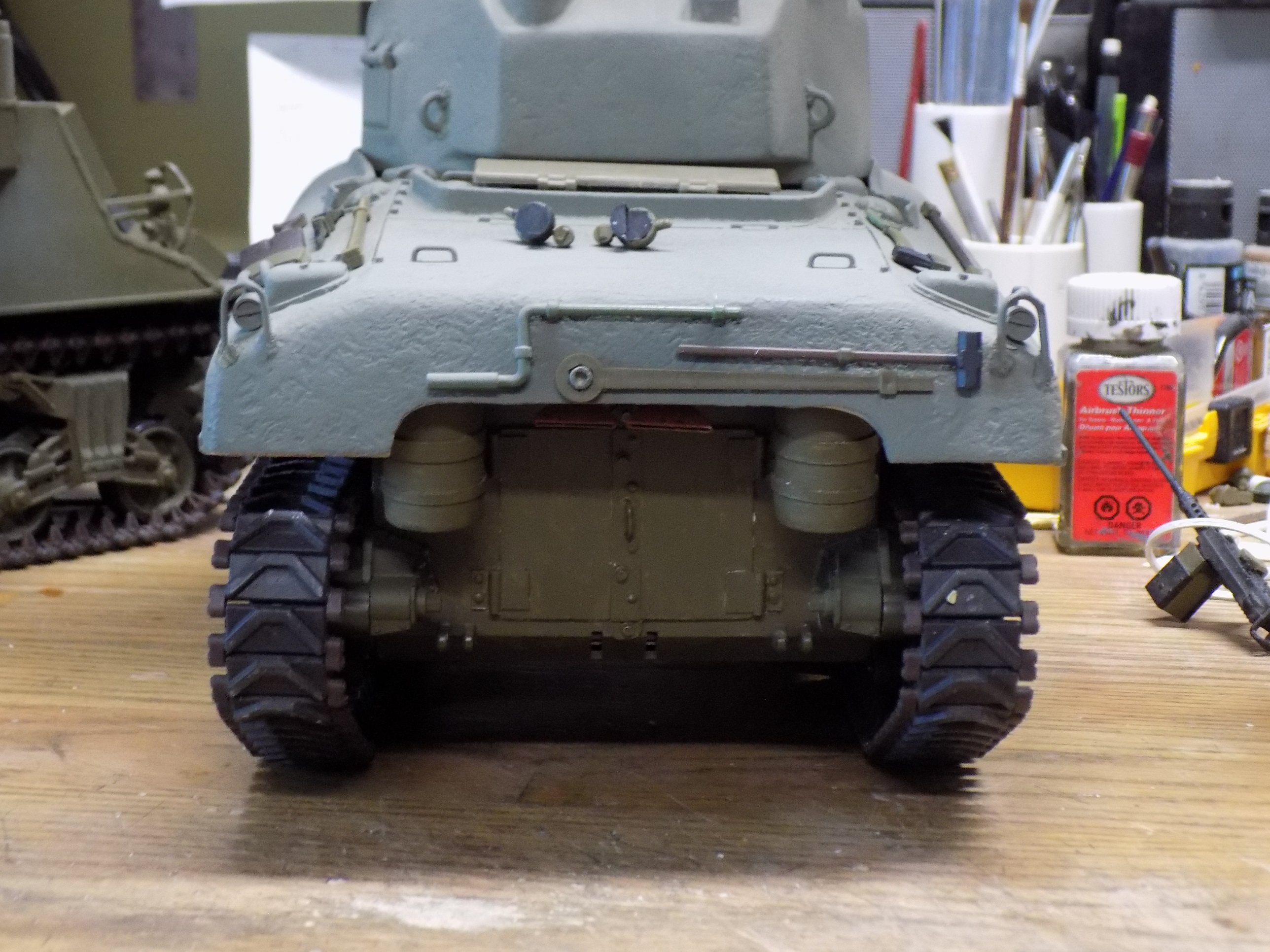

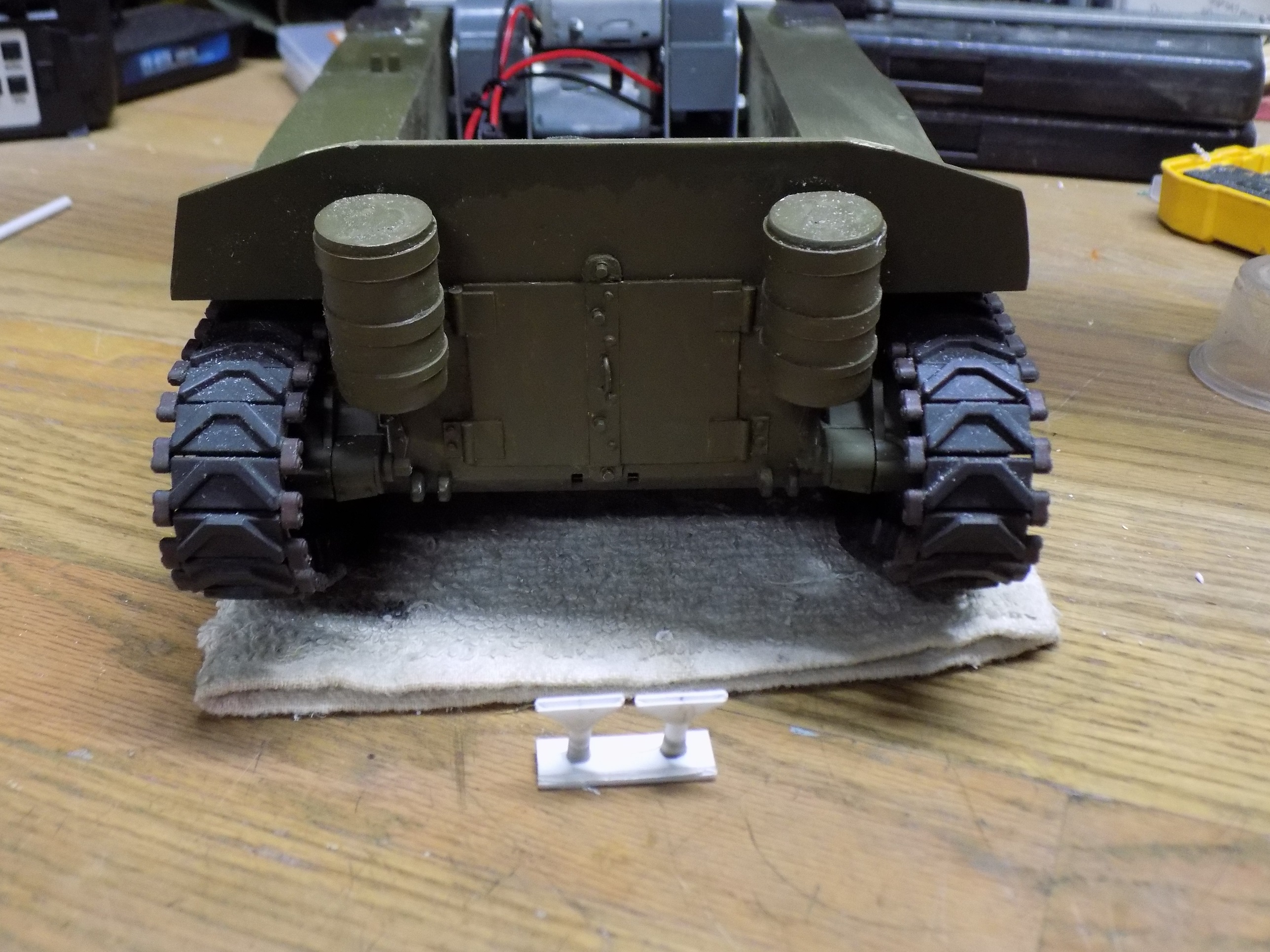

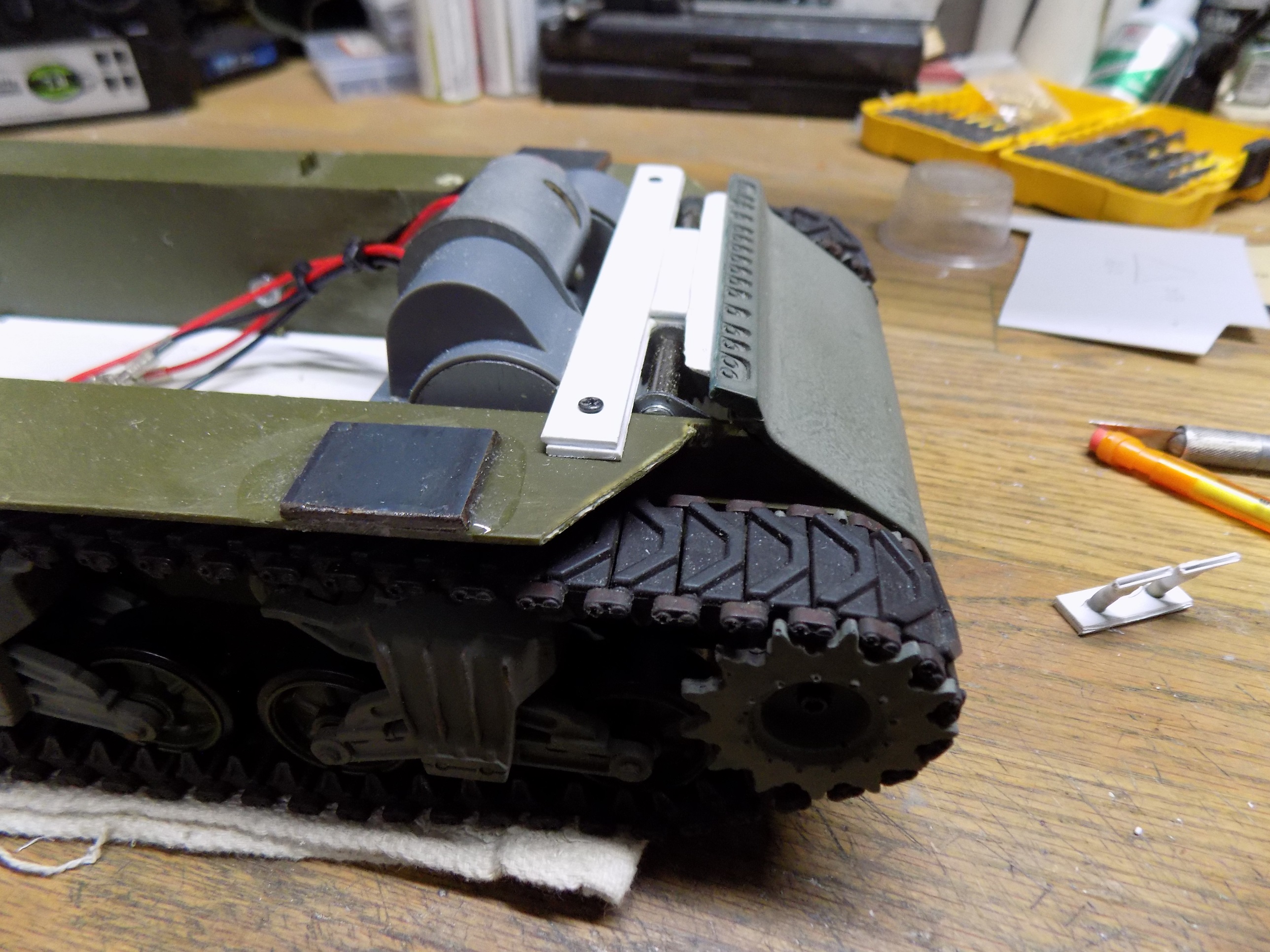

Rear wall. Have three tanks with square air cleaners so I thought round ones would be nice on this one.
M4A1 19.JPG (1.34 MiB) Viewed 21 times
The shape of the cast hull makes it hard to deal with the upper trans cover mount, so I rigged this up.

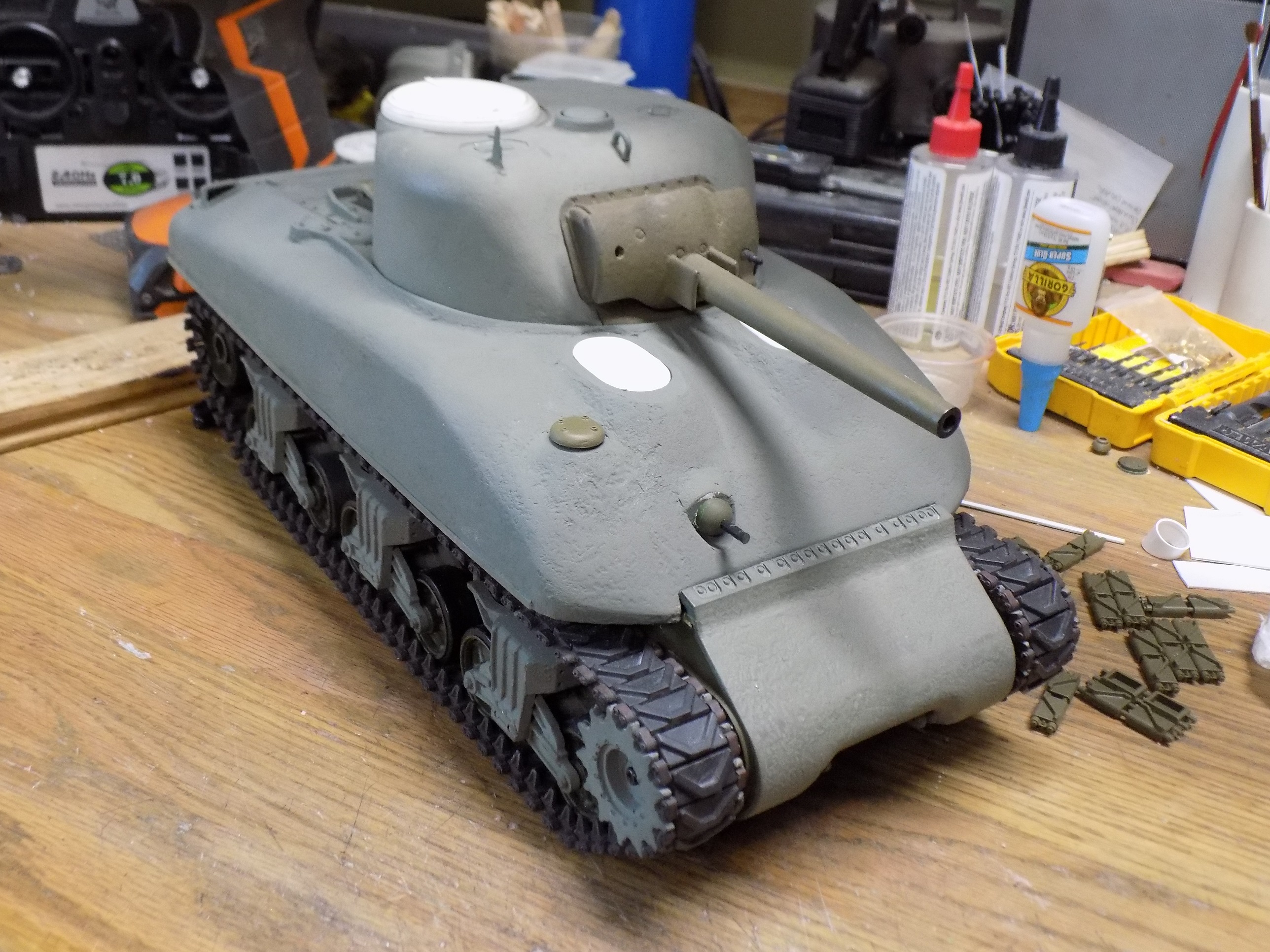

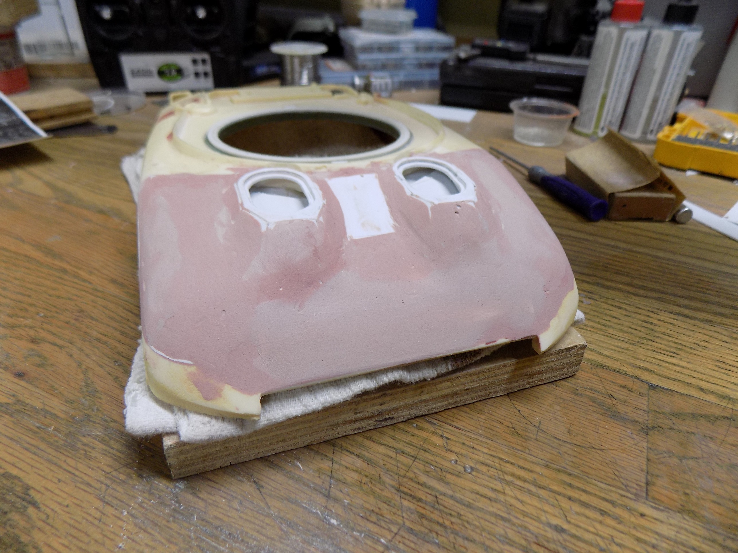

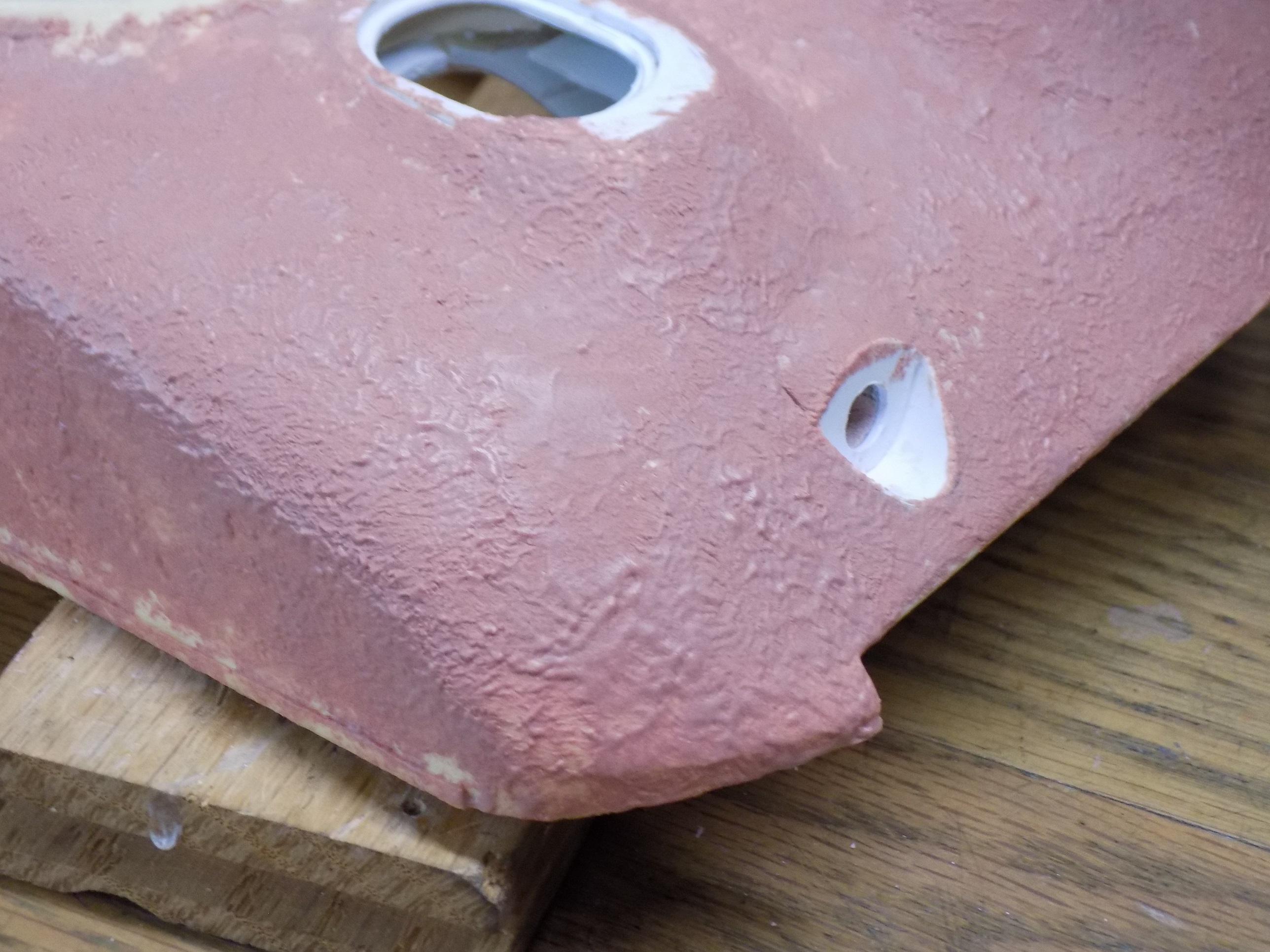

It took several attempts to get the front end to my liking.
M4A1 23.JPG (1.32 MiB) Viewed 21 times

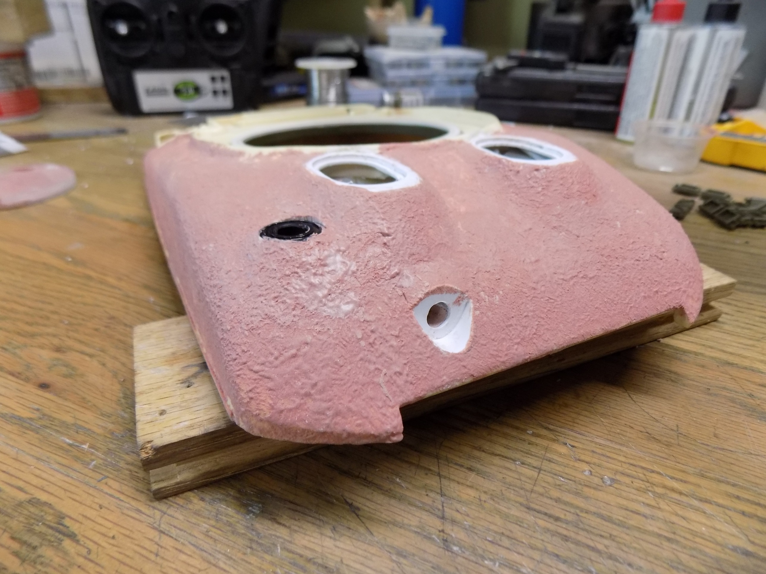

Thinned down Bondo and dabbed on with a stiff brush. It was also about here I realized I forgot the ventilator on the front right of the hull...
M4A1 24.JPG (1.21 MiB) Viewed 21 times
Fixed.
M4A1 25.JPG (1.14 MiB) Viewed 21 times

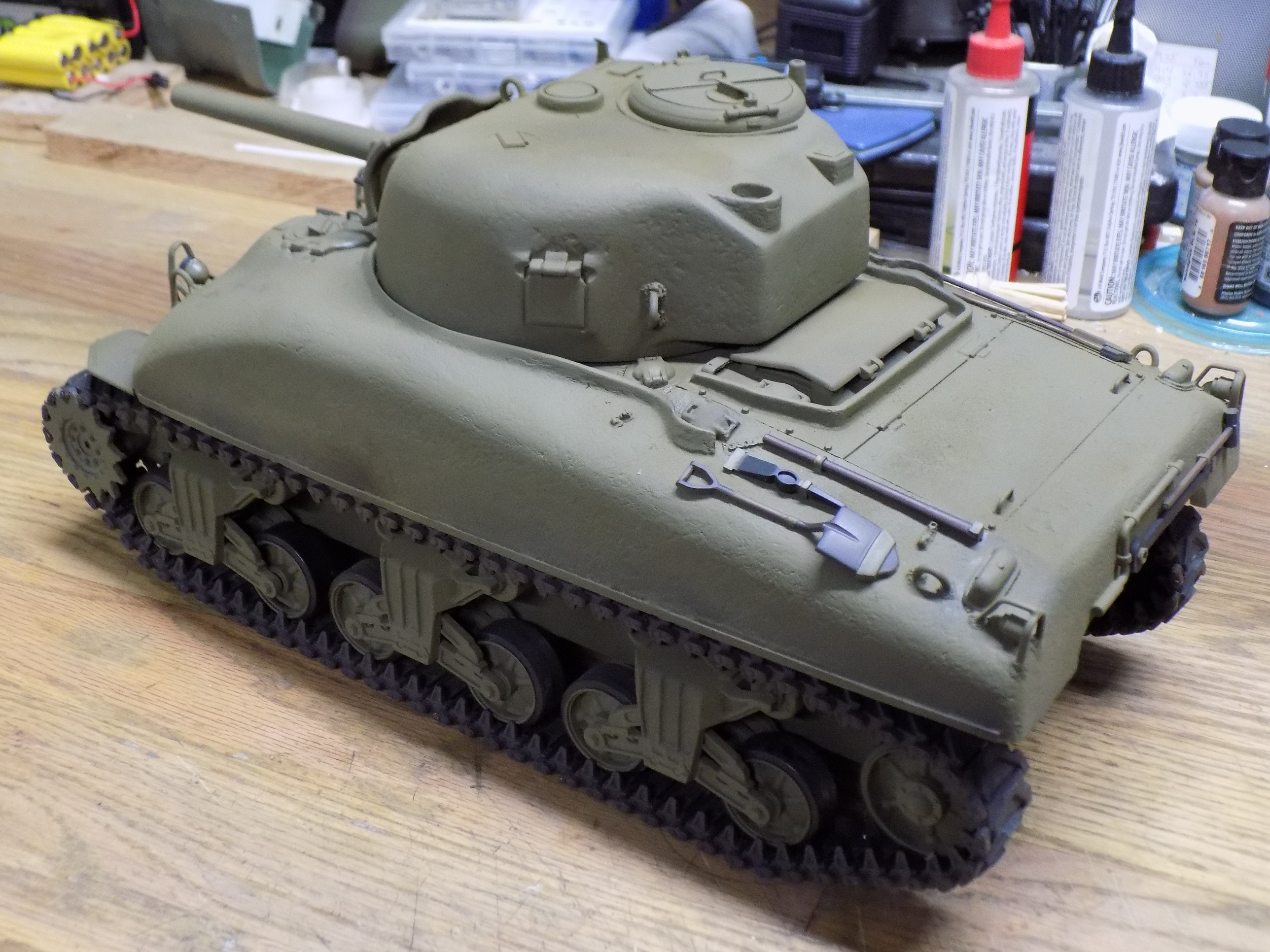

Light guards and lifting rings.
M4A1 27.JPG (1.31 MiB) Viewed 21 times
Tools and barely peeking out, the exhaust tips.
M4A1 28.JPG (1.33 MiB) Viewed 21 times

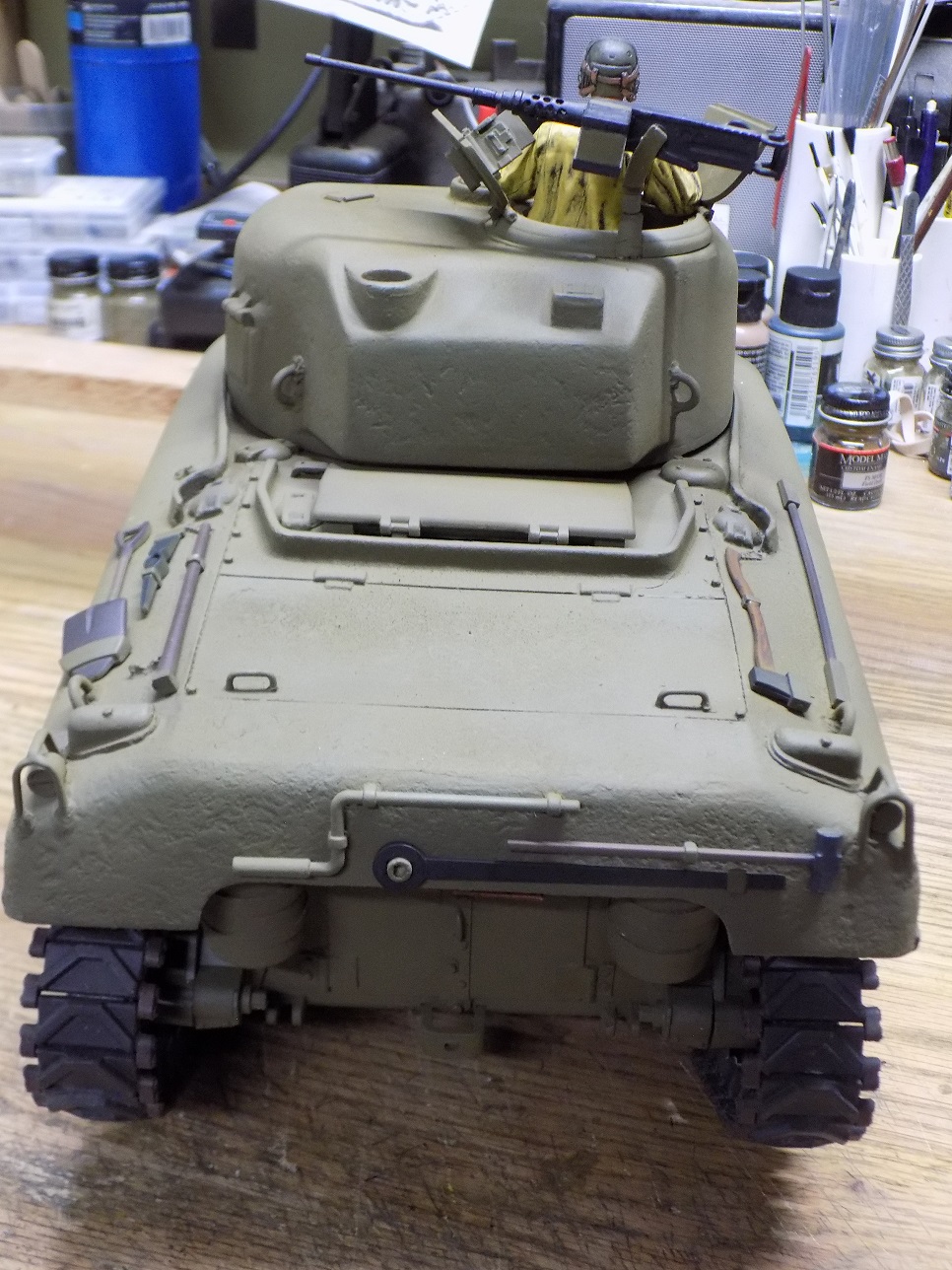

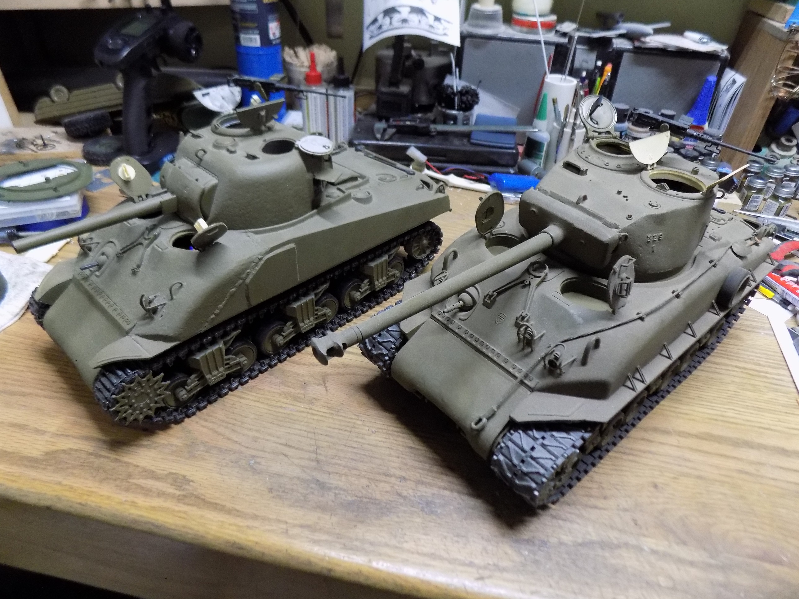

Not a big deal but I did manage to make the periscopes able to turn. The periscope mounts came from my brother and I think they came with one of Nick's turrets.
M4A1 30.JPG (1.14 MiB) Viewed 19 times

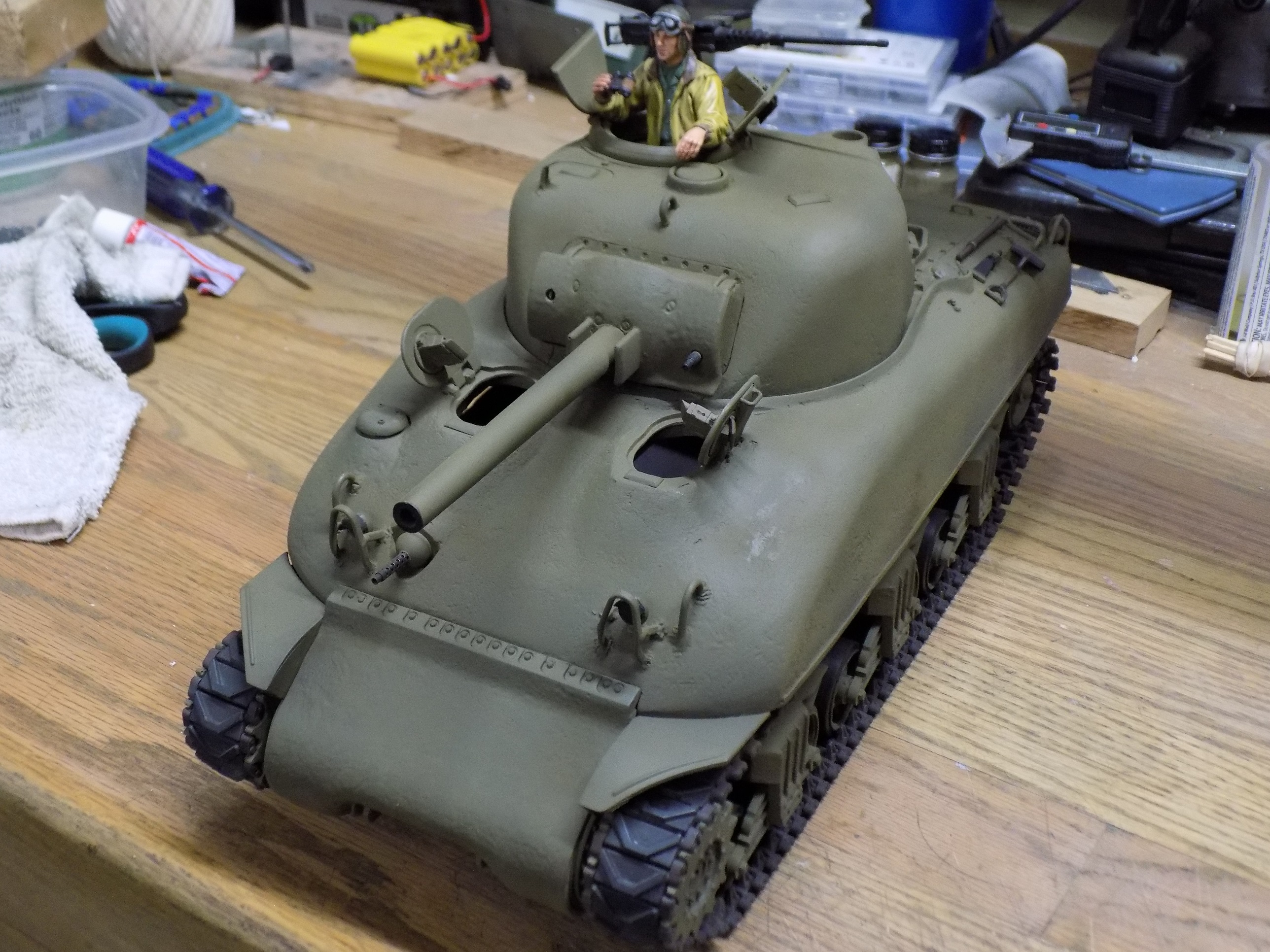

A few details and some weathering to do yet, but this is just about complete. I moved the HL elevation mech to the opposite side of the turret giving room for the commander.
M4A1 31.JPG (1.38 MiB) Viewed 19 times
M4A1 32.JPG (1.44 MiB) Viewed 19 times
M4A1 33.JPG (479.67 KiB) Viewed 19 times
